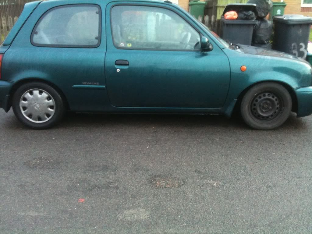

side
front
rear
do it well worth the money even if you feel every single bump in the road, but thats worth it if you can go around roundabouts at silly (legal) speeds....

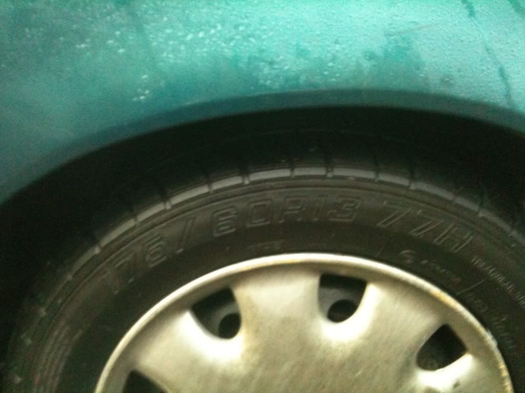

does anyone know of any cars that used wide steels?
You are not likely to find anything with wider than 5.5 in a 13" steel, you might have to buy some wide wellers or something and use them to re-rim the micra centers. Though you could get about an inch by getting some two part wide rims made up like franks, using the wide rear part and corresponding wide front part of two factory rims.

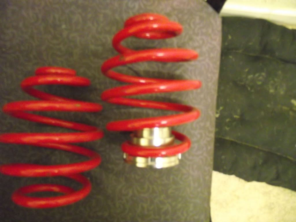

whats the score witht he rear corsa coilovers then, why dont they fit?
they weren't really coilovers on the rear more uprated shock with separate spring and adjustable cup, the shock does fit with minimal modification but the spring is the wrong shape more of a ball compared to the micra spring
i get a pic up in a minute scott
But if you could get a set with proper coil overs you will be able to fit them and have the height adjustment. But the micra mounts are pretty weak because they are originally only meant to support the shocks. You could strengthen the mounts or you might get away with it if you dont take any weight in the back.

Yes, he sells the Spax coilover kit that was rear struts with shock and spring together...
So, this would mean that the "proper" Corsa Coilovers will fit on the rear of the Micra? Didnt Stani got those Spax C/O?
