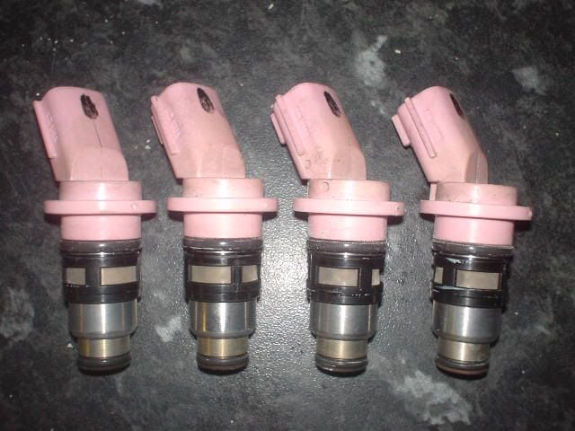

a little present for the car turned up today, but now i'm unsure about fitting them after elliot's encounter with a tree after fitting his mmmm
also had this fitted in the car for a month or so and i want to know why we never got them in this country..... they are so handy
hehe no snow in this pic (Y)
yes they are frank....
a pic of them out of the rail, i was going to swap them over about ten minutes ago but it got dark really quickly and it felt like i was going to round off one of the screw heads, so that'll be a job for either monday or tuesday next week :down:
i had to use mole grips to shift eliot,s screws mate fwn once you crack them 1/8th of a turn they screw out a treat
and those are probably better suited for the CG,s eh, you may not suffer the overfueling that the black (198cc) ones sometimes give ?
i'll have to get some mole grips first i don't know why i don't have any fwn.... they'll go well with the throttle body aswell, i'm more than likely wrong but it looked like the rail was a straight swap aswell

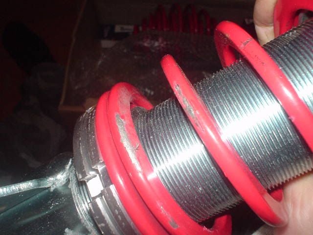

Massive update :D spent most of today with (watching) frank getting corsa coilovers on, will put pics up either tomorrow or wednesday but lets just say both me and frank were very surprised with how close a match they were
corsa coilovers ftw
nice one cant wait for some piccies should ghet a little guide going of how to make em fit then im sure hell of alot more people will be doing the mod themselves!
they,re pretty straight forward to fit will (Y) and very strong/secure too

ok so i'm home now and realised i didn't actually take that many pictures *doh*
anyway heres pictures i did take

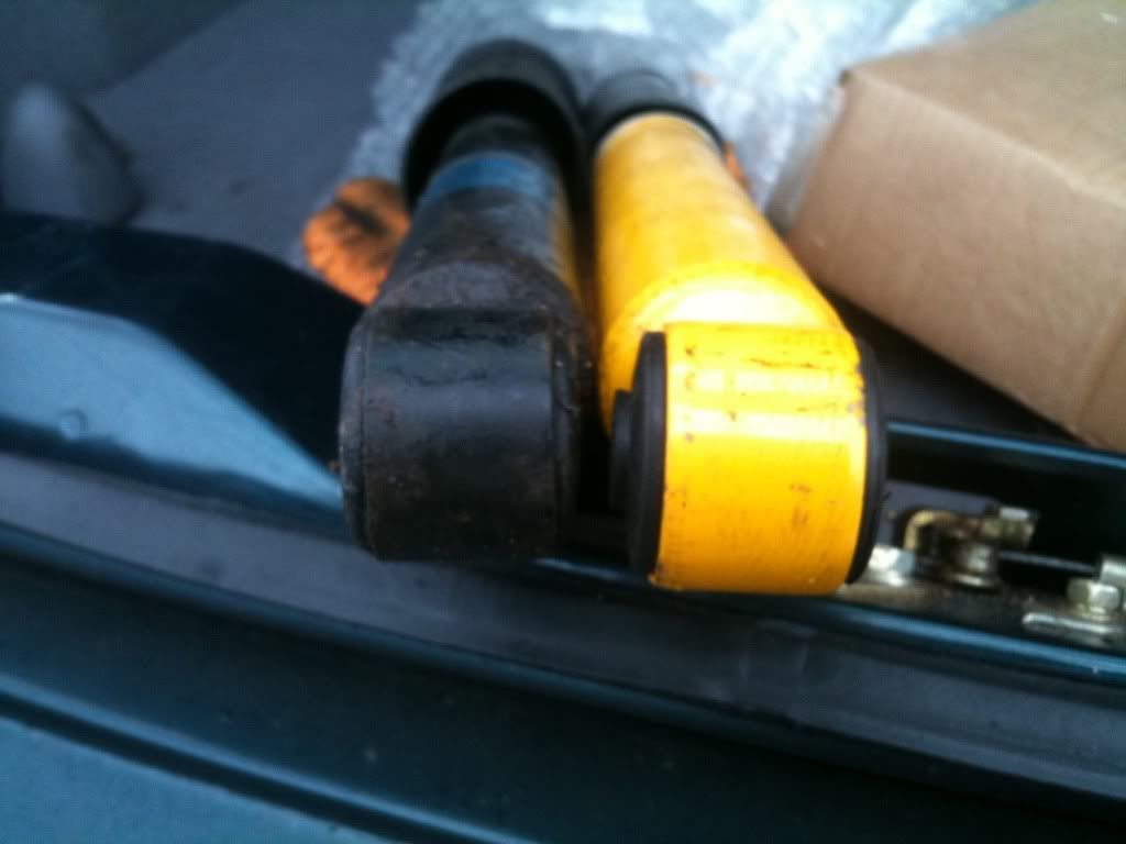

how close a match the bolt holes are

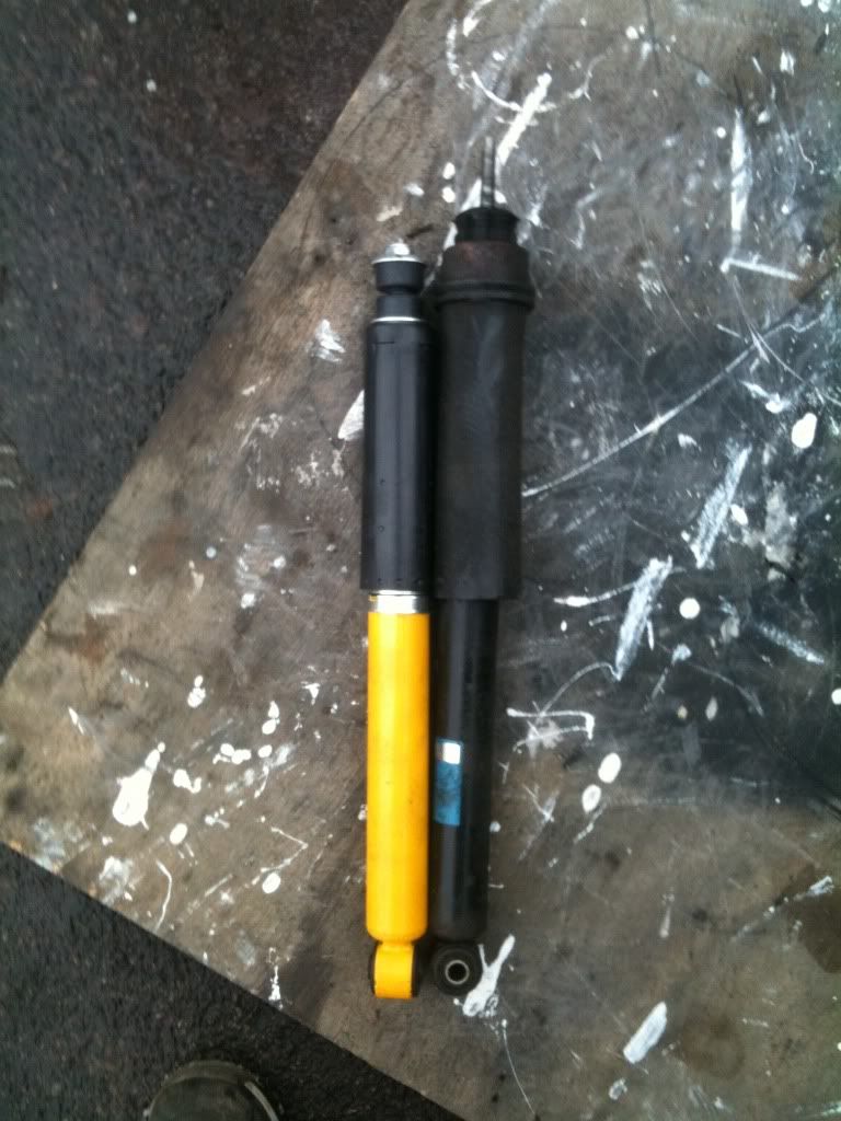

how much shorter they are

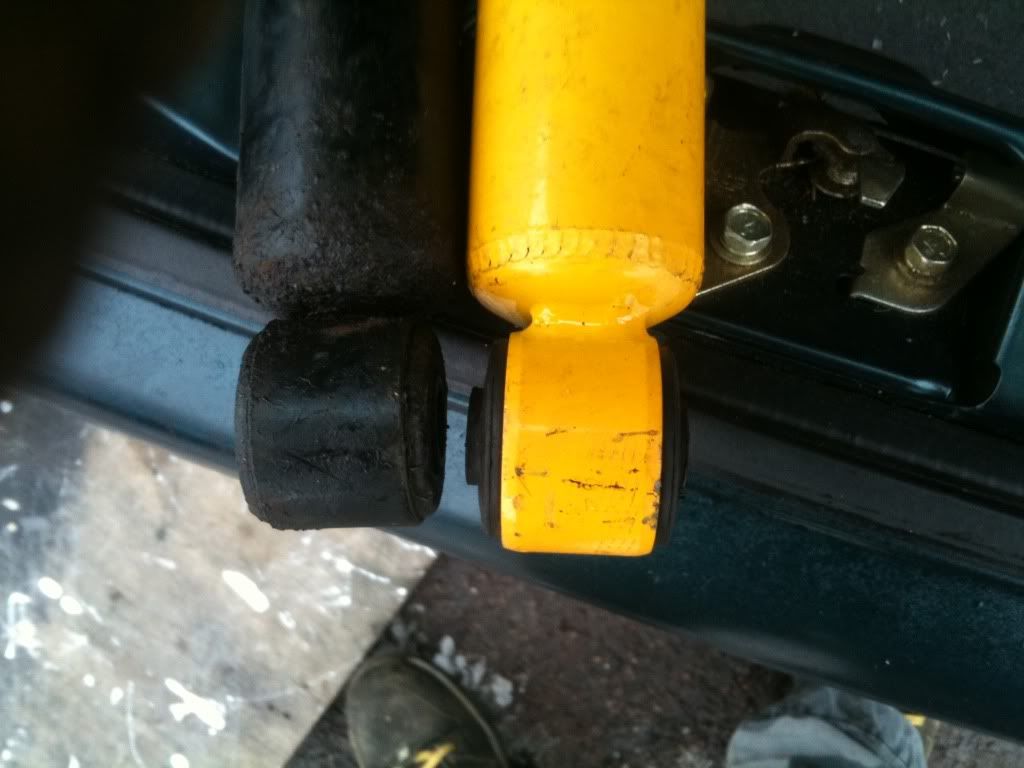

size difference between the micra (black) and corsa (yellow) rear struts
on this one \/ you can see how much wider the bottom of the corsa rears are, they'll need grinding down and the mounts need widening when fitting and smaller bolts as the corsa rears have a smaller diameter bush

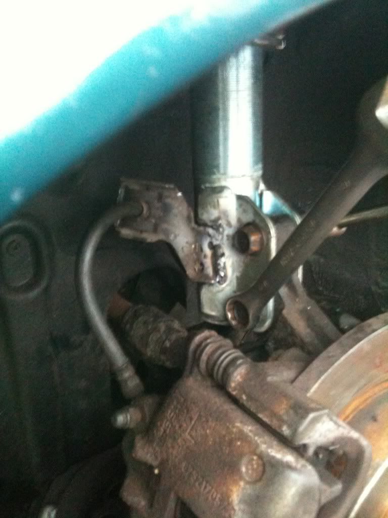

brake hose mount welded onto c/o

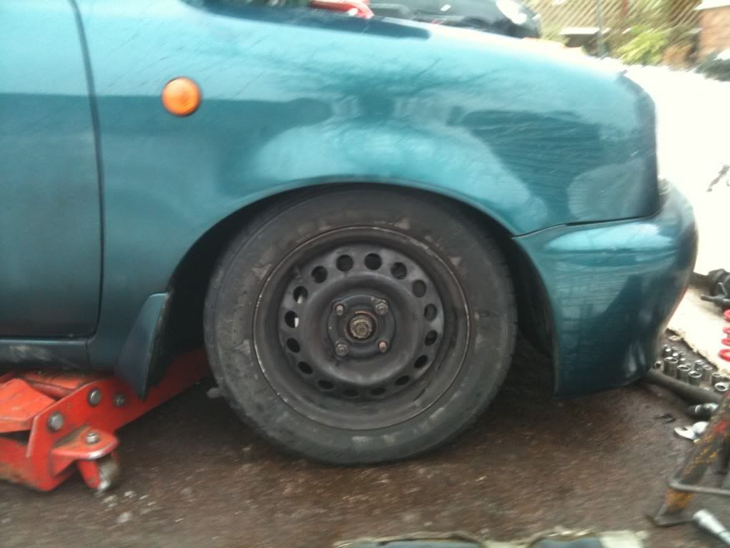

I'll get a pic of how it's sitting in the morning tried earlier but the pic came out really dark :down: the rear is a little higher than the front but I like it

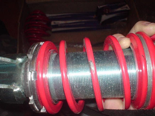

U can up or down the front when u want its an coilover ?
they,re not really height adjustable mailys, you can gain a bit of height if you increase the preload (tho that makes them even stiffer :eek:)
you could lower them about 30mm if you use the spring helpers (but i doubt you will want to lower these tho lol)
polly p,s are true height adjustable ones, where B is the height adjusting collar, and A is the preload adjustment eh
