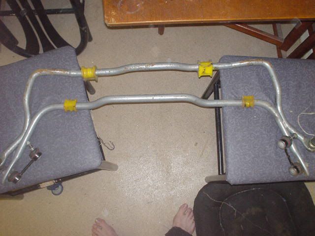

a little present arrived today, hopefully the weather is bearable at the weekend so they can be fitted...
22mm both ends (Y)

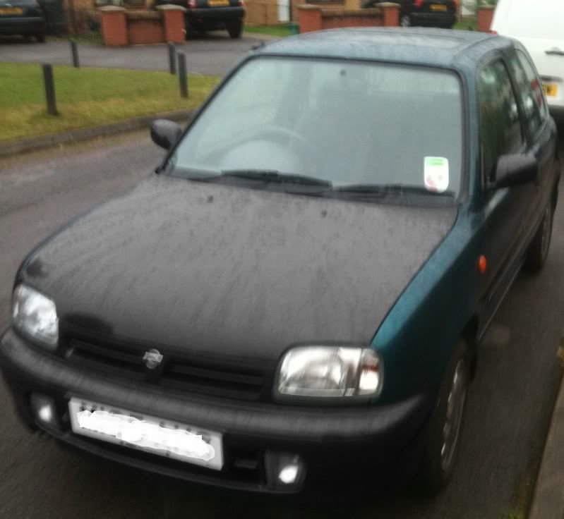

and Shaun's photoshops
lowered
de-colour coded
pink jdm goodness
using the photoshops Shaun did for me i had a little play on paint.....
opinions gratefully appreciated (Y)
I'm a little lost as to why you would want to de colour code the bits people want colour coded??
The super s and sr look better IMO as they are 90% colour coded bar rear handle and Door handles
Loving the the wheel idea pure jdm tac :)
Do the bonnet not the bumpers plleeeeeeaaaassseee ?
What's the airflow mod? Spill the beans man ;)

It's for that reason I want to de colour code, the bonnet if a definite yes
Wheels don't look like tac do they?

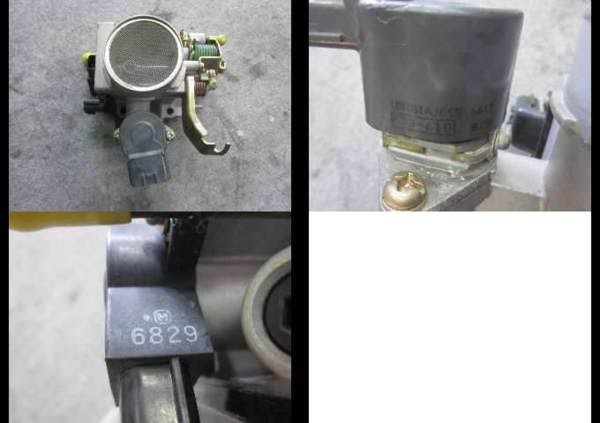

ok it's time to spill the beans and yes it will be an anti-climax...
it a GA15 throttle body, same benefits as a GA16 with one exception absolutely nothing needs modifying to make it fit (Y) just bolt on (Y)

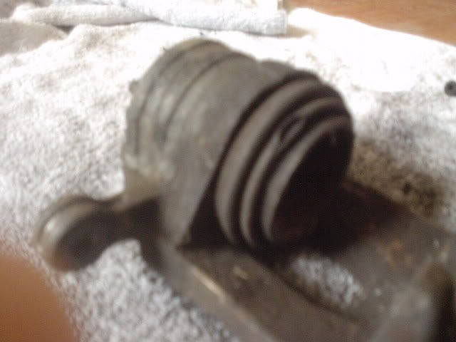

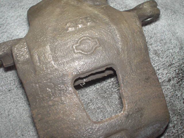

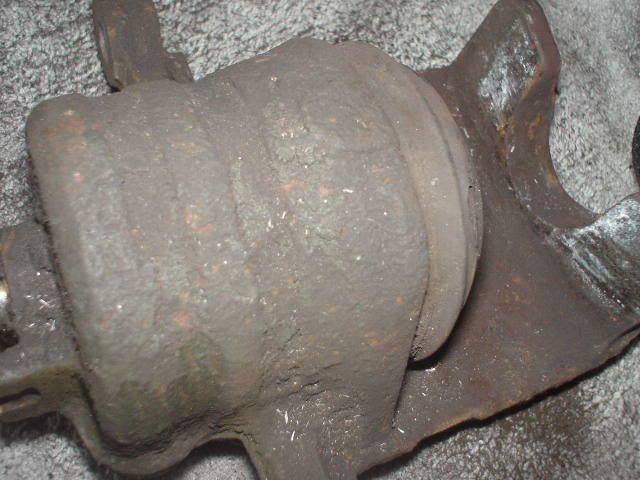

shopping done i thought i'd get on with cleaning my calipers
before...
after...
then hang on what the hell..... looks like the rubber has had it grr...
what do you guys reckon do i need a new caliper?

no, just a rebuild kit off ebay
cheers pollyp.. don't remember seeing any though
does the 100nx and almera share the same brake calipers... cause i couldn't find a repair kit for 100nx but i did for the almera

differences in the throttle bodies is the inner dimensions the cg is 40mm (i think) and the ga15/16 is 50mm also there are differences with the MAF (but i dont know what they are)
the CG,s are 45mm eh karl, so your GA 15 one is over 20% bigger iirc :cool: and is it the only one in the country ?
