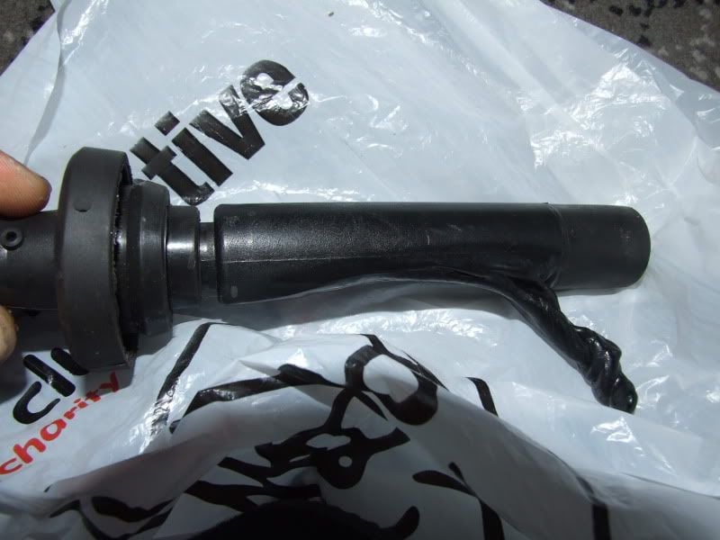

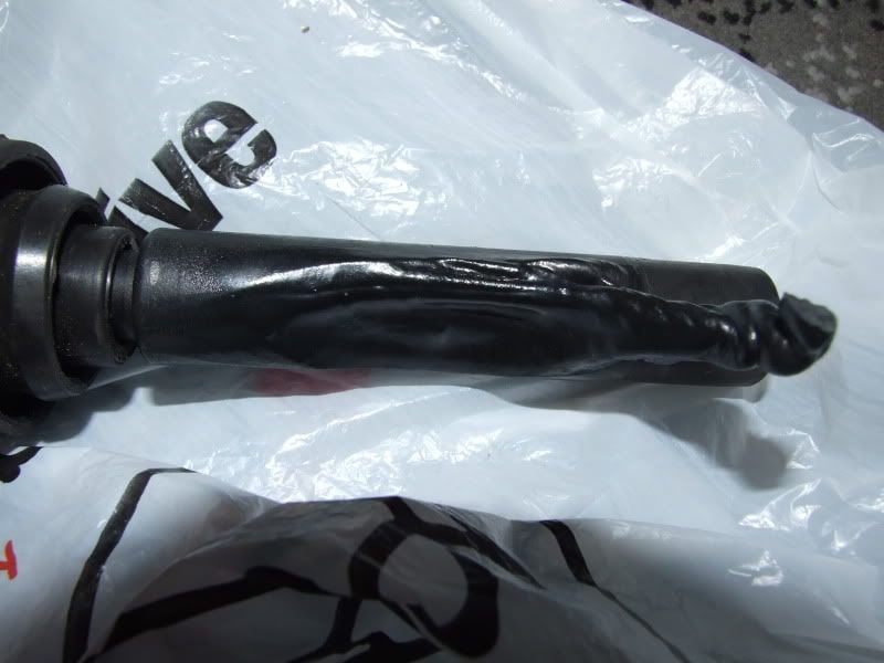

Took it for a run today and noticed that when i use any boost the engine splutters and misfires slightly, having looked at the spark plugs and HT leads i have found this on the magical 3rd cylinder:
It has not melted all the way thorough the insulation but i may find this is the cause of the misfire? i will see tomorrow.

Alright man ,
See those leads, throw them in the bin, they are not worth a shhhiiiteee!!
Order a set of Blueprint figaro leads,they are the best quality leads bar nissan ones that i have come across and they will fit the st, check the 4 plugs,if she's missing bad it can damage the engine.If the leads are melted they are ####. As regards the water bubbling in the expansion bottle buy a "sniff test" kit it takes a sample of you coolant and if it turns a certain colour that means there is conbustion gases in your cooling system and will diagnos the h/g failure. It should not have failed though

I know why the lead melted and was completely my fault for using the wrong leads.
