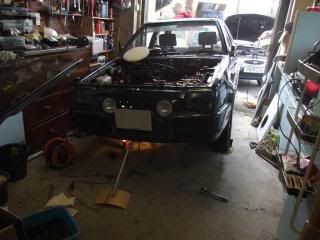

After a long time of iff'ing and arr'ing about bits i thought it was about time to see what work actually needs doing on the ST. so i decided to take the pistons out and check the ring gap on the new block etc.
This is what it was like before i started :D
I jacked the car up and secured it with axle stands.

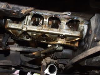

Then took the sump off and jiggled it free to expose the bottom end :D
I numbered all the pistons 1 - 4 and arrowed the front facing direction before messing with the big end bolts, undid these and slid the pistons out the top leaving the shells in the correct sides of the big end and put the bolts back in loosely. (The rings on piston 3 where the cracked block is looked fine)
I then tried the top piston ring to check the ring gap on the honed block, the haynes says the top ring should have between 0.2 - 0.3mm ring end gap and across all cylinders i got between 0.4 - 0.5mm which i don't think is good, so i think the engine work i.e. sleeving will definitely need to be done. I am planning of ringing around tomorrow :D

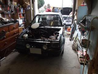

Ok so i have now got the engine out, and done my back in so i will be doing as much as possible that does not contain any more heavy lifting. :D
Cant believe how flimsy the flywheel is, just looks like a piece of tin with a ring gear on, glad im replacing the oil seals too as there was some 'oil fling' marks around the flywheel where it looks like the crankshaft seal has been leaking slightly.
