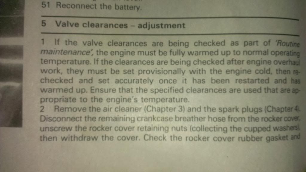

Not sure if you know procedure so........
