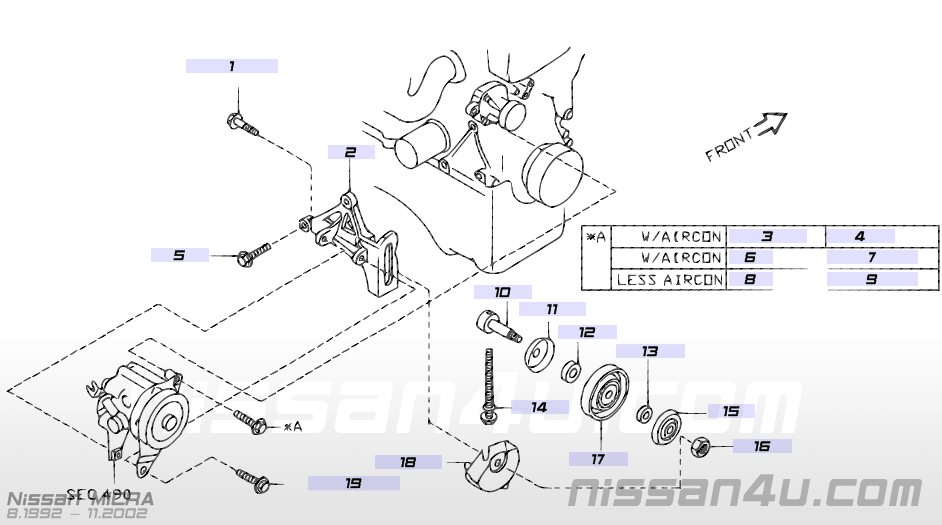

Ball bearings need to be packed with grease, all wd40 will do is flush what little grease there is left in it out and accelerate wear. If it's a sealed bearing then just replace the bearing.k tonight its been squealing constantly warm or cold, needs fixing.
sprayed wd40 behind the waterpump pulley, no change.
sprayed wd40 on the tensioner pulley axle, gets quiet briefly but then few yards down the road to squeals again.
so removed the pulley and oiled the bearing with thin wd40 rather than thick engine oil, reassembled.
its running alot quieter but can still hear a very faint amount driving through the streets.
I think both belt tensioners actually need replacing

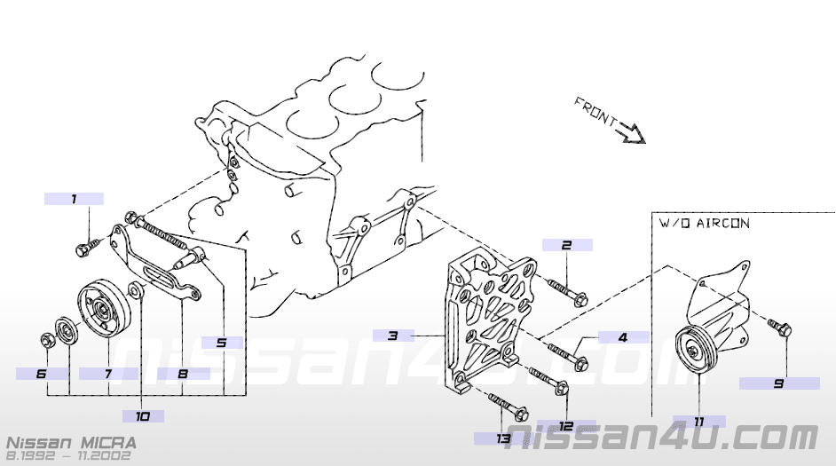

You won't need SKF bearings, they're so expensive because they are made to ridiculously tight tolerances for CNC machines and the like, the bigger one even have a little laser engraving to mark the point of maximum eccentricity!so here's an auxilary belt idler pulley
first grind off the 2 rivet lips on both sides that is holding the pulley together
then split the pulley apart
push the bearing out the other cap
the bearing is an SKF 6301 2RS1
37x12x12mm
took the alternator idler off to check if that uses the same bearing too
the pulley
that uses a NSK 6301DULX
and appears to be exactly the same
so I need two 6301 rubber sealed deep groove ball bearings
looked at simplybearings.co.uk and they have a budget 63012RS for £2.69ex vat
9.7kN dynamic load, 4.2kN static load, 20k rpm in grease
http://simplybearings.co.uk/shop/p1...ove+Ball+Bearing+12x37x12mm/product_info.html
they also have the genuine SKF 6301 2RS1 for a whopping £25.68ex vat!
but only handles 8.19kN dynamic, 4.05kN static, 14k rpm. why would I buy this one?
was thinking of getting it at the local bearing shop tomorrow at lunch but don't have the time to drive around tbh so gonna reassemble these pulleys and order a pair of budget bearings to be delivered soon and then just replace em.
£8.26 for two bearings delivered, not bad compared to £30-60 for one friggin pulley from anywhere else.
