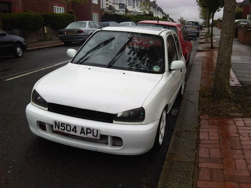

Here are the pics of my new car :D

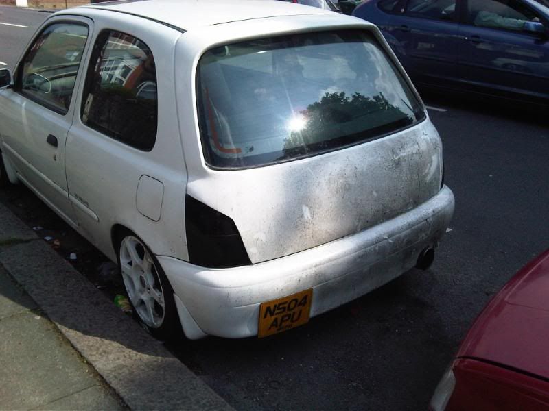

Reason for the black dirt on the back, it had a blown turbo before, so that was caused by that =/.
It was on pistonheads, its my friends old car, i needed something as a first car, so i decieded to buy it off him. Fixed the turbo now though, But it still smokes a bit...but only when after boosting when slowing down =/

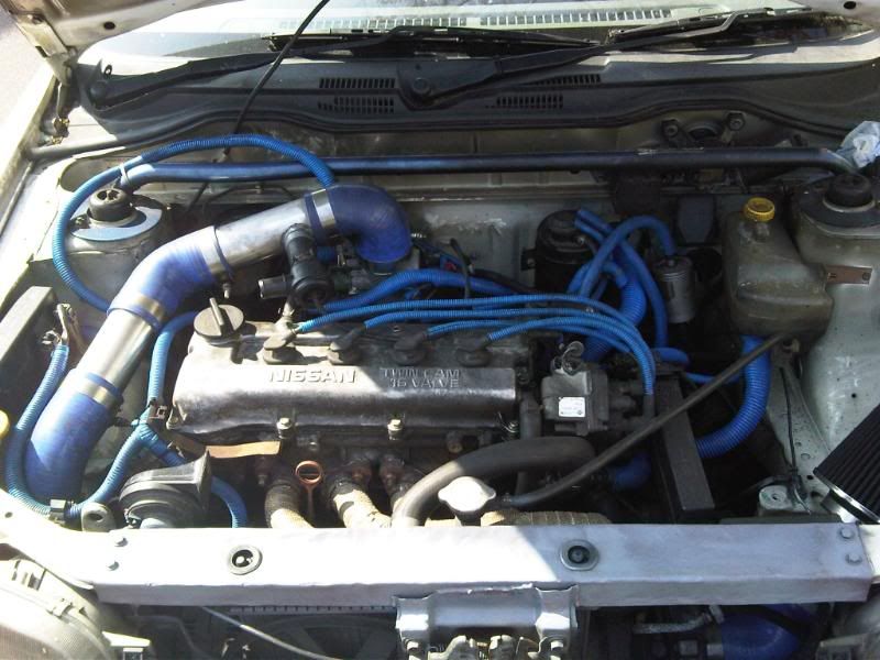

Was looking around in the micra, when driving normally no smoke what so ever,only when i boost it...confusing, also just found out, i thought it was running on 2 psi, but when i boosted it, it went to 8-10psi...O_O..THAT worried me....but when i swear it was on 2psi, when i set the boost controller, it set it two...any idea why it would go to 8-10psi when driving??...

if it's smoking on boost I'd say the only reason is the Turbo is a little shot.
What engine management is the car running and what BHP?
Has the turbo got an internal or external wastegate? I'd look at this for the boost pressure!

It has a normal dump valve, its over boosting in my eyes, really worrying tbh.

You are hitting 8-10psi because this is the base pressure of the actuator, your boost controller won't allow any lower pressure than the actuator base level. What colour is the smoke?
That sounds about right i guess, the smoke is blue-ish white. I guess i'll just not boost it too much until i can get my hands on a proper turbo....but yeah, need to sort this problem out fast...since driving it knowing there is a turbo but cant boost is sad :doh:
