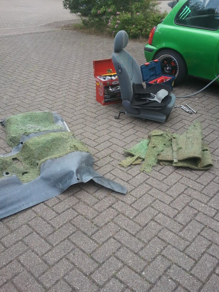

How much weight did you save by aircon removal, mate?

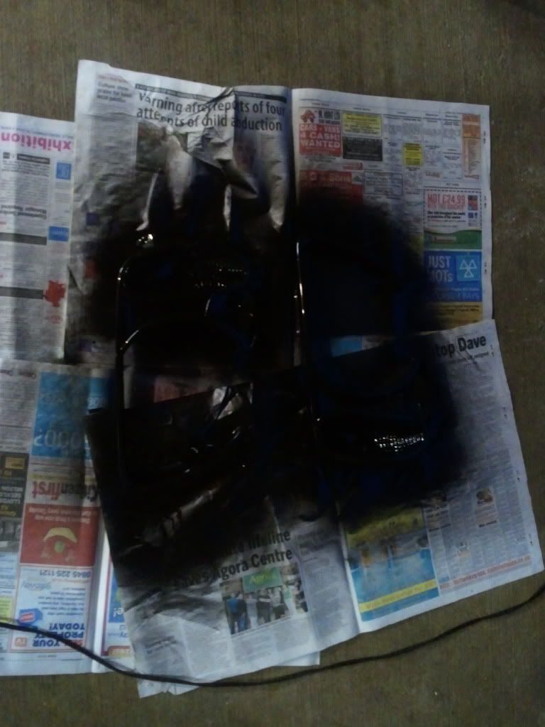

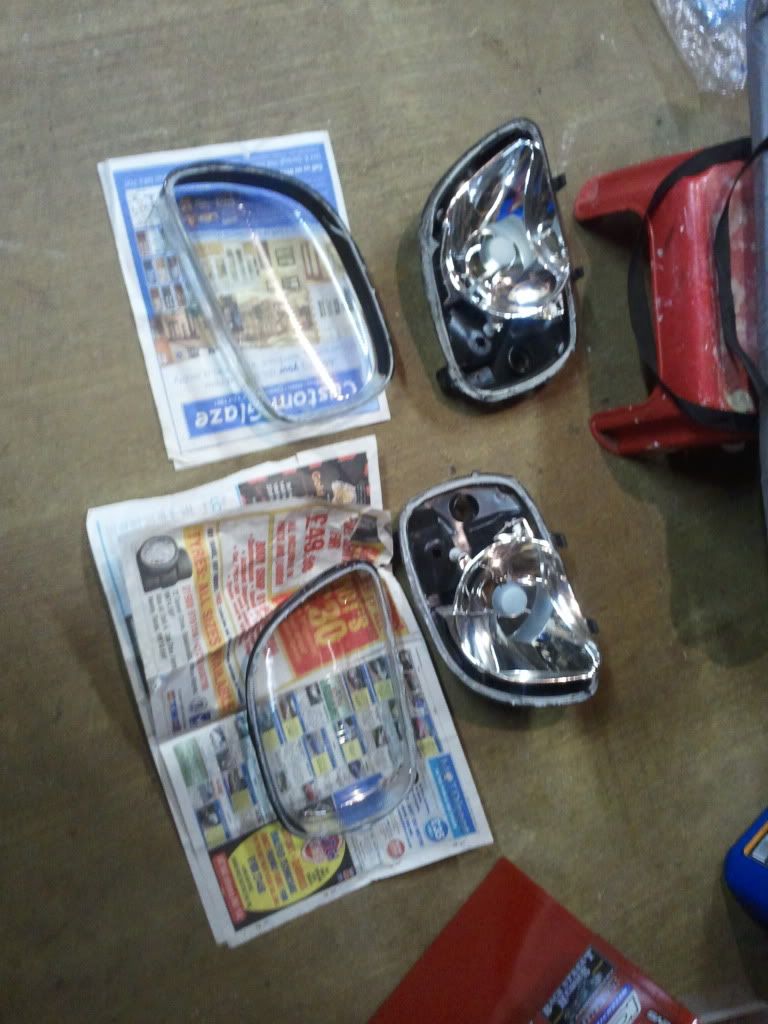

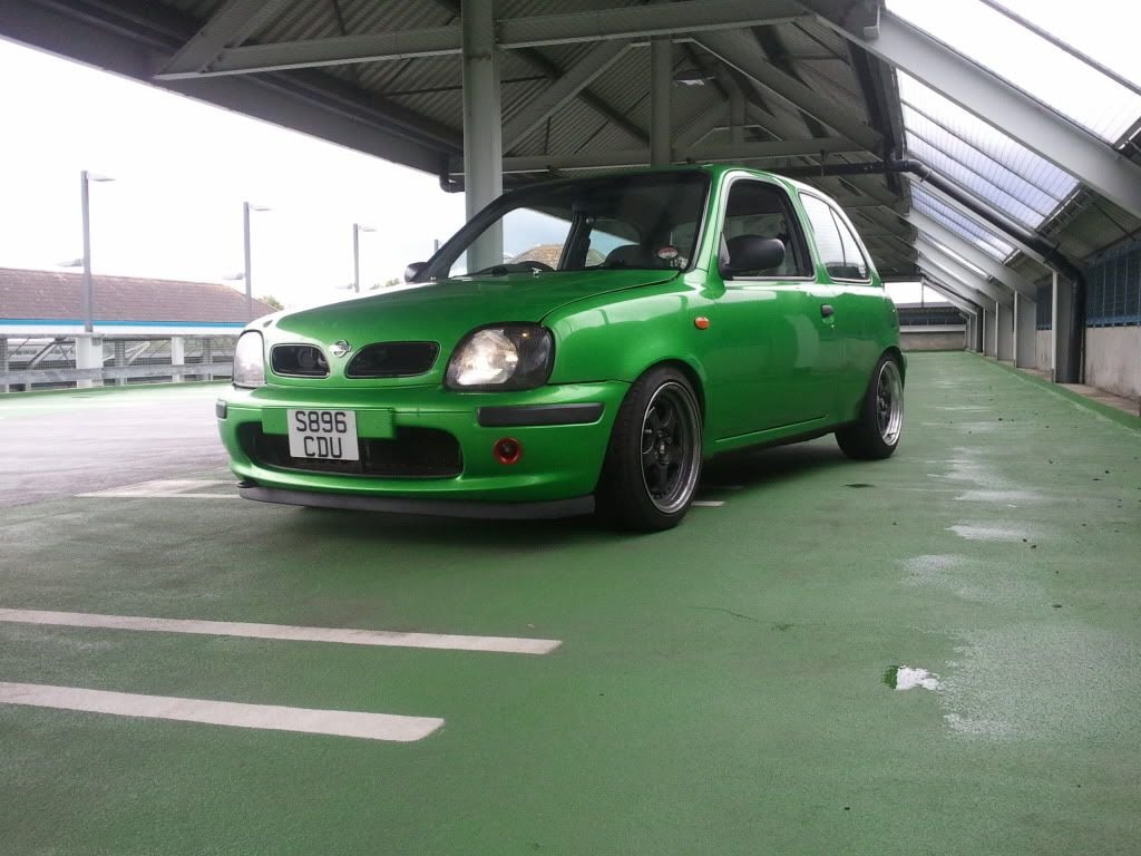

Finally got round to respraying the inside rim of my headlights - had the can of black spray paint hanging around at the bottom of my toolchest for about a month :laugh:.
Had mixed comments on it - some good, some bad. Opinions?
Took me about 10 minutes to seperate each light - I know they're supposed to be watertight, but that glue is STRONG. Especially when all you have to heat it up is a #### hairdryer.
Always seems like most of the paint goes on any surface other than the one you're trying to spray - in my case, the local rag.
Finished spraying, just leaving them to dry overnight. Covered them up with a box, didn't want flies or moths commiting suicide by landing on the wet paint :glare:.

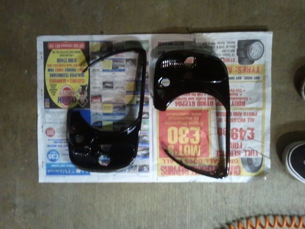

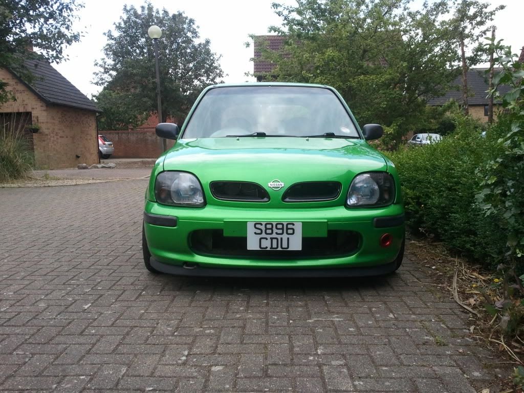

The finished product :grinning::grinning::grinning:. Really pleased with how they look, especially with the black grills.
Probably should have saved enough spray paint to do my Nissan badge. Oh well, maybe next time :grinning:.

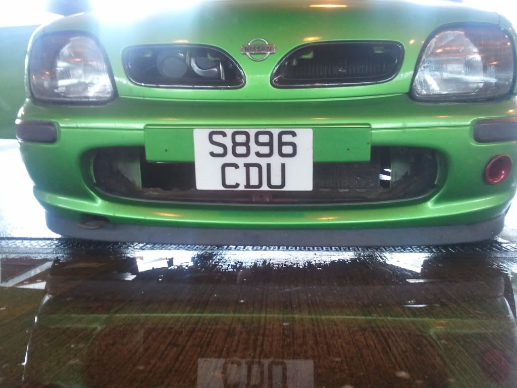

Looks effing nice dan!!!!
i'll have the spoiler for that price![]()
cheerson ebay they're 60 inc p+p :0 i say no no no, do you know where you could get another front bumber like yours? my scrappy does nae have one :l
Lights are looking good, especially with the grills, I've not been too sure whether to do mine or not but these are making me want to do it(Y)
How has the sidelight and indicator been affected due to black paint, as most other ones I've seen haven't had those bits painted?
Can it be done on pre facelift?

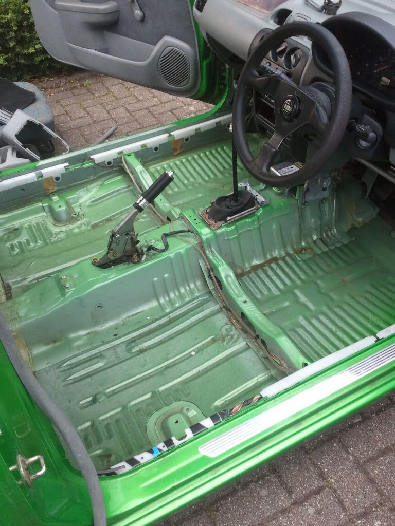

omg, that's a big job
Why would you want it louder inside?!?
I'd love to really SOUNDPROOF mine![]()

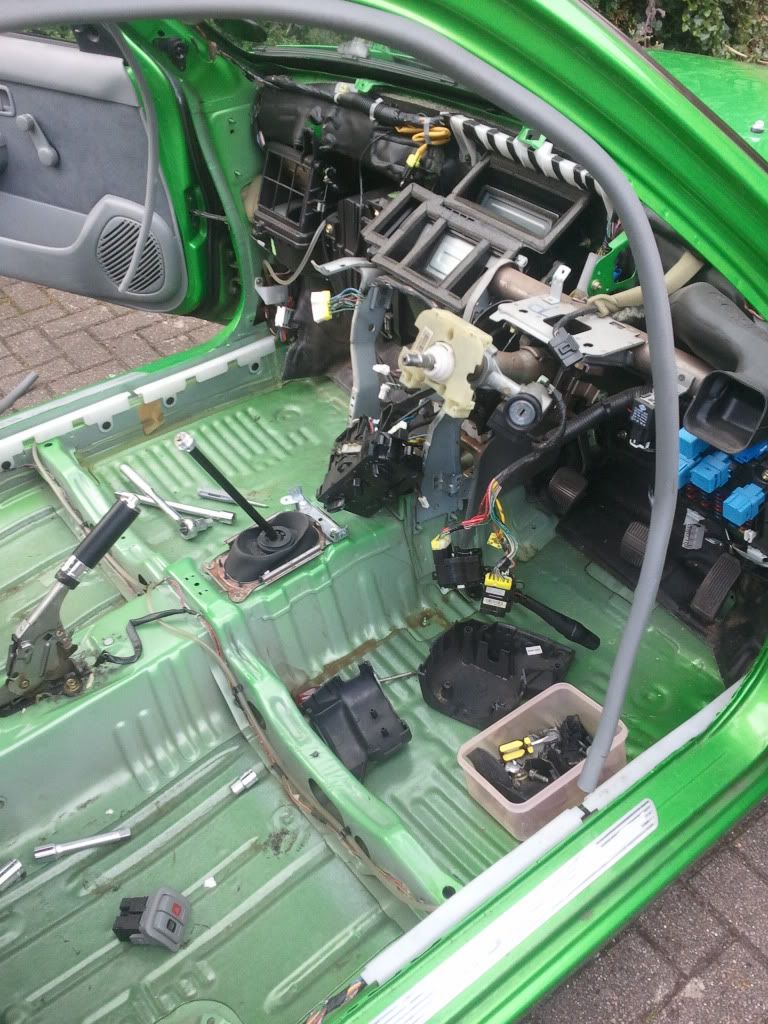

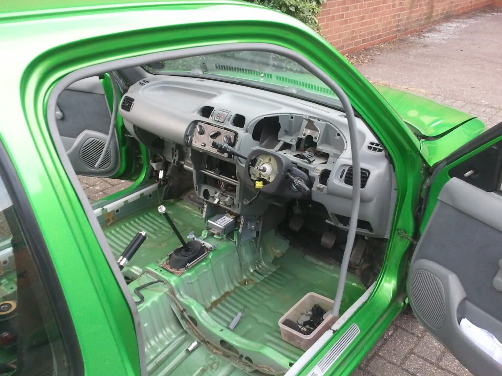

i suppose you could also strip out all the airbag equipment like the ECU etc, that would save a bit of weight
I've stripped out the airbag when I fitted my Momo steering wheel, but I haven't taked out anything from under the bonnet or anything like that
no there is nothing for the airbag system under the bonnet, but there is that box in front of the gear stick that won't be doing anything now. every little helps.
oh and if you want to go through the nightmare, you can take out the entire loom and strip about 2.5kg of stuff from it, but you have to know which wires to take out, and its all covered in glue too

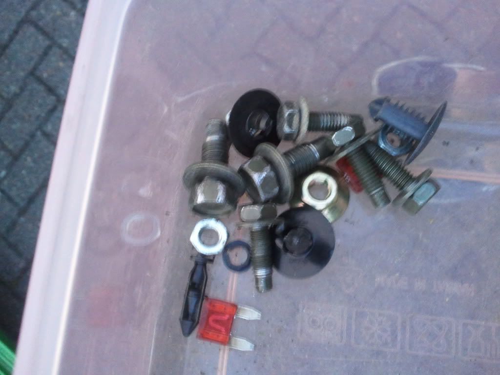

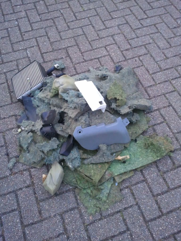

(Y)(Y)(Y)(Y)(Y) Fantastic!!!No, I've kept all the interior in, I kind of wanted it to be user friendly and an everyday car. If I completely stripped it out, it would be too loud. I wouldn't be able to hear myself think! I did weigh the 2 bags of stuff I took out, was about 5 kg. So I've probably saved about 15 kg along with the aircon removal (Y). I want to get an SR next year, I'll be completely stripping that out and turing into a track car - roll cage, bucket seats, 4-point safety harness, no stereo/speakers, no aircon. And making it as fast as possible without a turbo :grinning:.
Not sure if you have binned it yet or not, but I retrofitted an aircon system to my '96 GX and the only thing missing is the wiring harness parts, which plug into the back of the fan controls, (small white 3 pin connector), and the rest of the loom which runs into the engine bay and hooks up to the receiver/dryer pressure switch, aircon compressor and power relays.
Also I wouldn't mind knowing if the evaporator matrix has a thermocouple attached to it or a thermo control amp bolted on the side, as there seem to be several revisions of how Nissan hooked the aircon systems up depending on factory or retrofit options, as shown in the service manual.

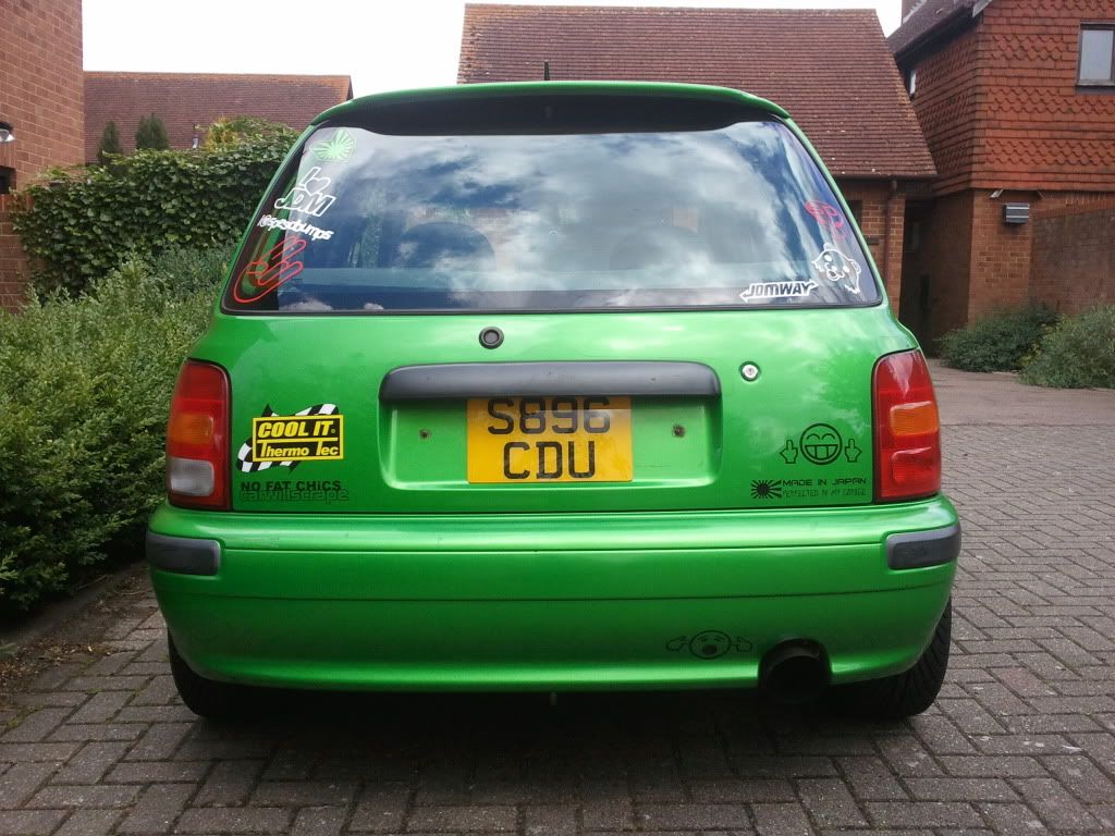

Dont fit a rear splitter please. They look ridiculous and will only cause drag!!
Honestly ive seen micras with splitters/skirts all round and nismo arches, jap plate recess and rare spoilers and it just looks a mess! Maybe its just me who loves a subtle looking micra.
Looking good dan but I'd get that plate down in the corner and smooth the old number plate holder away
