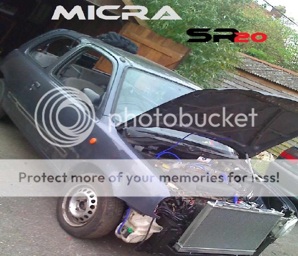

Brought the k11 for £125 off a mate in work. Since then i have done the following mods:
-Brought a window wrap spoiler currently needs paint finishing.

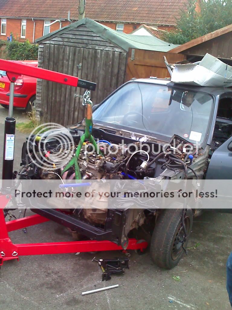

-Fitted an sr20de engine from a 1998 Almera gti on 60 000m

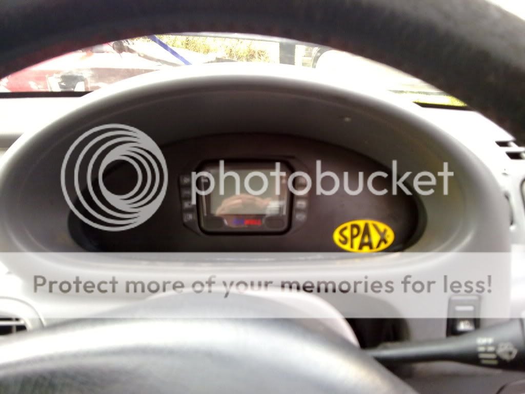

-Brought and fitted an acewell kit car dash
-100nx front brakes with green stuff pads and grooved disks yet to be fitted.

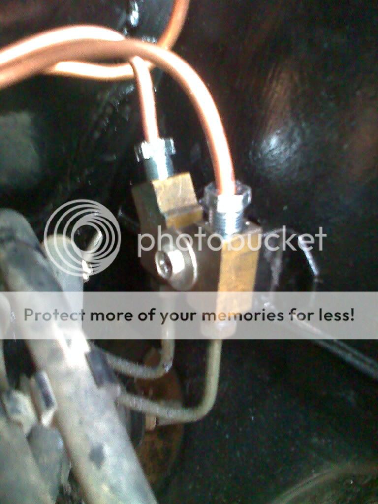

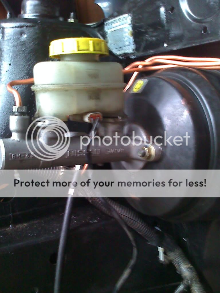

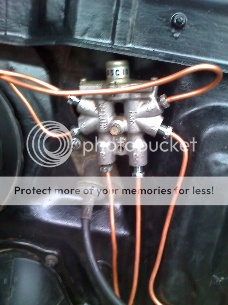

-Fitted much bigger brake servo and bias valve.

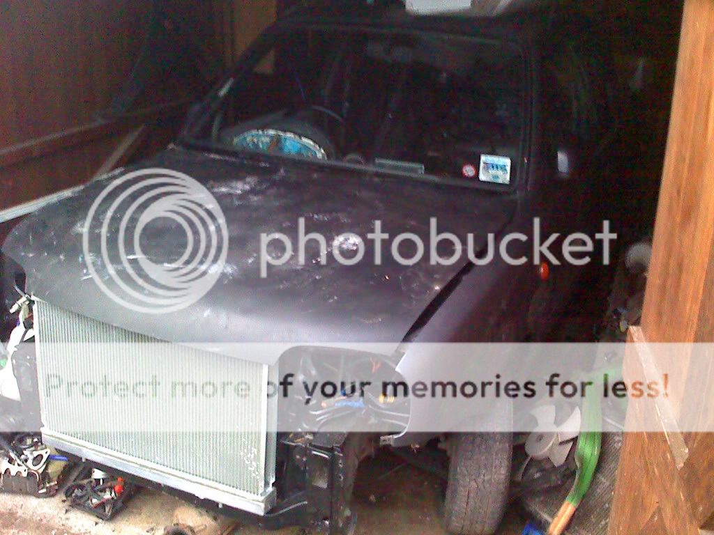

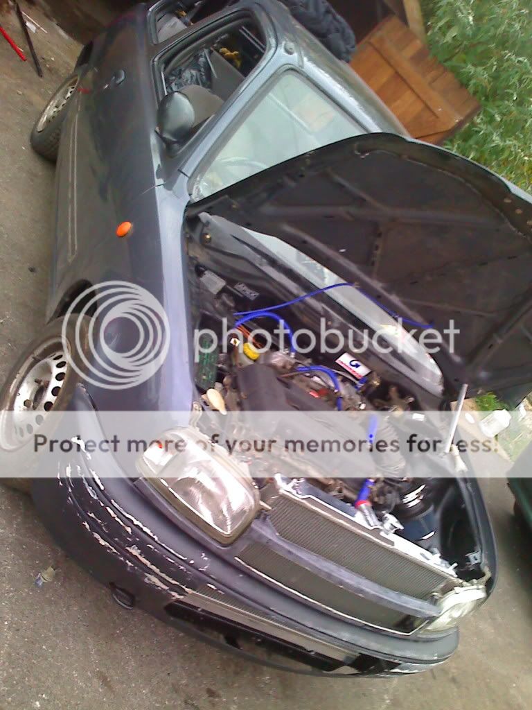

-brought a 700mm aluminium rad
-brought a 16'' slimline rad fan
-converted battery into the boot
-modified standard bumper and grill for extra cooling
-multi spoke 15'' wheels with 205 tyres not fitted yet but going bright orange :p
-Fitted goodridge electric blue braided brake lines

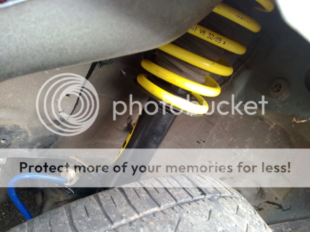

-Apex 35mm springs with spax shocks

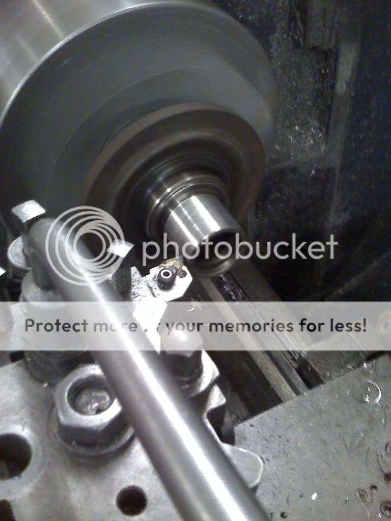

-custom hubs to fit into micra carriers to accomidate sr20 shafts
-high pressure fuel pump
-Stage 2 clutch kit
-Almera gti steering wheel
-full st/st exhaust system from block to tip with no cats or boxes other than back box.
-Removed p/steering pump - abs pump and aircon.
-currently working on the air intake.
-underside of bonnet had to be gutted out for the rad to fit so now using bonnet pins to hold it down.
-only couple things left to buy inc. panhard rod and anti roll bars.
-driveshafts will be prototyped on saturday, by this i mean i am cutting and welding to check size and test car functions with a small SLOW test drive. Then getting new ones made.

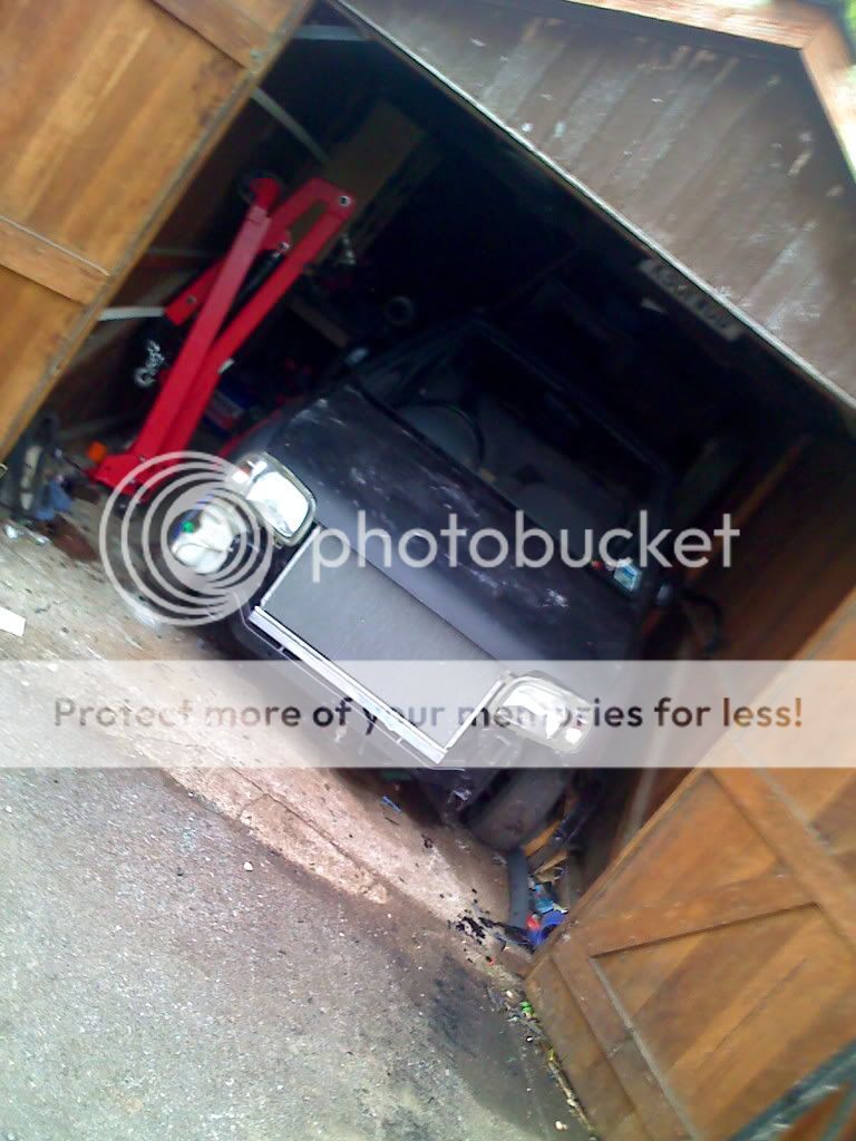

Heres some pics. Let me know what you think and any ideas or parts i may want the let me know!
Planning to be finished in January.

This looks Ace, want to see it in person. Where did you get this Digital/LCD Display from?

How come you didnt just just a standard almera GTi rad? That one is huge! Looks a bit exposed behind the bumper too.

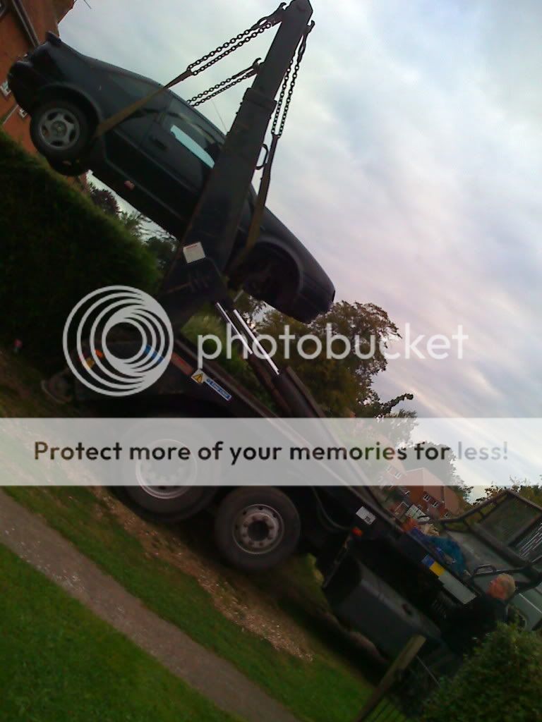

Yea ive used the same engine. i know its history and its just piece of mind really, Heres a pic of the NX going to its new home :(
I got the rad mainly because i needed a replacement. Didnt relize it was such a beast until it arrived.. ill check the sizes next time :grinning:
