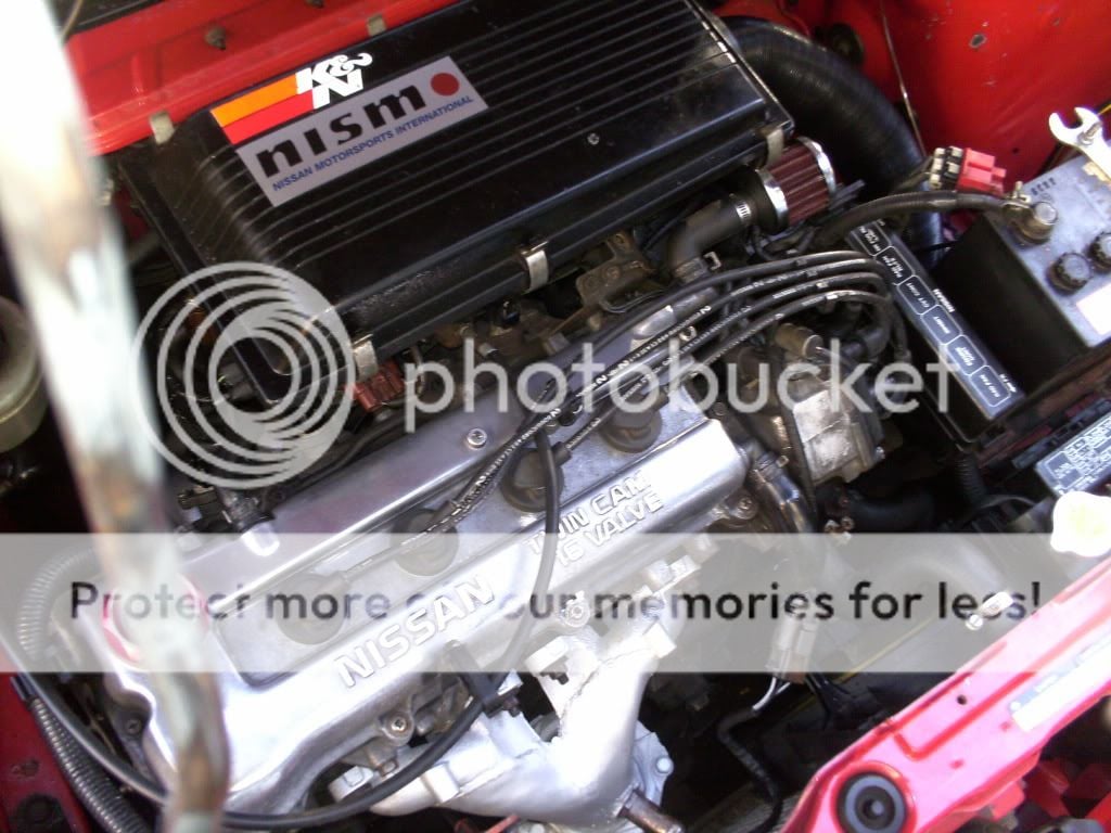

I Was out today down country roads, motorways etc. I Decided to see how well my cold air set-up worked by feeling how cold the filter was afterwards. It was very cold exactly like the outside air temp. So it works pretty damm well!

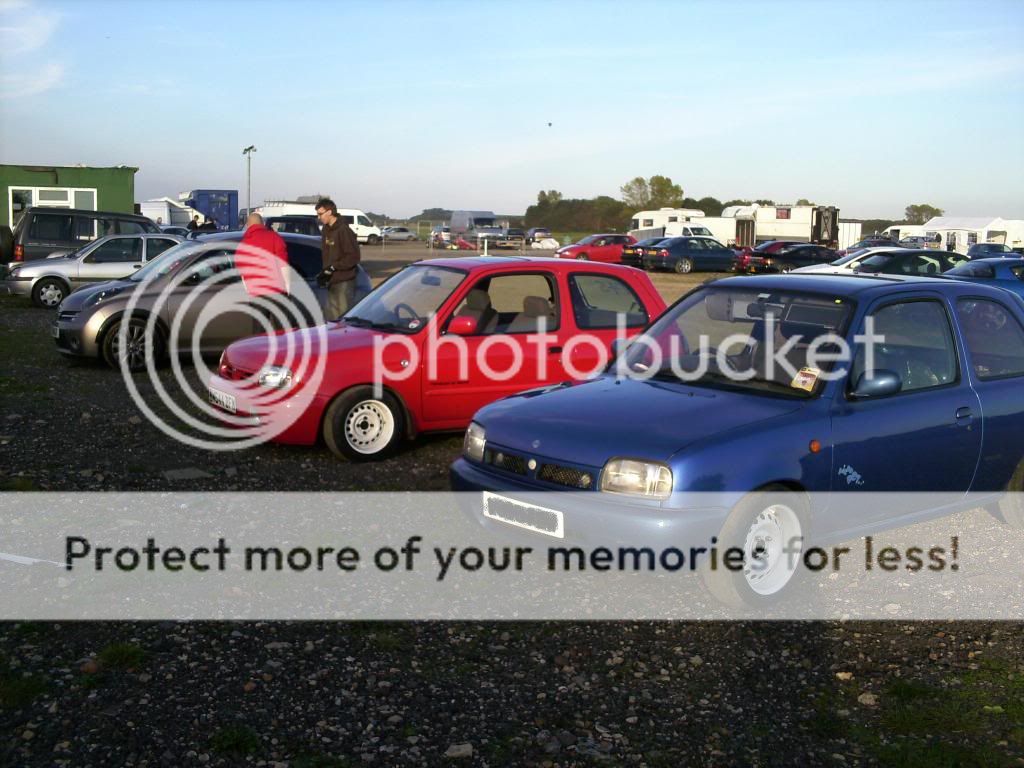

Im sure you all know whos the the blue car is !!
The K12 is Dragonmasters

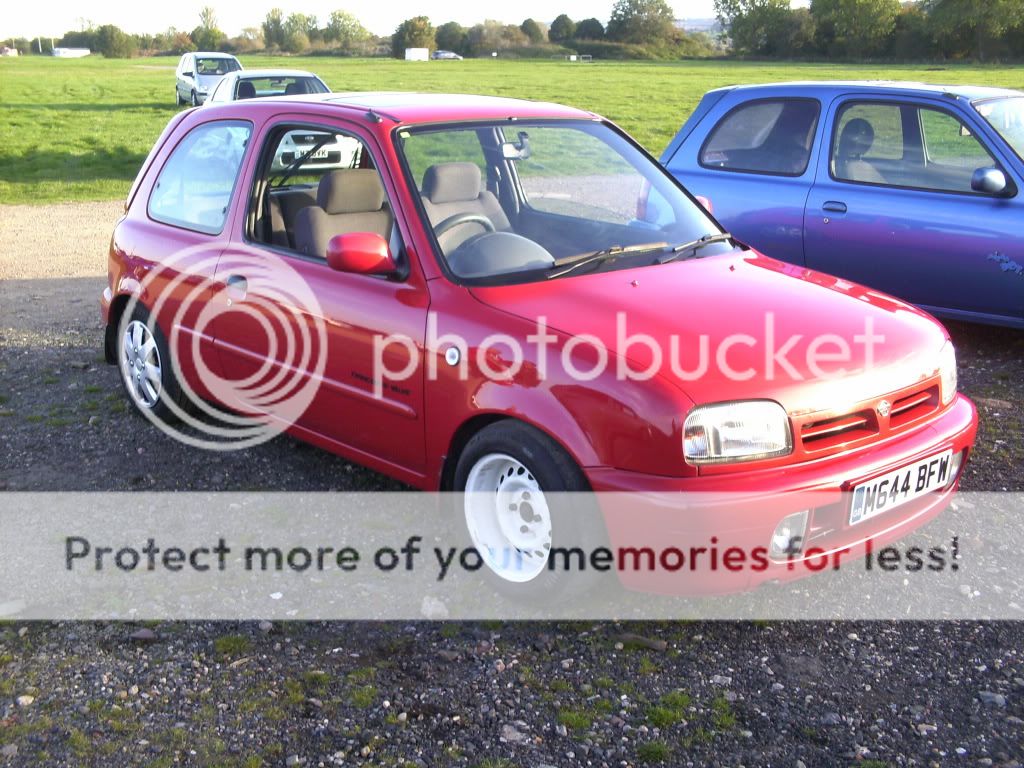

I love the stance of your car mate, how much have you lowered that by. That will be my desired height
(Y)
cheers buddy, My brother lowered it when he had the car a couple of years back. It was meant to be a 35mm drop however Frank says that the springs are from a K10 not a K11 therefore it turned out too be more. I think its about a 60 - 70mm drop.
:laugh: thats fair enough do you know if the k10 springs were standard springs or lowering? just looking for a cheaper suspension option at the mo

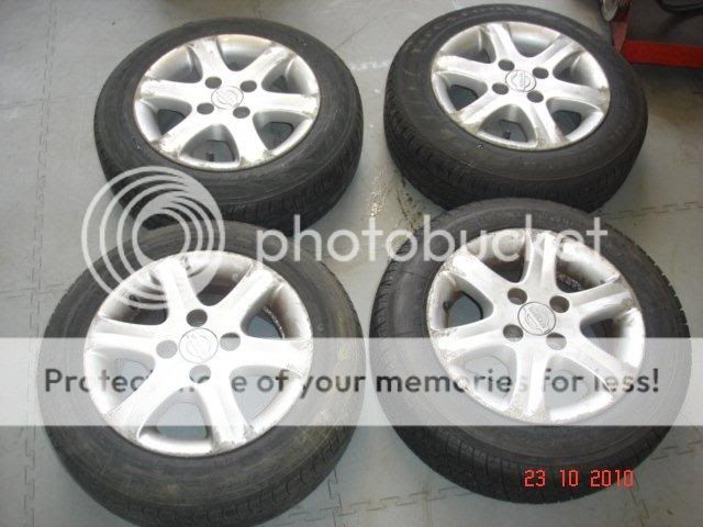

quick update, picked up some alloys for £60 of Matt H, he was kind enough to throw in some stickers and wheel bolts as well. Also had a look at his micras when I was there, They are the meanest micra's ive ever seen!!
anyway seeing as there quite scuffed Ive decided to give them a refurbishment, im going hammerite black again like did with the steelies. I will post up pictures when im done.

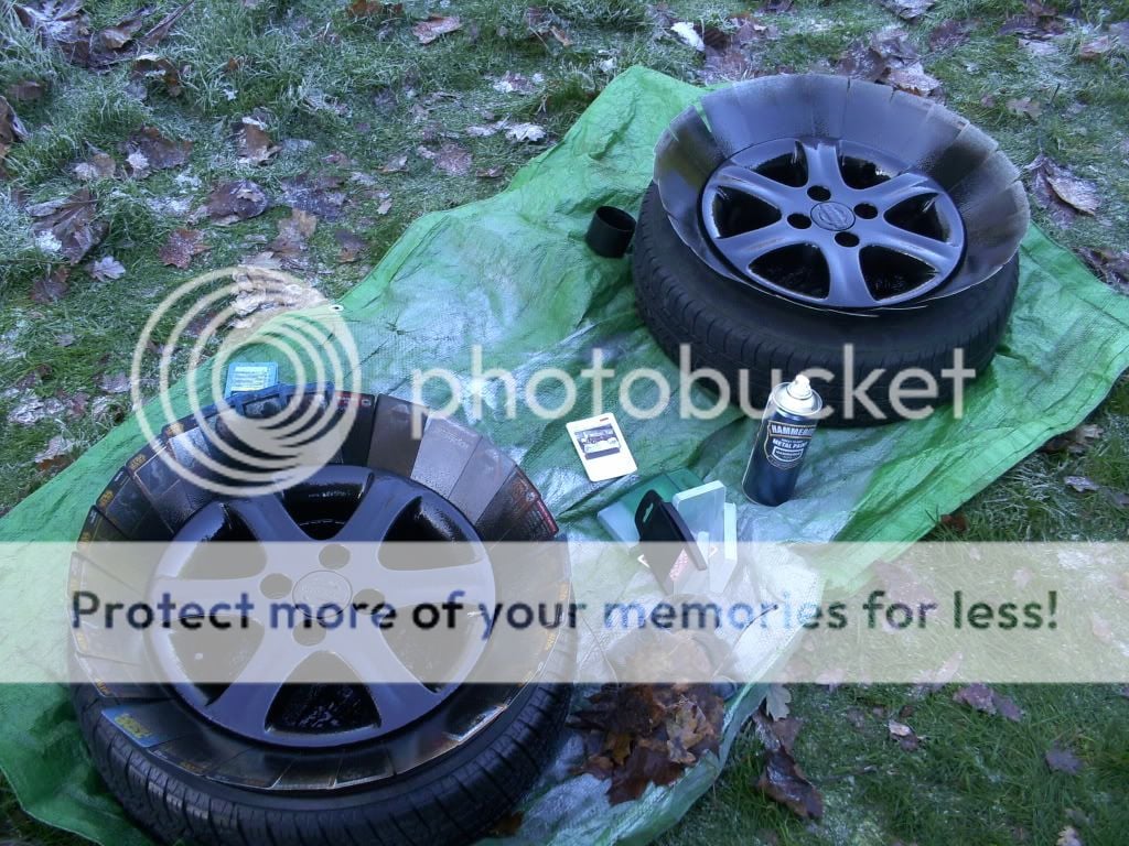

Ok guys, the wheels are painted, (I used the card trick again) im gonna pop to halfords to get some laquer and I will post up pictures later today!

they are still wet here (the paint came out the can all blotchy.), the plan is to leave them overnight, laquear them tomorrow then fit them. They might not be a perfect finish but they look better than they were curbed.

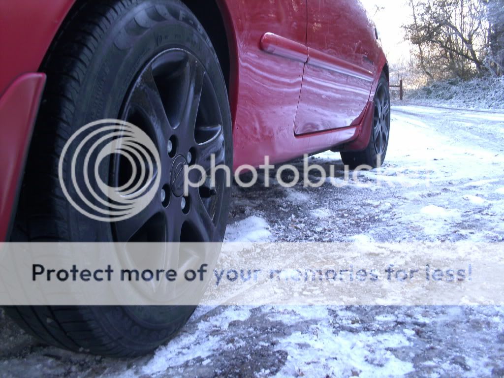

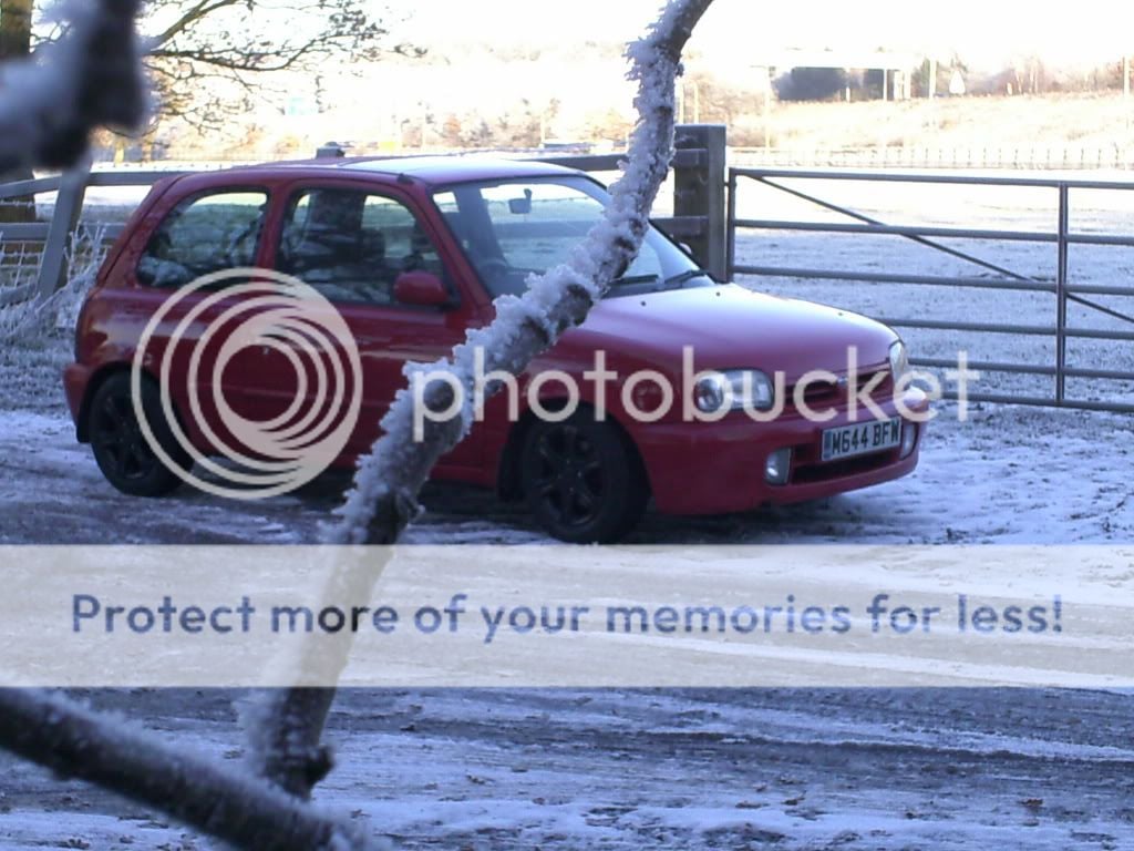

Painted Frankspeed
They actually look quite good mate. The cold weather dont help much when using cans thoughh, did you heat the can up first then mate

how did you refurb those wheels exactly? you just sanded them down til they was smooth then sprayed up then coated them with the laquer stuff?
wow loving the car
cheers buddy!
yeah sanded them down until smooth sprayed them with a hammered black hammerite spray can, left them for a couple of hours, then sprayed them with the lacquer, left them overnight and fitted them in the morning. (There are a few imperfections nothing major though) The most important ting is preparation and always always keep the can moving never stop in one place.
thanks for all the comment's guys! yeah its hammered black.
Thought so, can see the glittery effect it has. I have always found the hammered to be thinner than the smooth hammerite, which wont help with imperfections at all haa. Main thing is though it looks good
yeah, im very pleased with the outcome!(Y)
