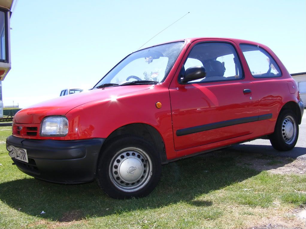

So iv finally got the new motor! (INSURED AS OF TODAY!!) Weyhey! Been waiting for this moment for over 3 months now! So here my new little baby how it stand right now:

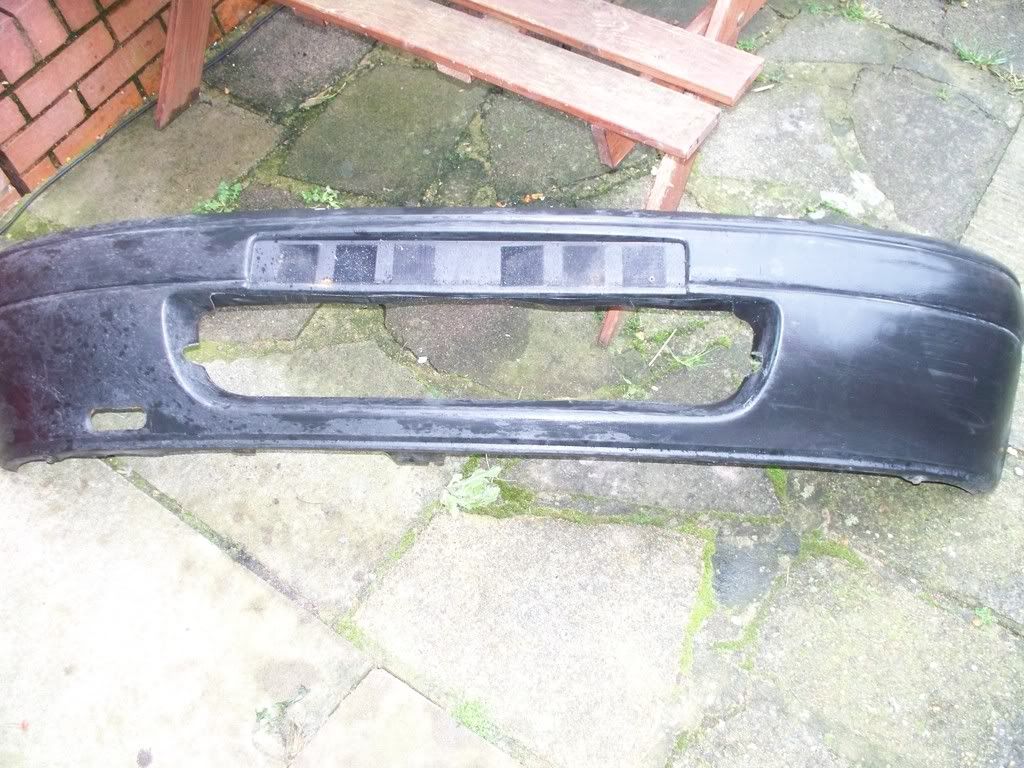

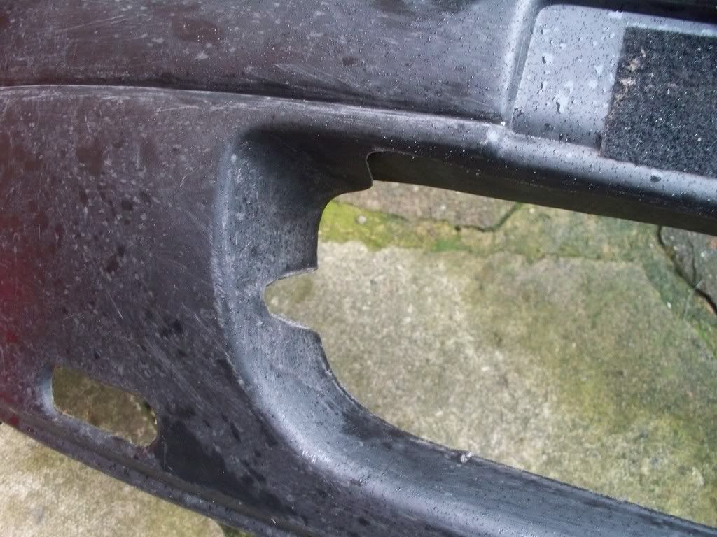

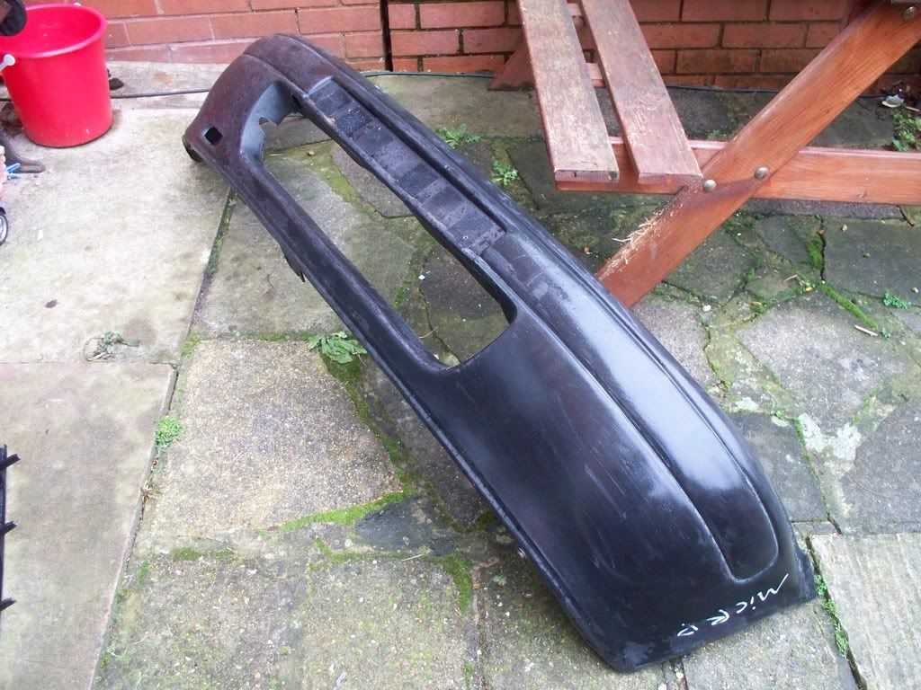

Hey everyone, Just a little update, i started making my Bumper into an open mouth style one today. Went pretty well i think, all i got to do now is, sand them down, filler, primer then paint, and with anyluck they will be looking good!
Just need a bit of advise though, im not to sure how im supose to fill the gap on the side of the oval, should i use fiver glass or something? or does some have a better technique??

^^Thats the little gap thing i was talking about :] ^^ Thanks again guys!
put somthing behind it i.e metal?, or somthing that wont ruin when wet, and use fibre glass then filler :)
Ohkidoki mate, not to sure where i would get the metal from....would it be ok to use mesh? i mean this will be my first time using fiber glass so i dont no if that would work??
looking good all i did with my bumper was melted a thin piece of plastic behind it then just bodyfilled it :D
Thanks for the advice guys, gonna do it tommorow, iv got the fiberglass and everything, so ill let you know how it goes. Pics shall be comming...

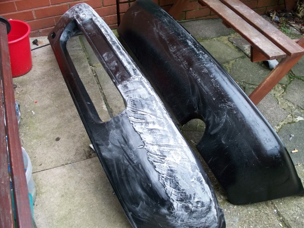

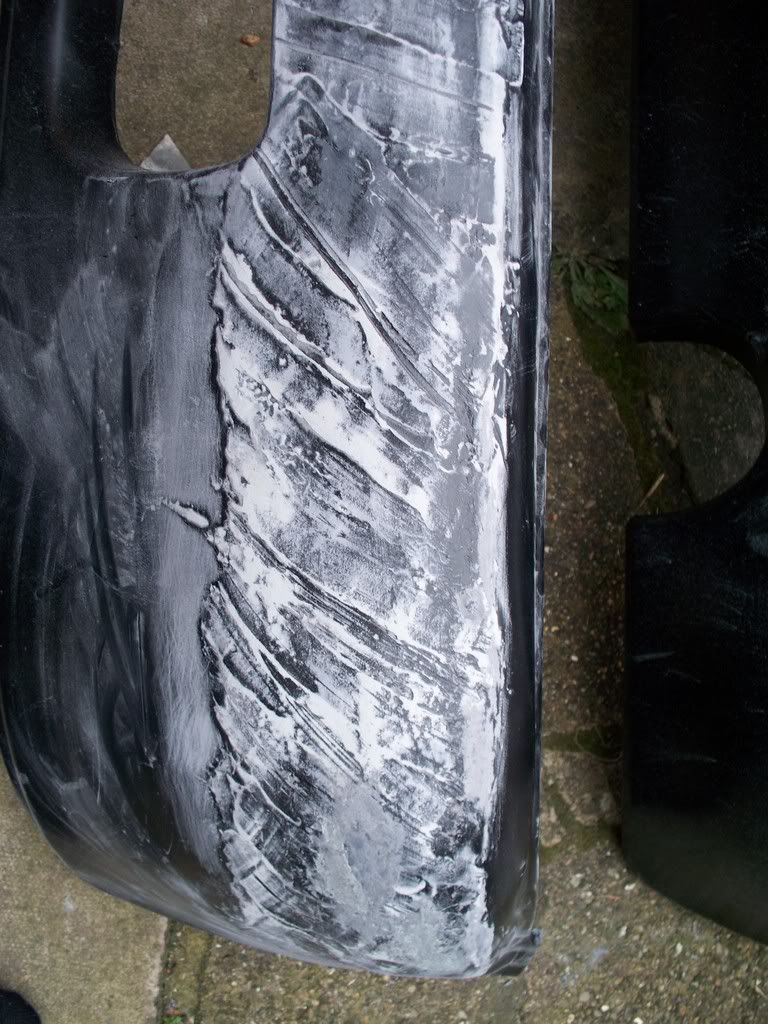

Iv just came in from working on the bumpers and im not too happy...Tbh the bumpers look like sh**te! iv filled in the gaps and now im trying to sand em down (3 hours on friday). I sprayed them after i done the first bout of sanding, because i thought to myself "after the paint it might look better" ...but no, it just looks horrible! :(
Iv just been out in the garden since 1 sanding away with a electric sander trying to make it smoother, but no luck, it just looks the same really...
This is the first time i have ever done something like this, and i just feel so :( that its so crap (i suppose i keep thinking about how much effort and time and money into it, and to not get a result.)
Bellow are some piccys of what they look like rite now, if anyones got any advice (contructive please lol) then fire away, or if anyones got any suggestions?? Thanks for listening to the rant eveyone!!!!
Thanks again everyone!
my advise would be to keep filling and sanding, then looking for indents to fill and sand some more, dont give up now:) they will look great when you have got them all smooth and nice:D
oh, and use good quality paint! (from a paint shop, not halfords or some cheap place) it makes such a difference to the finnish and it will be much easier to spray with!
oh, and i take it you are using a block to sand with right?
omfg thats hilarious, just by comparing them 2 pictures i can see how much my 1st timer filling skills suck! lol

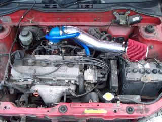

Small update everyone, got a delivery yesterday in the form of an Induction Kit.
Looks and Sounds the Nuts...and a steal for only £38.99 off fleabay...
Any comments are welcome or advise is welcome everyone...
NEXT ON THE LIST: some sort of tubing so i can get MORE cold air going direct to the filter... Pics bellow..
So what do yall thinks?? yah i no i no, engine cold do with a clean lol

Oooh i was just wondering, considering i was thinking about doing the open mouth, will i be able to cover over the gaps with fiberglass sheets? i was looking through smidges blog and he glued in some plastic, but iv got a load of fiberglass left over in the garage so i thought i could use that, but im not to sure, cos the gap looks pretty big. Thanks for you help guys!!
its the same induction i have on mine mate they are nice go to helfrauds and get some silver ducting that fits inside the middle part of the filter have a look at my blog to see what i mean
The easier way I've found to do the open mouth, like you've cut it out there, is to sand the paint all around the bits you've cut out, then fibreglass the back of the gap, and then fill it in with filler (p38 will do) till it's flush with the plastic. If that makes sense. However, doing the top edge will prove to be a tricky ###### if you're a perfectionist.
You'll want to file down the plastic strengthening bits near the gaps though so the fibreglass sits better.

just a quick question on the air filter whats that pipe you got going to the top off it ? because on mine i just blocked the hole up :S
looking good tom
LOL oh dude i dont have a friggin clue what it is lol...all i know is then i was taking the originial air box out, this little black tube came off it. so when i attached this new filter there was a hole just the right size so i just ploped it in lol.. if anyone does know what it is, would be good to know lol..

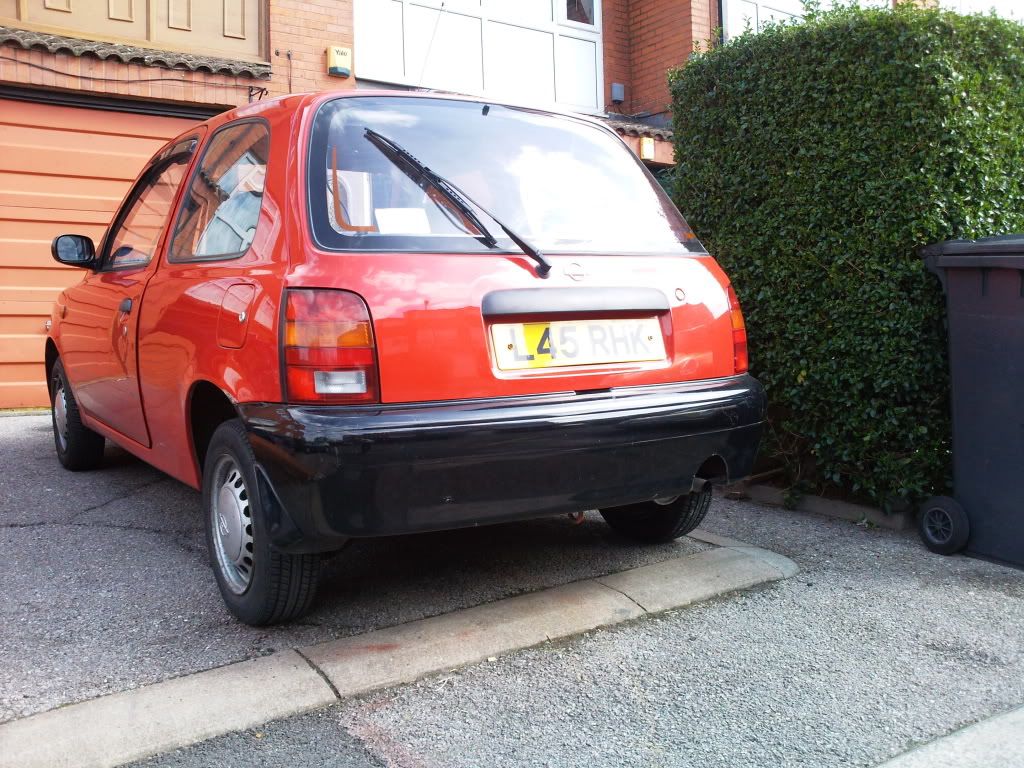

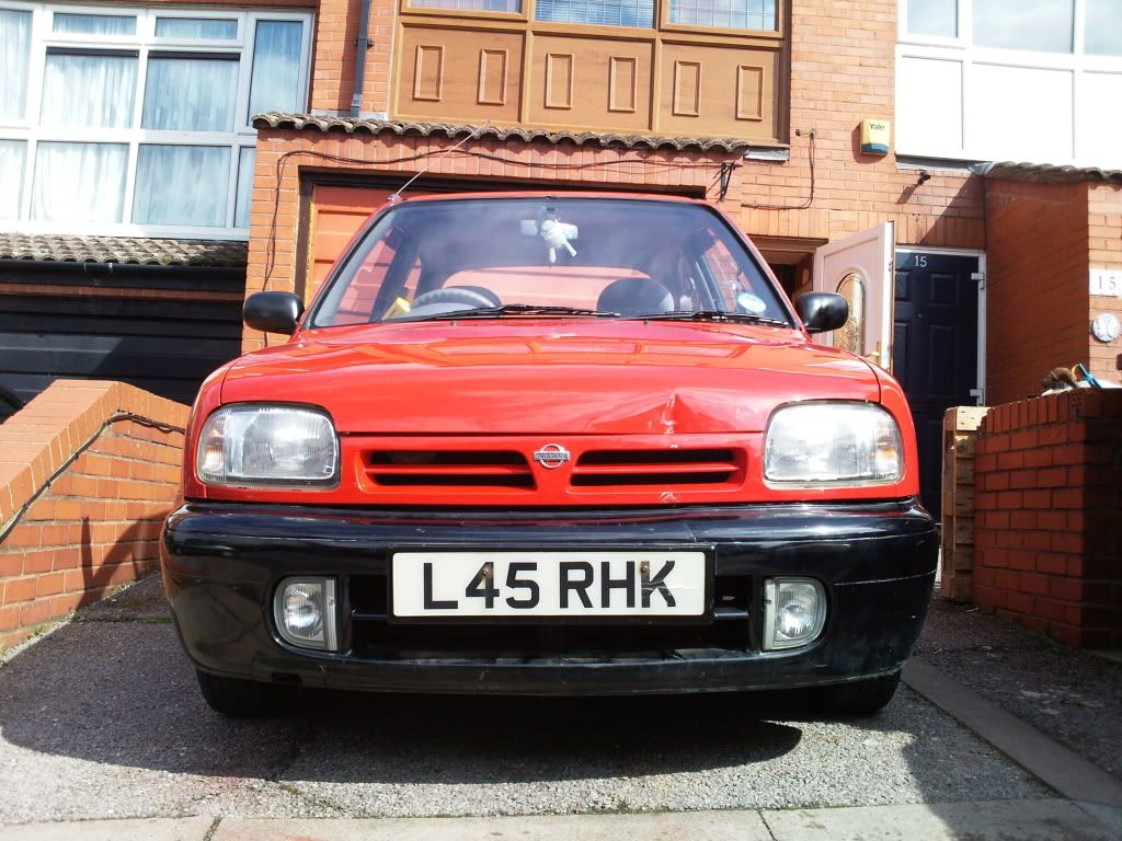

Well after a bit of break (due to no funds) ib made a bit of a progression...I got myself some Super S bumpers yesterday... Excellent condition apart from the exhaust hole has been made a lil bit wider, but hey i can live with that, i mean im gonna be filling it with an exhaust soon enough...Well today i spent the whole morning fitting them..a little bit trickyer than i thought it would be, and the bumpers JUST about fitted..a real squeeze, to the point where i had to drill new holes..

The dent in the bonnet happened befor my misses even got the car. As for the colour coding, im not gonna do it :p lol...im gonna keep them black, love the way it looks (now its been cleaned lol) and plus its a bit different to the norm...
thats a march rear bumper ;) its got the cut out on the bumper so you can open the boot lid as marchs dont have boot handles...
the bumpers where on sonnys supercharged micra....
Damn didnt no that , but thinking about it, its pretty obvious lol may have to get rid of the current boot handel and invest in some nipples...hmm so many ideas, just not enough time/monies to do them lol..
