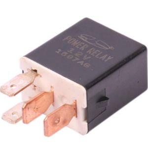

Hi mika, I'm looking into how to wire my dash cam into the fuse box or similar to reduce the usage of the cigar connection.
This would then be more convenient as the unit would just remain connected and will work as soon as the key is turned.
Rather than having to plug it in manually each time.
After some googling I found that it's possible to use a piggy back fuse although these are not the best option.
The other method is to use the obd2 port and use a switch that is able to be used in both positions of the key such as when it's removed even.
For the cigarette lighter I'd like to be able to send power to the battery and not need to lift hood or bonnet as we call it here in England.
My power bank is around 8Ah that I would try to send power to the battery under the hood.
Could work to send power from the wire of the stereo to the cigar socket I would think though that that some vehicles you can operate the radio without the key but in my case this isn't possible.
Not sure If that would make a difference.
I think the best method though would be to dedicate a wire to the fuse box directly as mika is suggesting as this would make more sense.
Radio has 2 live feeds. One is switched one is permanant live. It would forget its radio presets otherwise.
Do not take a live feed from the OBD2 port, if you **** that up it can cause all sorts of issues as it feeds from the canbus.
If you want a port to feed power back to the battery then run one through a fused cable directly from the battery to the cabin, you should really put a diode in to stop high amps backfeeding to your devices in the cabin. Dash cam, what's the current draw? If its half amp then go to the internal light for live feed that shuts down when you take the key out and open the door. Also puts it up high and means you dash cam can sit behind the mirror out of the prescribed area.

I think I will go direct to the fuse box i will get some wiring next.
These are the items I will use well the first one this way I may not have to cut the connector off but may decide to later.
A piggy back fuse maybe still needed.

How about small automotive relay, 12V from battery via fuse box.
Coil feed/trigger wire from from cigarette lighter socket positive.
Some kind of socket/plug/connector to some where on dash...?:unsure:;)
Mikrorelay 12V/25A 4pin+resistor 48-1966
4AD3C712D7AEA22C6F1C79D9AA7C877C3580FC91
Nice I heard that a relay is the best way to connect to the battery for various devices and connections.
I've just got 2 mini piggy pack fuse wires and I already have fuses.
Will keep the relay in my notes and probably get one next.
