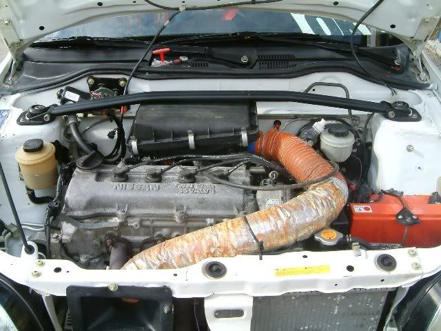

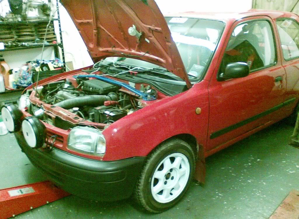

On the red one I have now put an almera air box on and exhaust wrapped the manifold.

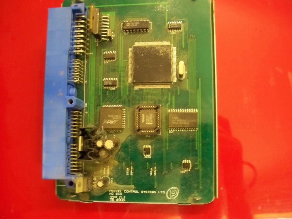

Well we have been trying to get the blue rally going for a while now but we seem to keep coming across eleci gremlins, the other day when we had the dash out again! I decided to check the ECU, for those of you in the know I had been told it was a rare N2 Pectel Micra challenge ECU.... well.... it is and here are some photos of it!

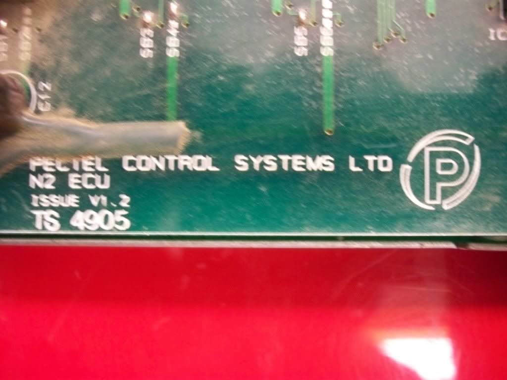

The spec Pectel had been given when they built the ECU was to make it look as standard as possible so here it is against a standard ECU, Spot the difference!!!

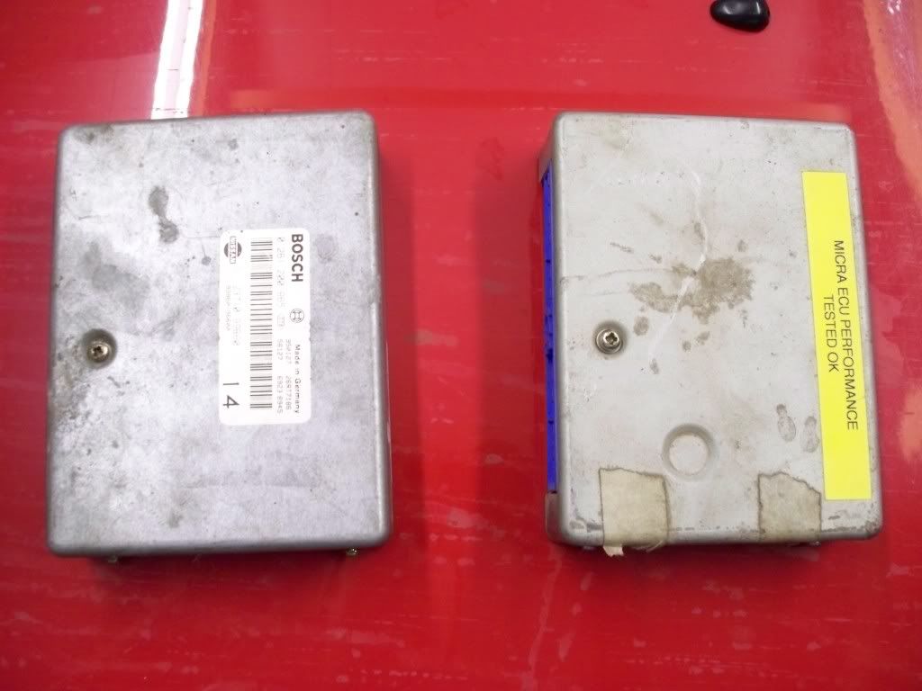

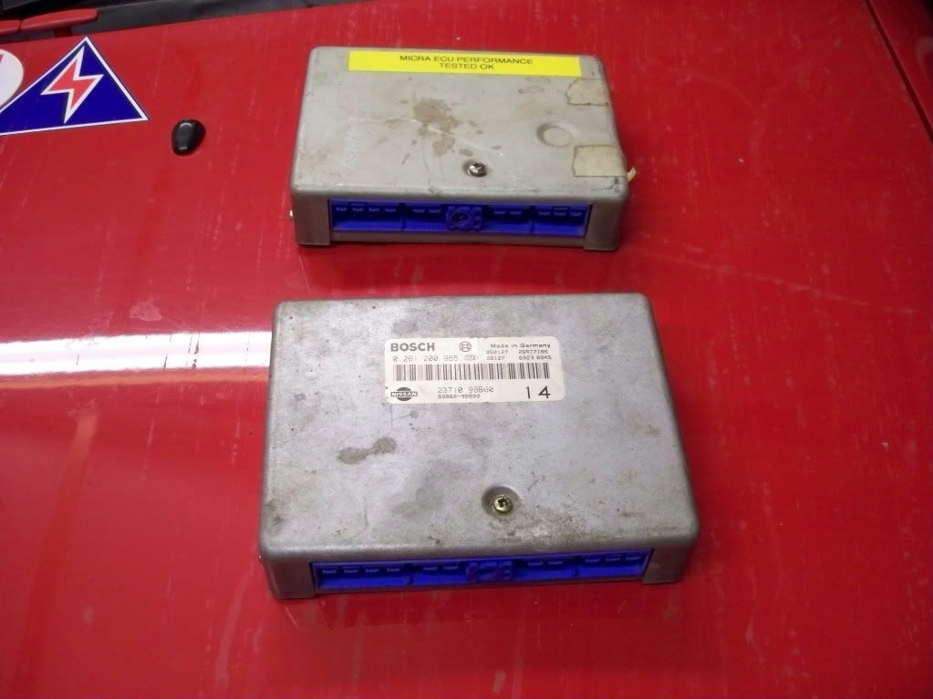

The blue car the problem we found was the Ecu. A small hair line crack on the board, its an easy fix so thats being done now. So we tried it with a standard Ecu and it ran fine so the car now has life!!!!! Panels have been painted, the bonnet and boot are still white I need to see how it looks and if its crap i will get them painted too. So that is coming along well.
More news soon, I will get videos of both cars.
Easy repair if its only a double sided board, but looks to me like multilayered, good luck
Oh forgot to say I'm not doing the repair! lol... I have a friend who does this sort of thing for a living so he is doing it. He said its an easy repair!

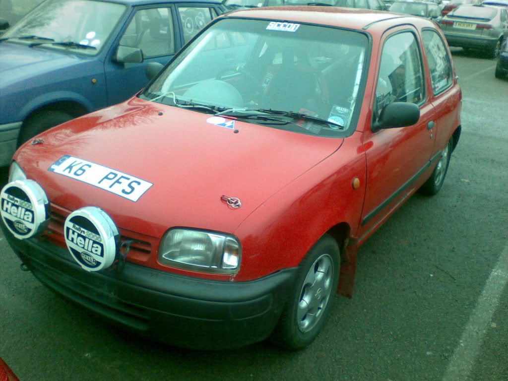

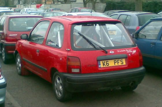

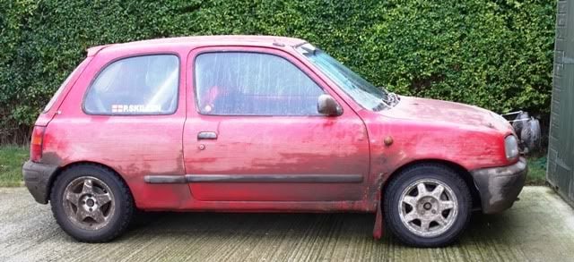

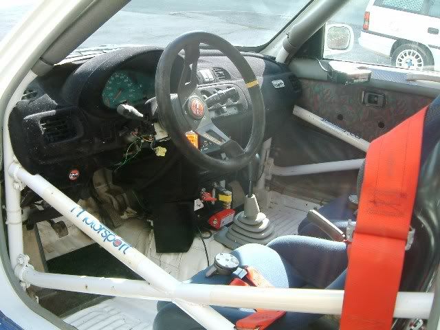

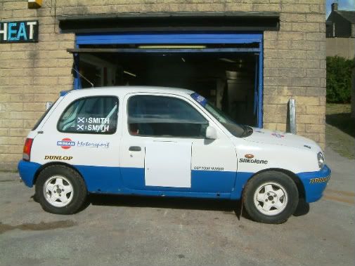

Well I have my road rally car with me today at work so I took a couple of photos of it. I'm going to an event tonight from work. So here are the photos of it and then the next event i will hopefully have some photos of the micra in action!
As for the blue rally car that is coming along I hope to have it finished in a matter of weeks now, for now here is a little update of what I plan to do and the spec of the blue car. The plan is to fit a set of bike cars to the rally car, here is a photo of the carbs and manifold!!!!

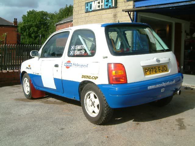

SPEC!
LHD ex-micra challenge car.
Dog Box Gear Kit
Gripper LSD Diff
Quick Shift Lever
Helix Competition paddle clutch
Nissan 100NX Callipers and vented discs and rear discs with hydraulic Handbrake
Bias valve
Revolution 13” Alloy Wheels In White
Janspeed Competition 4 Branch Manifold & system Grp A
Peter Vaughen built engine and PVE engine number stamped on it.
Professionally Modified Gas flowed Cylinder Head, Group A Rally Cams 773 Spec with Lighten and balanced bottom end, lightened JUN flywheel.
Nismo Engine Mount bushes
Programmable Pectel N2 Nissan challenge ECU
Competition suspension bushes Nismo
NME Front Strut Brace
SPAX competition rear Dampers
Bilstein Front Dampers
Strengthened rear axel
Kevlar Under Body Protection ½ Length
Kevlar Fuel Tank Guard NME Spec
Alloy Sump Guard
Twin Bonnet lamp pods and 2 bumper lamp pods
Flocked dash
Sparco seats and steering wheel, Sabelt harness
Lightened doors and boot
Multi point roll cage
Light weight alloy bolts used throughout
Painted in Nissan blue

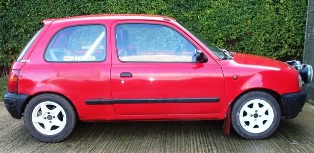

SPEC!
Red Micra Road Rally car.
1.0L shell
Close ratio Gear Kit
Gripper LSD Diff
Helix Competition paddle clutch (standard one fitted at the minute)
Lighten flywheel
Revolution 13” Alloy Wheels In White or 14” fitted at present
1.3 Engine standard maybe? (Might have different cams in not sure see earlier blog about the engine)
Almera airbox
1.6 injectors
Bilstein Front coilovers
Alloy Sump Guard
Prodrive Sparco seats and steering wheel, harness
Fly off hand brake

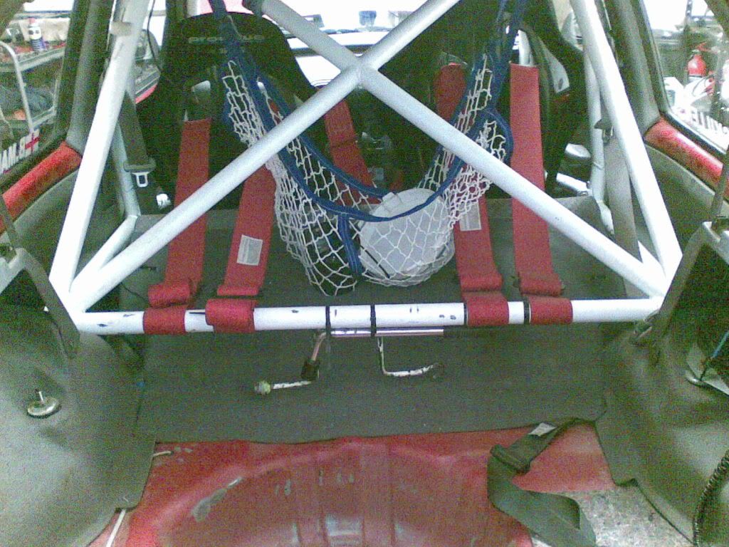

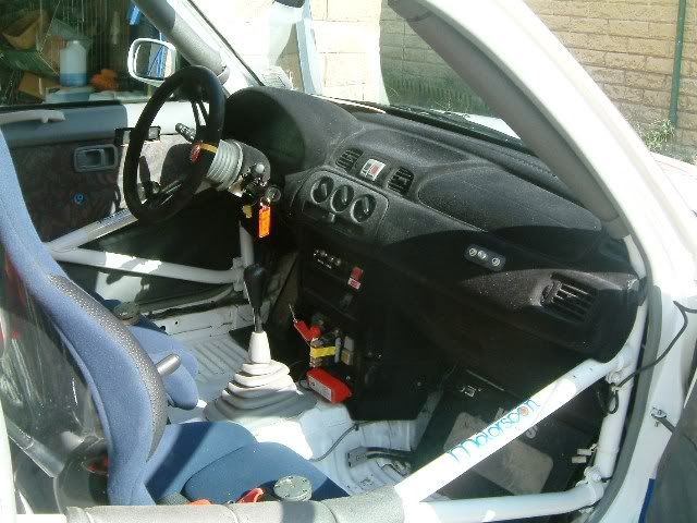

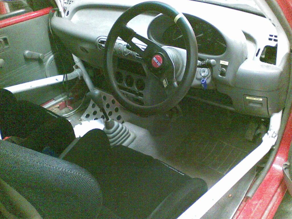

Wow! that is a great spec. Whats it like inside. any pics? It still has carpets rear seats headlining etc in?
I will take some pics of inside, it still has carpets, rear seats (folded down under the rear part of the cage) and headlining.

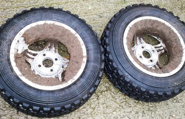

Well that was a rally and a half! below is a link to the event photos so you will see all the other cars and a video link of my car at the end of the rally, out of just under 60 starters only 38 finished it, it is know as an event that brakes cars! We came 24th, should have really been 18th but we booked in early three times so picked up 3 fails which dropped us ti 24th! Still really pleased we finished it, as you can see by the end of the video clip the ground was frozen solid! We started at 22:42 and finished at about 08:12 ish I think!

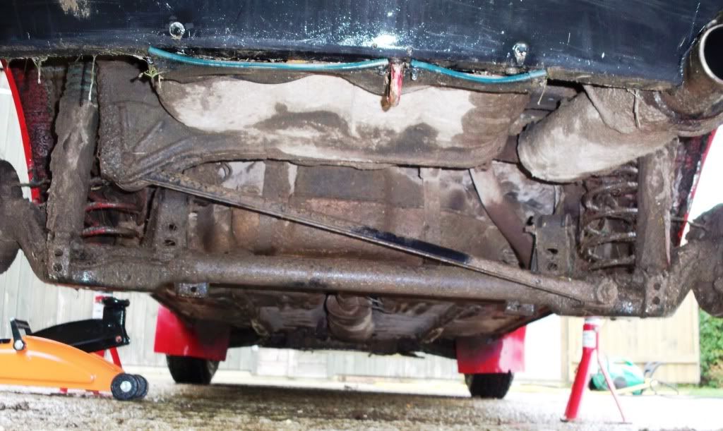

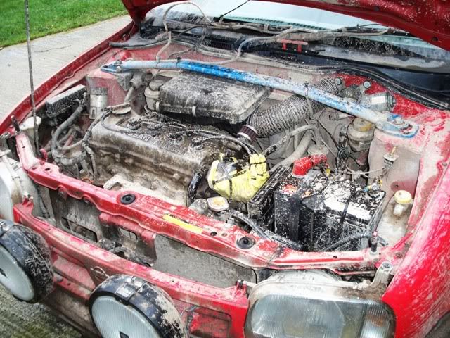

It did take me roughly about four and a half hours to clean the car yesterday, see the before and after photos! Suze & Matt from here did really well too they also got to the finish and they did have more problems than I did.
http://www.mandh-photography.co.uk/events/Preston08
http://video.google.com/videoplay?docid=-7176718256808991337
Car before the rally
Car after the rally!

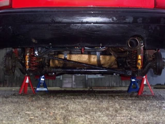

Rear axel after the rally
Rear axel after cleaning it!
Who needs to balance wheels with this on them???
Engine held up really well not one mis-fire all that silicone helped!!
I found after cleaning three problems, exhaust has a crack in it. Wiper bottle motor wires broke and front lower engine mount bolt came out!

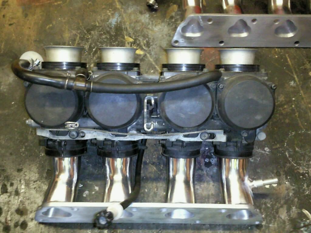

Hi all,
Well I have an update on the other car now, looking to get it finished over the next couple of weeks. I am really pleased with how the car has come on and we have had huge problems in getting it going. We have had to change the loom over as the old one has been hacked about and was in such a bad condition. The other problem with it being a LHD so many UK bits didnt work, for example rear lights didnt work and sent all the dash lights crazy??!!
Below is a video of the car running last night, the car is up on axel stands so we put it through the gears and the dogbox was clunking away like it should, the hubs also made a noise as they arent on properly yet.
List of jobs left to do,
O/s front aero pipe to fit,
sump guard,
