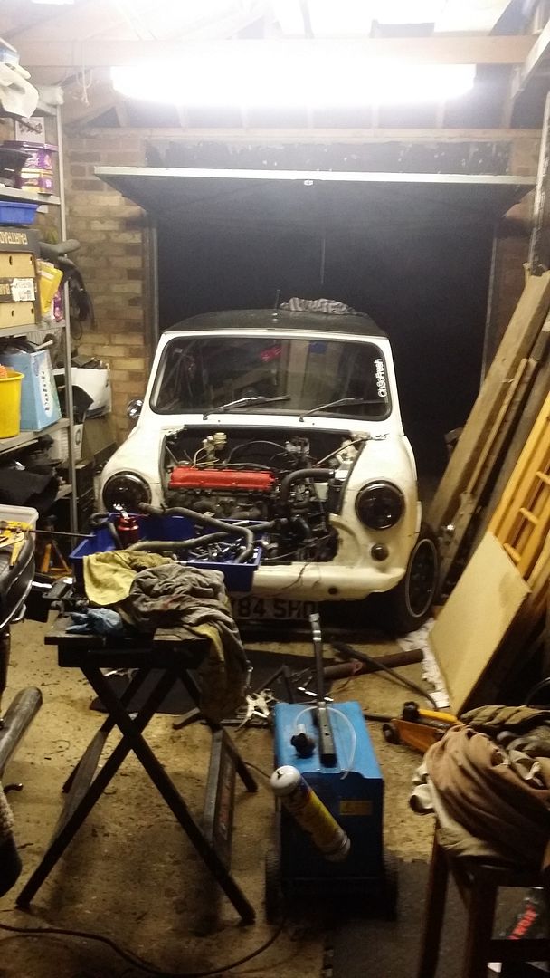

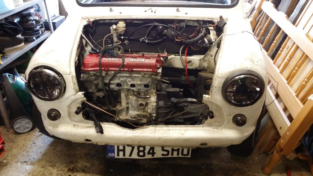

Well then, photos! Bikes moved outside, mini inside

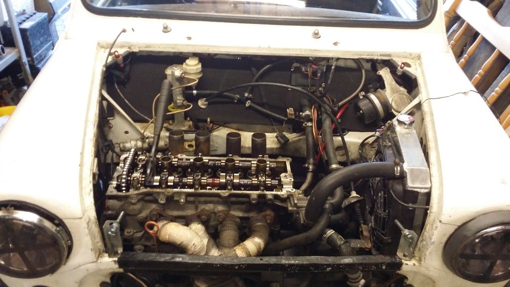

Working area
What's going in

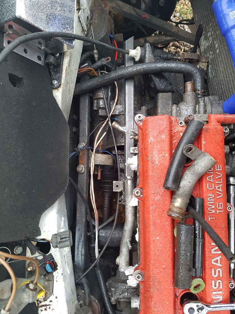

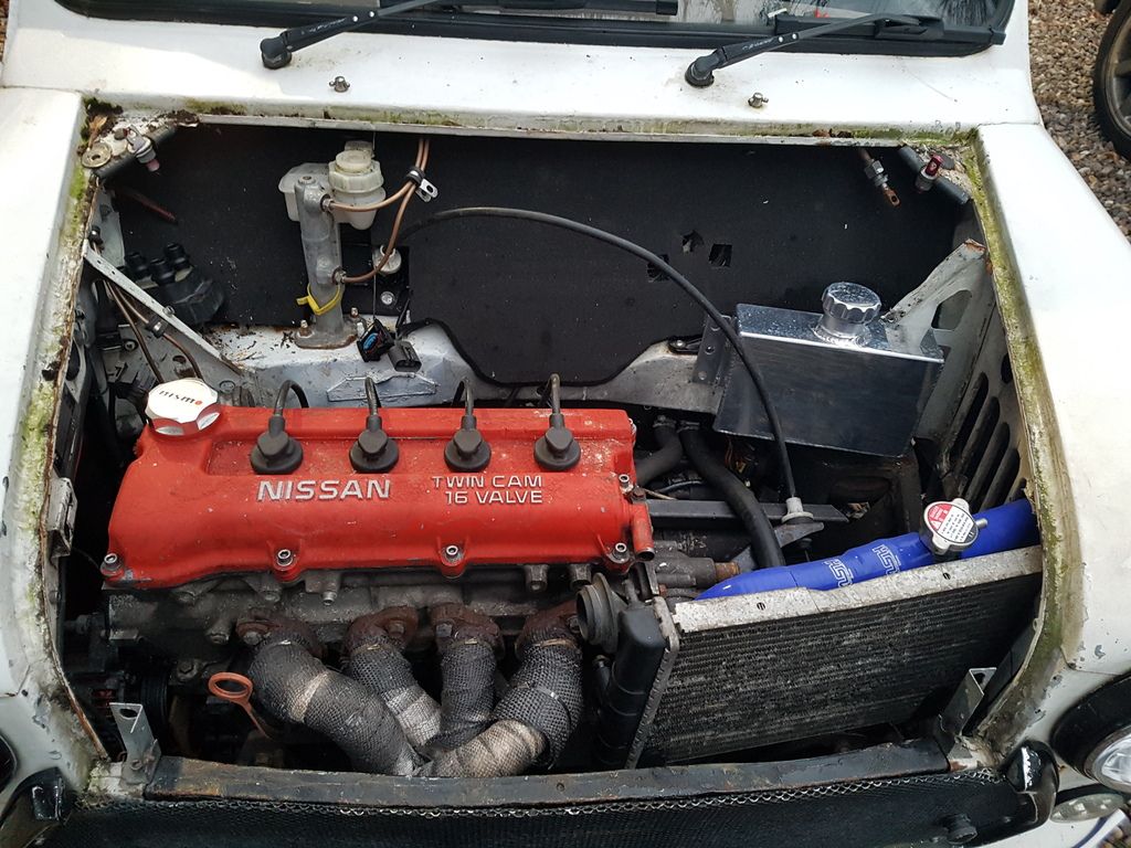

Stripping down

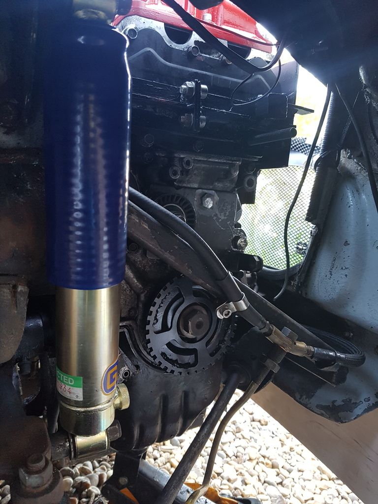

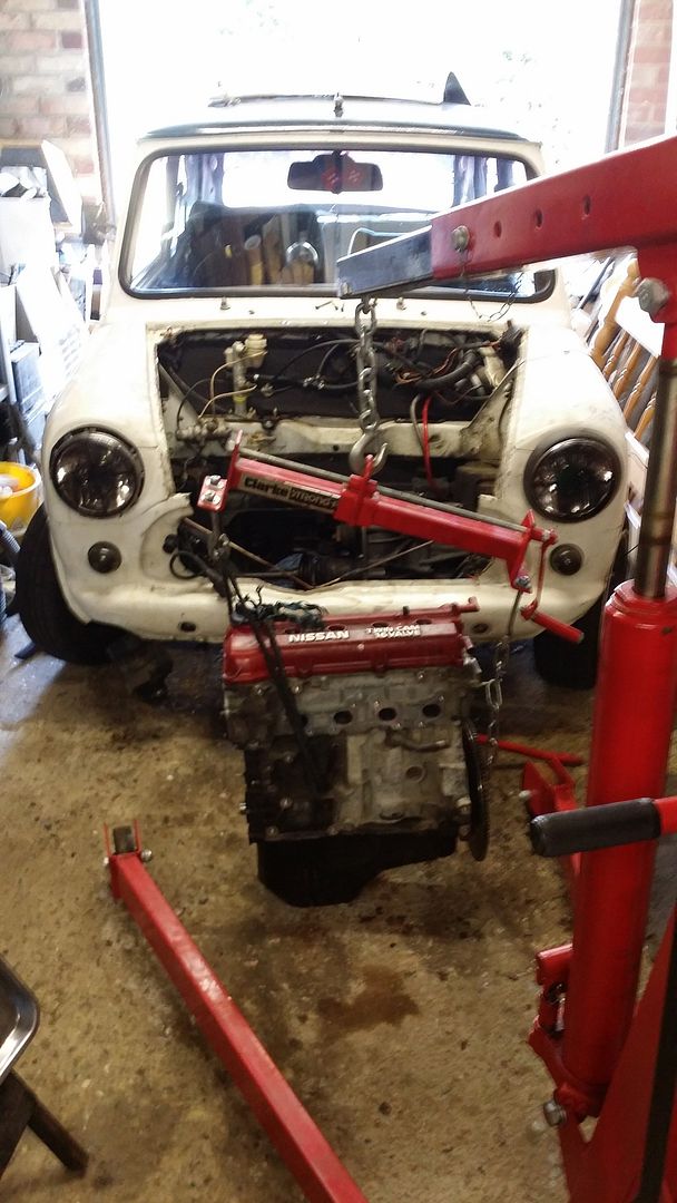

All ready to come out, cams removed as they are the 1.3 ones and need to go back in the engine
Coming out

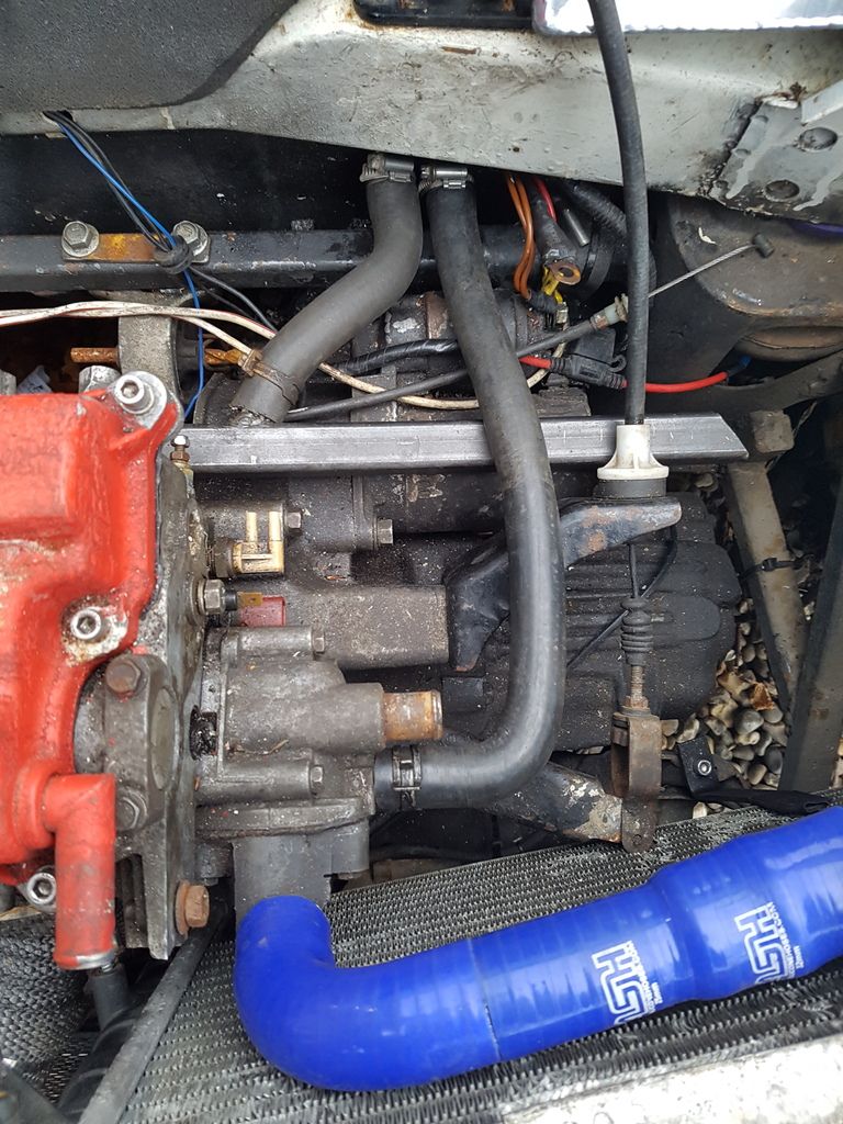

You can see how tight the space I had to work in! Really could have used another pair of hands too!

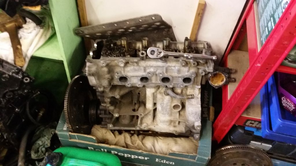

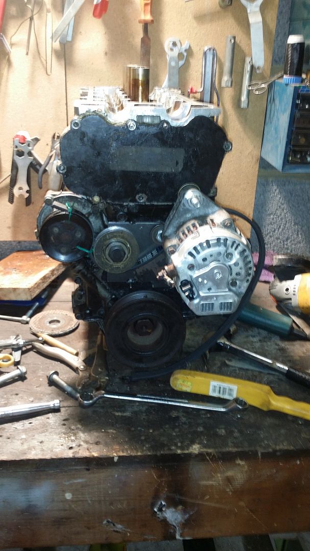

Gearbox all alone
Engine out and on the floor
Total time to remove engine completely and gearbox staying in = 4 hours
Started at 1800
Out and sitting on the floor by 2200
Left and at the pub by 2230

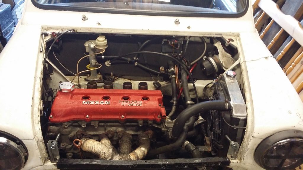

Engine finally in and reunited with gearbox
Went in lush and so smooth.
Engine at 45 degree angle, then flat to hovering just on the subframe. Slightly jacked up gearbox, pushed together but the splines didn't line up. Rotated engine slightly with crank pulley bolt. Tried again and they slipped together lovely.
Probably took 5 minutes tops

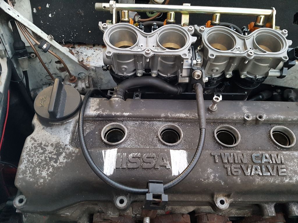

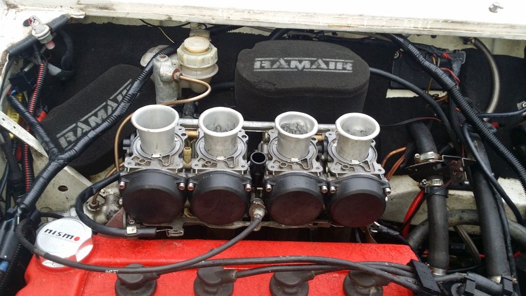

Writing this now everything accept the carbs and exhaust are done and dusted
I test fired with easy start. It's got a slow turnover but ignition so that's good.
Inlet manifold is fitted but no new gasket as I need to make it. Tested with my hand on the manifold and there's a big vacuum that end and puffs from the exhaust side
Working area
What's going in
Stripping down

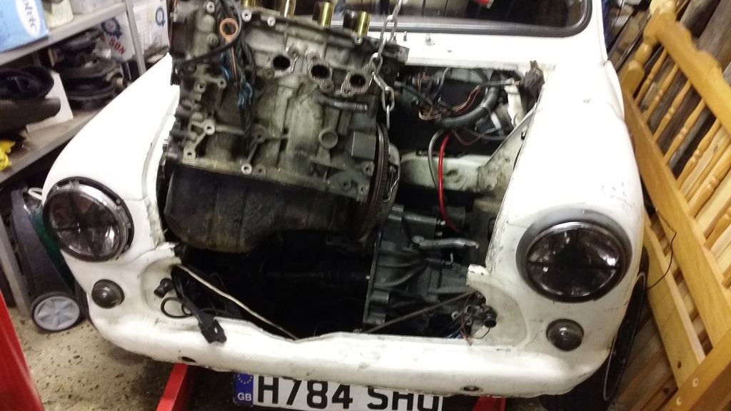

Coming out

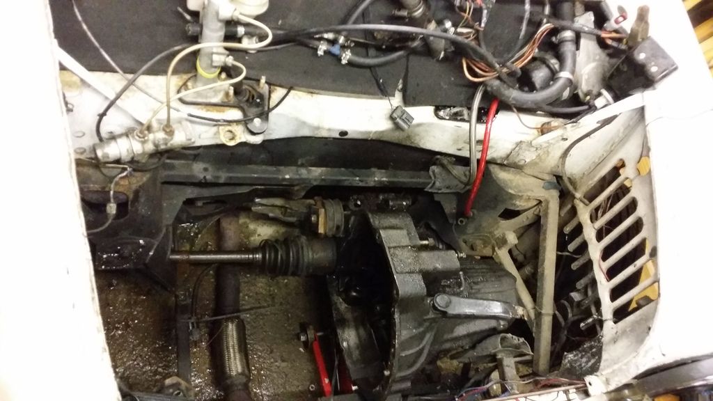

Gearbox all alone

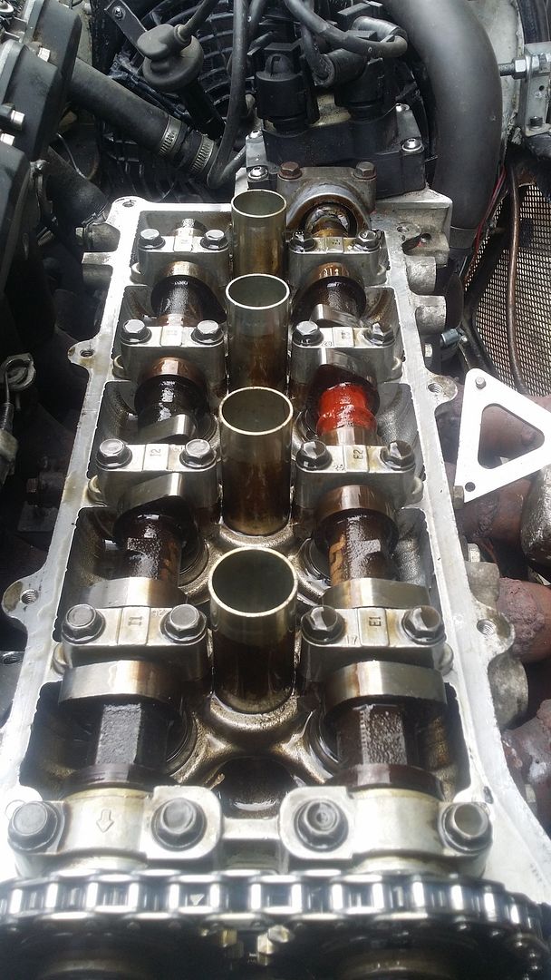

Timing done and Cams installed by 10am
Gaskets all done, sump on and ready to go in by 12
