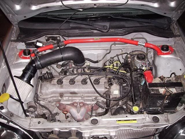

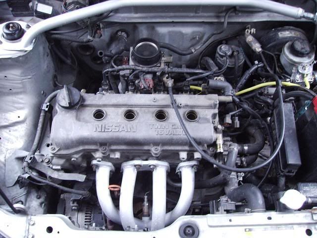

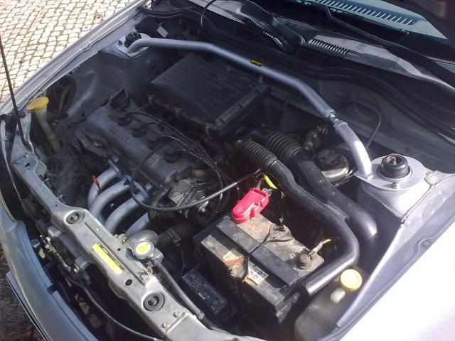

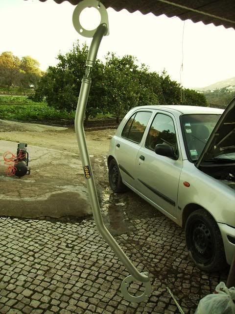

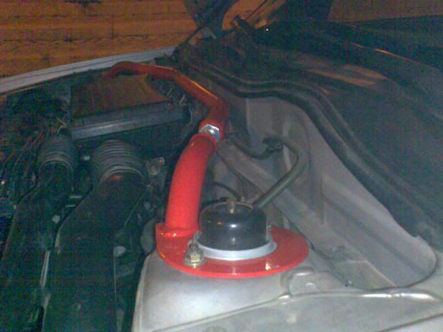

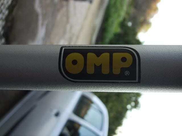

OMP Strut Brace:

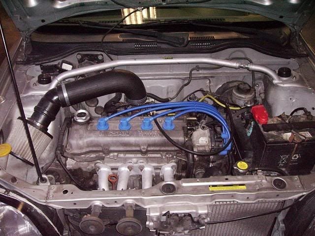

Eagle Pod Filter Before:
Eagle Pod Filter After:

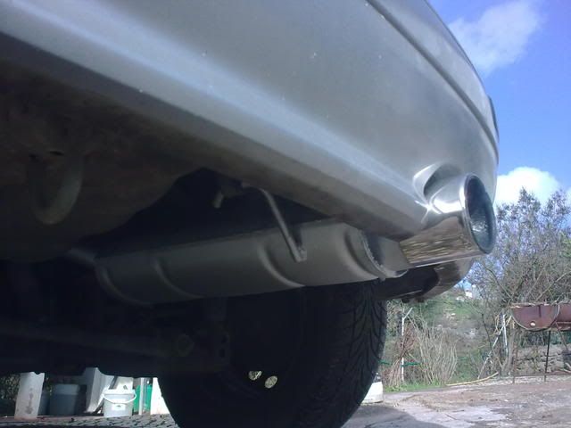

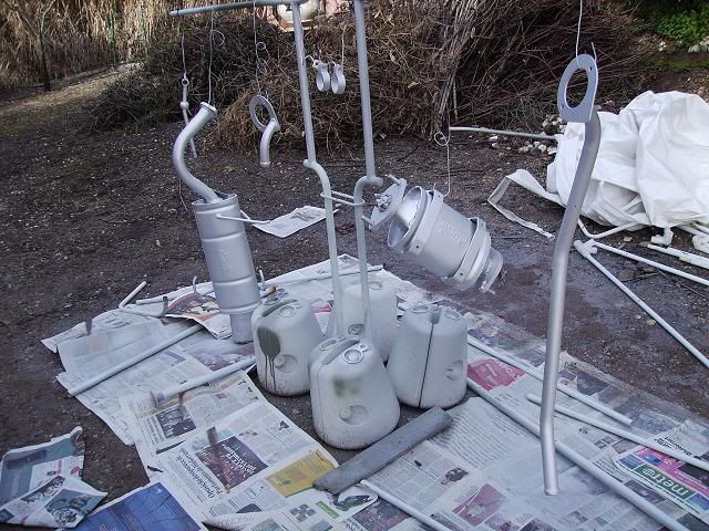

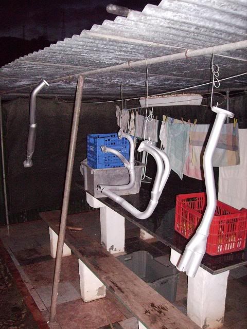

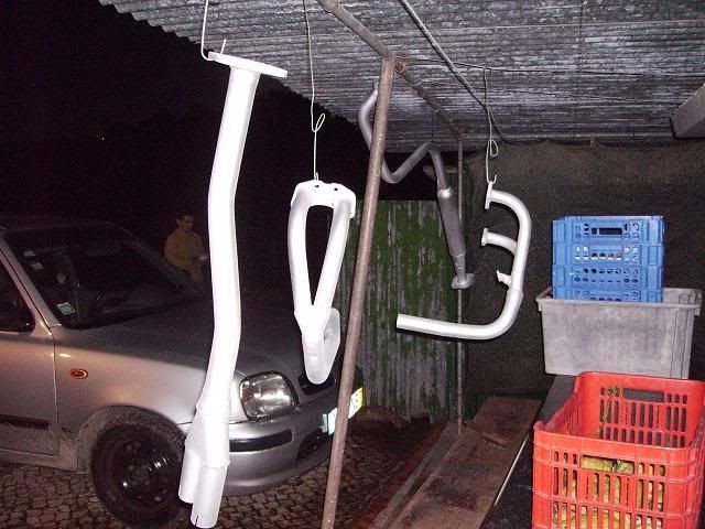

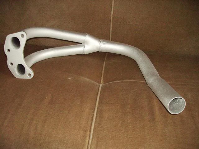

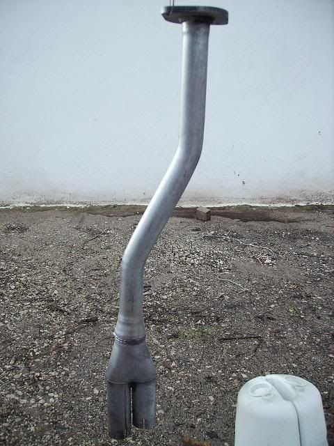

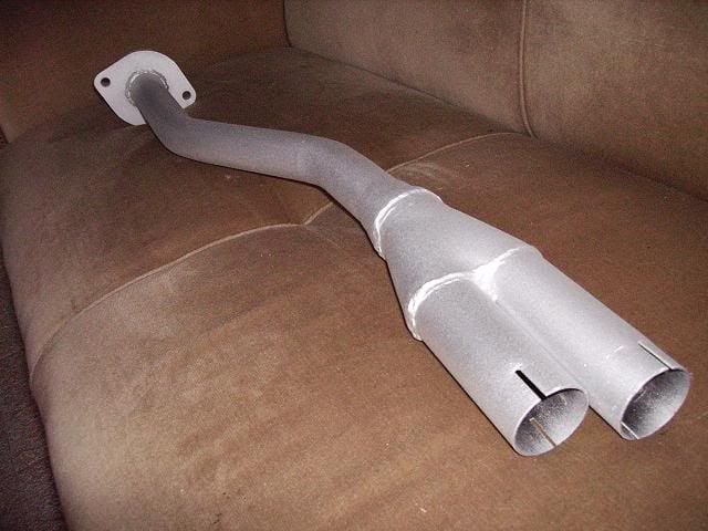

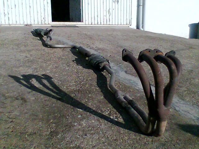

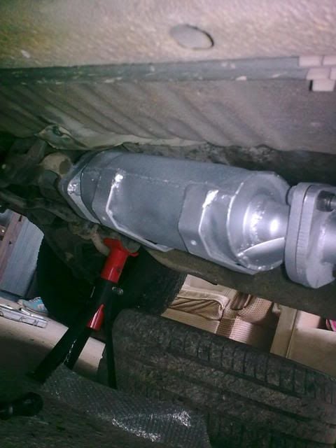

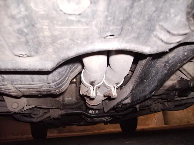

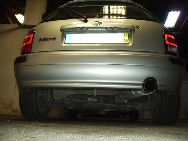

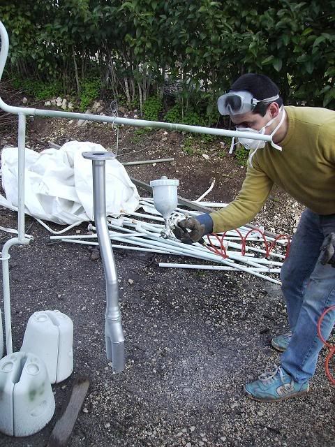

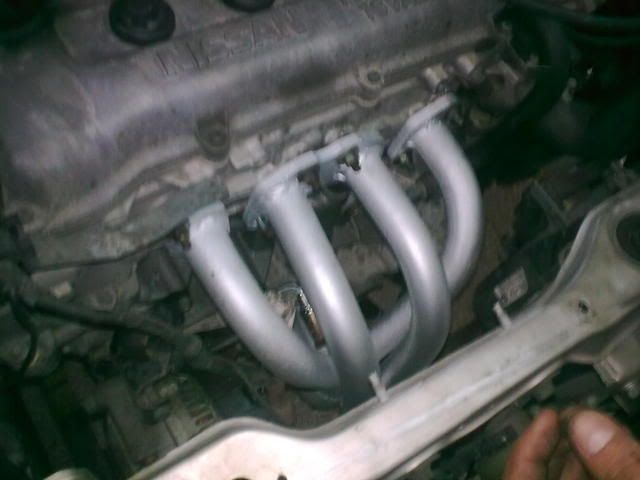

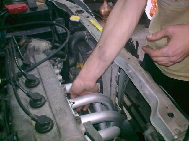

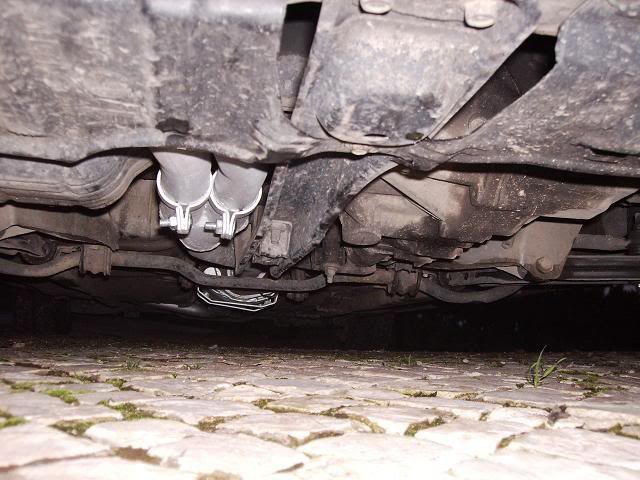

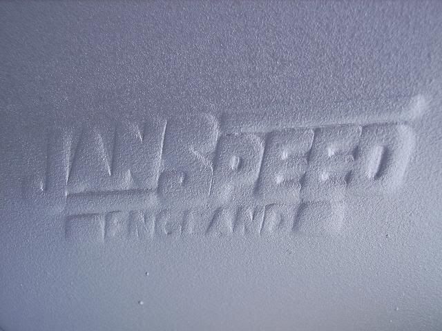

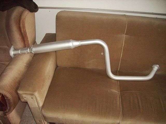

Full Janspeed Exhaust System before painting:

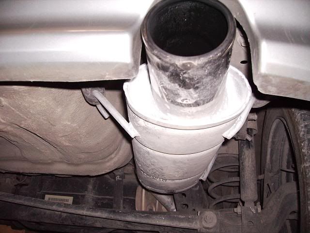

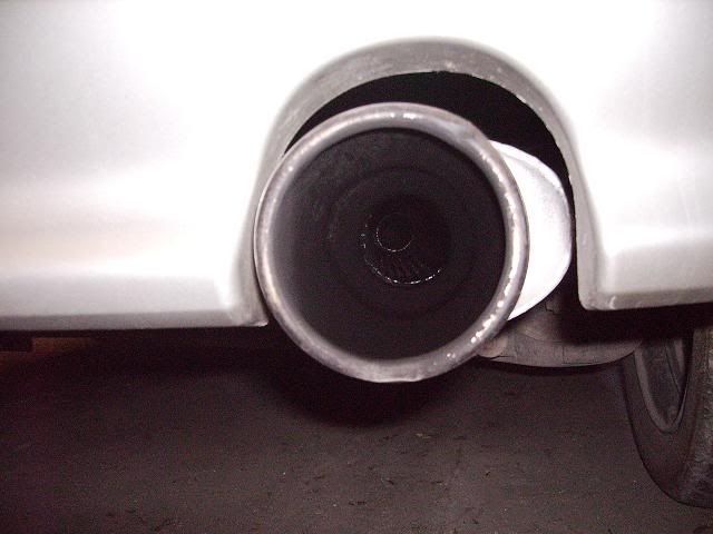

Full Janspeed Exhaust System painting and some more parts:

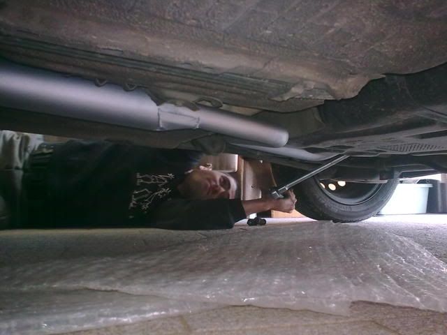

Exhaust assembly:

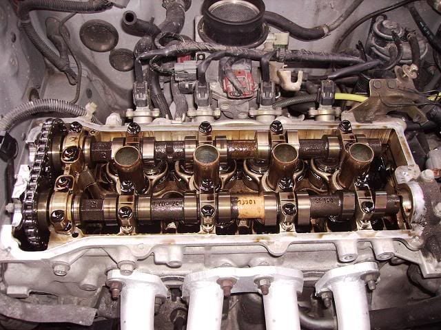

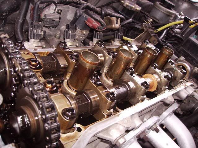

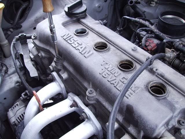

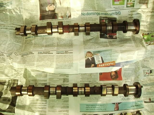

1.3 Cams:

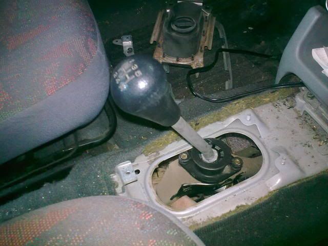

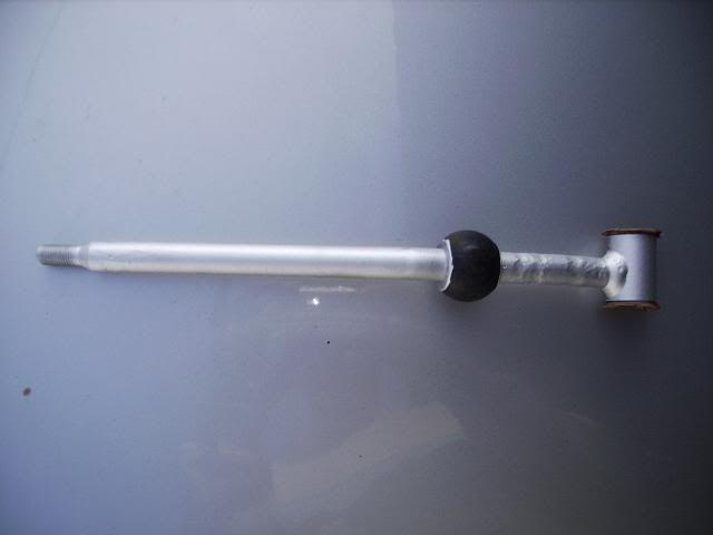

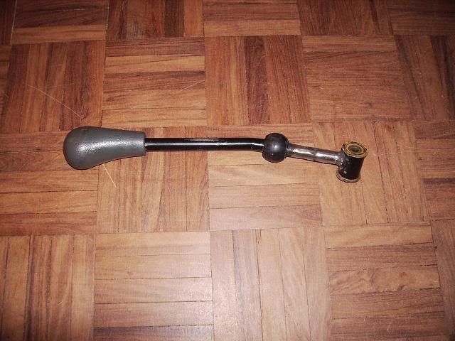

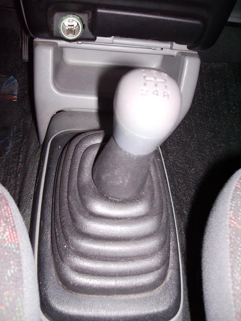

Home-Made Short-Shifter:

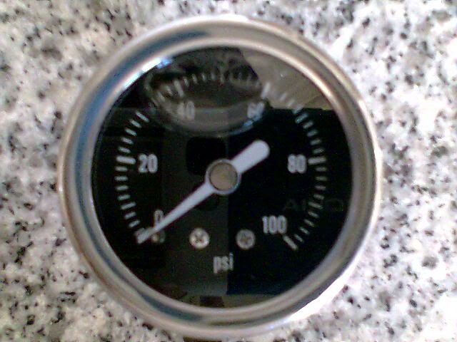

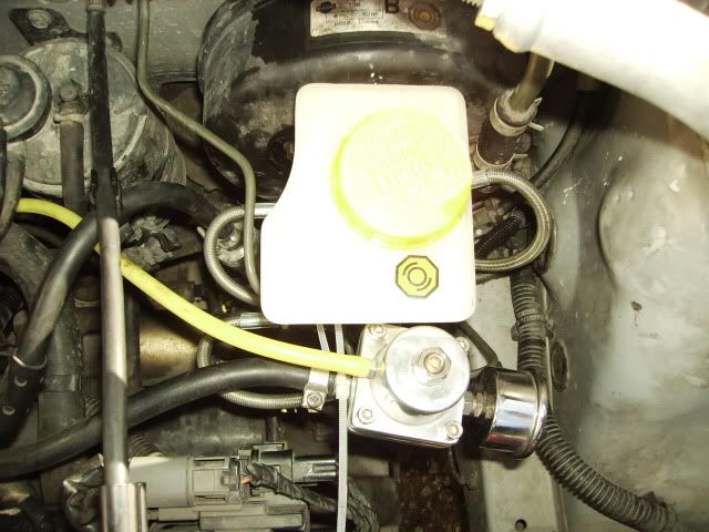

Fuel Pressure Regulator:

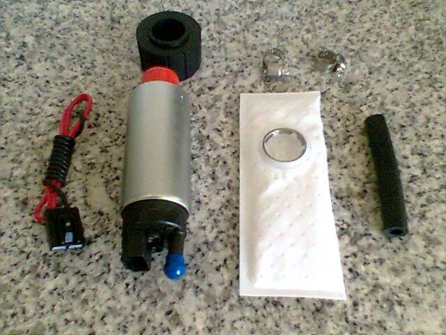

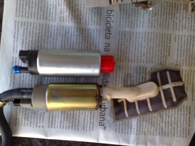

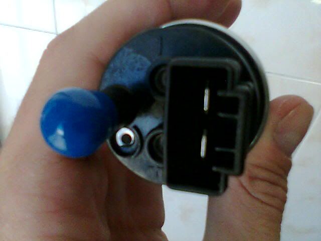

Walbro Fuel Pump:

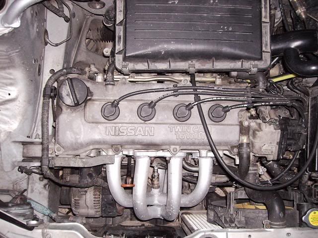

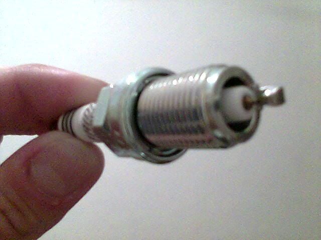

NGK Iridium Plugs:
10mm Plug Leads:
Nismo Oil Cap:

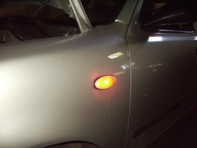

Smoked Side Repeaters:

- Reprogramable ECU with NIStune Board
- Full Janspeed Exhaust System
- 1.3 Cams
- 35mm lowering with Ventura Springs
- Kayaba Premium shocks
- OMP Strut Brace
- NGK Iridium Plugs one level colder
- Adjustable Fuel Pressure Regulator
- Walbro Fuel Pump
- 1.6 Injectors
- Mesh Fuel Filter
- Mesh Eagle Pod Filter
- 10mm Plug Leads

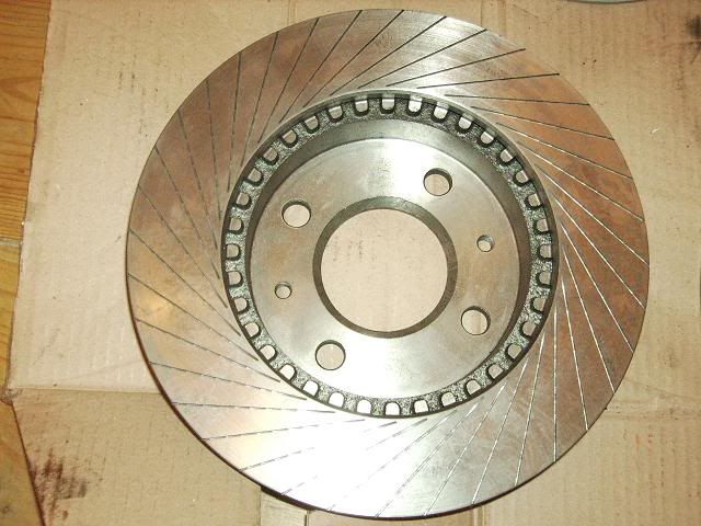

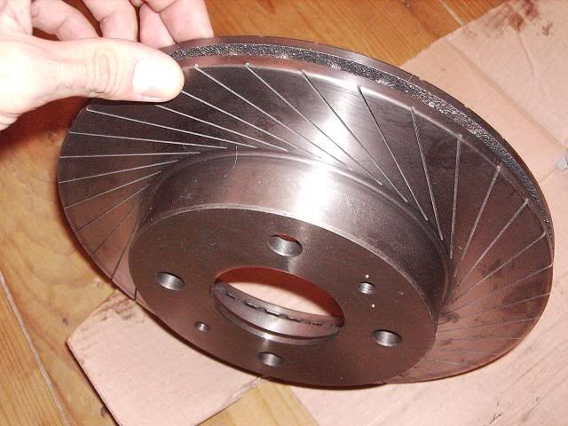

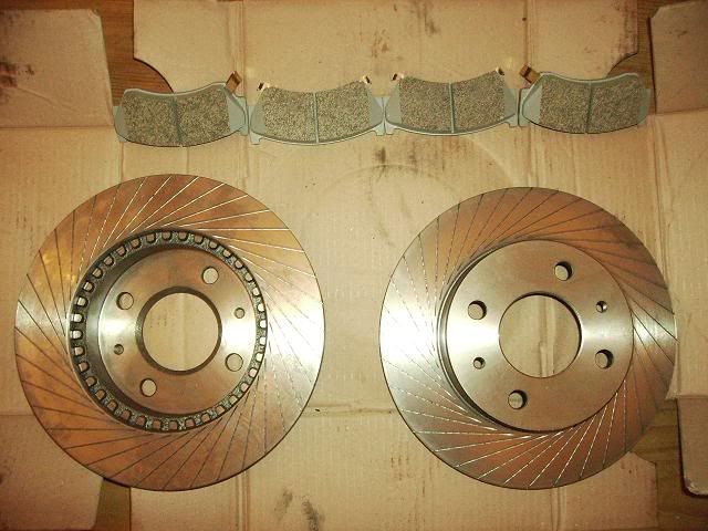

- Brembo Max Brake Discs
- Textar Brake Pads
- Home-Made Short-Shifter
- Smoke Side Repeaters
- M3 Mirrors
- Dashboard Blue Leds
- 193.000km :laugh:

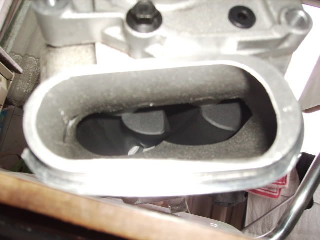

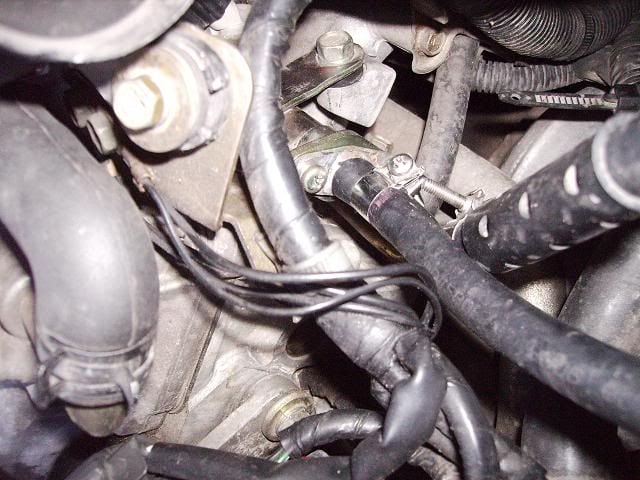

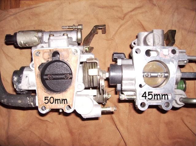

One question, when you put 1.6 (GA16E) throttle body, you source it from which car? Sunny N14, Almera N15, Primera P11 or P11? Does 1.4 throttle works too?
Best regards
Best regards
maybe you have GA15,s over there ? same 50mm bore as my almera one but the GA15 is a direct fit (same 1 valve idle control setup, whereas i had to cut my 2 valves off) :)

- how easy is the nistune system to use?. i see your using GA16 injectors, but i didnt see an AFR trace on your dyno sheet - was it easy to adjust the mapping for the increase in injector capacity?. does the nistune board allow you to adjust the rev-limit too?
- is the fuel pressure regulator your using fixed rate or rising rate?. did you alter the mapping to account for this?.
No, no GA15DE over here, only GA14DE or GA16DE, which one is the better?

thing. :( Im using 3.0bar/3.5bar on the FPR, but the big injectors are overridden
at bellow 4.000rpm, the ECU only goes open-loop above 4.000rpm. I can still have
some good consumption values, at 6.9L/100Km, something like 34 MPG... (Y)

all the GA (almera/primera) ones that i have seen looked the same bagas, i had to cut the 2 idle control valves off and refit my CG one remotely (circled in the pic), and also cut the water heated circuit from the back, and altered the throttlecable bracket, disregard the 5th injector tho (square in pic) :)
http://www.micra.org.uk/attachment.php?attachmentid=13386&stc=1&d=1249920548
I was asking that because on Nissan Parts Catalog, GA14DE and GA16DE throttle boddies have different part numbers...
And on scrapyards here, there are only Sunny/Almera 1.4, not a single one 1.6... :(

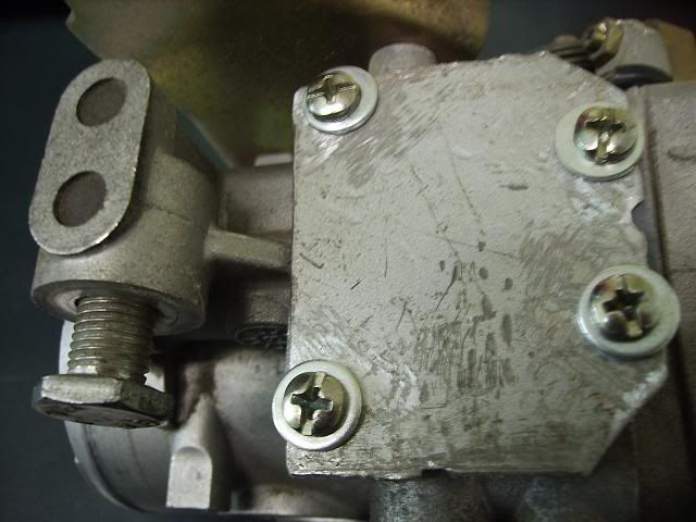

Is there any way to connect the Micra loom into GA idle control valves? I really dont want to cut the throttle body...
Thanks for the pics, seems that you have pics of every single part of Micra (Y)
there,s a thread somewhere bagas (3 or 4 months ago ?) where i think i figured out which wires to splice together to work the 2 i/c/v,s from the CG loom, but i think the valves hit the fuelrail anyway tho ? .
iirc somebody modded their manifold (angled the face backwards maybe, or raised the t/b ?) so that everything cleared ok :)
edit, this one i think
http://www.micra.org.uk/showthread.php?p=341838&highlight=idle+control+valve#post341838
Frank, many thanks again. I will source a GA throttle body and try to make a clean install. (Y)

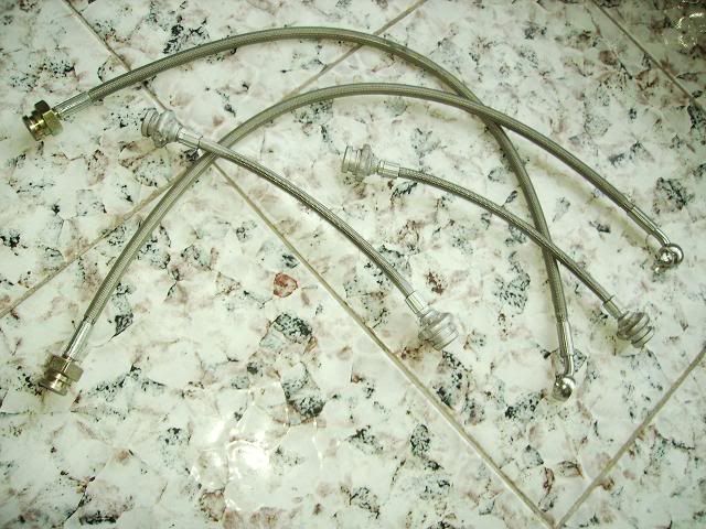

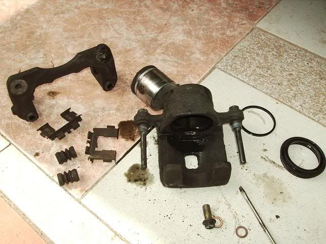

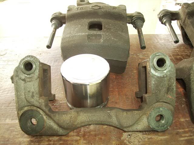

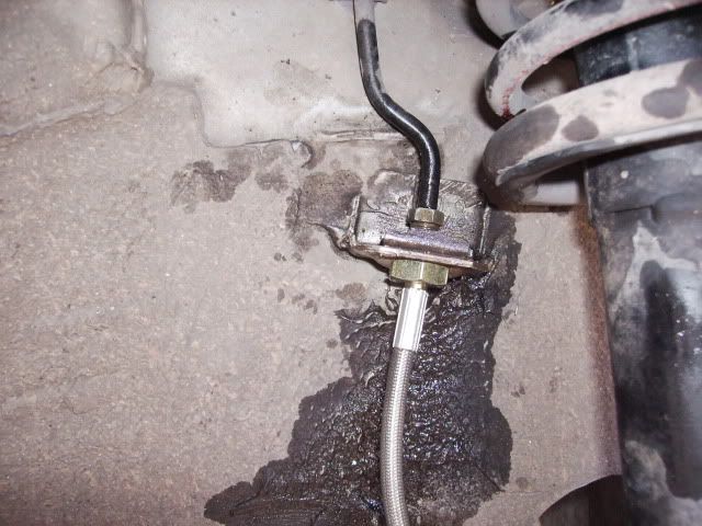

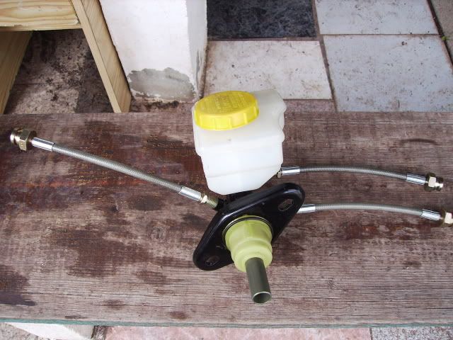

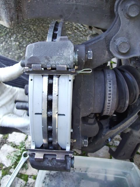

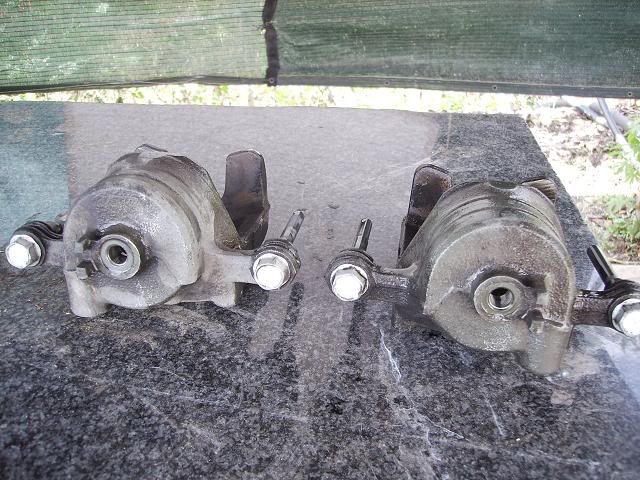

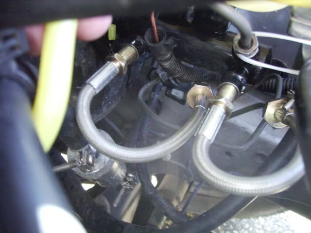

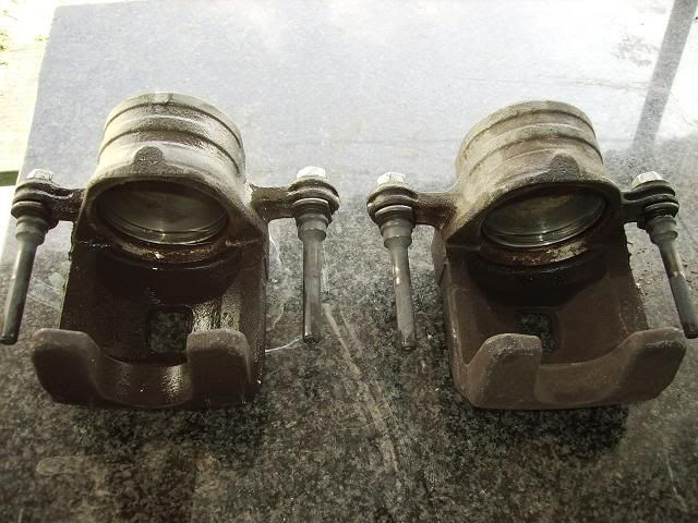

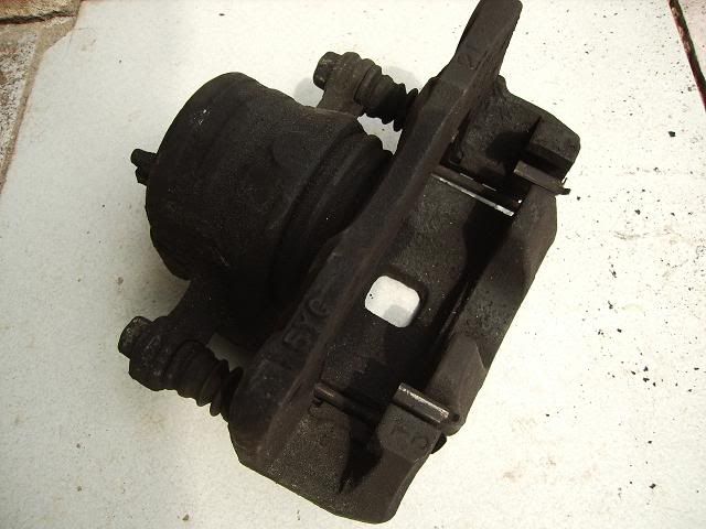

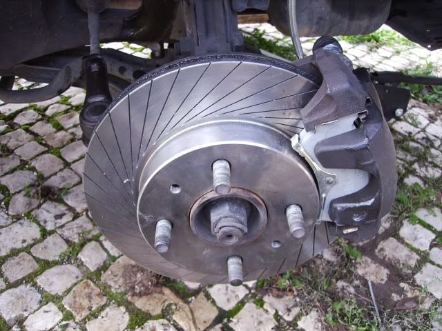

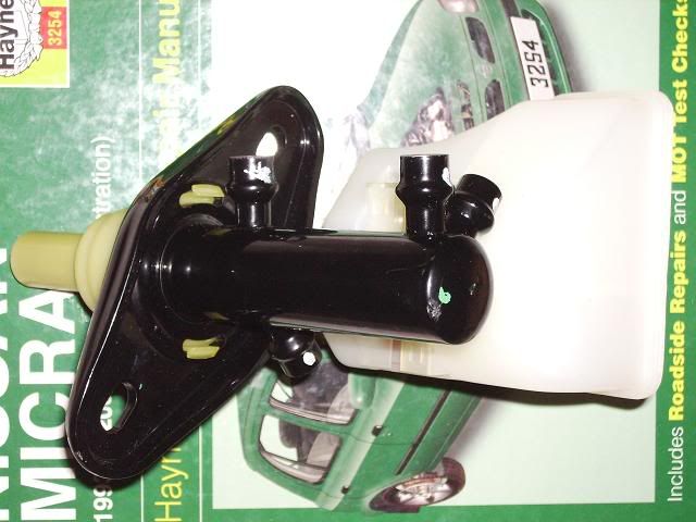

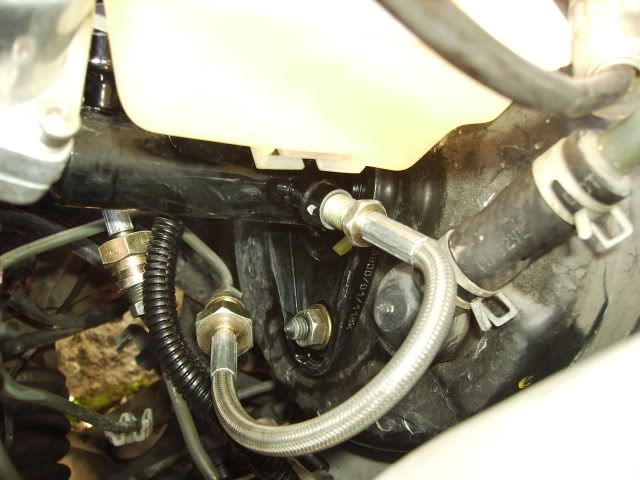

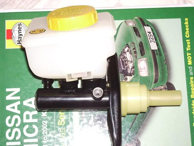

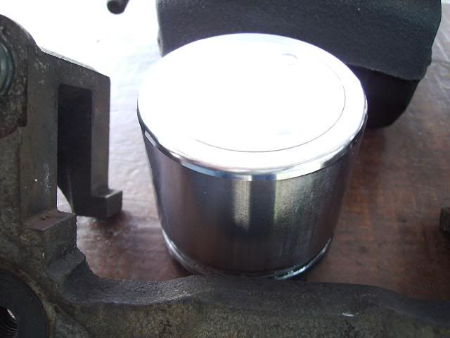

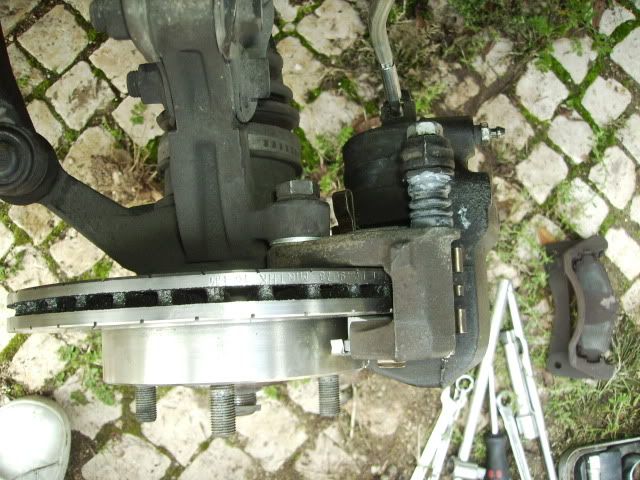

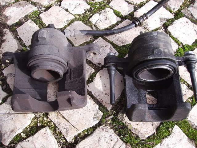

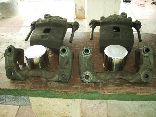

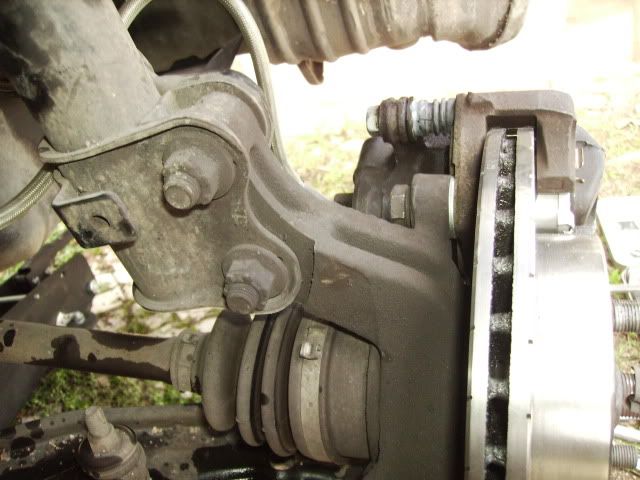

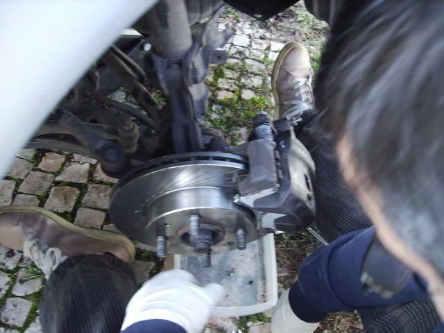

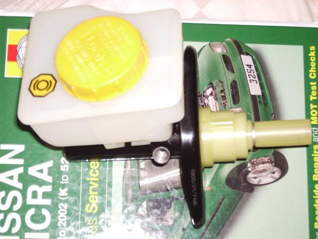

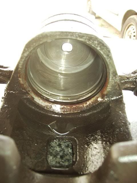

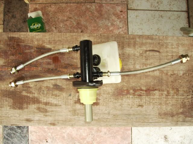

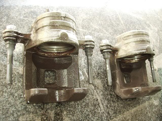

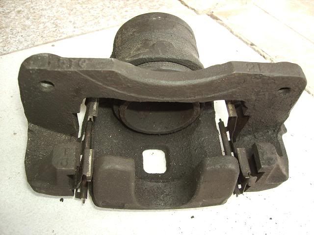

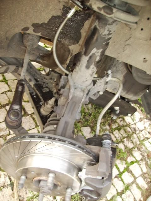

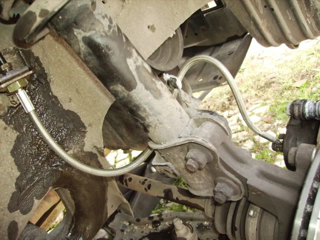

New Brake System (Almera N15 calipers + Primera GT Brake Master Cylinder + Braided Brake Lines + Tarox G88 Discs + Ashika Brake Pads + Bardahl Brake Fluid):

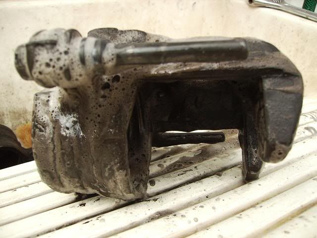

Comparision between stock calipers and Almera calipers:

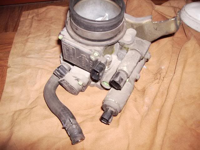

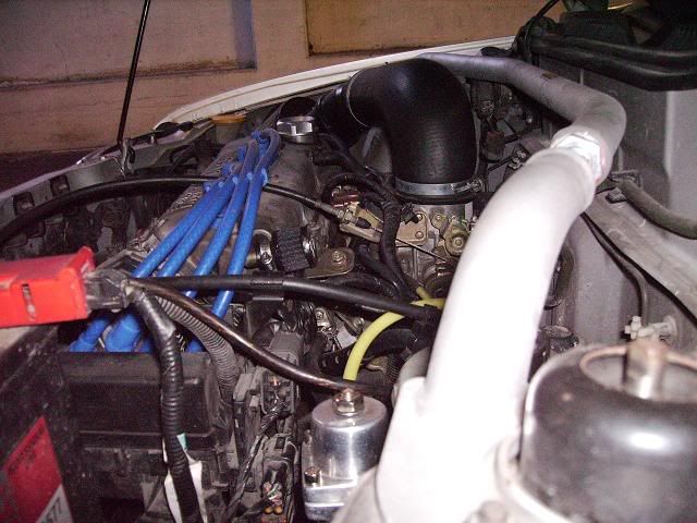

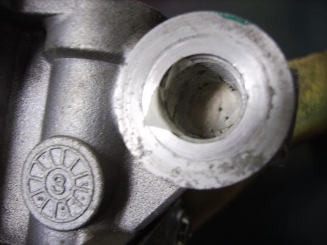

Primera 1.6 TB:

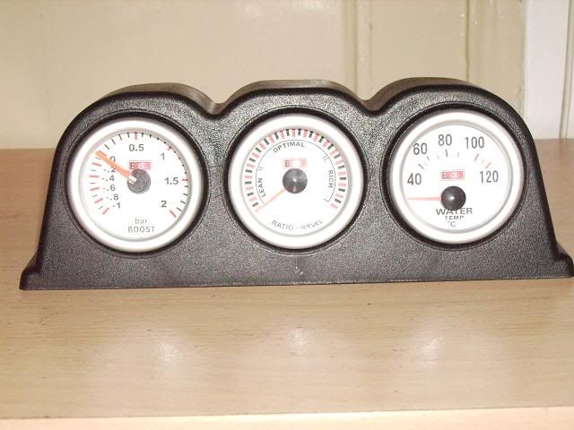

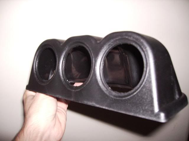

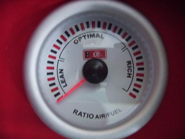

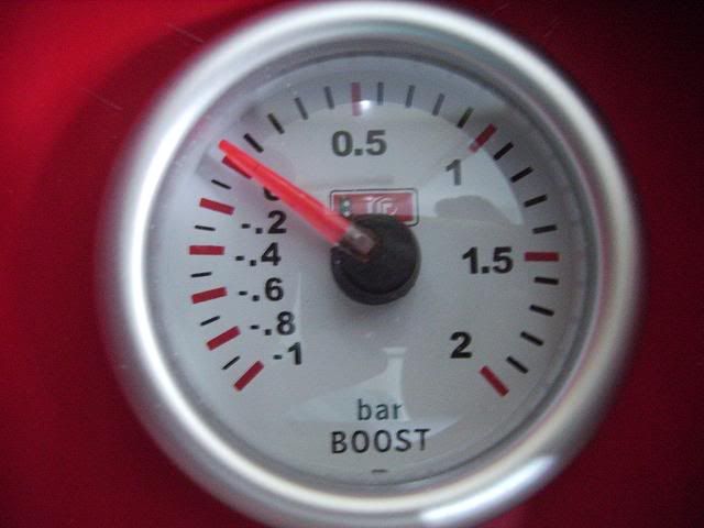

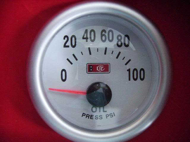

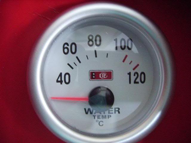

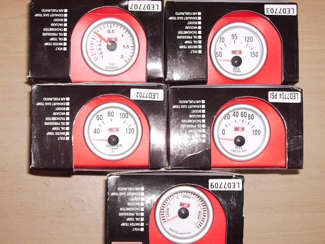

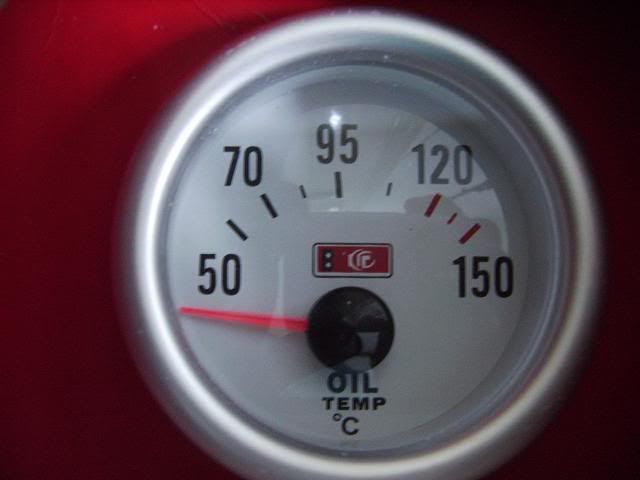

Gauges and pod:

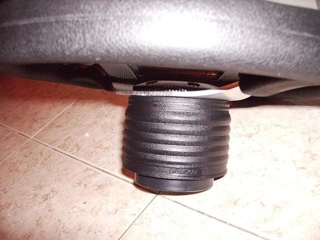

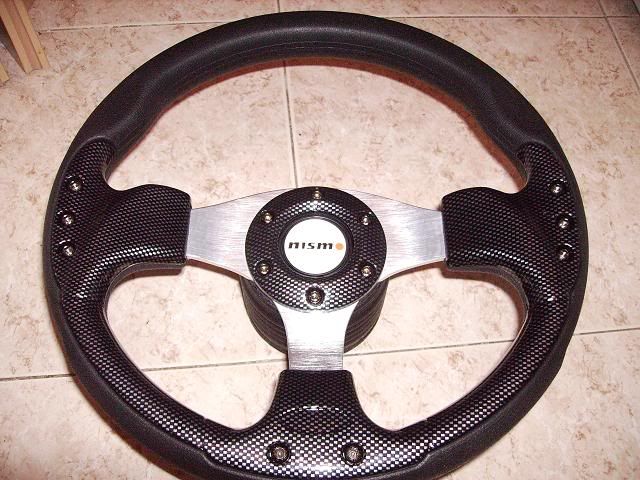

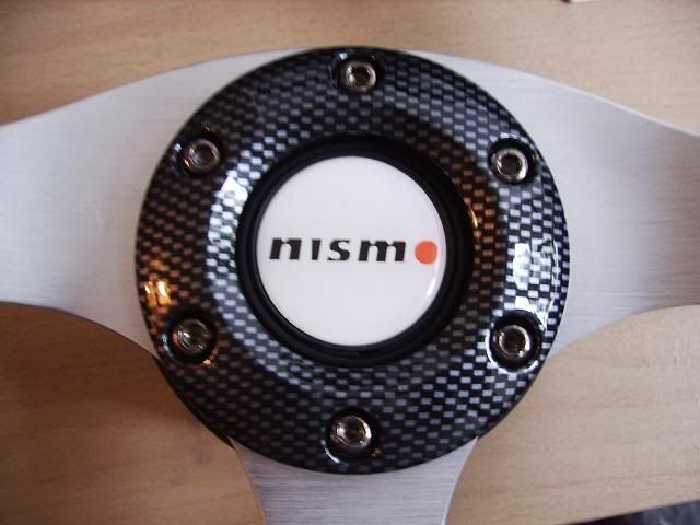

New Steering Wheel:

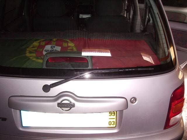

Horizontal Rear wiper:
http://www.youtube.com/watch?v=2VnMpcDZYBI

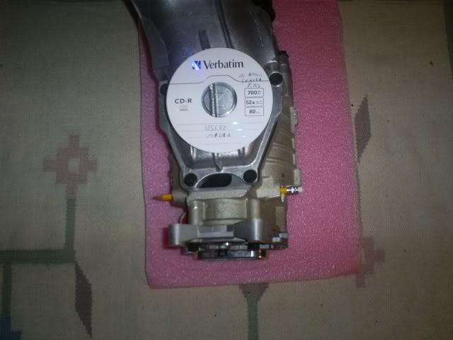

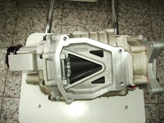

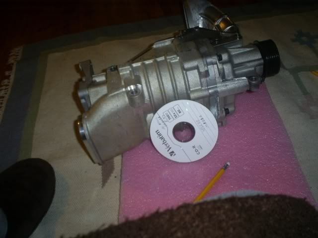

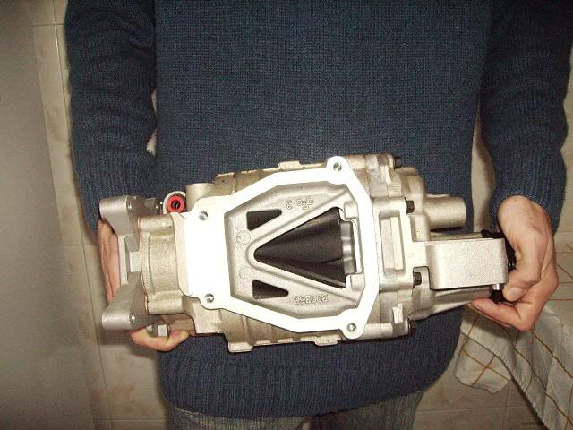

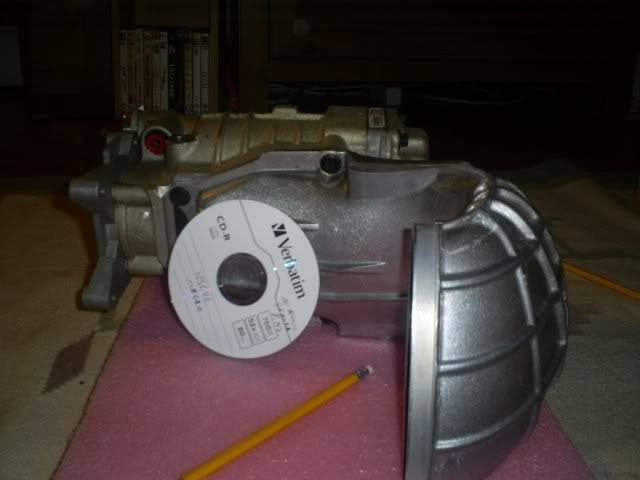

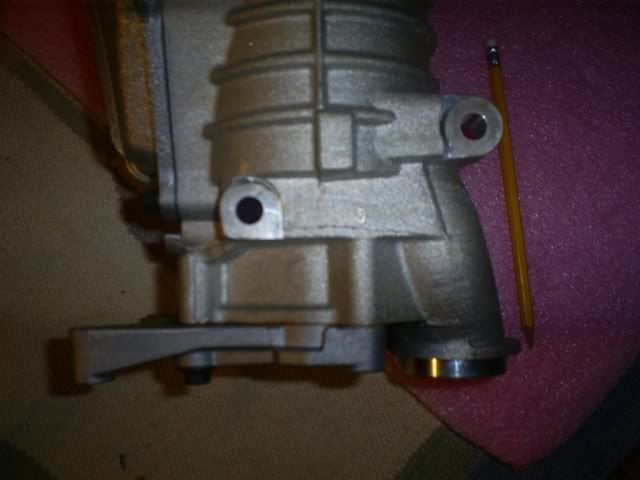

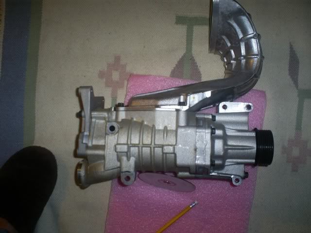

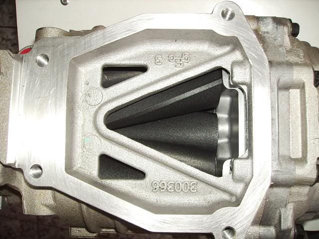

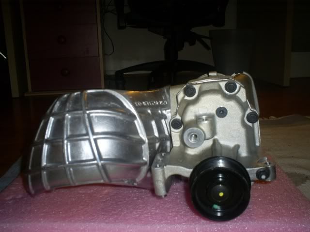

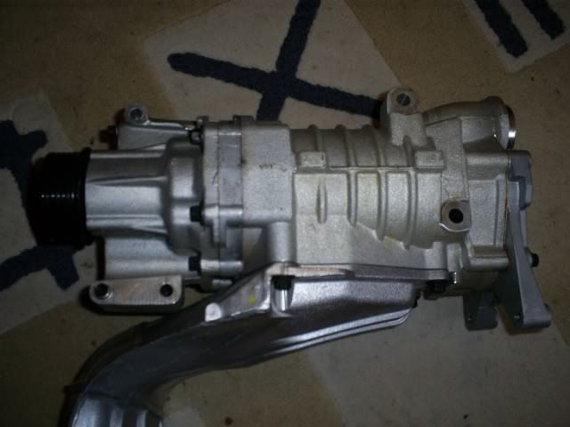

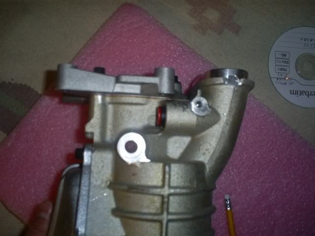

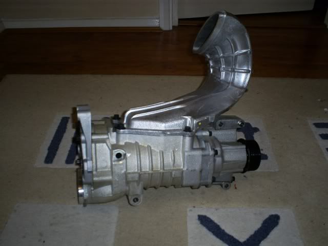

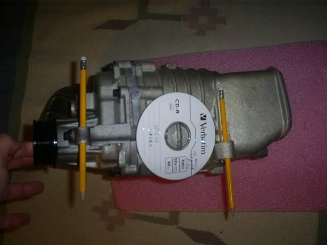

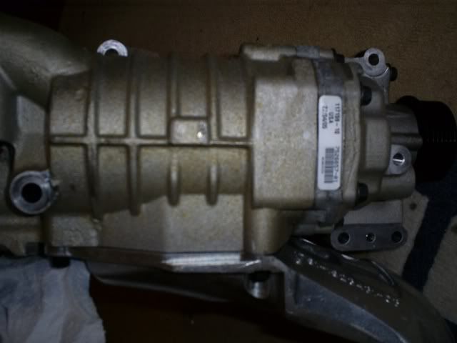

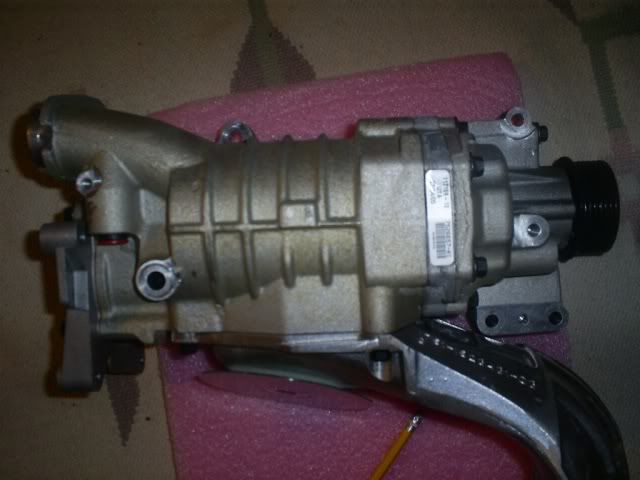

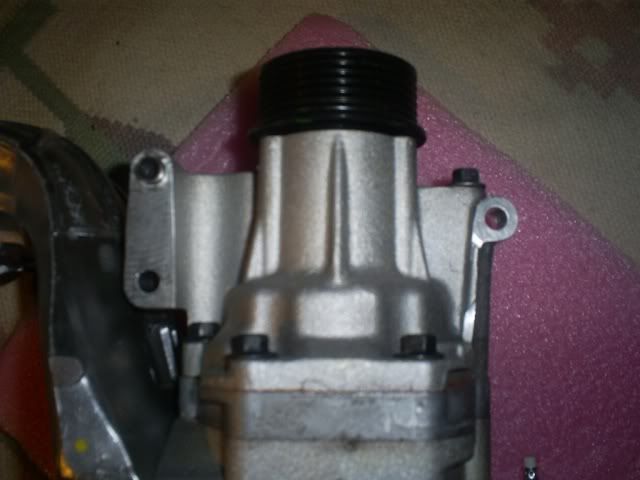

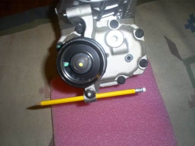

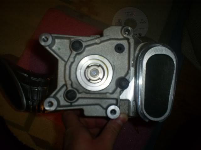

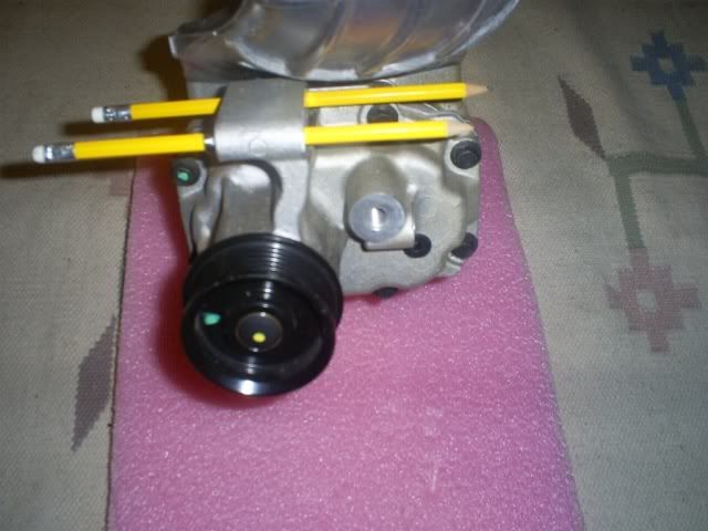

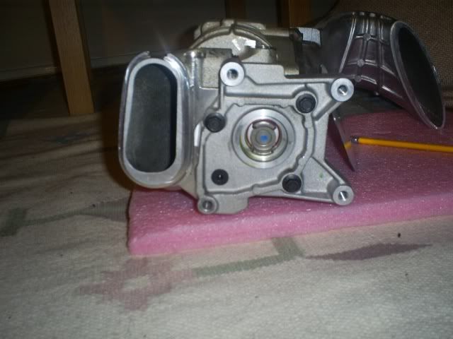

Eaton M45 Supercharger from a Mini Cooper S:
you have been busy baguete :eek:
major progress :cool:
I got some more pics to upload, i will keep you informed :p
bagas your mods are impressive. what ideas you got for the supercharger you gonna stick it on?
Thanks. I will put the supercharger on a forged 1.3. The rods are already ordered, the pistons will be ordered next month. I will use 1.2bar (SC @ 14.000rpm) on 8.1:1 CR, good for 200hp (in theory).

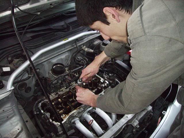

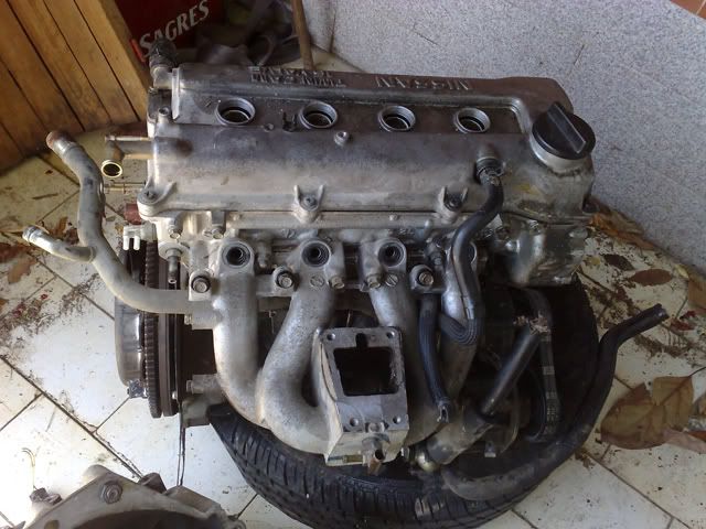

The 1.3 engine (have a spare 1.0 also):
1.6 TB:

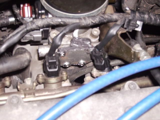

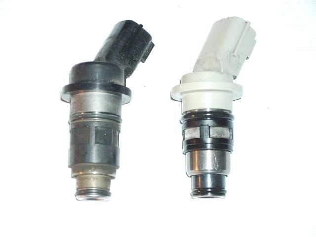

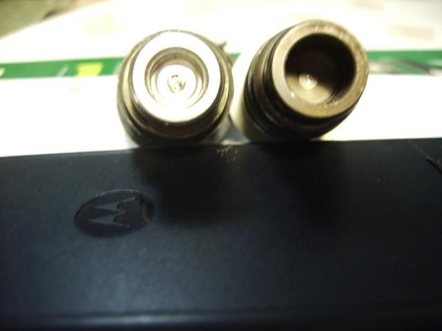

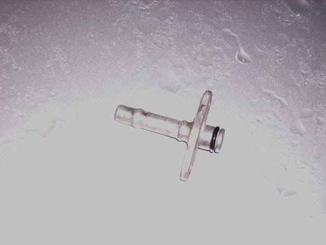

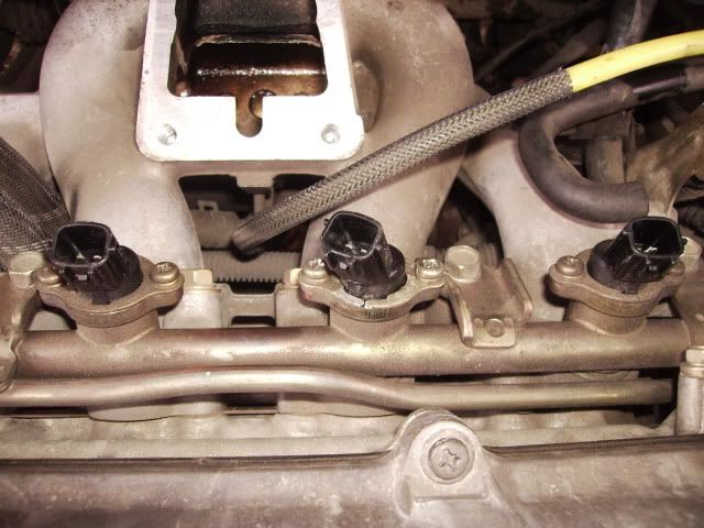

Twisted injector:

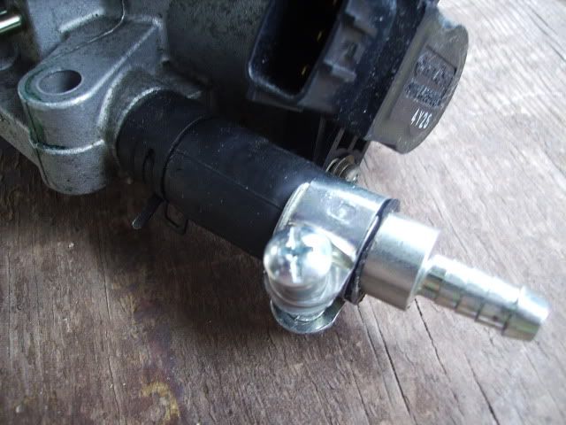

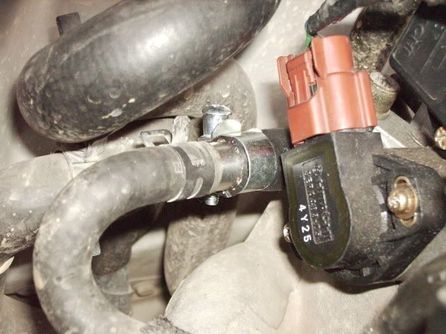

TB Water hose adapter:

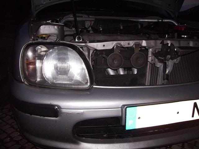

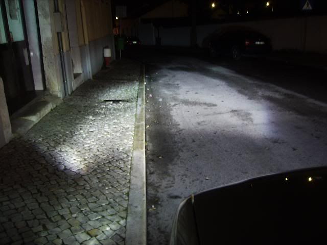

4300K 35W Bi-Xenon:

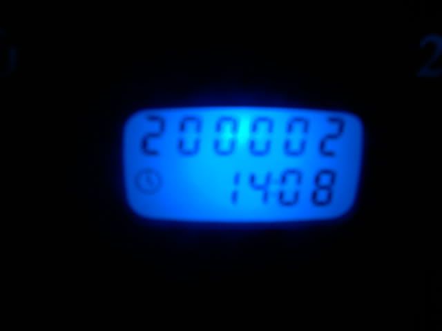

Passed the 200.000km barrier (120.000miles):

The current 1.0 will be stretched to the limit (1mm skimed and ported head, 260º/10mm lift inlet cam and remap) until the Supercharged 1.3 gets in.
If anything goes wrong with this 1.0, i will swap for the other 1.0 spare engine, but sooner or later the 1.3 goes in.
ok i see what you mean now. cant wait for that mini supercharger to go on a micra 1.3.
I want the supercharger project done until summer... Lets see how it goes.

Awesome blog, great with all those pictures. I was wondering, are those calipers from a 1.4 or 1.6? I picked up a pair a while back but the coding seems slightly different than yours.
I took them from a N15 1.4, but the calipers are the same for 1.4, 1.6 until 98 and 2.0D...

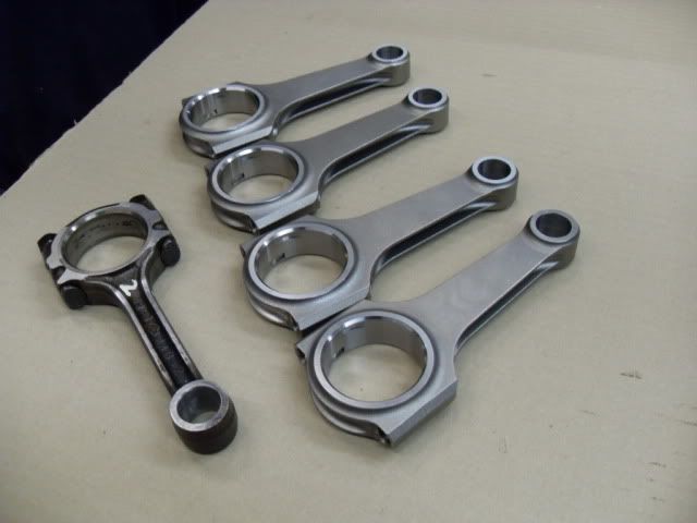

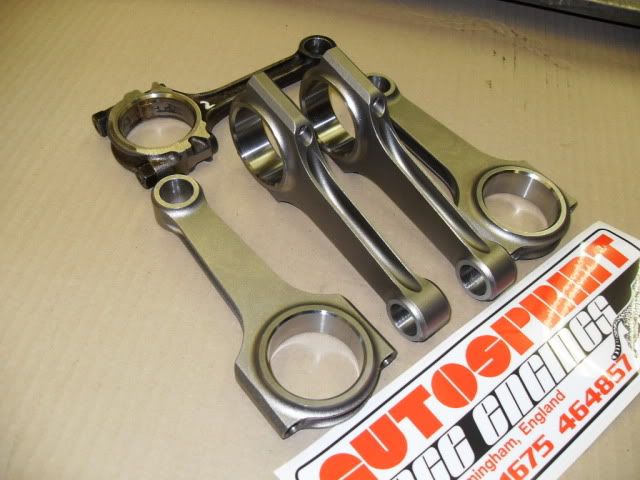

Frank guided me to Autosprint, and Geoff made these rods:

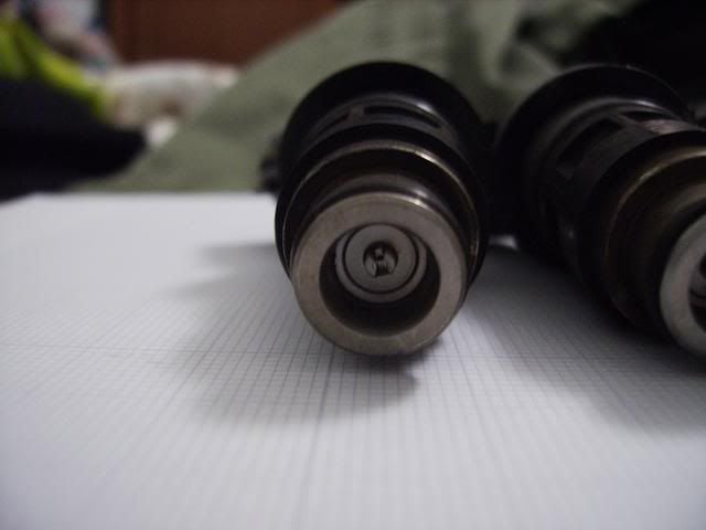

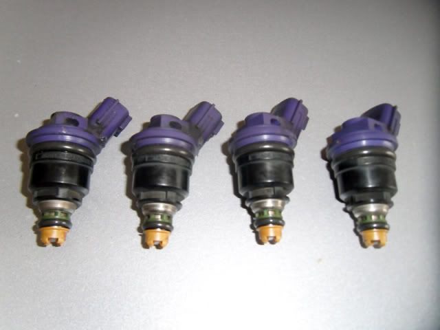

Manage to get some S14a SR20DET 370cc injectors:
Just need an SR20 fuel rail adapted to fit Micra, can anyone get in touch with Kristian? Sent him a PM a week ago, but he didnt replied. Thanks

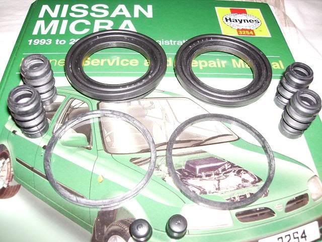

Made some changes to the brake system, the pads were like sh#t, changed them with Bendix Pads, Discs were mounted with the grooves pointing forward and were put the right way, pointing backwards, and the most important, the brake lines on Primera GT Master Cylinder were mounted incorrectly, the front left wheel was braking less then right wheel, its ok now and braking real good.

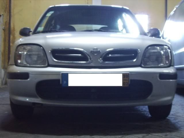

Changed the trunk dampers and put the Facelift 2 chromed grills:
