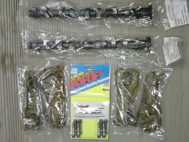

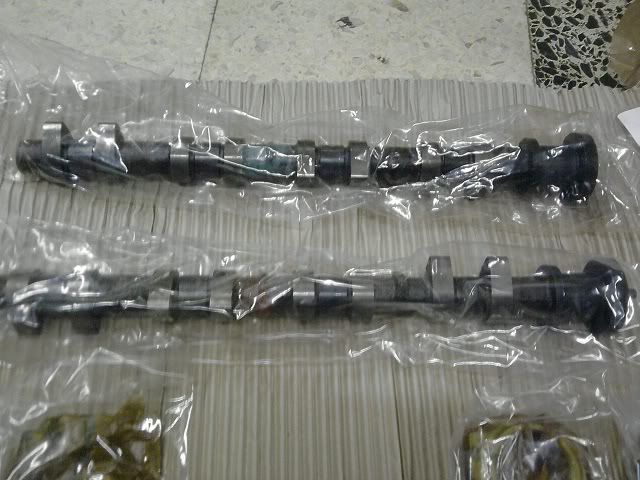

Maybe 3 more months until i get the pistons and the other parts, but half of the way is made...![]()

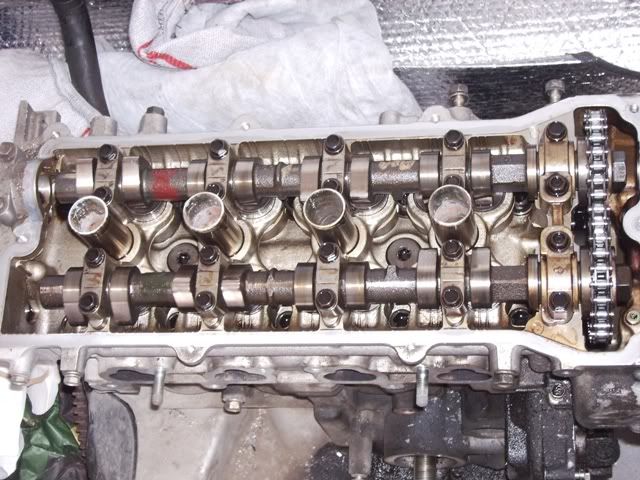

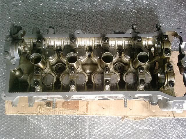

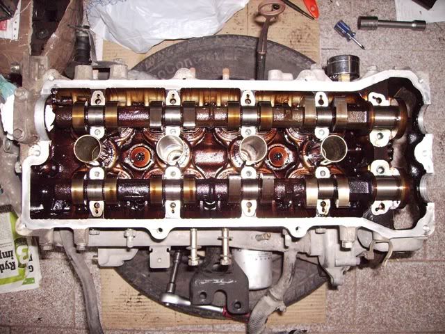

They look strange, got to compare them with the stock cams, they seem to have lobe re-worked, but the lower side seems to be same as stock, yours are almost at the same level as the body of the cam... What do you think about that?
he,s took 2.5mm off the base circle and nothing off the lobetop basicly baguete, and changed the timings from 42 0 0 42 to 60 20 20 60 (you wont be disappointed :grinning![]()

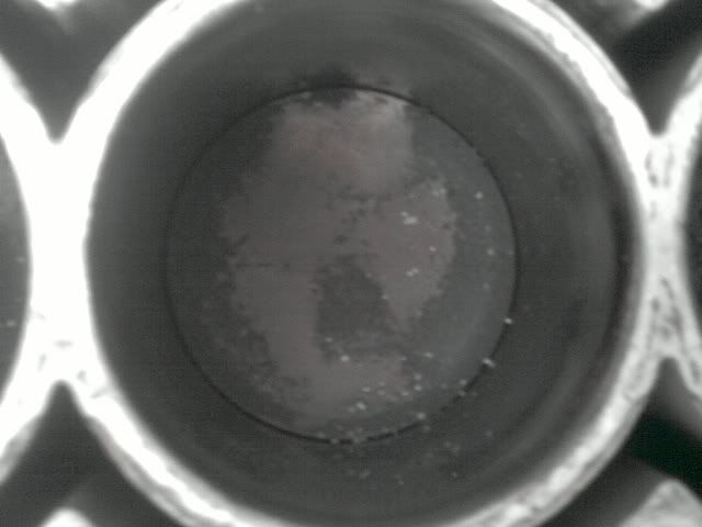

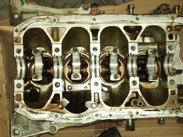

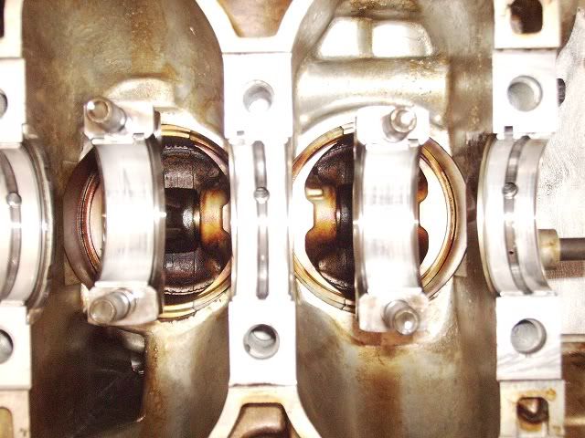

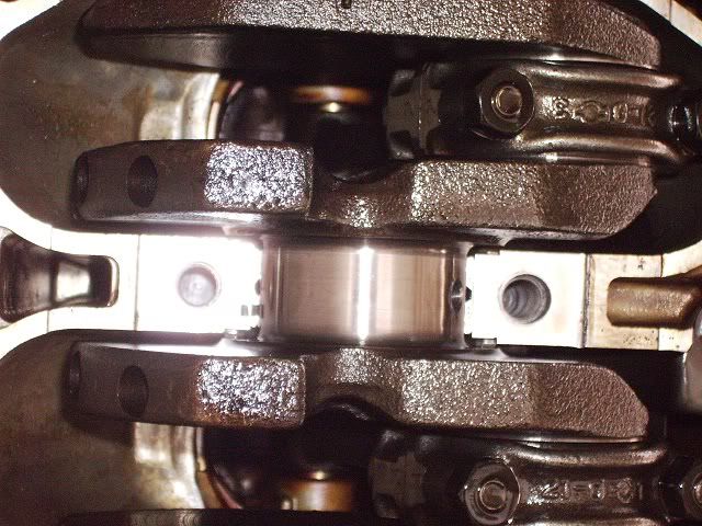

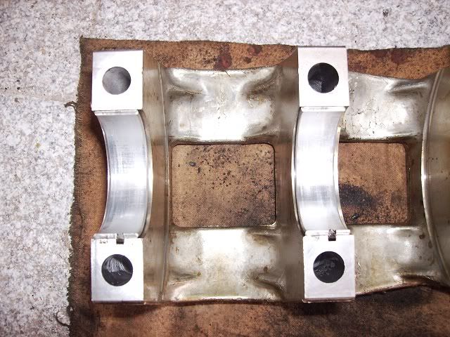

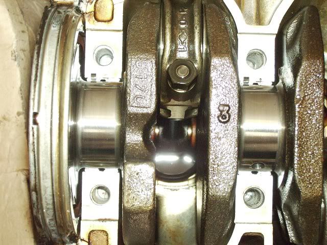

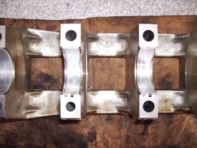

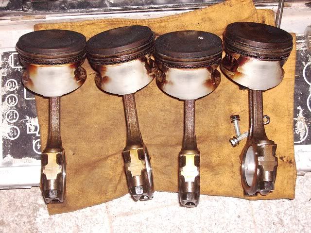

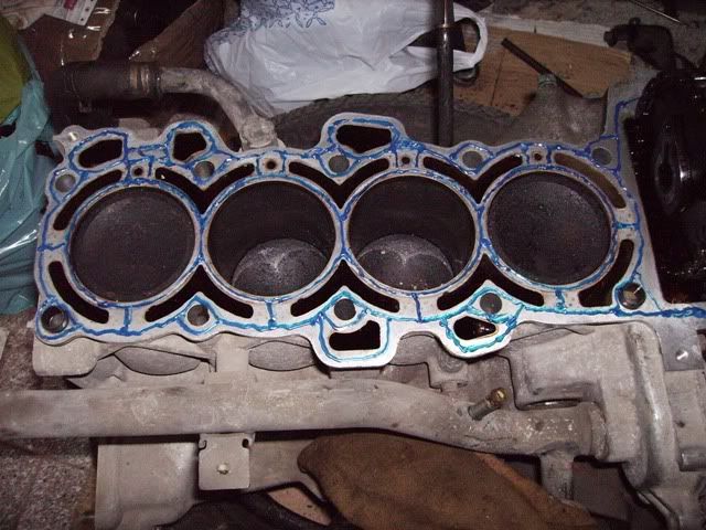

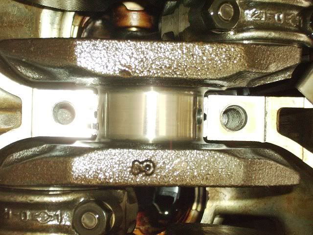

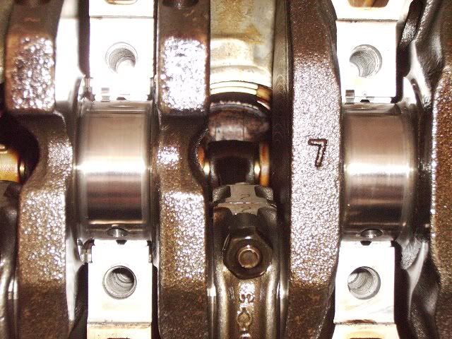

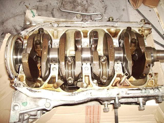

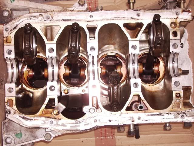

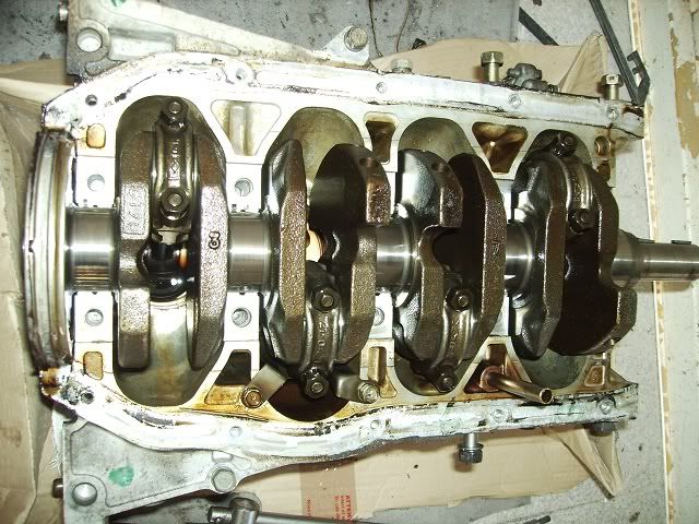

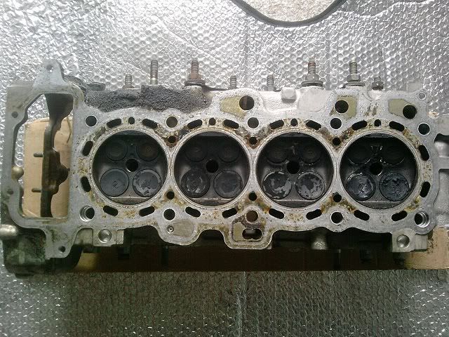

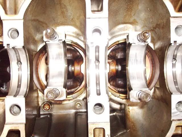

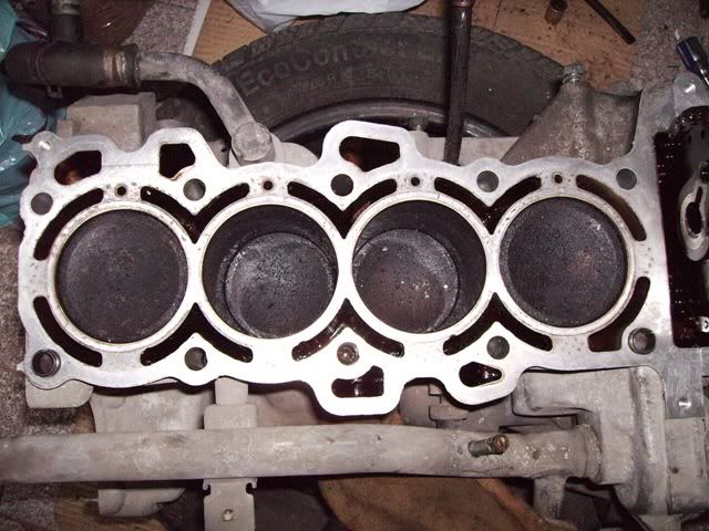

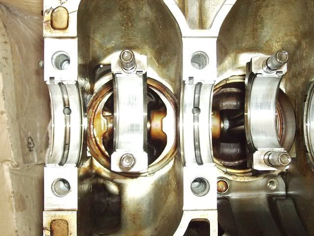

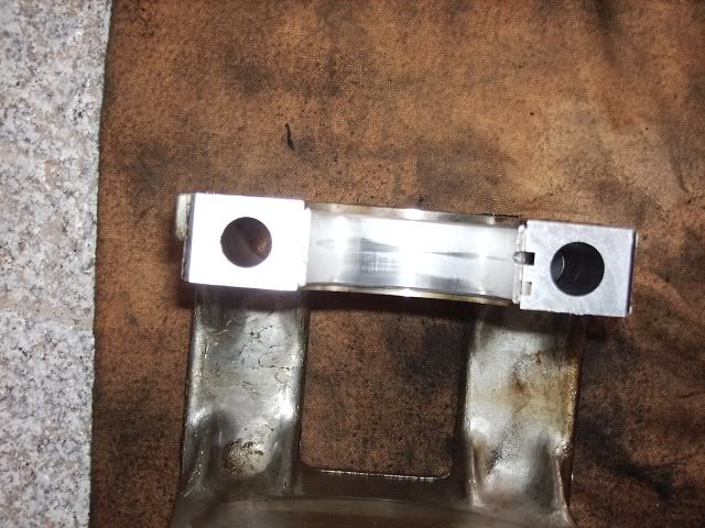

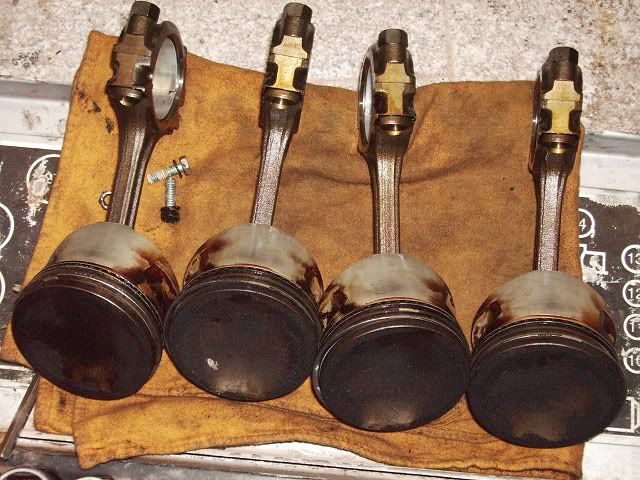

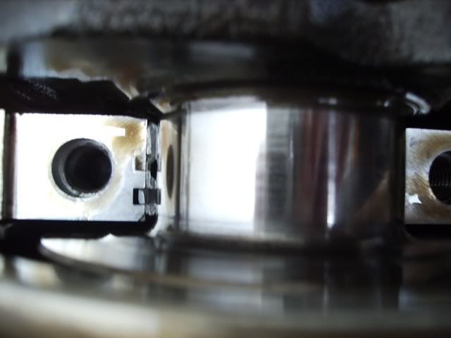

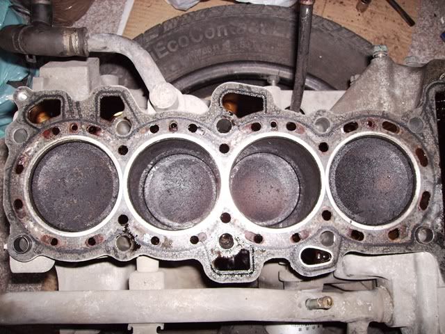

those journals look very healthy eh baguete, the rings look clogged up with snot tho(not as bad as mine were)

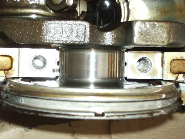

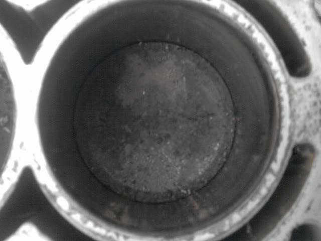

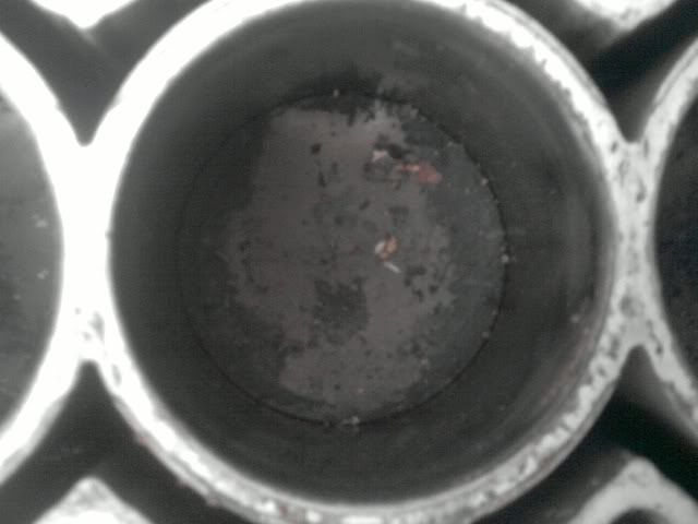

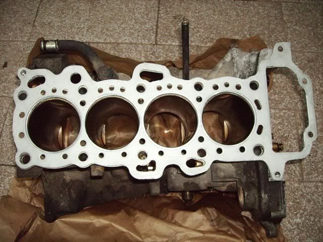

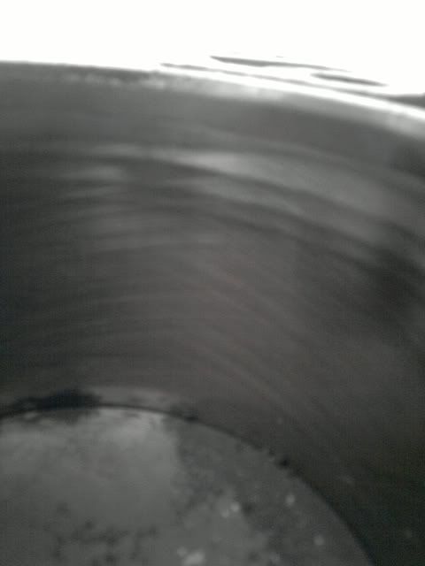

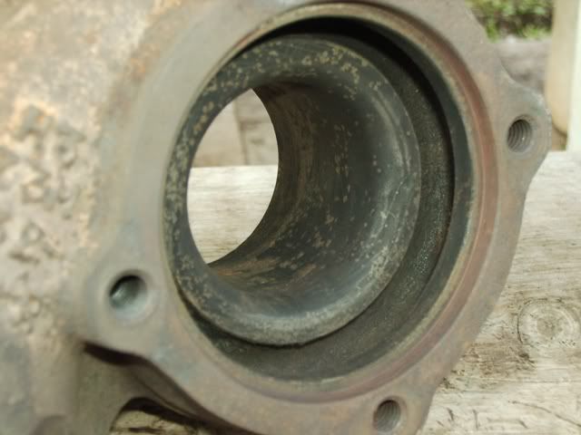

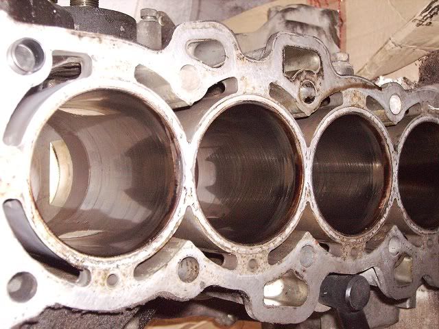

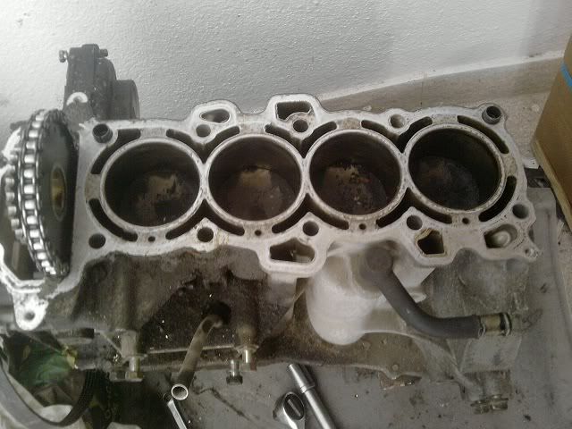

Is it normal to have a 0,10mm (0,004 inches) between the piston and the cylinder bore?
haynes says .01 to .03mm (.0004" to .0012 = .4 to 1.2 thou) ? that sounds very tight to me fwn
i never measured mine baguete, but i think you would see some bruising if there was any "slap" and yours look fine to me (you did measure here btw ?)

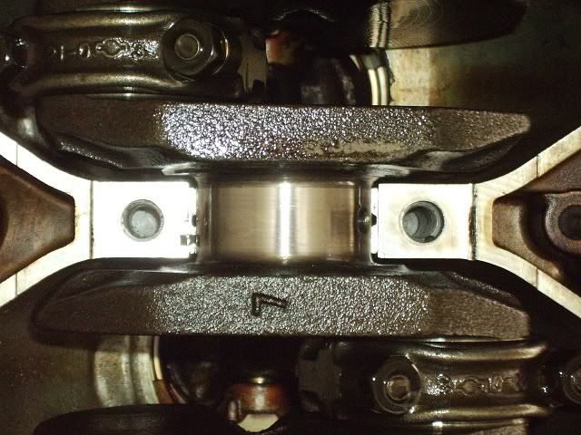

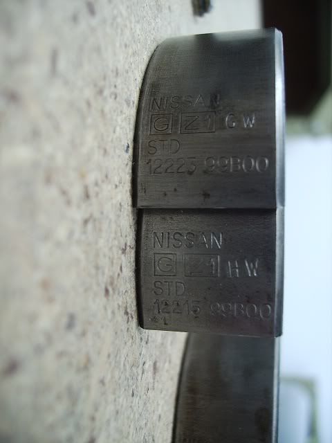

BTW, the crank journals have a part number that i cannot find on Nissan Parts Catalog, what part numbers should it have? The crank marks are easy to find, but where do i find the block marks to select the right journals?

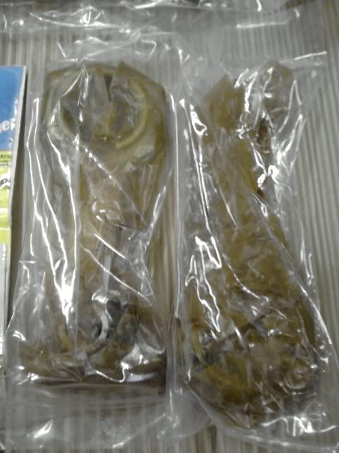

Once you hear it that won't matter! i was the same.Yeah, they told me that they were out of stock, that it would take 2 weeks, but hey, very quick deliver... (Y)

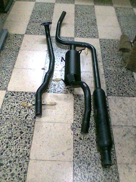

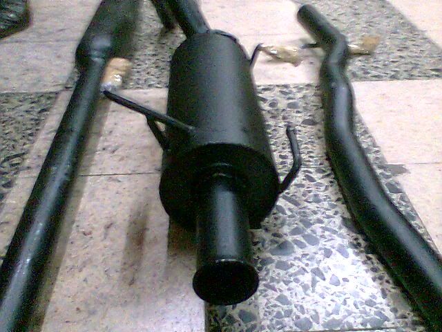

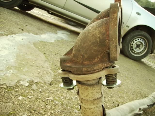

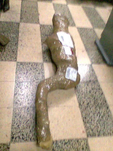

But the same old story, bad packaging, some scratches on the exhaust... fwn

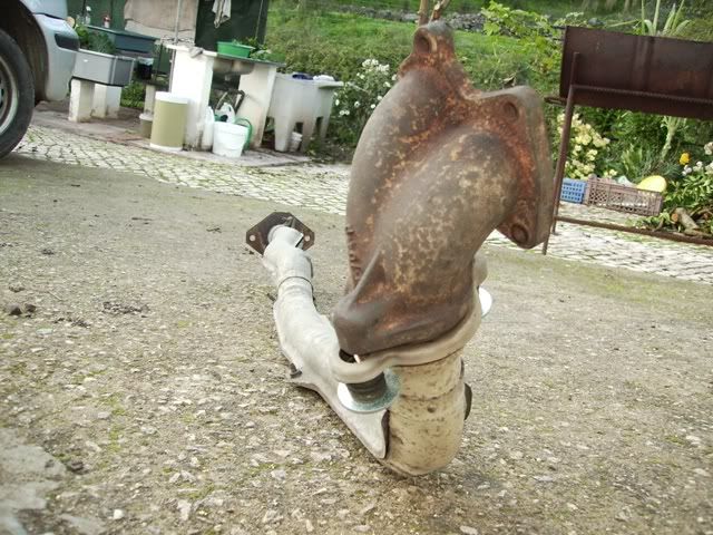

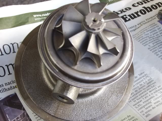

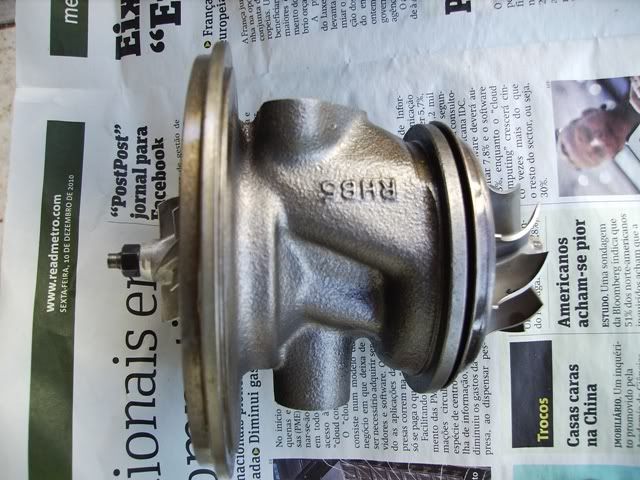

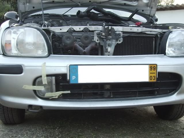

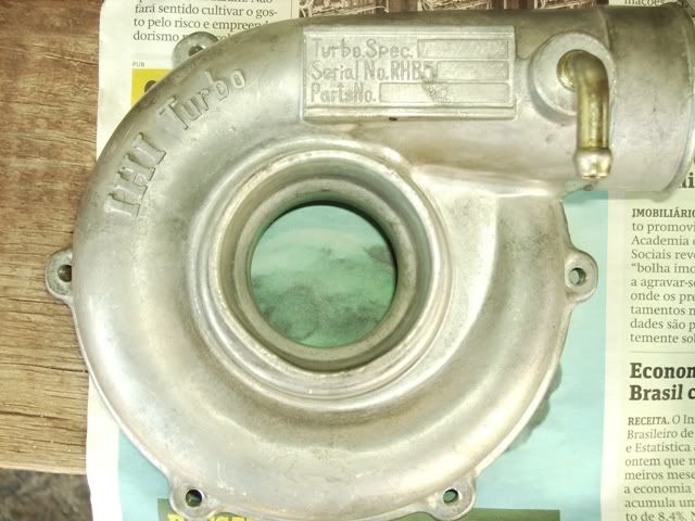

Looking smart mate! That turbo has come up nice! So many turbos on the cards these days![]()
Thanks mate. (Y)

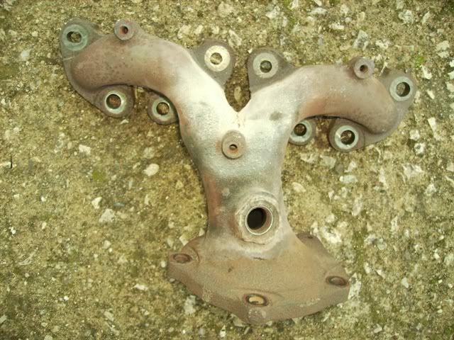

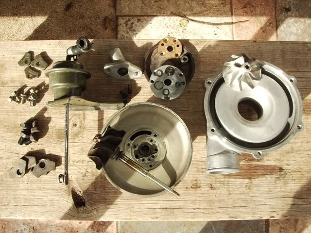

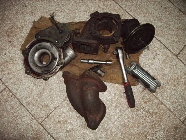

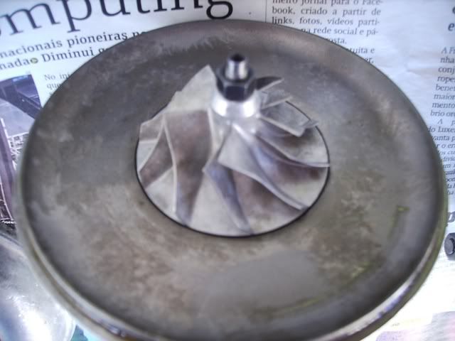

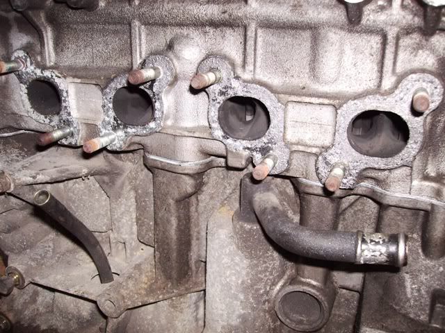

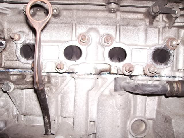

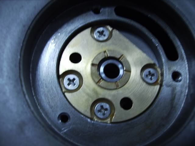

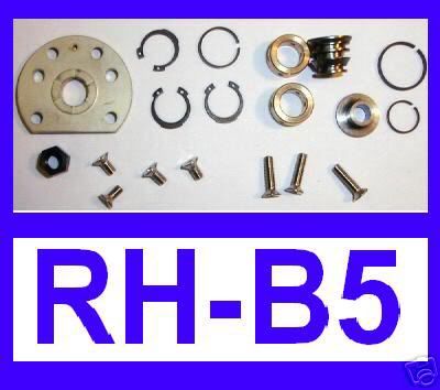

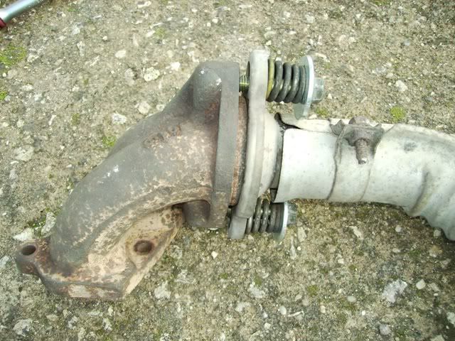

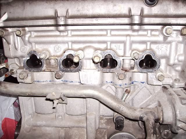

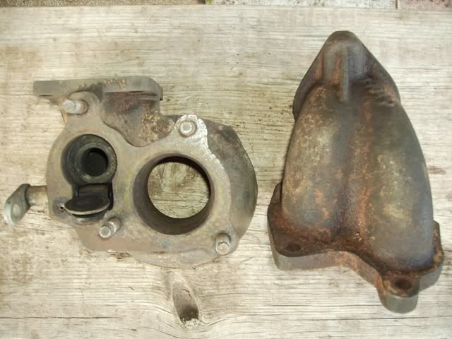

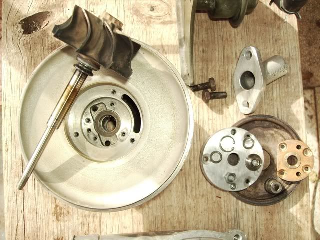

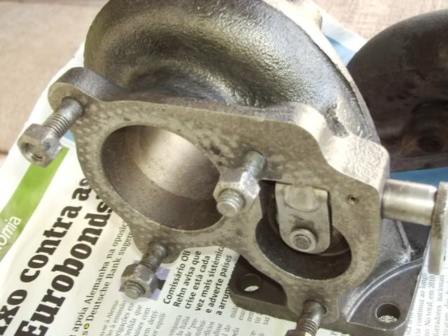

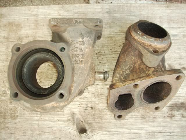

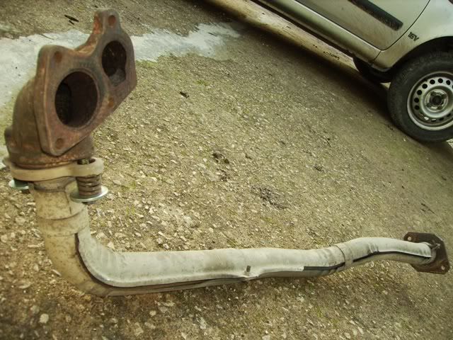

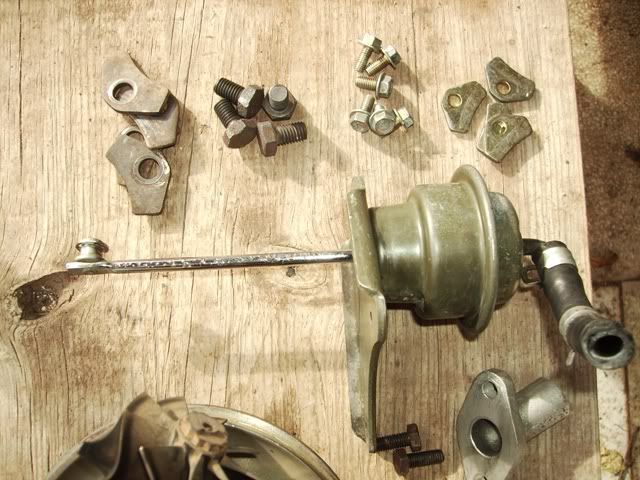

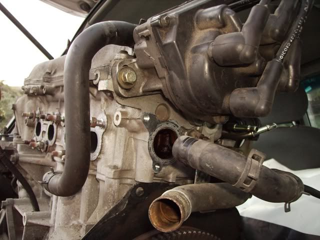

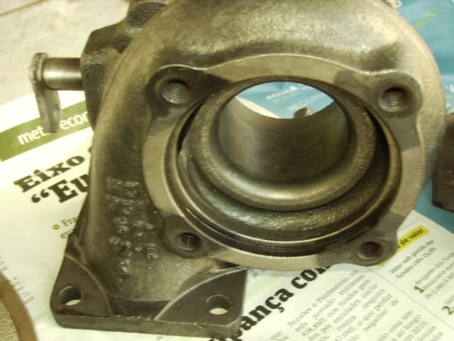

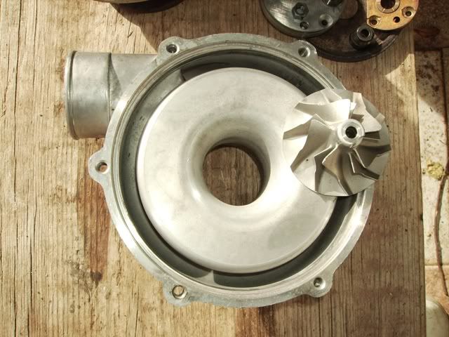

That turbo is an IHI RHB5 from a Ford Fiesta 1.8D Boss Turbo, quite big, i cant go for low mount or top mount, i think i will go for "middle" mount. Im just checking if the stock manifold can be used, otherwise i will talk with you about a butt-weld manifold like yours. :grinning:

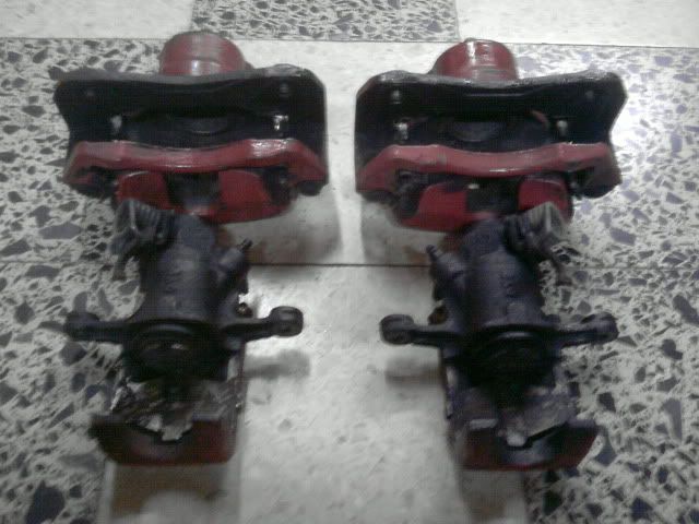

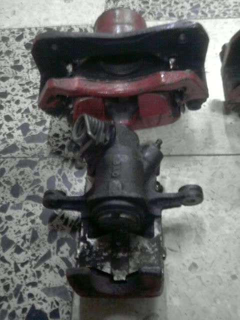

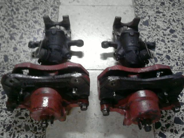

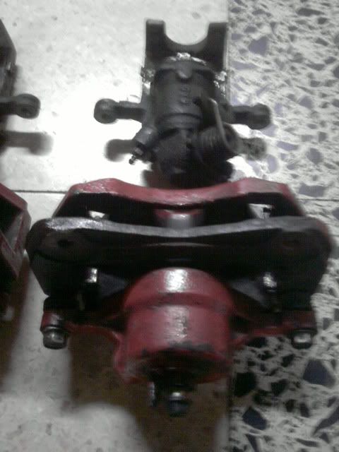

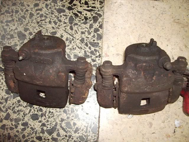

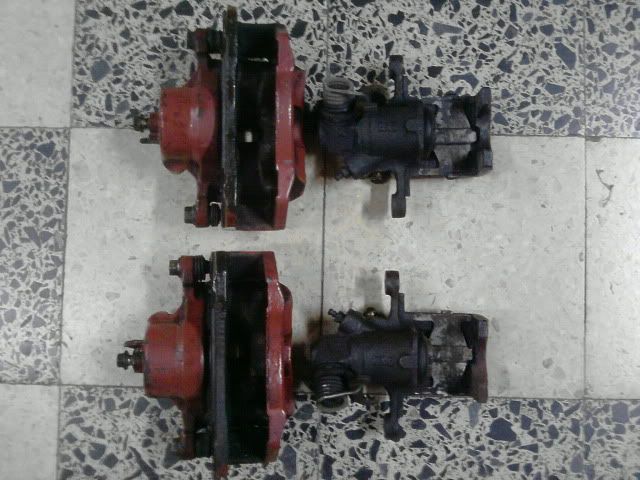

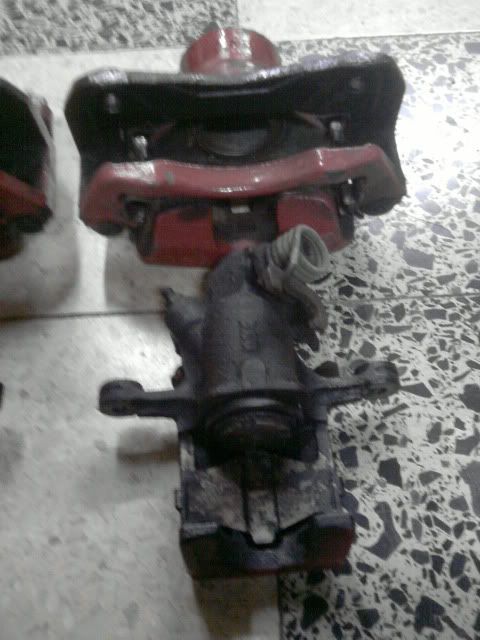

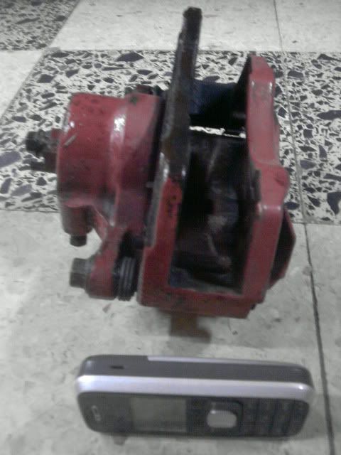

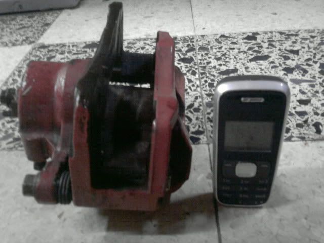

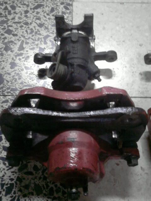

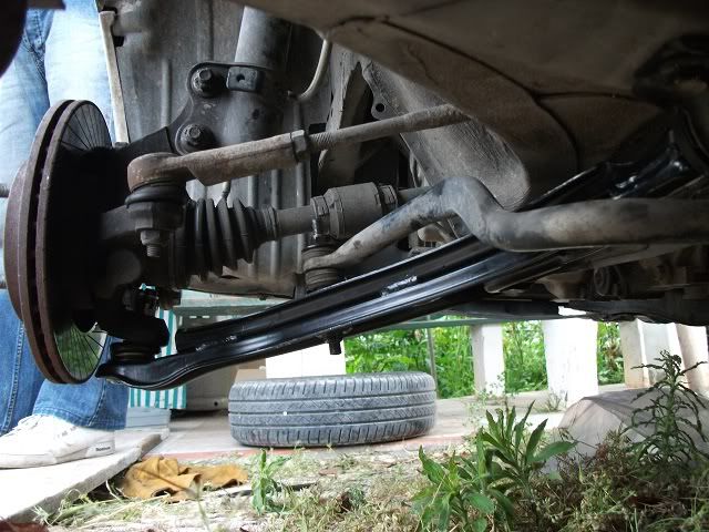

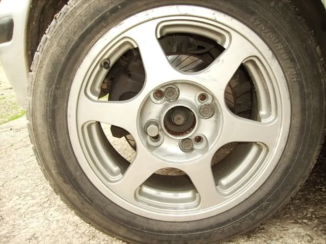

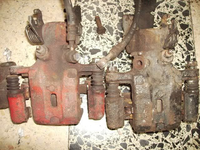

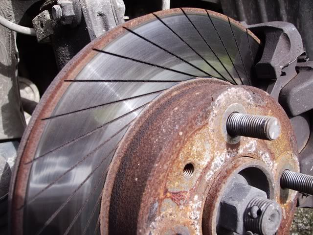

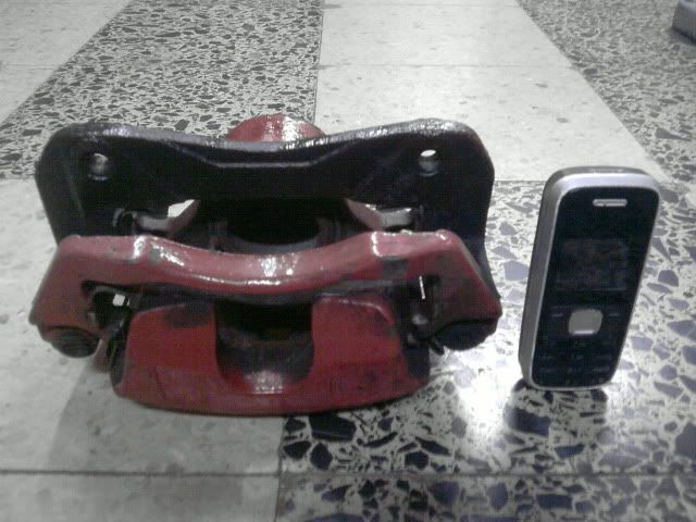

did the rear calipers from gti-r fitted easily?
simple replacement?
what's the mm of your rear discs?
No problem, im making a couple for people in the next couple of weeks so gimme a shout and im sure i can knock you something upshould be able to place it wherever you want within reason.
whats wrong with a top mount for the turbo? looks like it would work to me?
