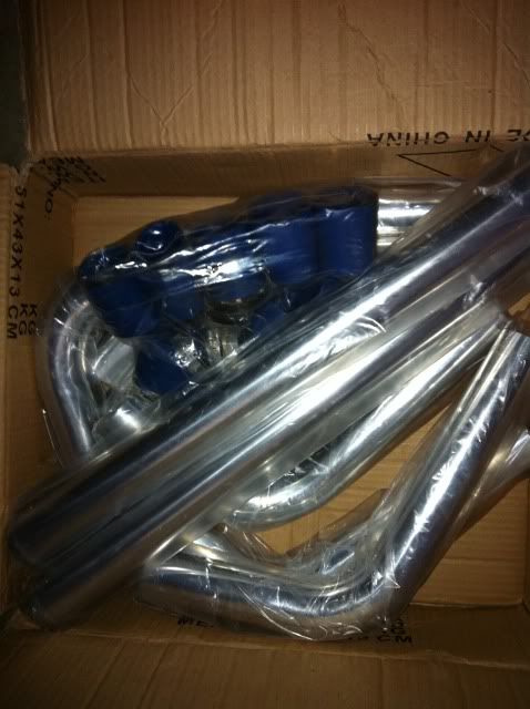

Just ordered a "universal' 2" intercooler piping kit from 999 Automotive :)
Just need a 2.75" > 2" reducer (throttle body) and I should have all the boost piping I need. Just manifold and dump pipe.

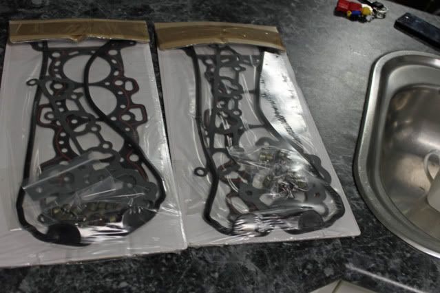

Tomei metal head gasket (0.5mm) ?? Found a gasket shop on ebay too, they have a standard one. Plus exhaust and intake mani gaskets, rocker cover gaskets and a few other bits and pieces

.5mm is a bit small for boost? And be running a bit high then normal with compresssion, you would want to try and Tomei only stock .7mm metal head gaskets, a few fellows on here are running standard or double standard head gaskets for boost they want

Think I'll go the double standard when I do it. More a "safe than sorry" kind of thing.

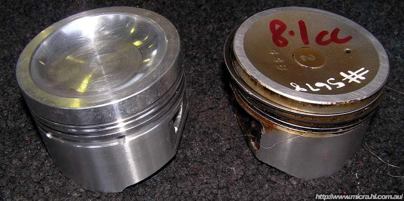

a .5mm one will raise the c/r by about half a point eh (10:1)
i find this a good calculator <a href="http://www.csgnetwork.com/compcalc.html" title="http://www.csgnetwork.com/compcalc.html" target="_blank">http://www.csgnetwork.com/compcalc.html</a>
2
71mm
80.5mm
72mm
1.2mm
26cc
-6.5cc
0
Shoot.....that's thrown my calcs off. I always went on the pistons bowls being 8.1cc and not 6.5cc. Ciscos Jap CG13DE must have been an oddball perhaps....
<br
tbh the calculations tally with the (flat-top and 63mm stroke) 1.0 calculations if you use 25cc for the chamber and 7.5cc for the 1.3 dish dave.
the numbers i posted were from using a syringe and are probably + or - about 10% eh

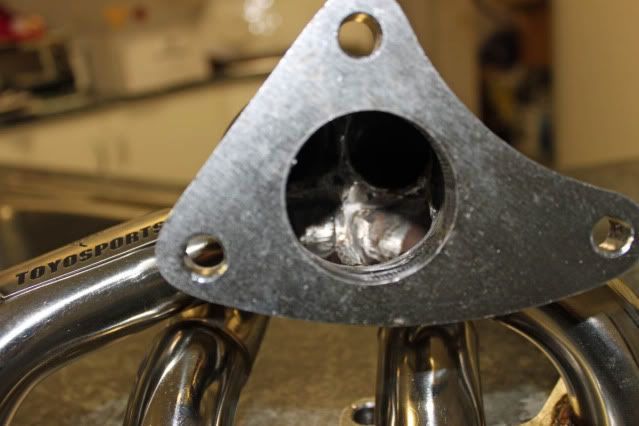

thinking about copying Stani's glanza manifold idea and running with that now.

Just bought 2 of these kits (double headgasket if mine goes) and helps me out with manifolds etc if I have to take them on or off.
New rocker cover gasket so I can take this one off and clean it up :)

And copying Stani here:
http://www.ebay.com/itm/400164231279?ssPageName=STRK:MEWNX:IT&_trksid=p3984.m1439.l2649
Sizing it up and measuring, my manifolf just wasn't getting the turbo high enough to clear the alternator. So this will help.

Those pipes look heaps to big! And that manifold will need to be cut, and a micra flang weld on if you don't already know!

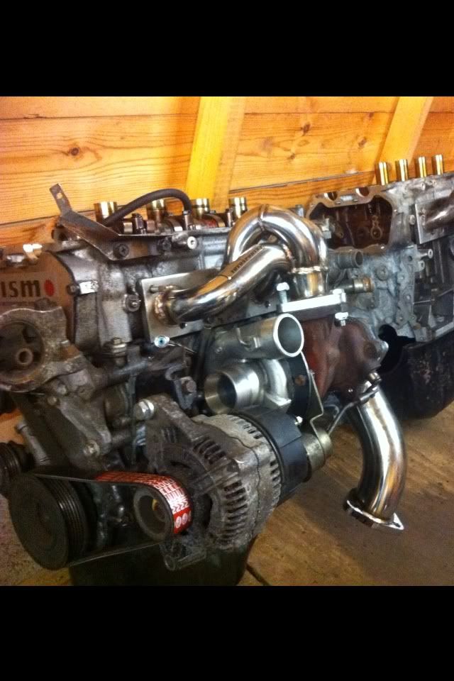

Well Im pretty much copying this effort RTK,
requires spacing the alernator out and getting a longer belt but small problem in comparison I think. Might try and get the turbo flange a little bit higher (possibly to the right aswell) and may not have to do that.
He's using a modded RB25 rail and injectors.

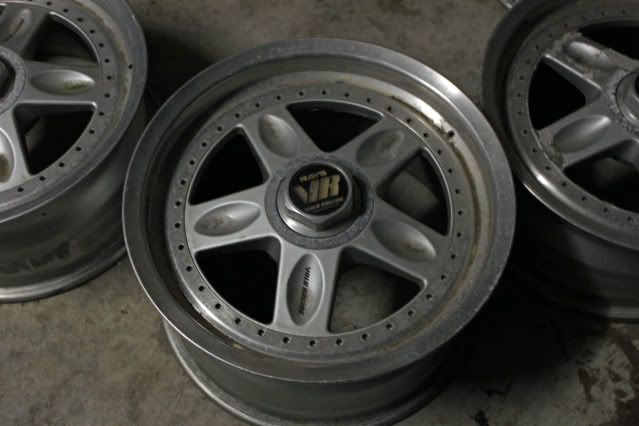

And now have these in my posession :)
Fronts: 16x7 +35
Rears: 16x8 +38
Should fit quiet well I think, worst case will be inner clearances but they wont go on till it's been lowered, sway bars etc..well I think thats the way anyway. Got a motor to do first...

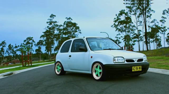

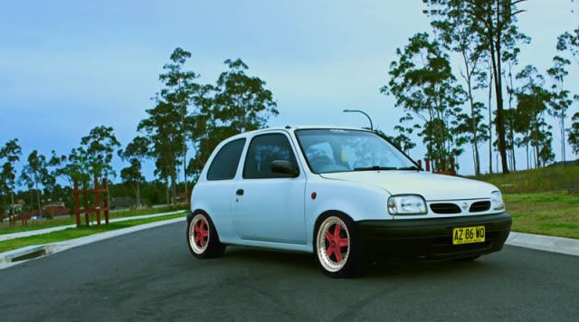

rims in blue with chrome lip :D and maybe with the turbo try high mount? so you dont have the problem with the alternator?

^lol you read well :p
turbo is higher mounted with this mani, was gonna use the standard one but ran into problems, hence copying the other guy that's done it already :) He's cool with it lol

yeah cant use the standard manifold, will be best to go get a 12-15mm one made up same as you manifold and go from there

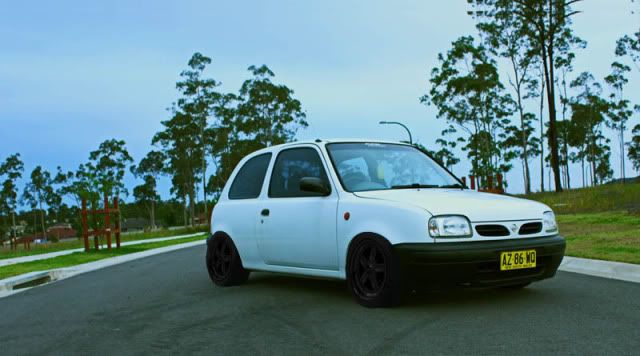

Nice little write up.mate, looking forward to seeing how it turns out =}
Your rims in the gold (but with polished lip) would be nice (and different) but black with polished lip (gives it a panda look lol) looks tuff..need a nismo grille =}
