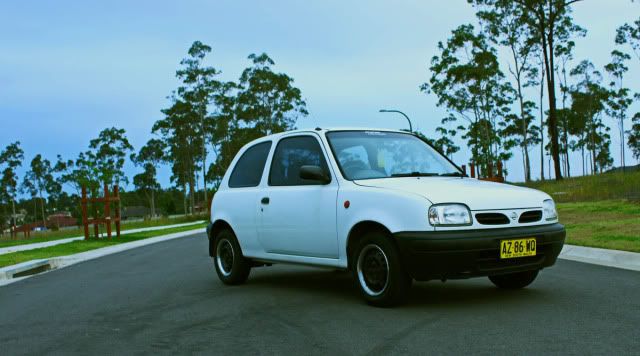

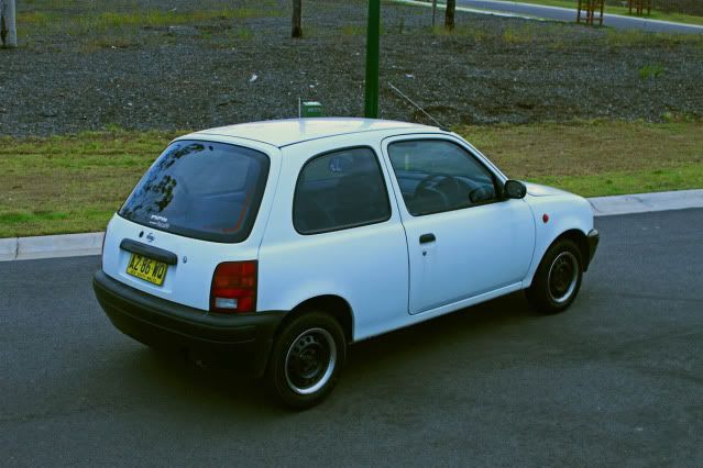

Howdy all, only recently got into the Micra fold when I purchased a 1996 K11 as a cheap runabout to work. My girlfriend has a K12 which made looking for cheap economical cars lead to Micra's ;)
Anyway, its to save this beast and try and look after it better with less km's etc:
2004 Mk4 R32
So I picked up the Micra, has the JDM cupholder option which I'm told is pretty desireable! Had a cold air intake (well filter sat over the top of the exhaust mani!)Glad it's 5sp manual!
And took a few snaps

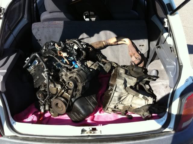

The car has noisey lifters but I wasn't worried initially. Then looking for "where to get Micra spares if..." I came across this site.
The girlfriend moved to Orange so making trips out that way (suited the purchase) I found some goodies outside of Windsor ;)
You'll spot a spare CG13DE, manual 5spd gearbox, 2 driveshafts and a set of headers. Spares indeed!
No clutch or flywheel (or flywheel bolts or gearbox bolts so need to acquire those)

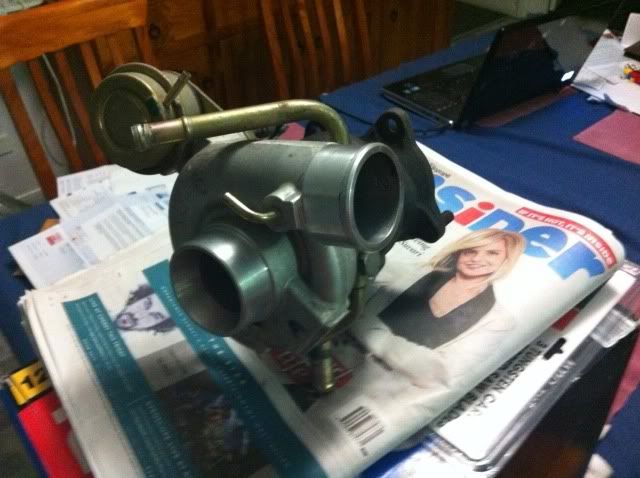

onto the space CG13 and see how it goes. It's a TD04L off a WRX 2L and I got it for $100 bucks. I'm doing this as cheapily as possible for sure.
Main objective is decent torque to go over the blue mountains, I dont like revving the freckle out of the little Micra!

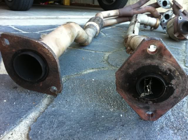

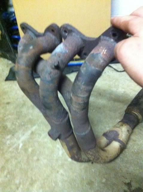

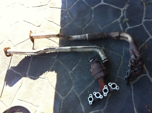

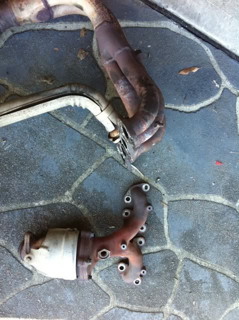

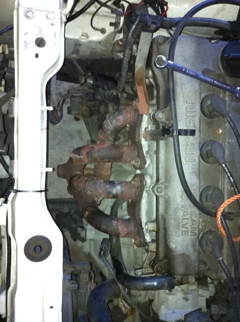

I was planning on making a manifold out of the headers and buying flanges for the exhaust mani and dump pipe to suit a TD04, but late on Friday afternoon decided to use the standard cast exhaust mani instead, so went about installing the headers.
-No idea what brand they are?
-Wasn't too hard to install myself, only really required removal of the alternator.
-One stud has no nut on it (the lower right one when looking at the flange from the front of the car as there was no clearance left (even after filing the washer down to fit in there)
-I have plenty of leaks but I decided to do it at 4 o clock on Friday afternoon so haven't replaced the gaskets, will head to an exhaust shop hopefully this friday and get the gaskets replaced.
All fitted up
Flanges have been ordered and should be here this week so I can start planning this build.

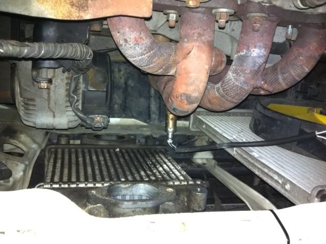

My intercooler idea was to get an RX7/S chassis Nissan/GTIR cooler and mount it next to the radiator. Point the compressor outlet down and do a 180 degree turn into the bottom of the cooler, hen out of the top of the cooler over the motor into the throttle body, but am open to suggestions.

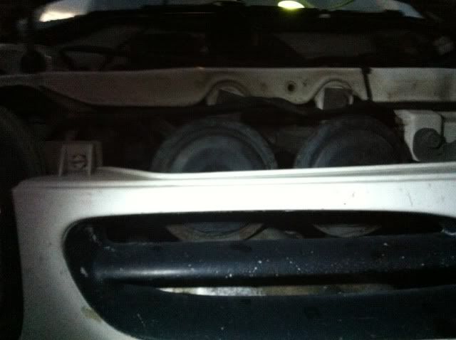

Well here you go, wasn't hard to rig up lol.
It will be tighter than a nun's nasty I'm thinking but hope it will work. Damn I hope I can get it to work haha.
Probably relocate the horns and mount the cooler off the horn bracket + other associated tapped holes/threaded studs around the place.
With the horns gone it'll be up much higher :) you can just see it (sorry about pics, its getting dark here)

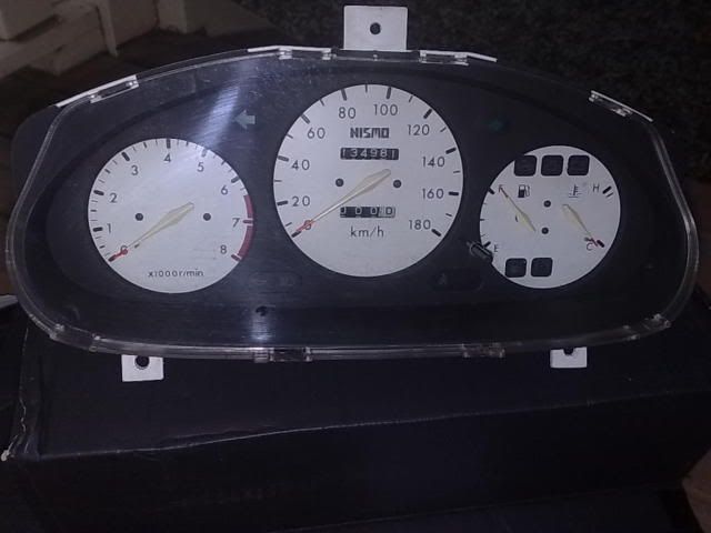

And the NISMO clocks showed up too!
Now to sort out wiring diagrams and get it all working....

Still nothing about the EMS Stinger. Meh 3 emails. No response.

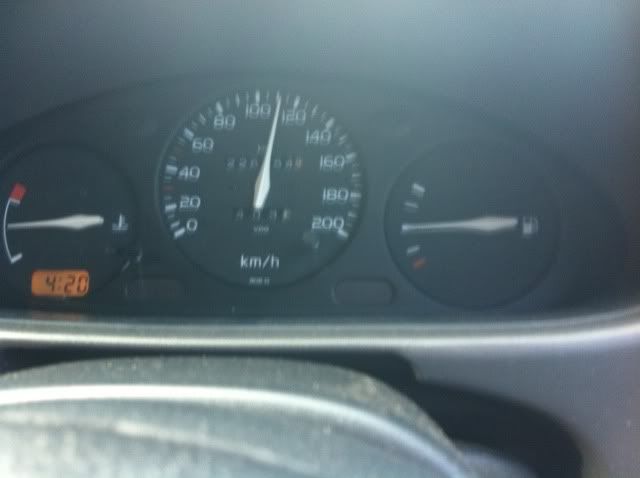

Hopefully won't have too many dramas with the NISMO cluster. Fuel sender should be ok, temperature sender, meh I'm most worried about fuel, tacho, speed and lights. If I can't find a "JDM temp sensor".
Will just get a temp gauge to go with boost gauge. Better than an external tacho easy.
CMF_RBLUV
» CMF Member
Member since:
Posts:
the plastic surround is also a different shape to the normal k11 cluster
might still fit duno havent tried mine, im in the process of just swapping the faces onto another cluster :)

according to kovert.k11:
"In order to use it you'll need to splice into the existing wiring and rewire into the JDM harnesses...same deal for fuel sender"
I took that as fuel sender is different between JDM and UK, that's why he sent it so I can get it to work. I would still have thought that at the dash end you'd still have a signal for fuel level and coolant temp, so that should still be able to made to work on the JDM dash. If that makes sense. But apparently not. So this is how we going about it
Member since:
Posts:
i've got a nismo dash cluster in my car. you'll need to chop off all the original plugs and use the ones he supplied you with. . didn't know the cluster was shapped differently to the aus/uk micra versions. fits no worries at all. good luck wiring the **** up. was a nightmare. yes you'll have to use the jdm fuel sender also. same as the coolant temp sender.
proof lol: http://imageshack.us/photo/my-images/543/img2761k.jpg/

turbo march-rolling shell WROTE:
"i've got a nismo dash cluster in my car. you'll need to chop off all the original plugs and use the ones he supplied you with. . didn't know the cluster was shapped differently to the aus/uk micra versions. fits no worries at all. good luck wiring the **** up. was a nightmare. yes you'll have to use the jdm fuel sender also. same as the coolant temp sender. <BR><BR>proof lol: <A title=http://imageshack.us/photo/my-images/543/img2761k.jpg/ href="http://imageshack.us/photo/my-images/543/img2761k.jpg/" target=_blank>http://imageshack.us/photo/my-images/543/img2761k.jpg/</A>
I don't have coolant temp sender. Was if it's too much of a bitch to find a JDM one I'll just go with an external coolant temp sender.
I got bare wires, no plugs :(
Dad is an auto lecco, so hopefully he can give me a hand, will use terminals most likely. Try and label everything for "Ease"
