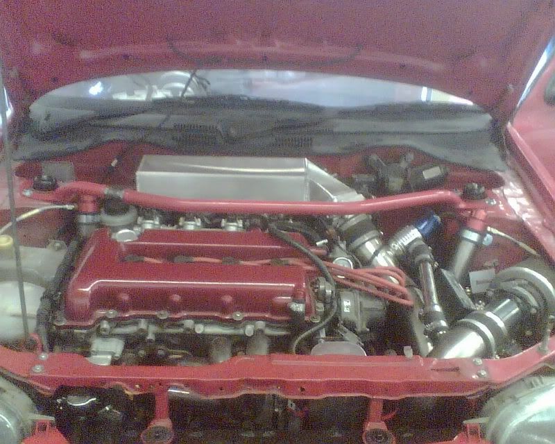

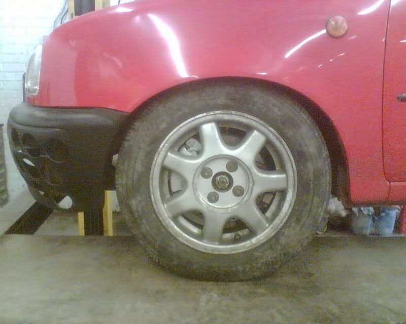

The car is now entirely poly-bushed and I have just fitted Whiteline anti-roll bars in the front & rear.
I also receieved my Leda suspension on Thursday (all £1300 worth for just the front) and fitted it on Friday. I will have to set up the camber & ride height but with the adjustable damping on both compression & rebound, it should be good for the twisties.
Here's a few pics(sorry about the camera phone quality)...
You can see the remote dampening cylinders on either side of the picture.
Bit too low me thinks...
I also modified my OMP strut brace to fit, as the manifold got in the way, so I cut the brackets off, turned them around and welded them back on. Coat of primer, paint & lacquer and it looks brand new!
Cheers
Dave
P.S. The new turbo is on!!!
