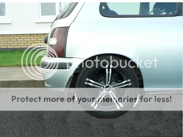

Some pictures day time:
Your micra is coming along nicely, wish mine was, really liking those side repeaters on your wing mirrors. Keep up the good work.
It's all your fault I have those repeaters :):):)
I'm glad you like the way the car is coming along(Y)
