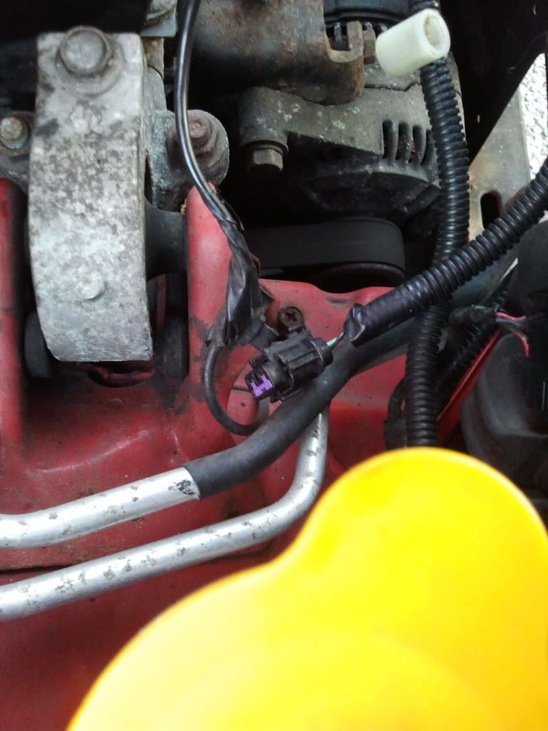

I also had another look in the engine bay to try and locate a connector, and the only one I could immediately find was this one which was taped to the back of the drivers side headlamp:
It looks different to the ones I've seen in various posts, but if it's not for fogs then does anyone know what this is for?
Cable for the fogs should already be there.
Taped down behind the driver side headlight, the inside of the plug should be purple but sometimes its all black

It's this image that made me question it:
That connector looks like it should fit into the one I found.

I've been looking through various threads and it was really bugging me, so I decided to go out and have another look for the connector. I just might have found the little bugger:
It means that there's a lot less cabling to do, however I'll still need to get hold of the cables to go in the back of the lamps and some way of switching them on and off. Any idea on where to get the harness?
