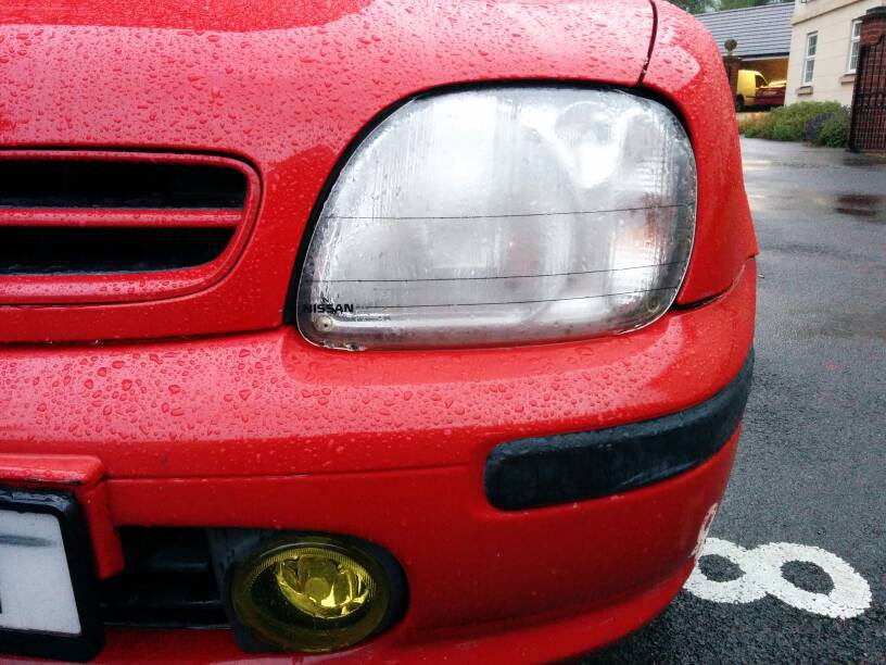

Fitted the rear fog today. It was a nice and easy job, just a lot of faffing around filing the hole so the light would fit in. I had already wired the unit into my homemade harness adapter, so all I had to do was get the wire out of the boot and behind the bumper. Luckily I found this grommet, so I punched a hole through it and fed the wires through:
Hacked a hole into the bumper using a Dremel:
I decided to mount it offset. I decided not to have it central mostly because I know I'd never be 100% happy that it was actually central. At least if it's offset then it's intentionally offset.
