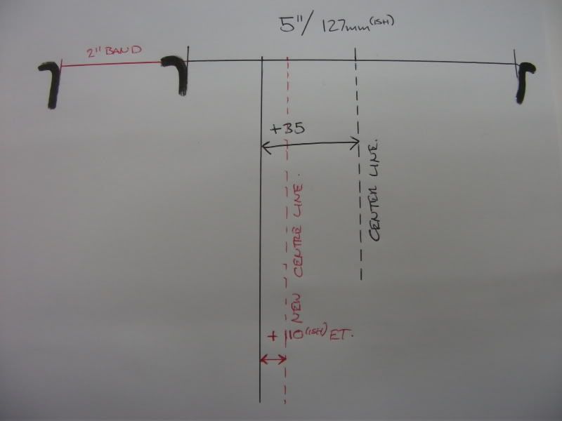

If it's still doing your head in, I've found in the past that drawing it helps:
In black is a 5" Et 35 wheel, the red is the changes that happen because of a 2" band added to the outer rim.
cheers mark, im still slightly confused. theres a pic of a green micra with 13x7 et+5. the poke looked slightly to much so would et+3 be a little less poke?
