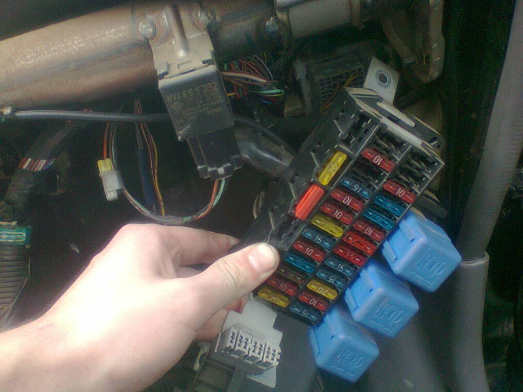

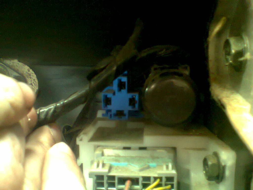

Anyone no what those relays are for? or is any of that to do with the starter/relay
