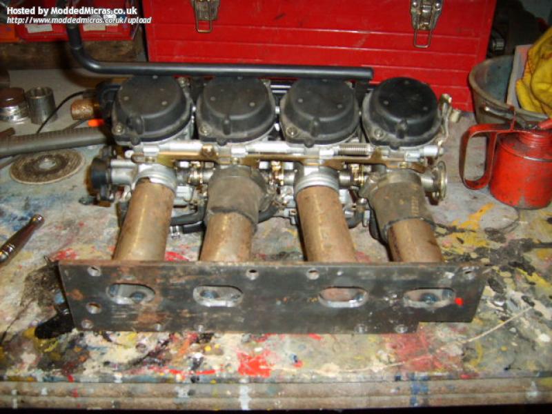

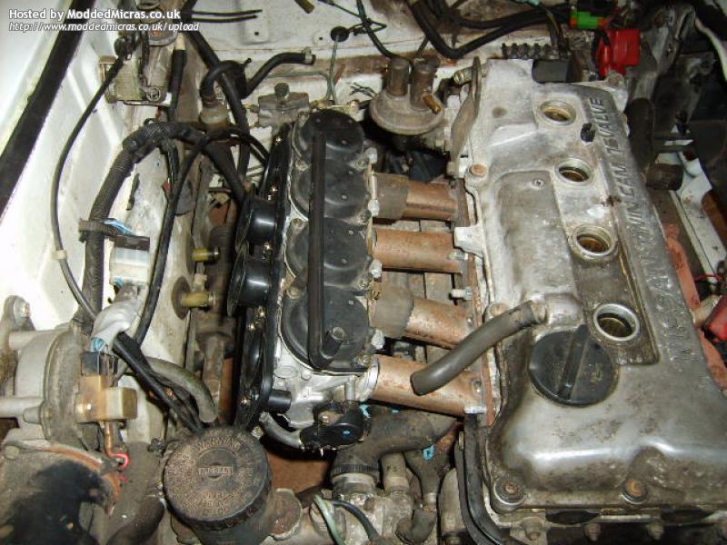

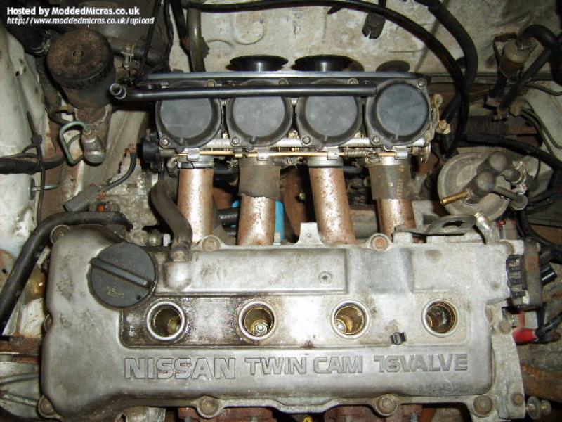

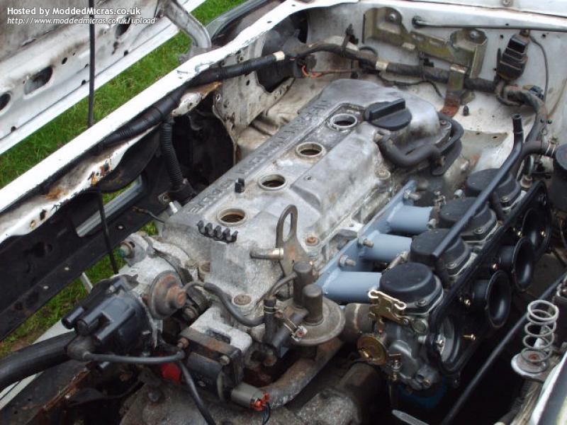

i was going to have a inlet manifold made up for it to run on bike carbs which i do have as well.
Its amazing what you can do in a couple of hours with some flat steel and 4 bits of 2" exhaust pipe.
Not quite finnished needs welding up and die grinding out to match the ports but dont they fit a treat though.

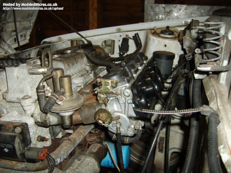

i still connot find this distributer i need around my way,PLEASE can some of you lot have alook in there local scappy,pre 93 non cat primera 1.6 its got the vacume pot on it here's a picture of the engine.
