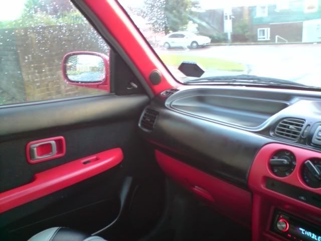

thanks for the advice im going to give it a go now and yes sleeper ss im painting it black and a bit red to match the door cards i did the other week.
Was pleased with the result so i figure the dash has to follow :D
Don't forget to use some plastic solvent (easiest) or plastic primer before you paint it.
Going to find time this week to do mine...
i used plastikote primer painting it sleeper ss , it would have been easy enough just like the door panels but one of the previous owners must have used a cleaning spray or somthing to make the dash shiney and it bubbled like crazy on my first attemt ... on second go i sanded it down twice as much and washed it thoroughly and its taken and is back in the car although it could look a lot better im still pleased with it
and thanks for the advice on the dash every one!! :)
ill post some picks up of it finished when i get back from work
the finished product :)
OOps yeah that's a nightmare.Anything that makes a dash shiny is sillicone based,paint hates sillicones & causes the fish-eyes.
Detergent & panel wipe gets rid of most of it but it usually always appears again somewhere.You can sometimes "paint them out" when you realise there's a problem by dusting the paint slowly/thinly over the sillicones,a heat gun helps a lot with this.
People panic when it reacts & try putting on more paint,don't matter how much you chuck at it won't cover.
I'm gonna clean mine extra carefully!
