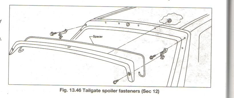

right i've got hold of a spoiler for my k10 and need to know how to attach it the car, and wether to spray it black or the same colour as my car (sky blue)
below is the spoiler i got, and any help would be greatful
If it's an original Micra K10 spoiler then you find some info about it in the Haynes manual.
It'll be in the section for later models which had the Spoiler etc :)
its an original spoiler, right best look at the manual cheers

As for fitting i see two screw's in that pic. Place it against the boot pull out the screws, line it up sqaure then put a marker through the holes and make a point on each side. Now you have your drill points!!!
you can do a resonably good job using aerosols if you use them right. i dont happen to have a freind with a spray gun so use aerosols quite often, only on small bits, aerosols should be fine for a spoiler, its when you try spraying panels using aerosols you get prblems. (Y)
thanks your very helpful, glad iam a member of this site, right not got a m8 with a bodyshop so it'l have to be can's, and the diagram is excellent.

i've spray'd it black. now i will follow the digram above from the manual. my next question is the bolts don't come all the way through the boot to the inside so how to attach, or iam i doing it wrong.
You need to drill holes on the outside for the spoiler to poke through, and holes on the inside to put the nuts on :)
You can't drill straight through because of the angle. You'l need to do it both sides
