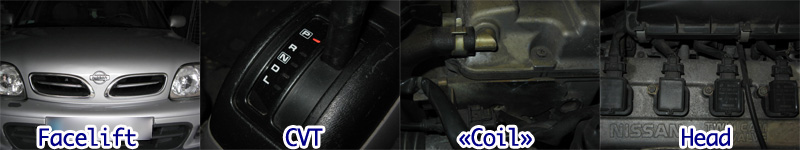

Hi !! (The second french guy in this tread :suspect: )
In the past, I tried too... (K11 from 2001, 1,0l, CVT, no distributor on the right of the engine) ... with pin 19 in the dashboard. (The wire was blue). The rev-cont never bounce :(
So.... I will take pictures of mine, maybe this time will be good !!
Tank your for your help.
Photo :k11motors
