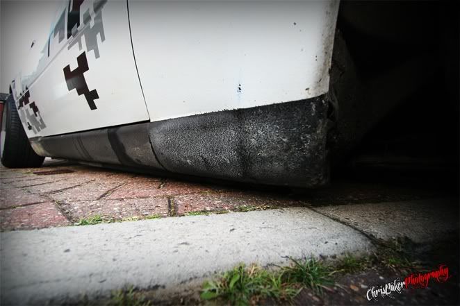

the side skirts are the wrong way around in the pictures, hence why it doesnt fit.
you took a picture of the passanger side skirt on the drivers side.

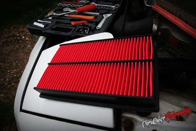

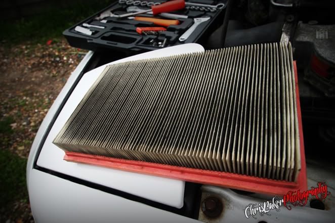

Thought it was time to change the air filter:
Out with the old:
In with the new:

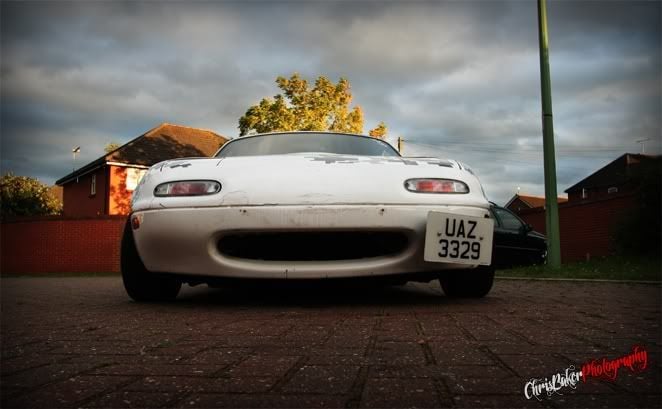

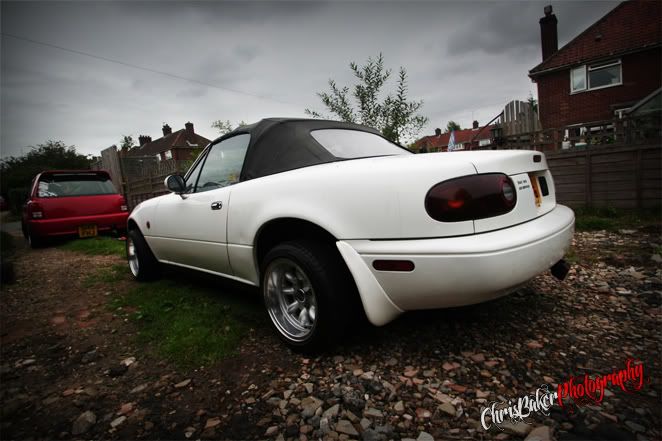

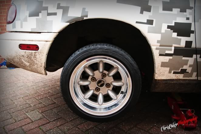

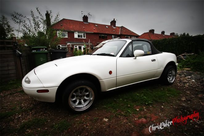

Trial fitted my Superlites (YES I KNOW IT NEEDS LOWERING :p)

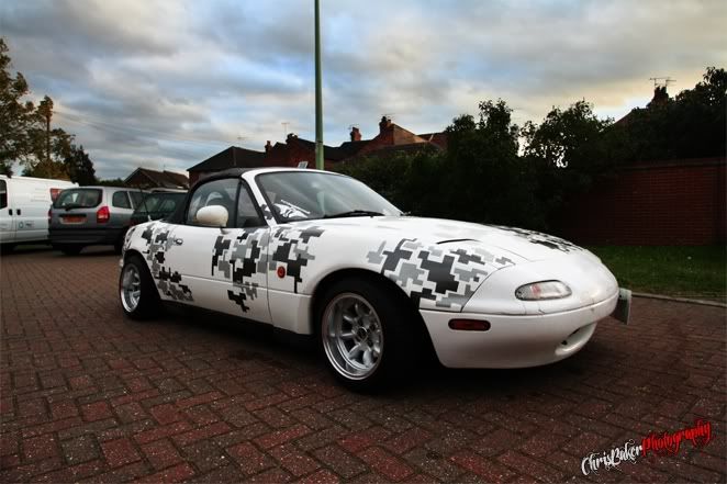

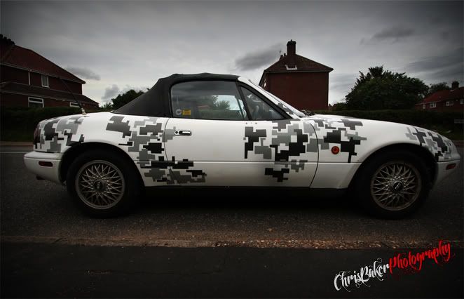

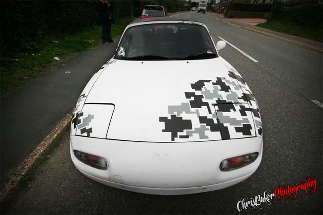

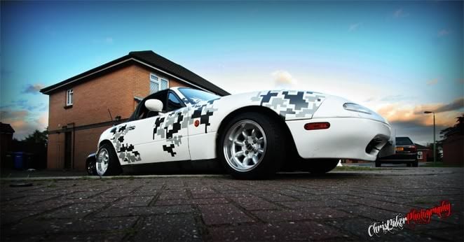

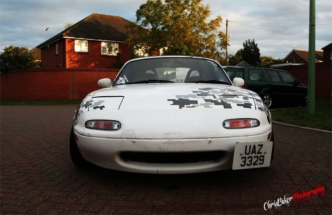

The car is in a need of a spray job. I was originally gonna spray it,then i thought i'd get it vinyl wrapped...then i was gonna spray it...but then changed my mind again.

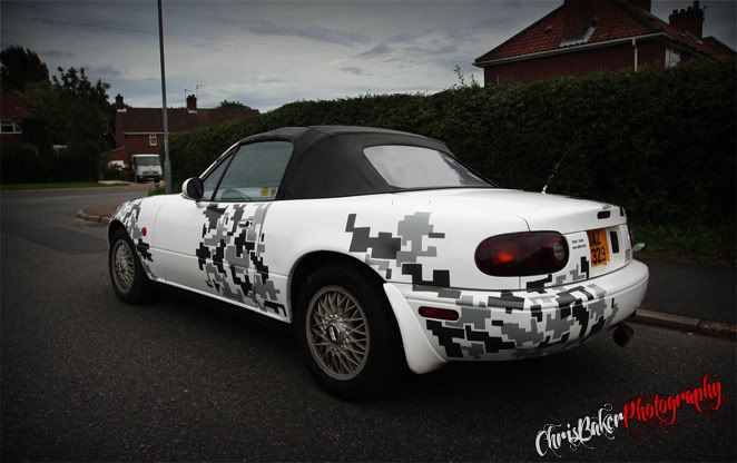

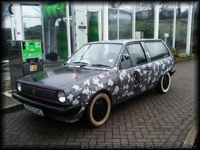

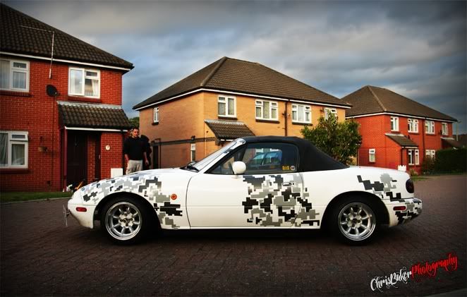

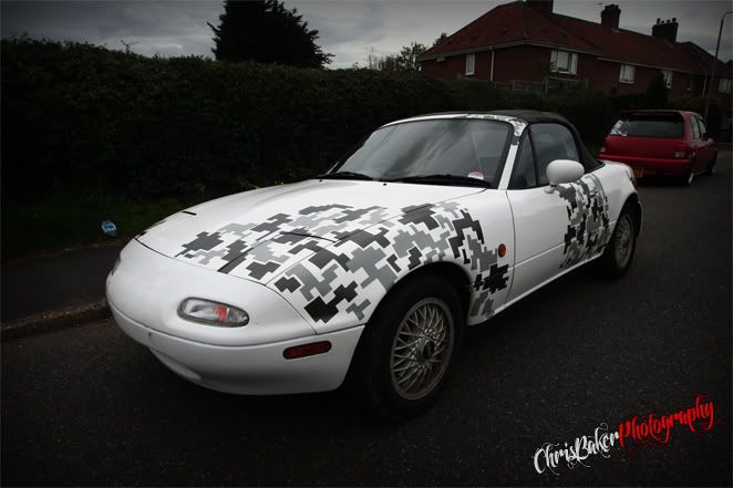

Taken inspiration from my Old VW Polo Mk2 Breadvan

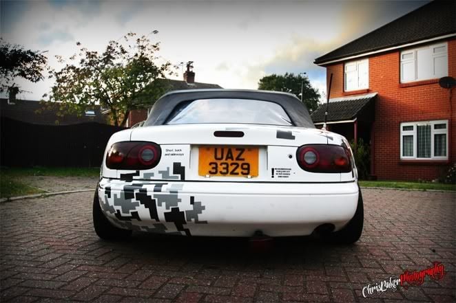

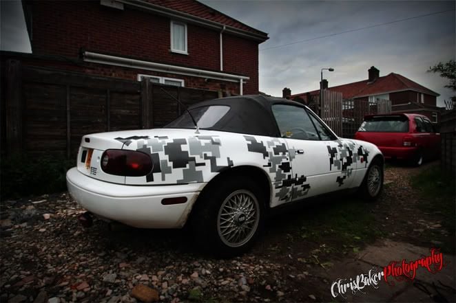

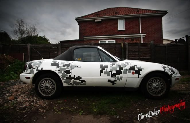

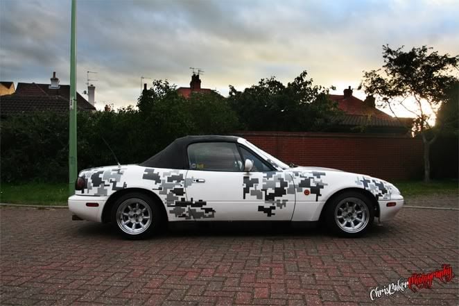

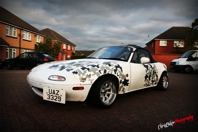

Its now looking like this...
Only managed to do one side as i ran outta time. Got most of next week off for JAE so will do some more then :)
No i havent forgotten to do certain areas its meant to be 'patchy'. I did like the way it was on the Polo,but i like it more patchy this time :)
Those wheels look mint mate. Not sure about the digital camo vinyl, but I'm sure it'll all come together once it's finished and slammed on it's arse on those Superlites (Y)

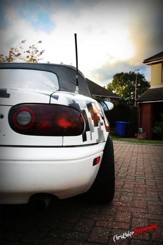

Lowering isn't a word i would use in this situation... the springs need to be halved at the very least! :doh:
I mean you could hide immigrants in those arches!

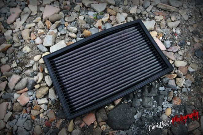

The new air filter looks nice ... but count the number of pleats ...... sorry I am a air filtration engineer lol ... so notice when they only put half the media in.

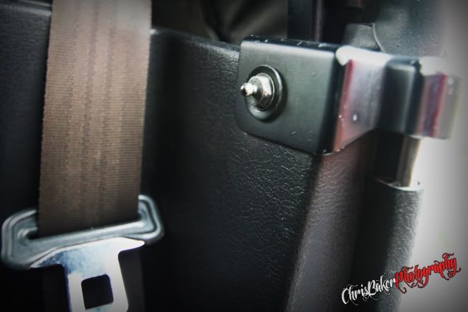

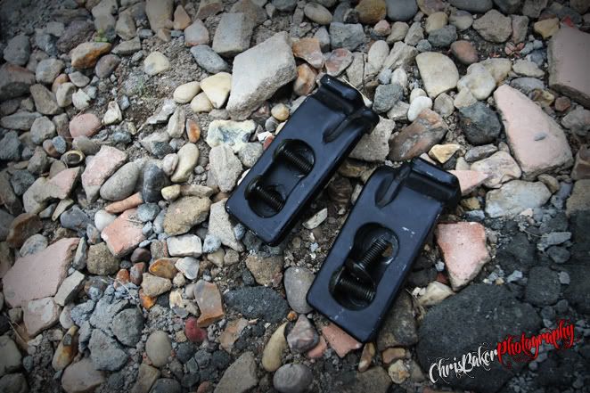

Hard Top Clips
But theres no cover...hmm...gonna have to look into this better...

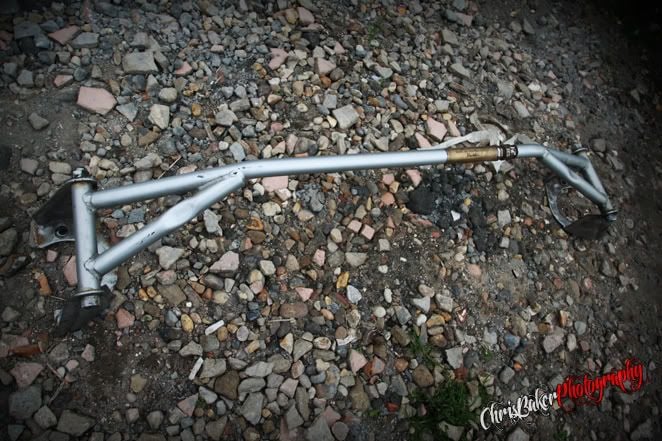

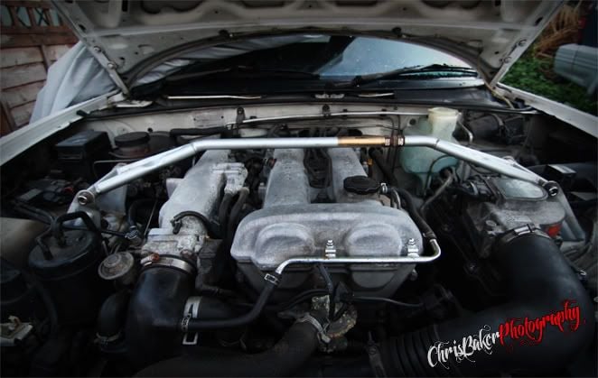

OEM Front Upper Strut Brace
And fitted:

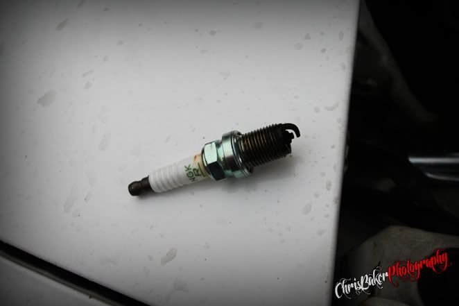

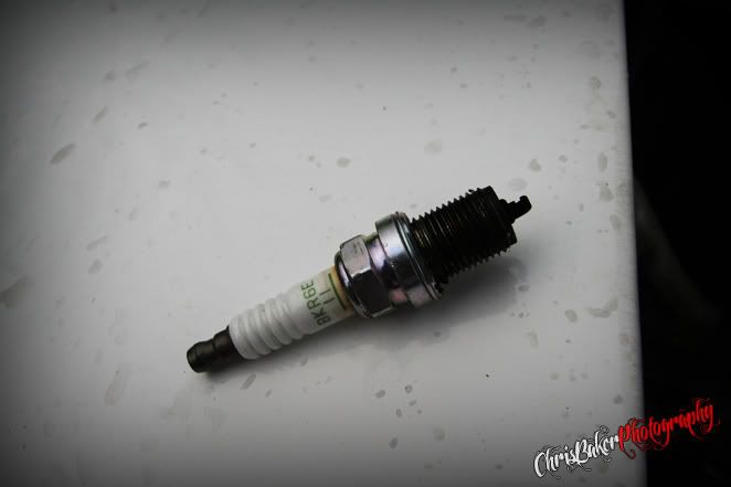

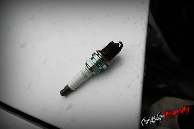

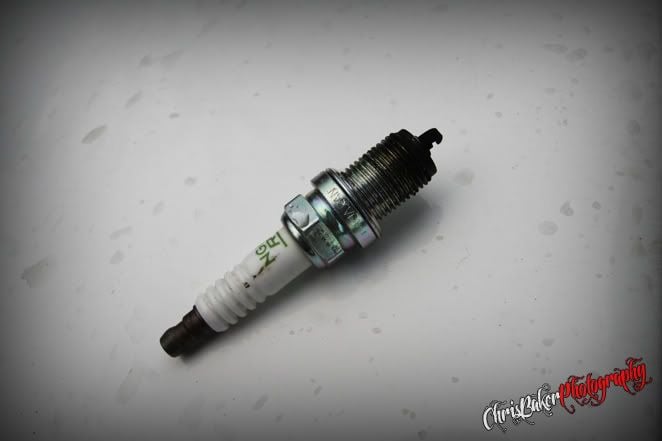

Replaced the spark plugs while i under the bonnet...
Plug 1
Plug 2
Plug 3
Plug 4

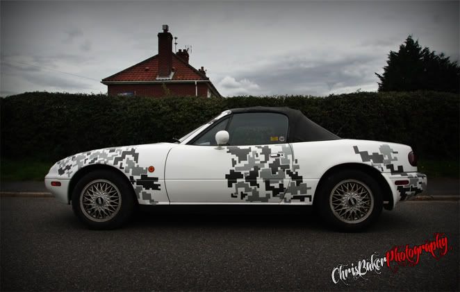

Was hoping to get more of the Camo done today,but its been chucking it down with rain all day. Will have to wait till Wednesday to do some more :) Fingers crossed its dry then!

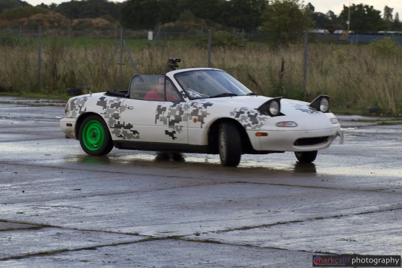

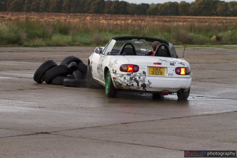

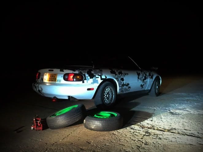

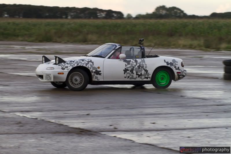

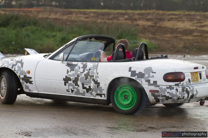

Yesterday i got the Mazda insured and on the road. So last night took a drive out to a location which had a nice large concrete pad....so it was rude not to have abit of a play :p
This was the end result,not bad for my first attempt...

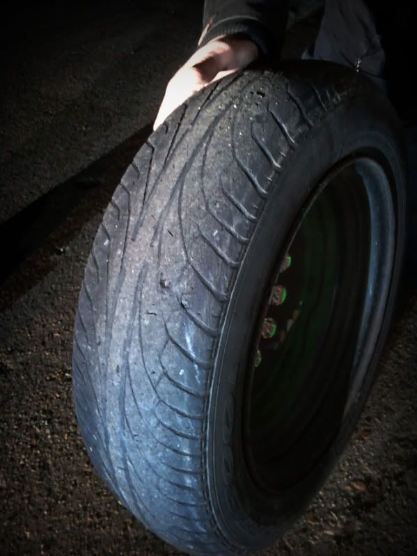

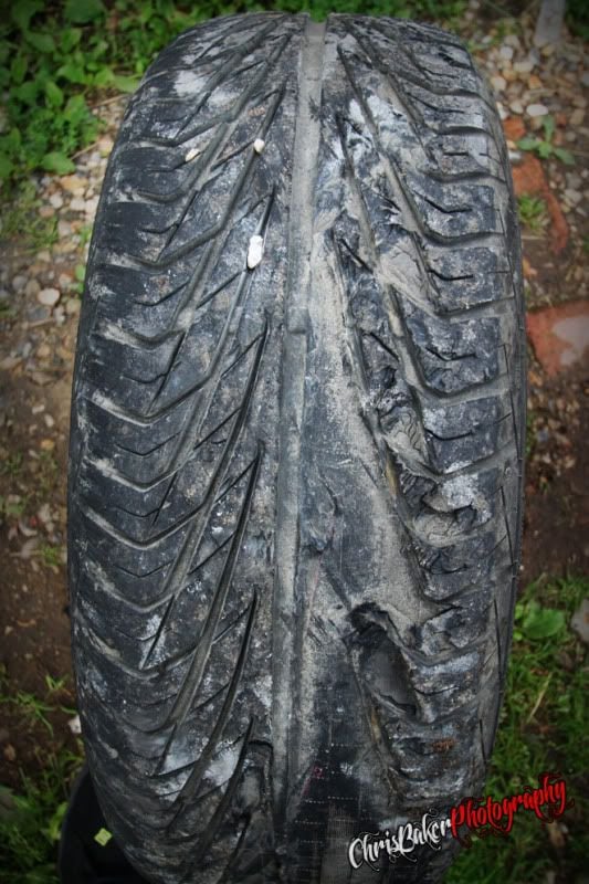

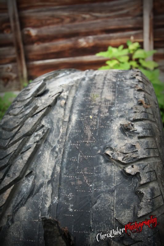

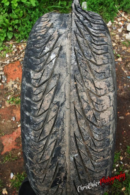

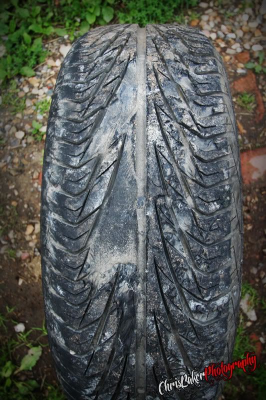

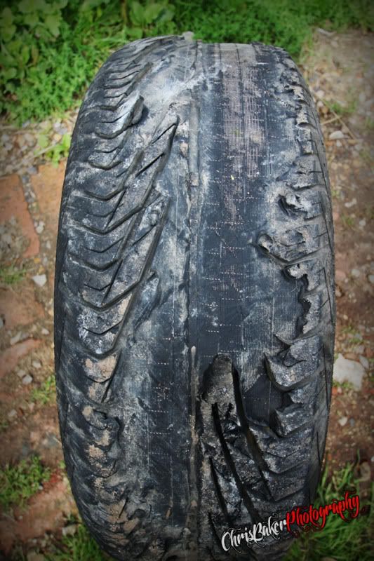

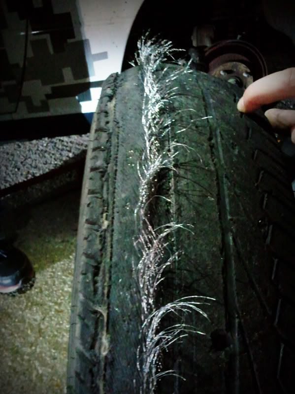

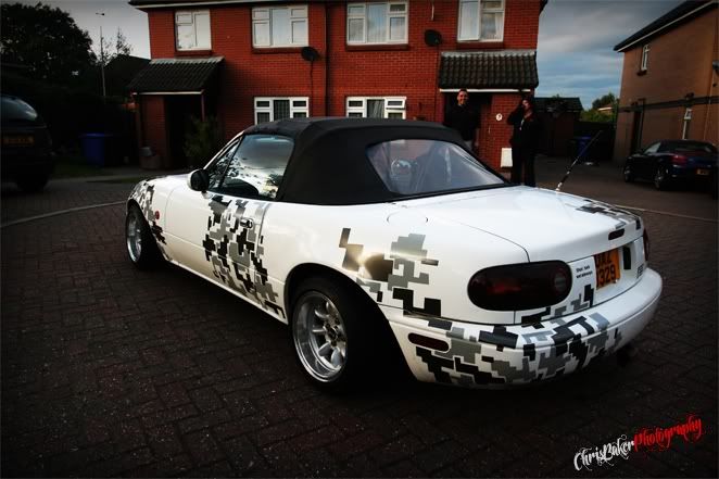

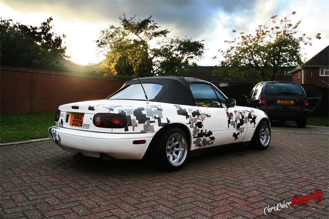

Today i got a new tyre fitted (free of charge from work :D ) and finished off the camo

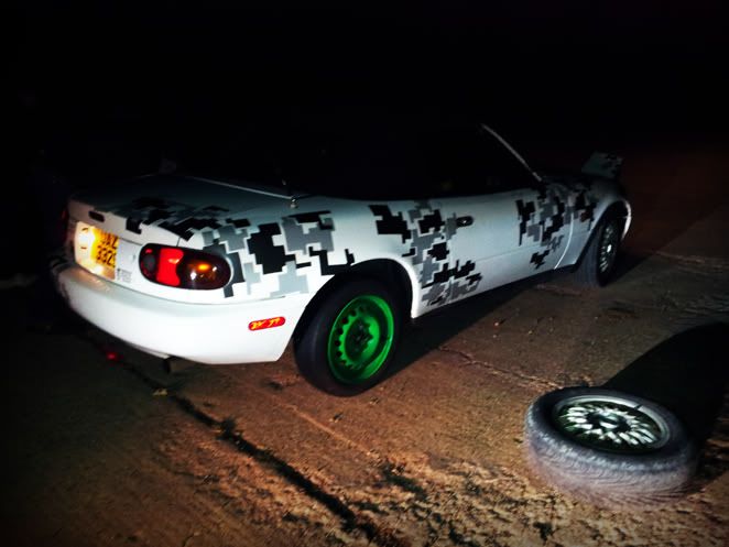

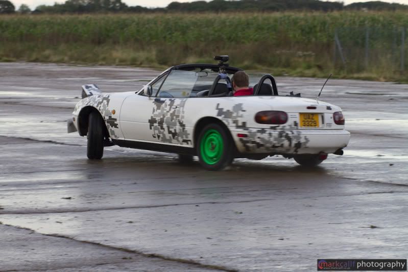

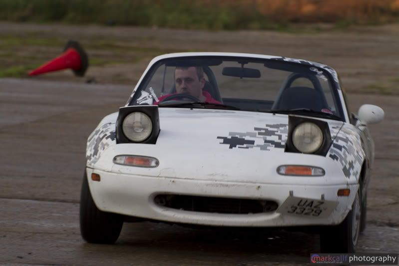

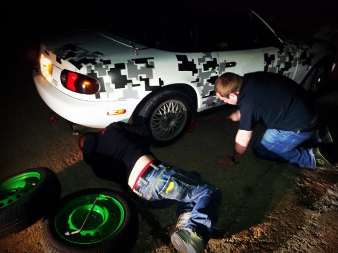

Took the 5 out last night for a late night practice session
Pit Stop
A mate giving me a hand
[youtube]http://www.youtube.com/watch?v=yL9mxwpWbh4[/youtube]
Took a break and had a look...
Other side...

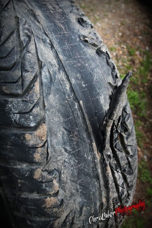

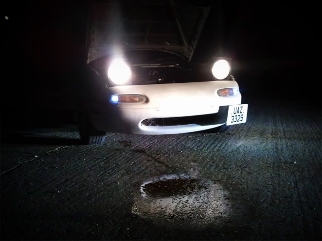

Then the 5 decided to chuck out some coolant,we suspect that it got abit hot under the bonnet and it started to boil...
Changed the wheels back over and that was the end of the night. Going for another session tonight hopefully gonna get some decent pics/vids so keep watching!

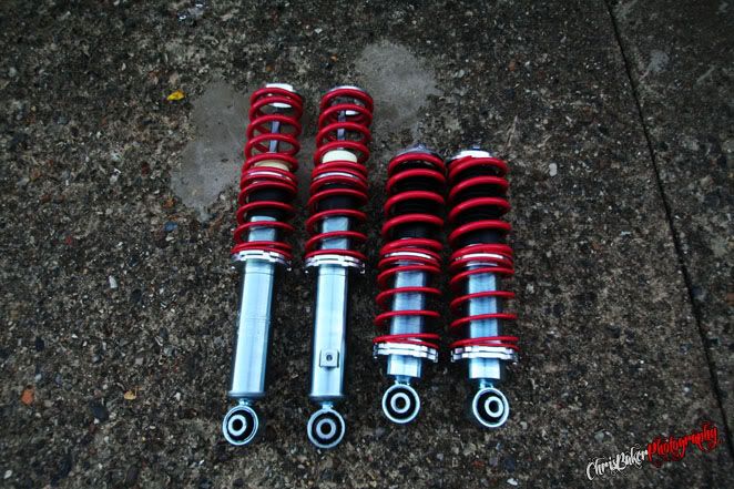

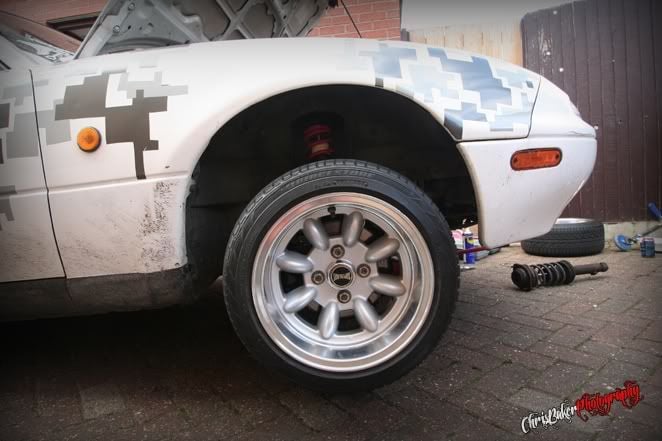

Ordered my coilovers Saturday afternoon,got an email Monday saying they had been dispatched from Belgium. I had a knock on the door this evening (29/9/11) at 6:15pm with a parcel :D
Also got a few other goodies coming,watch this space!
Popped over to Stews this morning to fit the Coilovers. Fronts were a pain to do and took up most of the day,rears were very easy.
Stew rolled the arches before we begun changing the suspension
Fronts fitted:
Rears Fitted:

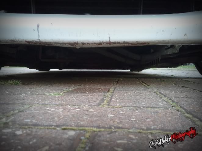

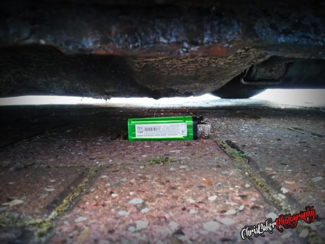

Clearance from the side:
Front Underneath:
