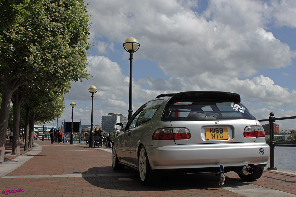

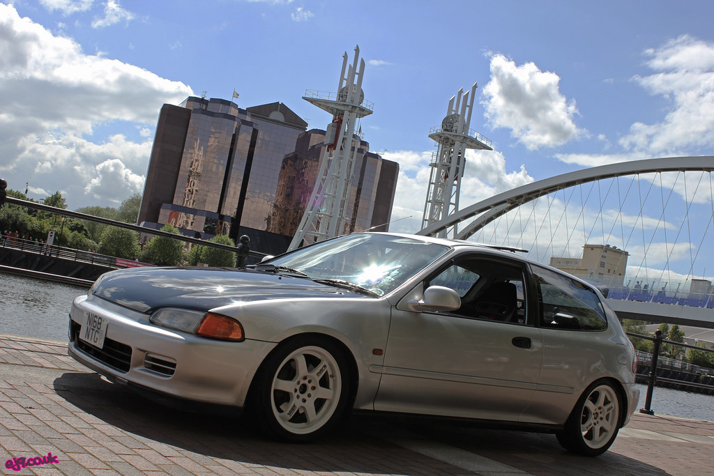

You had an eg before mov, love eg's got one myself, great cars, one I've got is an eg6 what was yours,
Yeah i had a eg with a teg engine but some **** smashed in to it it was about 216bhp and 226bhp per tonne
http://ej9.co.uk/?p=488
also i used front/rear whiteline arb and im selling the front one pal

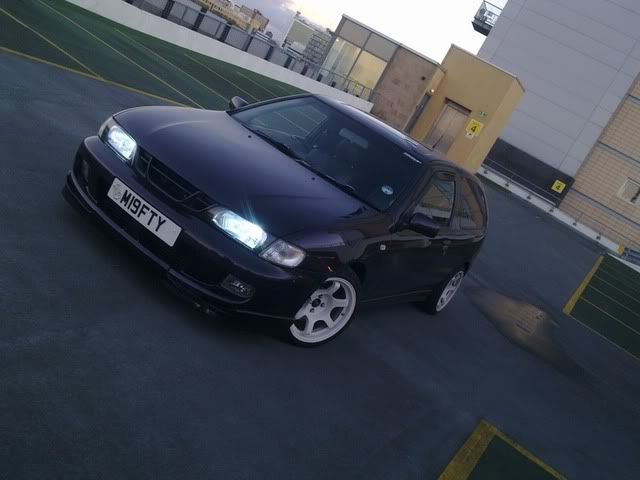

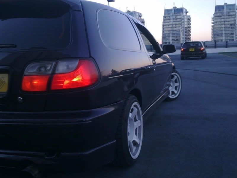

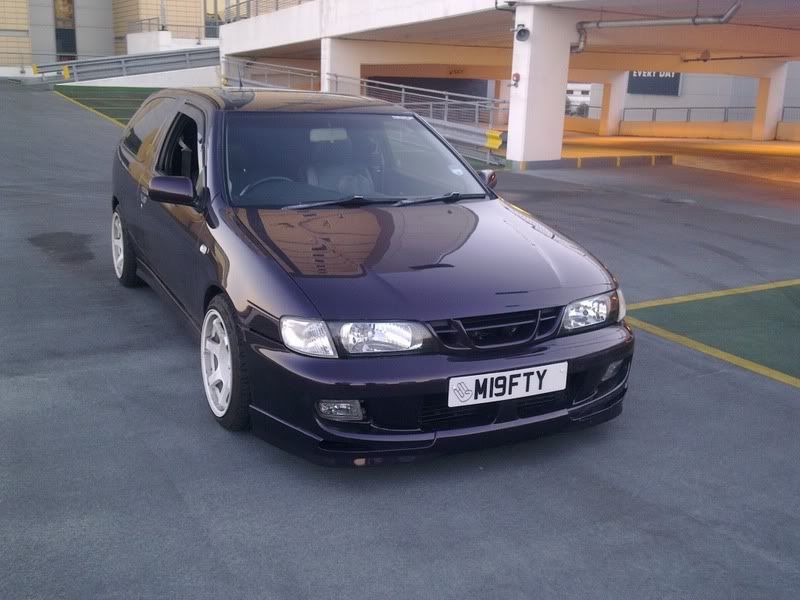

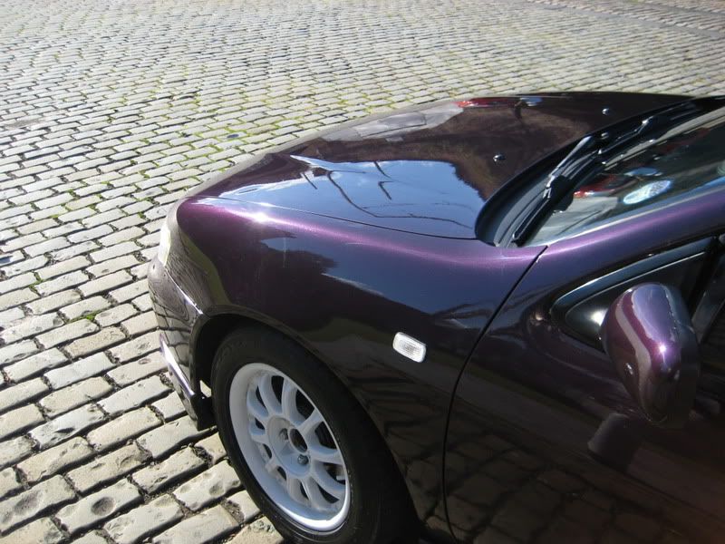

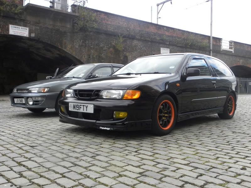

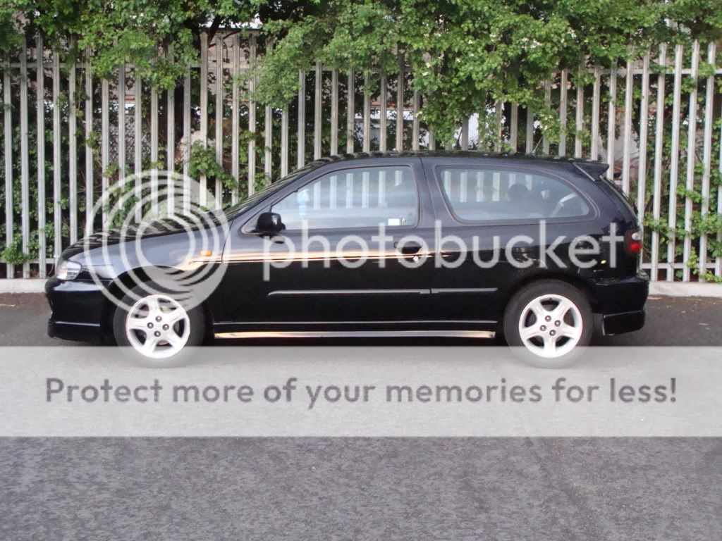

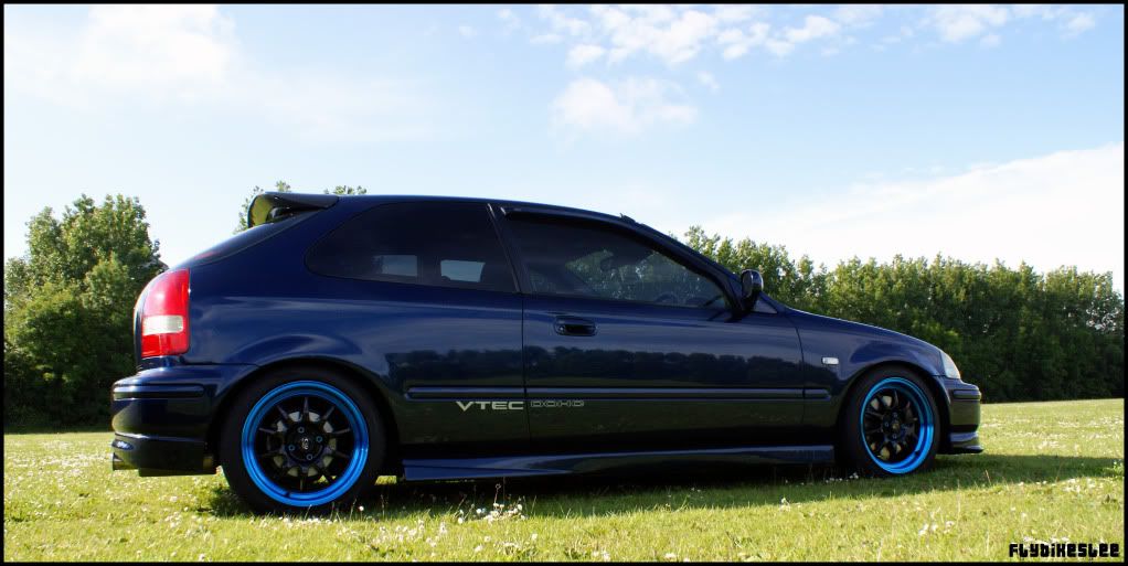

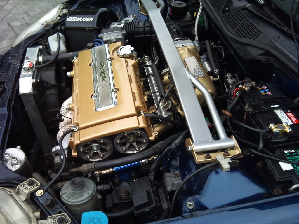

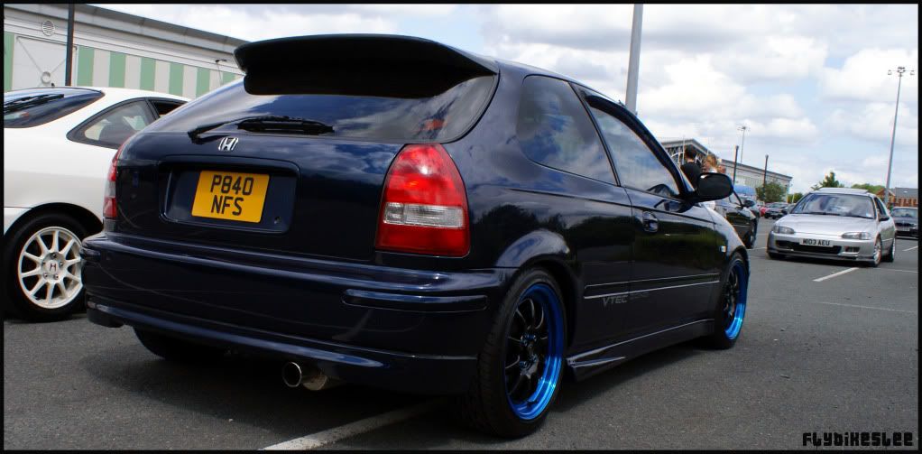

Also few of my previous car inc the 277bhp mera
Few collection of my past and current car
Civic EG 216bhp was light weigh beast
Banzai featured civic 228bhp
Skunk Tuned
and my fav
Almera GTI+T 272bhp
Started it off like this
Then this
Then sprayed LP2

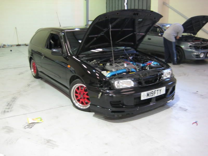

Hi, went out to get a fly by but we moved the air flow Sensor out to be4 the turbo, had it pressure side as some 200sx boys recon you get more power and a better reading of the airflow, but I think it runs smoother and better, but anyway ended up testing it on the road and setting up the timing, so no didn't get any pics, will have to get a fly by one night in the week.
