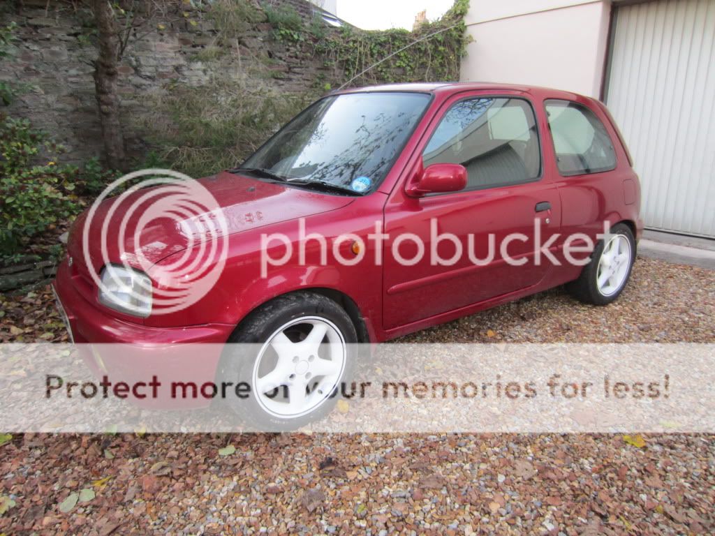

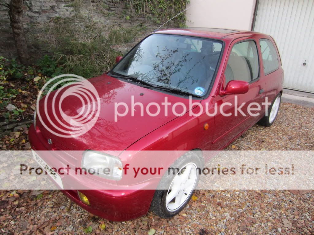

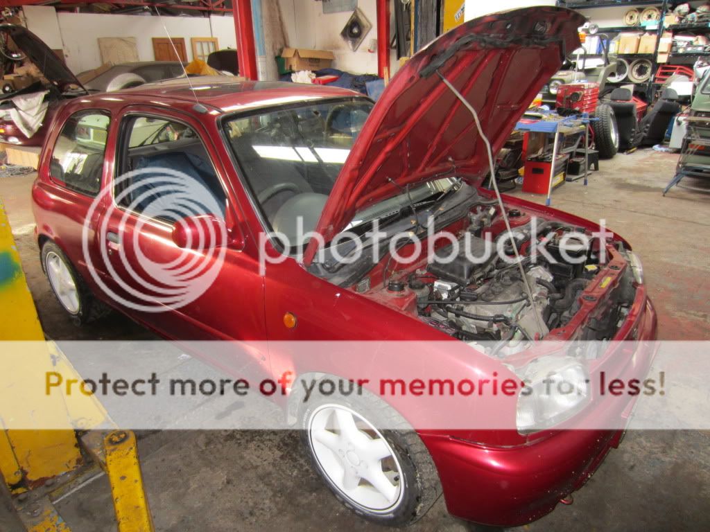

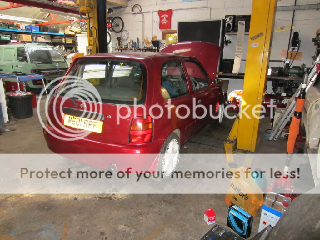

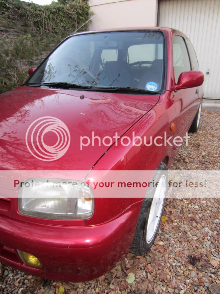

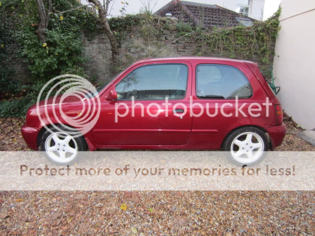

Ive just ventured into the small world of Micra's picked up a Super S for a run around so I can take my other car off the road over winter.
I usually reside over on the Almera Owners Club. oooooooo banter

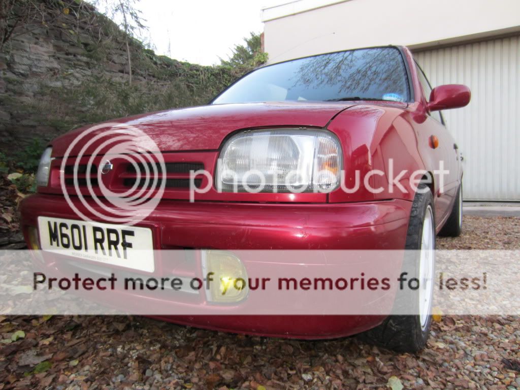

Heres the car in question
Few mods done, the wheels obviously, these will be coming off and sold in favour of some 14's, and it has some lowering springs.
Few things its had done;
It has a custom adjustable rear pan hard rod.
New wishbones
New clutch
New gearbox
New front cross member

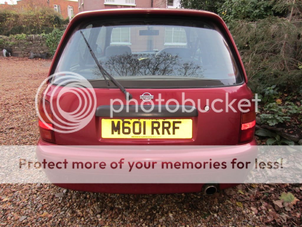

Im also on the lookout for a stock backbox as the one thats on it has been gutted, I already have one loud car dont really need another.

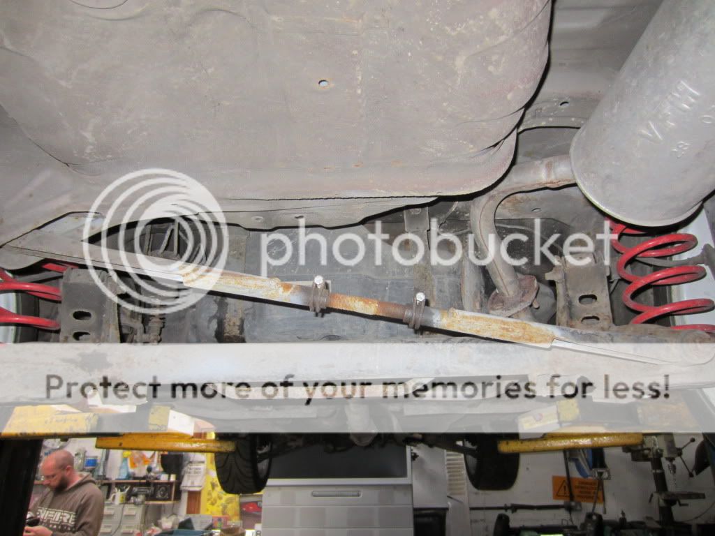

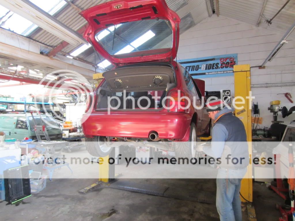

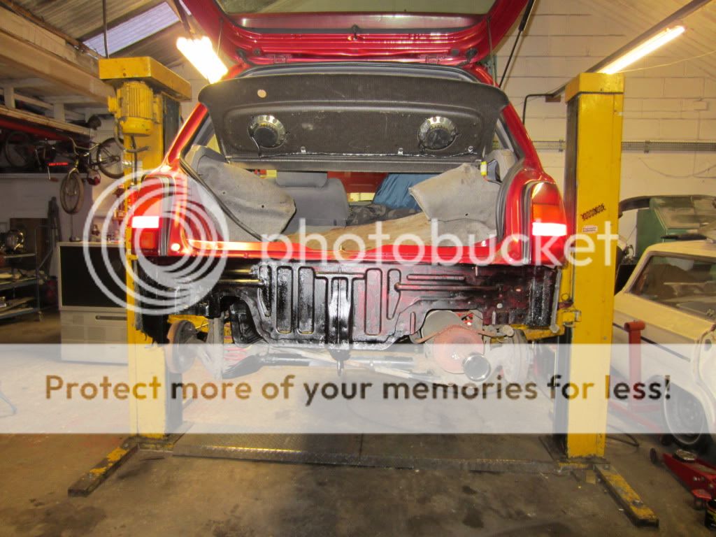

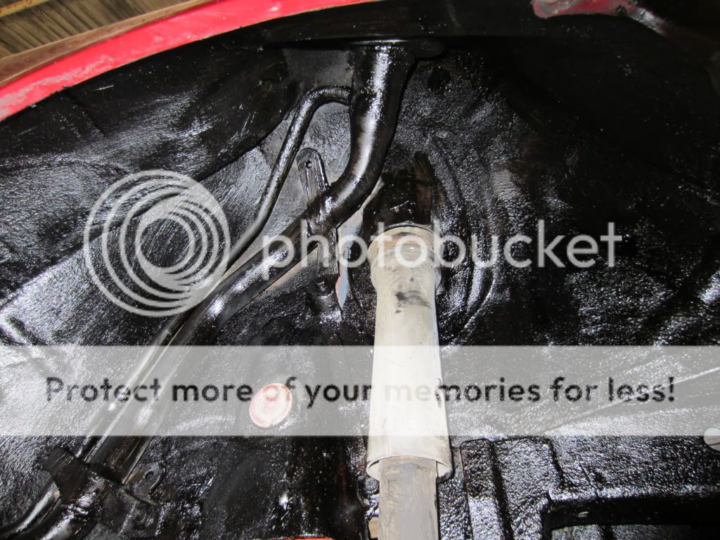

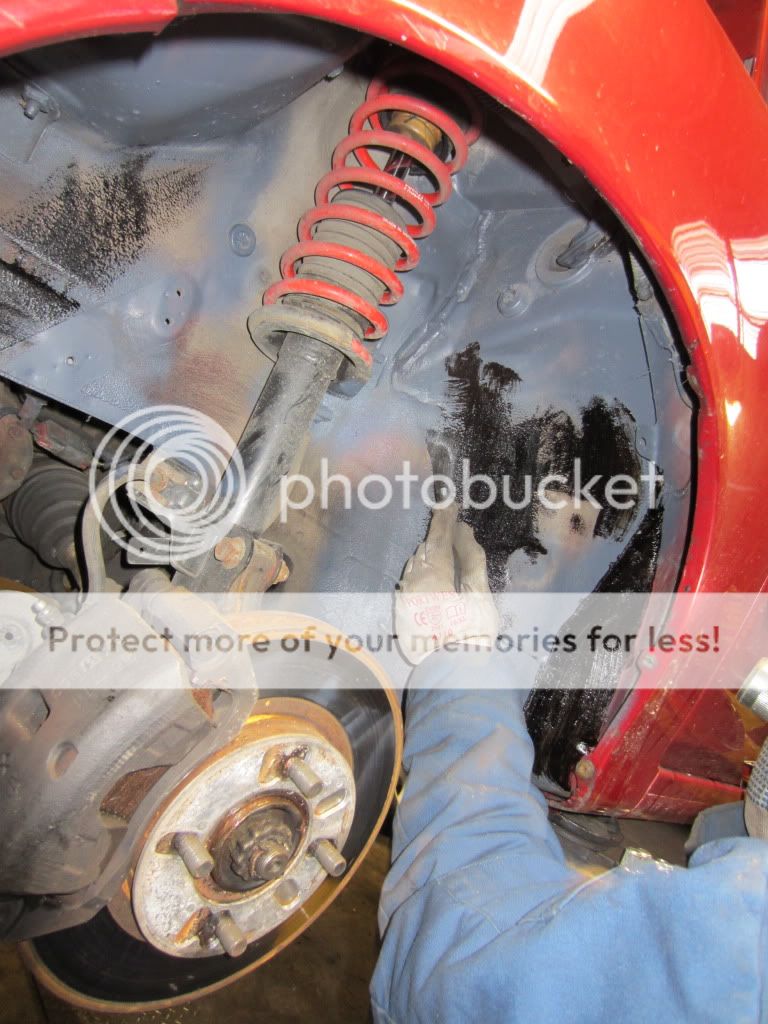

General idea is to clean it up to how I like it and pootle around in it, will be getting it up on the ramps on friday and giving it a once over, treat any rust I find and underseal it, its in surprisingly good condition for its age from what I can see.

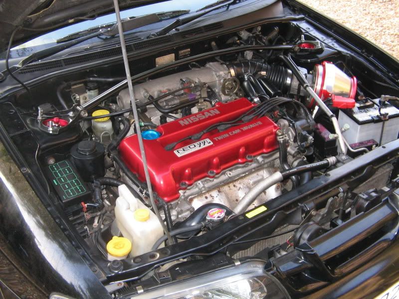

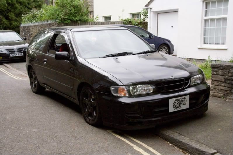

Here some pics of my other car.. Pulsar VZR N1

Its the same shape as an N15 Almera, but mine is an import there was only 200 built and its 1 of 4 in the country :)

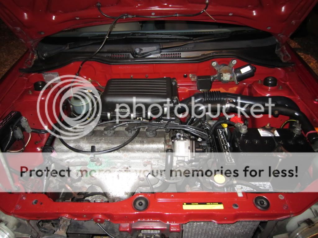

Started some work on the micra, removed the carbon canister and all the #### associated with it, all the hoses had split and perished so out that came, put in a temporary expansion bottle till I can get hold of a stock one.

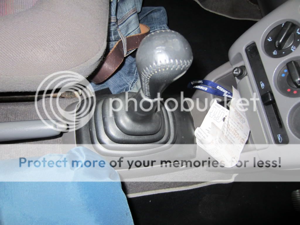

Stripped out the interior and gave it a good vacuuming and cleaned down all the plastics, removed the crappy looking gear gaitor and gear knob in favour of some better ones I had in the garage, just need a gti steering wheel now and some GTi discs then I can fit my GTi calipers.
I have removed and copper greased every nut bolt I could reach in the engine bay, will continue this around the car as I go, up on some ramps tomorrow for a good going over and a service.

So far have serviced it, oil and filter, spark plugs.

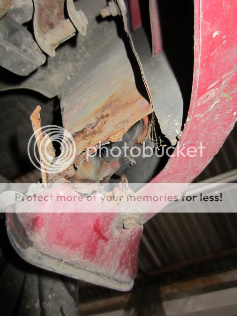

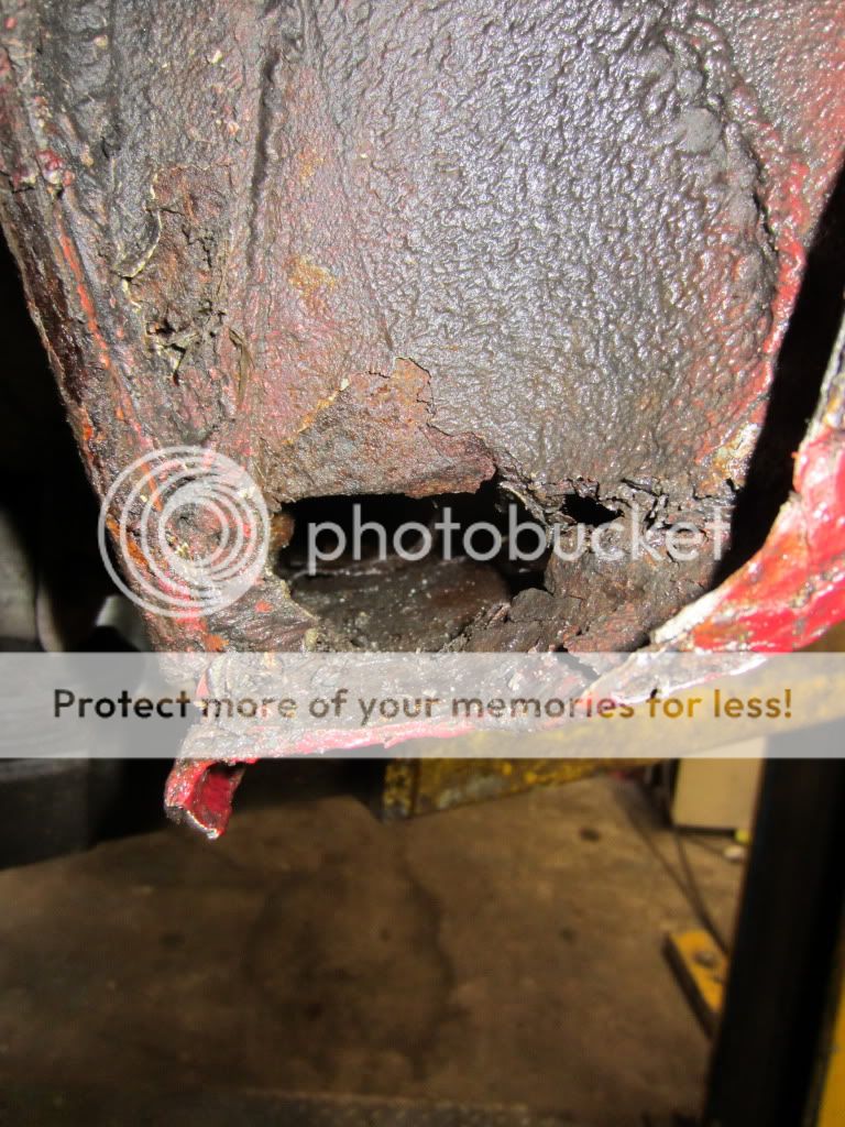

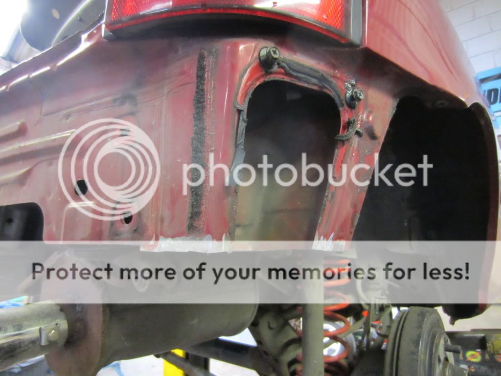

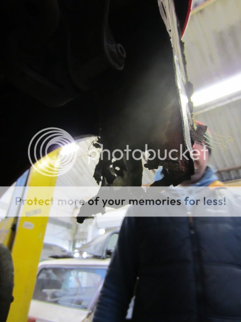

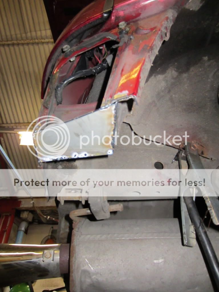

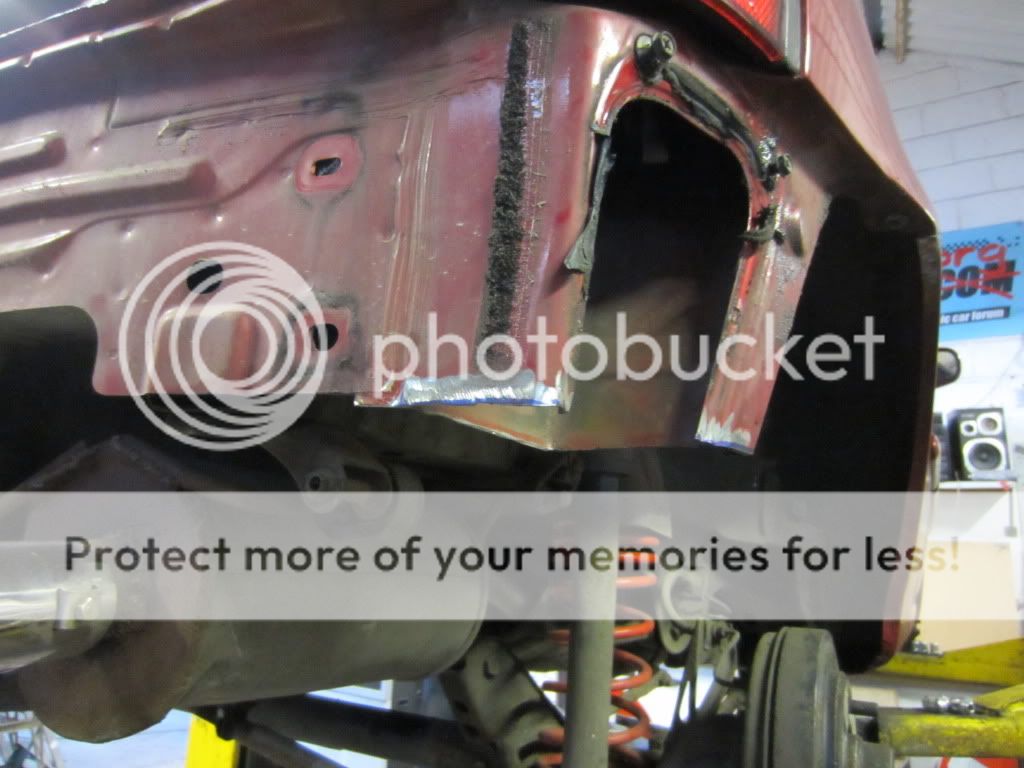

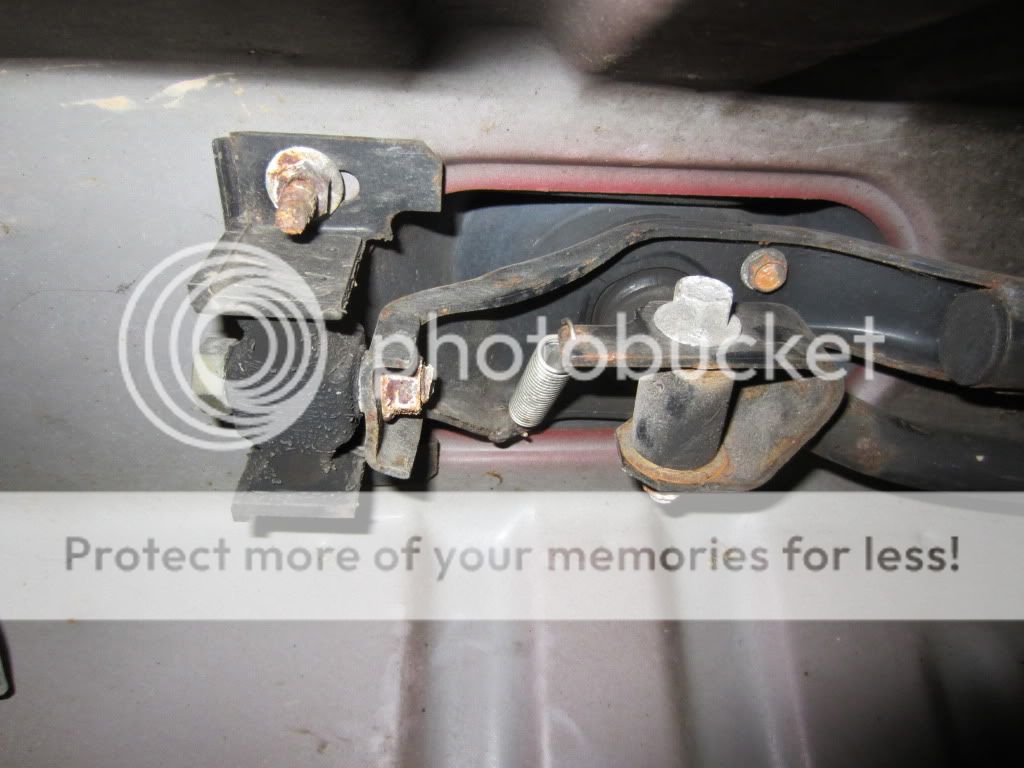

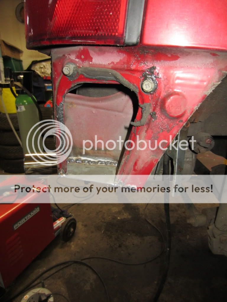

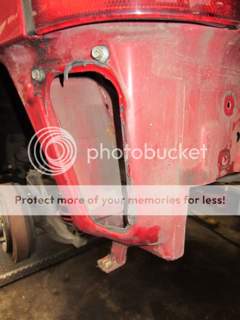

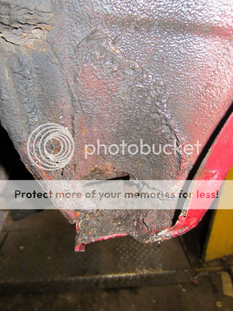

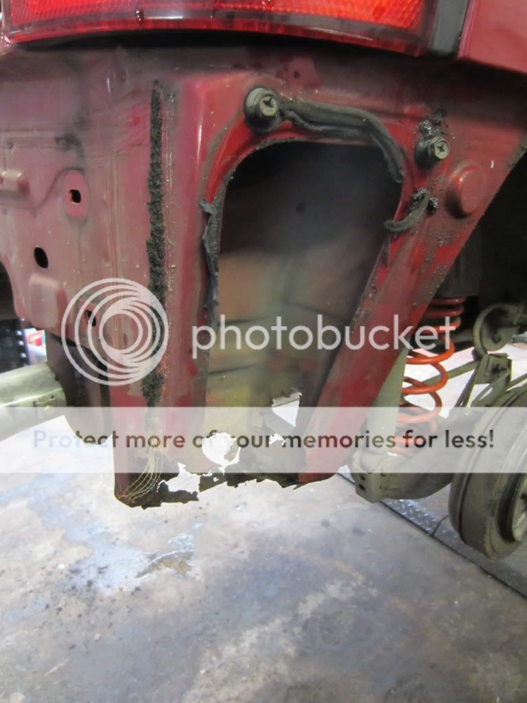

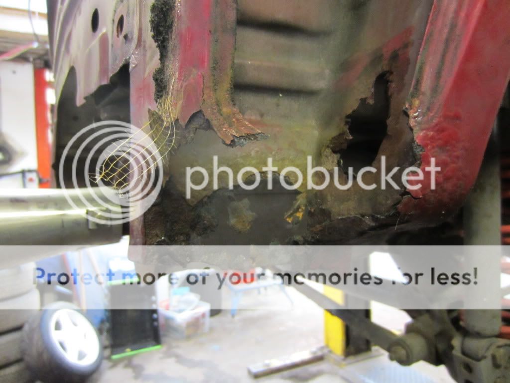

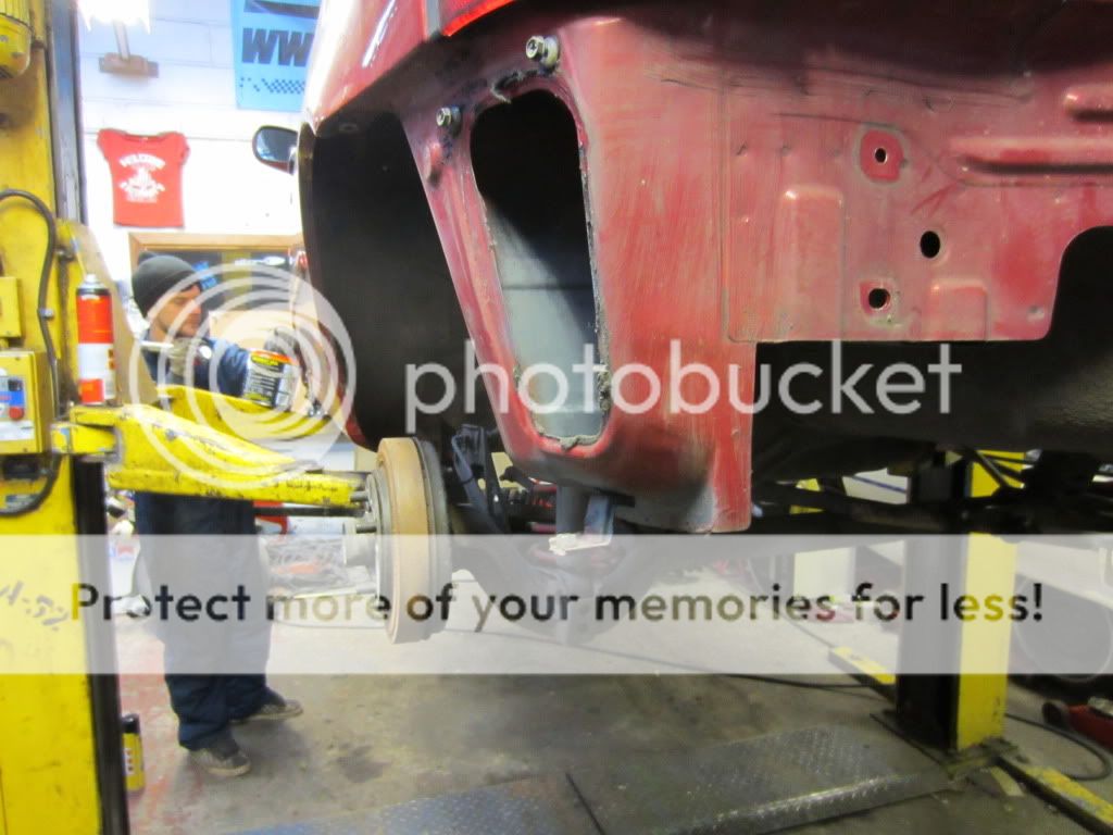

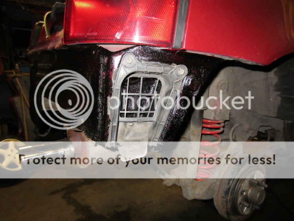

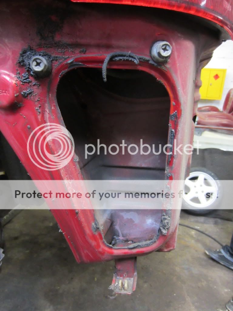

Resealed the chain plate thing, removed the carbon canister, put a new spring on the gear shift, fitted a standard nissan cat and new hanger bracket, fixed a dodgy connection on the injector fuse, vacuumed it ALOT, cleaned all the interior, replaced the standard gear gaiter and gear nob, copper greased loads, and found some rust, its had 3 patches over the years but that it, had a good poke and prod around whilst it was on the ramps the rust in the back is the worst I can find.

So stripped down the IACV valve today and cleaned it out, it was stuck when I removed it, I also took the chance to clean the MAF as the wires looked a little grimey, once all back together it fired up and idled quite high until I wound the idle screw down a tad, got it idling nicely at 800 rpm now, adjusted the timing again as it was pretty retarded again, car feels great now, and its using no fuel again.

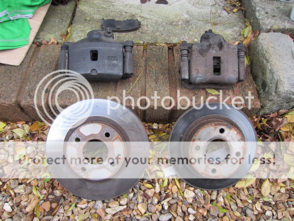

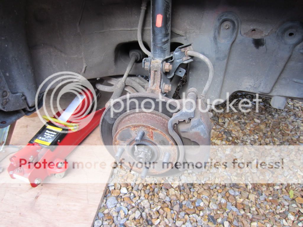

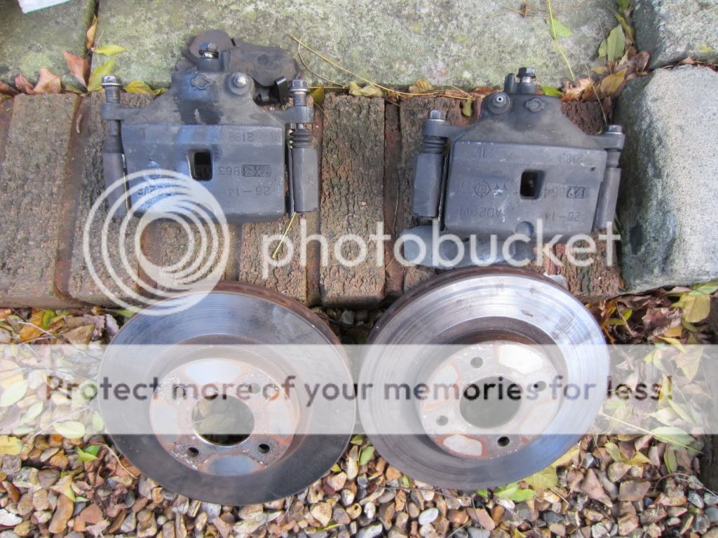

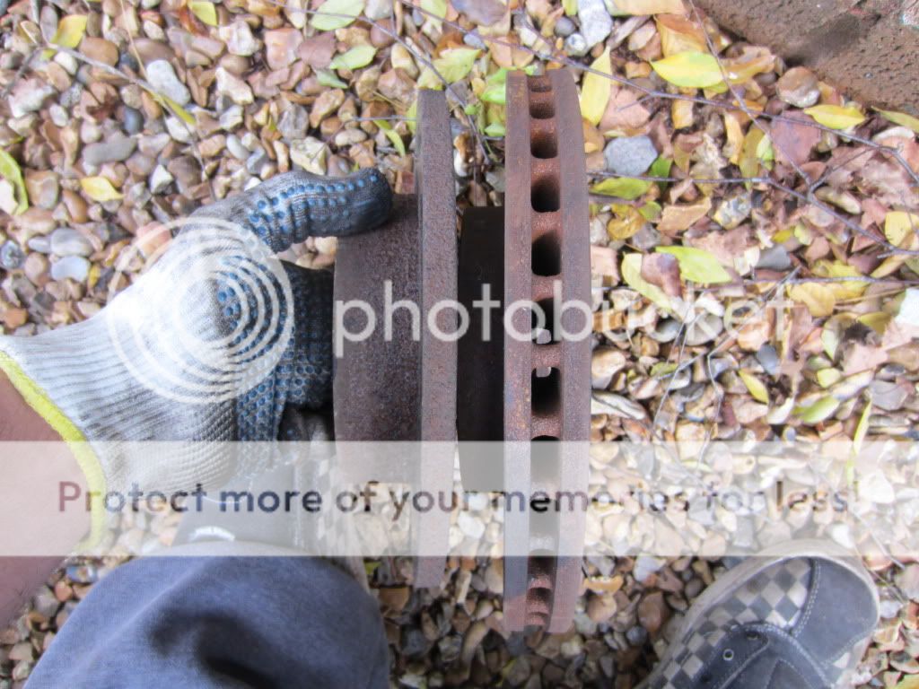

Also fitted some GTi brakes
New
Old
Old Vs New
New
AMAZING
