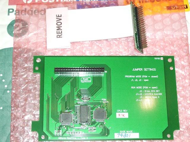

My board its Type 4 but with some changes to work on Micra NATS ECU. How he made it i dont know, just know that it works.

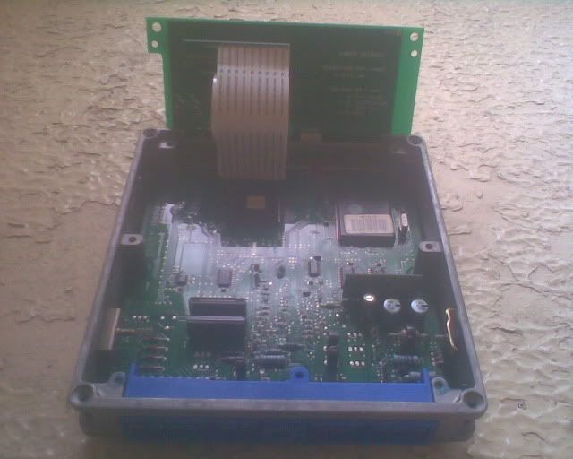

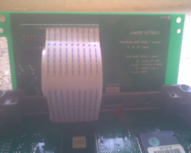

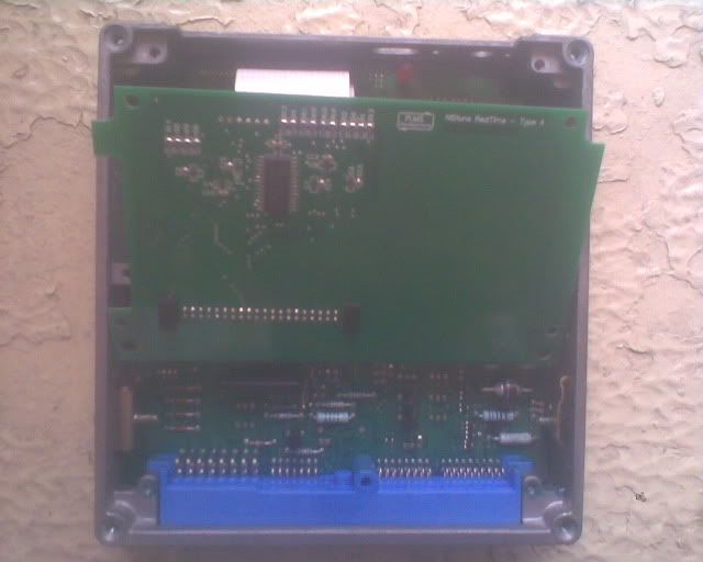

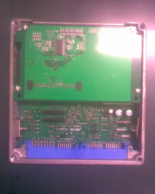

Here is my ECU and Type 4 Board:
The boards are the same, just the image files on them are different :)
