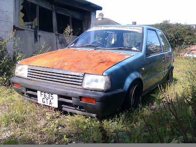

Went scrapyard and got
Cga fuel rail
Cga injectors
Cga inlet manifold
Cg10 ecu
Cg10 loom
Cg10 dizzy and sensors
Cg10 airbox
I couldn't get qg injectors or throttle body may be a pain to find as ebay shows no tb forsale in uk
Might try a ca18det tb
