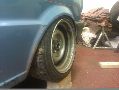

The matiz shocks are in the scrap already. They wouldn't go low enough for me so I decided that I wanted to see if the inserts were removable. They are not though so never mind. Atleast I know what the inside looks like :)
I removed the rear shocks and fitted new springs that are held captive by the shocks, so maximum bump travel, no loose spring and restricted droop.
Then I rewelded the axle brackets on to look tidier, stronger and the ride height that I desire.
Next up is makw an adjustable panard rod, adjustable trailing arms, new front shocks and a heavily tucked exhaust system :D

The micra is pretty much hellaflush wheel fitment on the rear now.
Axle brackets almost finished, still look crappy though .(q
Had to raise it about 15mm to get it out of the workshop :(

yeah sweet work on getting them wheels tucked that far up mate (Y)
thanks mate :D
