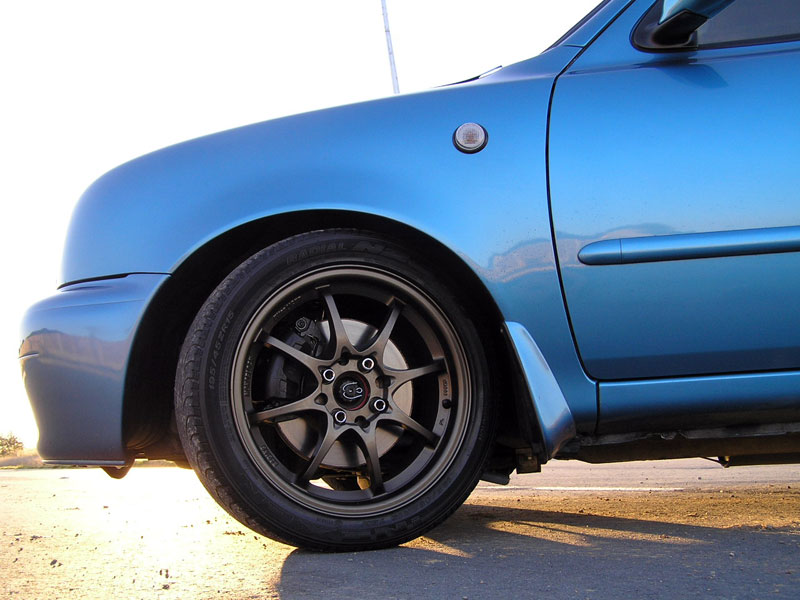

Konig Helium.
They weigh 10.8 pounds each... Very light.
They're kinda similar to the Volk CE28 i think?
