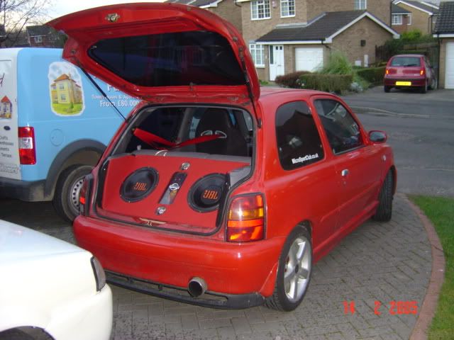

I'll put a picture up of my old install in a minute......

The only way I could fit in 3 amps, and active crossover plus a custom ported subwoofer was as follows:
My new install is a lot more simple, exchanging the 3 amps for one 5-channel (large!) amp plus a better source unit. I've not had time to trim the boot, and am going to make a fibreglass subwoofer box which sits in the left wheel arch, but here is my present install (amp hidden under false floor - will get pictures soon):

Just havin a look for ya now mate, found some random ones tho

Ok found them

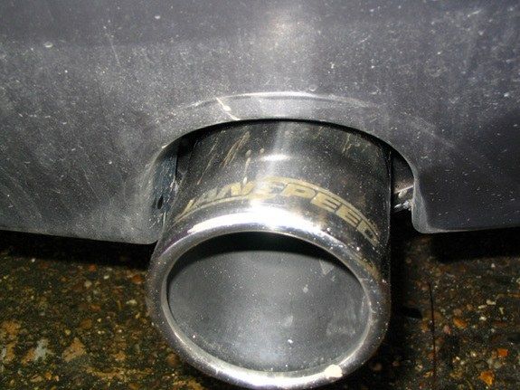

aah after seeing the pic i want one lol..even if i can get the size on the tip il just get a universal one of that size, Janspeed are good but pretty pricey i remember buying a Janspeed back box for my ae82 gt cost em an arm and a leg,apparently they're rare ?
