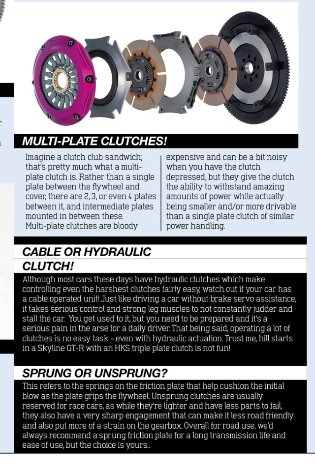

So what u running to be getting 500bhp. And how u know ur at 500bhp? Dyno? Proof? What clutch u using as mines slipping
yeah i know of dave bull 400bhp! :) watched his vids loads of times. he is a legend
so what clutch is that though? a twin plate one?
In latest fast car shows the types of clutches and gives me some knowledge of them. So that's a multi plate clutch like this
