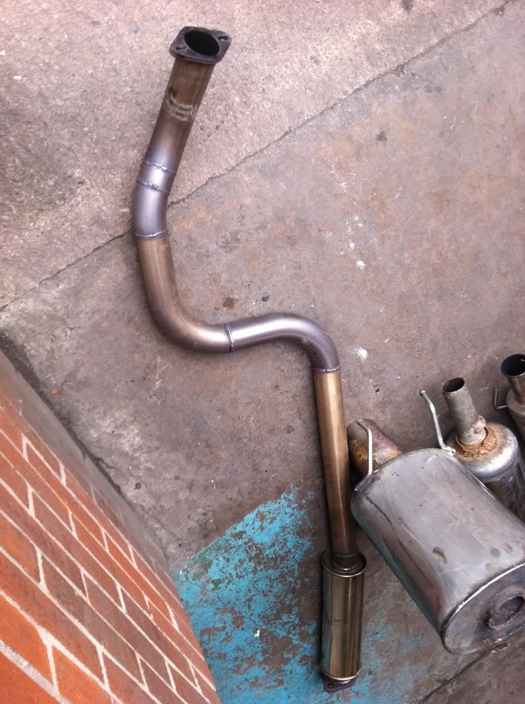

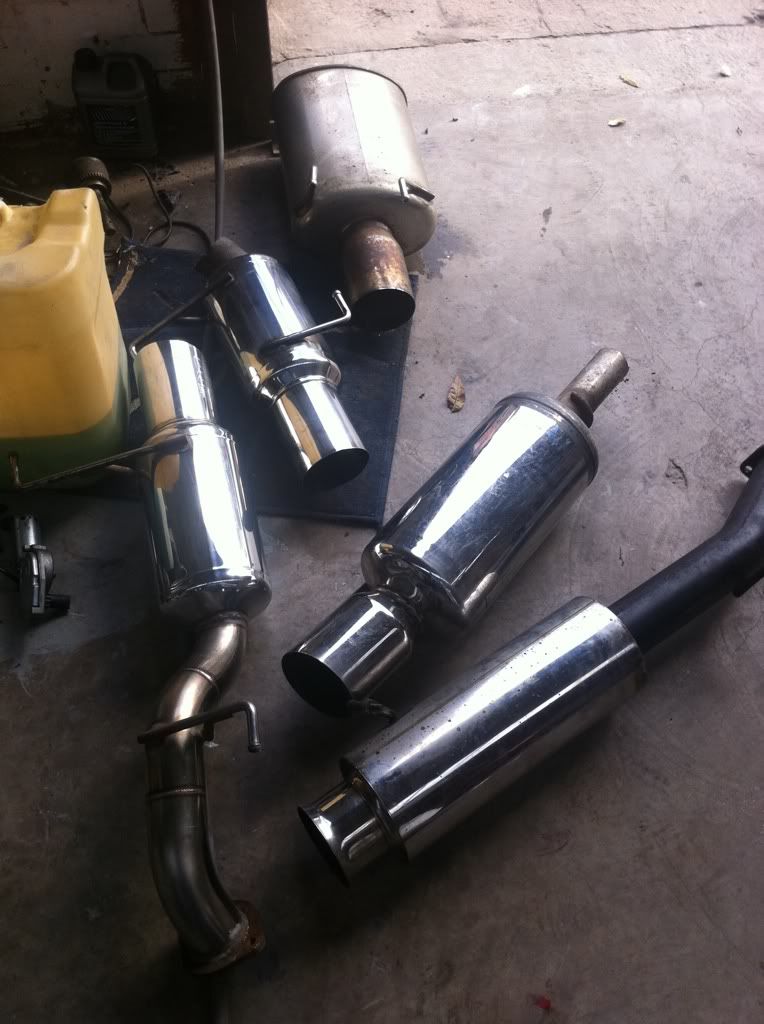

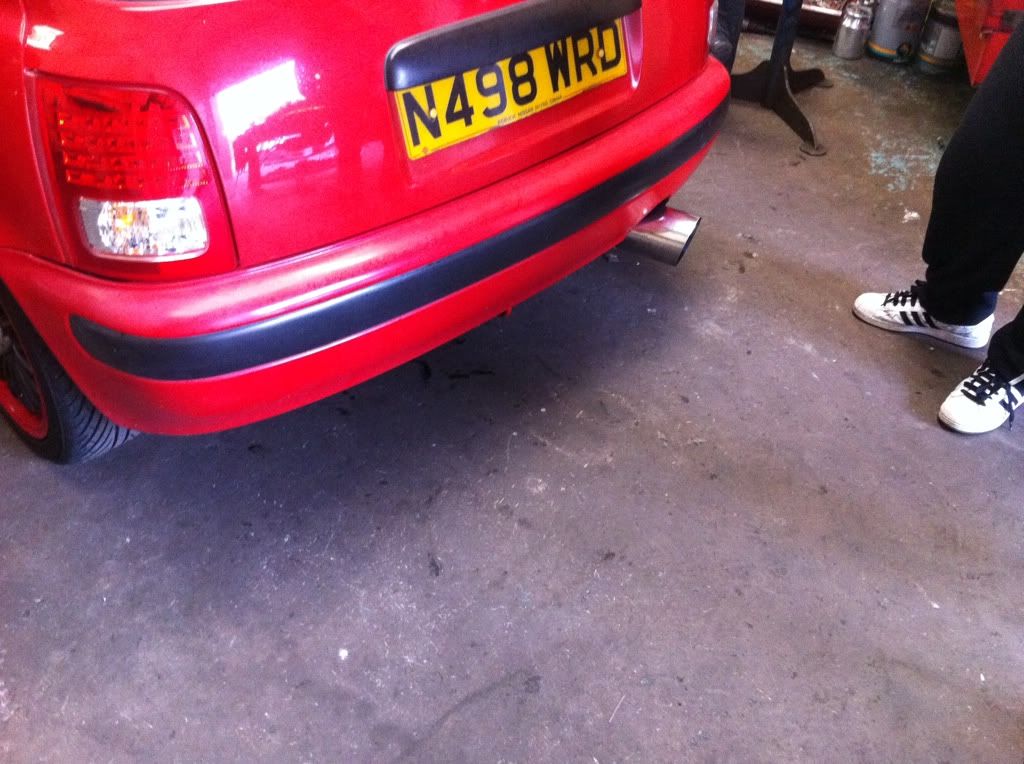

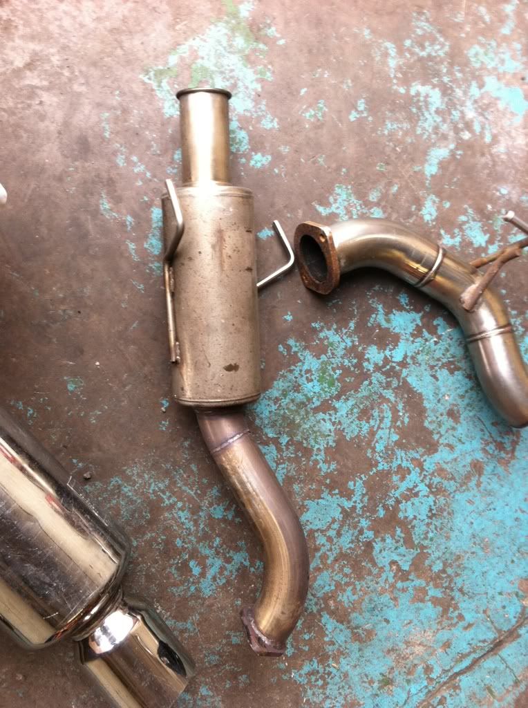

Paid a vist to Unique Exhaust in stafford for a 3" Mandrel bent Exhaust
Had few backboxes available to fit
Super Dragger -
Fuji Gike -
5zigen -
Blitz Nur Spec -
All of them where too big for the micra, the blitz was the only one that would fit but would stick out slightly.
The plus side is the brand name would be view able lol...
Old 2.5" Mandrel bent Spoon Exhaust
New 3" System
Took ages to customise the blitz back box, no room cause of the whiteline gear.

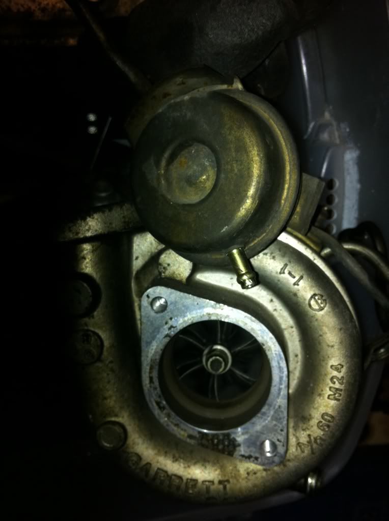

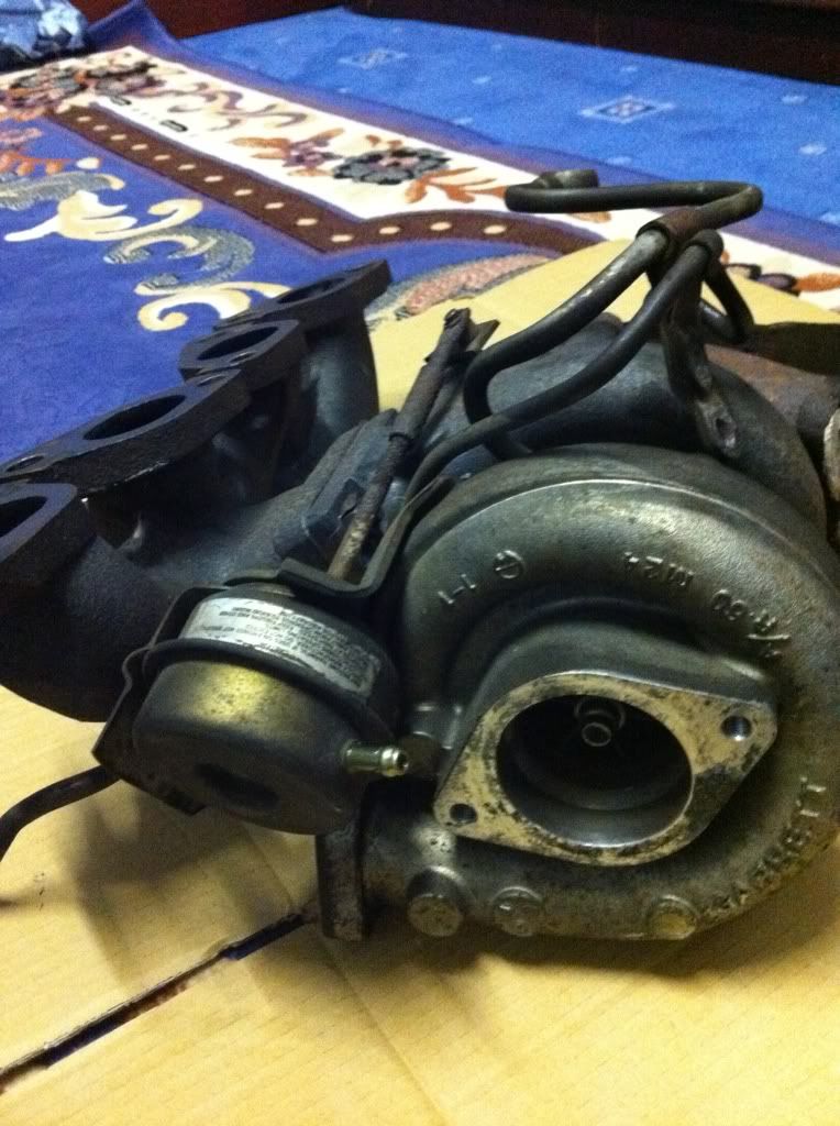

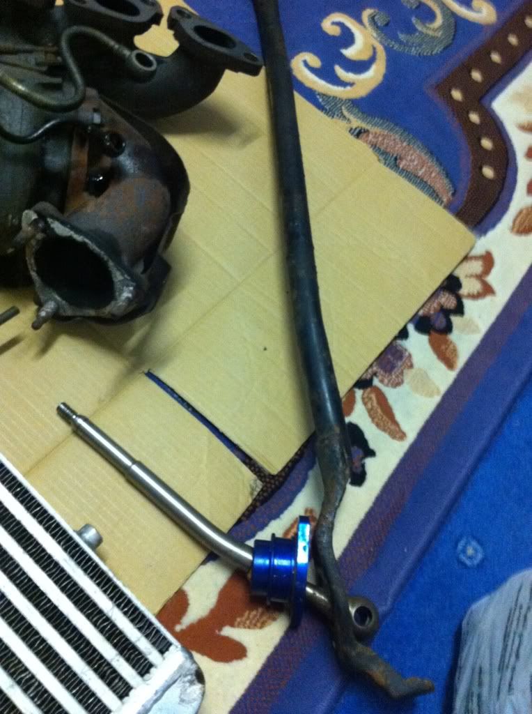

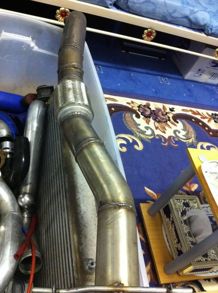

Most of the parts are here/got:

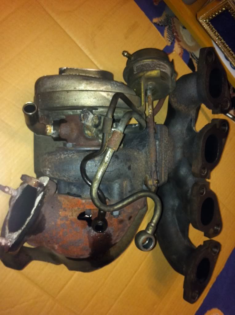

Turbo - Garrett T28

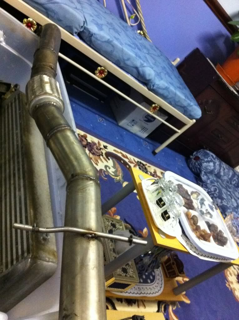

Intercooler + Pipe - Choice of two will go for the smaller one for less lag

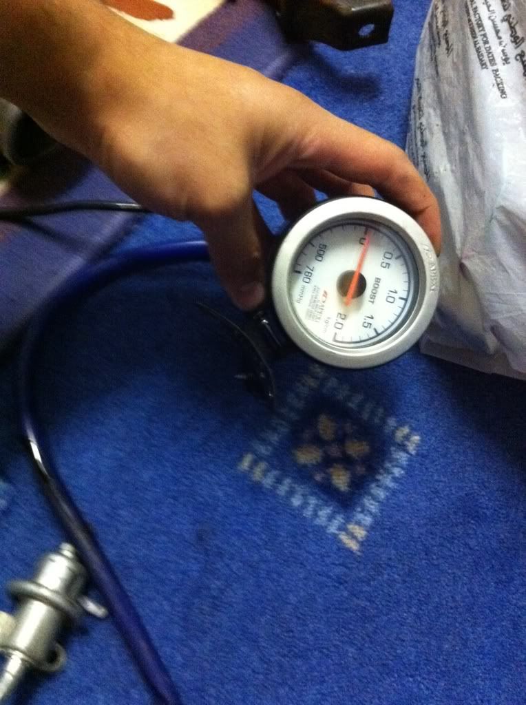

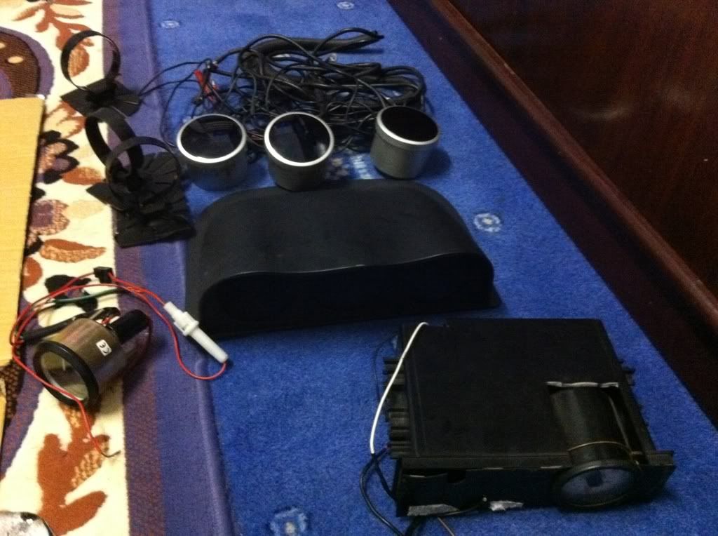

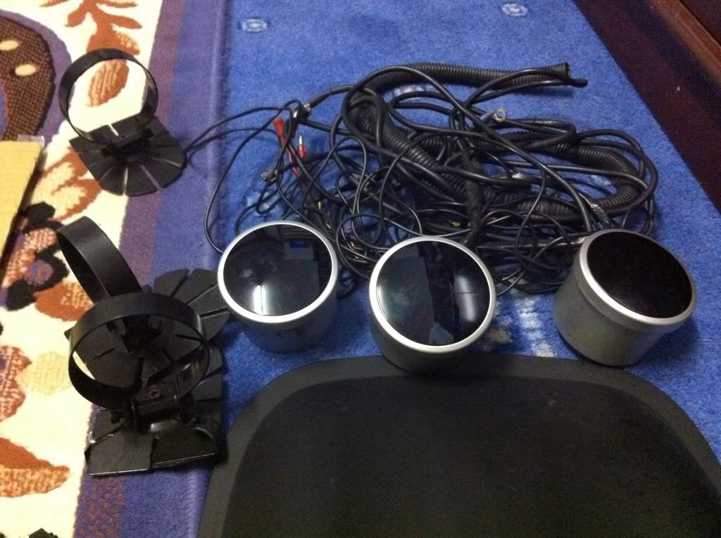

Gauges -

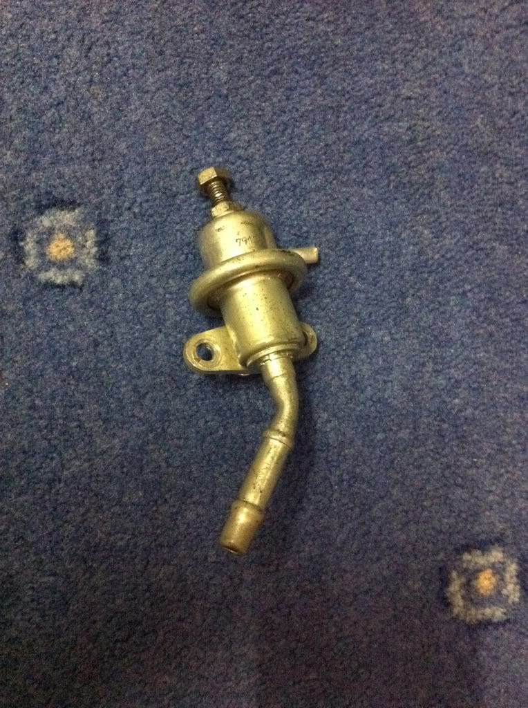

Nismo FPR -
3" downpipe -
B & M short shifter -
Poly mounts -

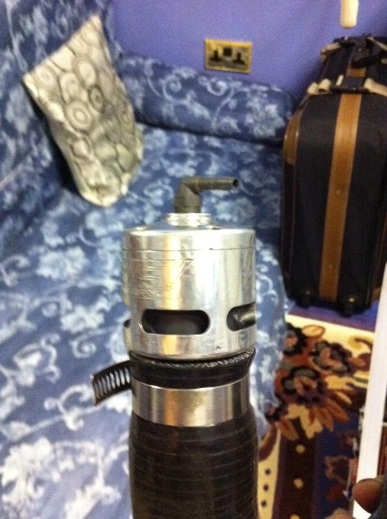

Dumpvalve -

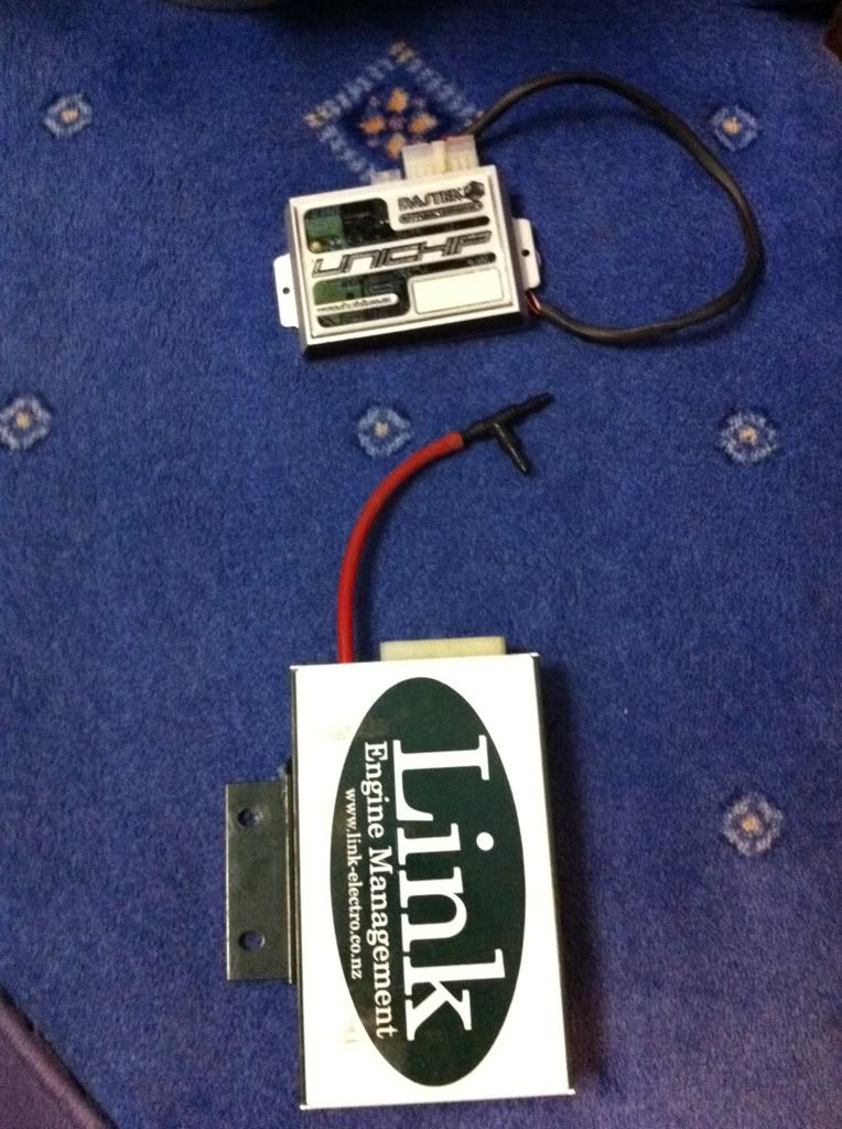

ECU's - I will be going for nistune rather than link or dastek
awaiting few parts then ready to go -

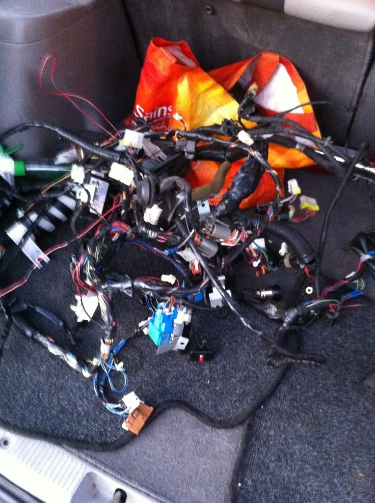

Decided to go for a full gti interior loom...

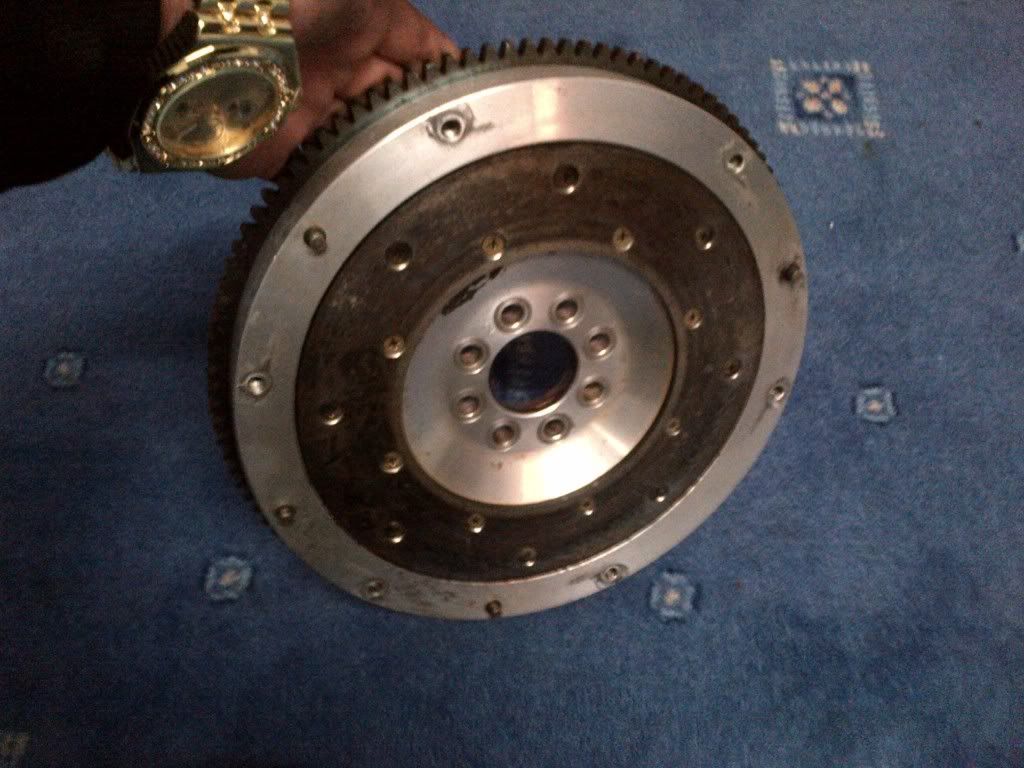

Fidanza fly and Gspec clutch

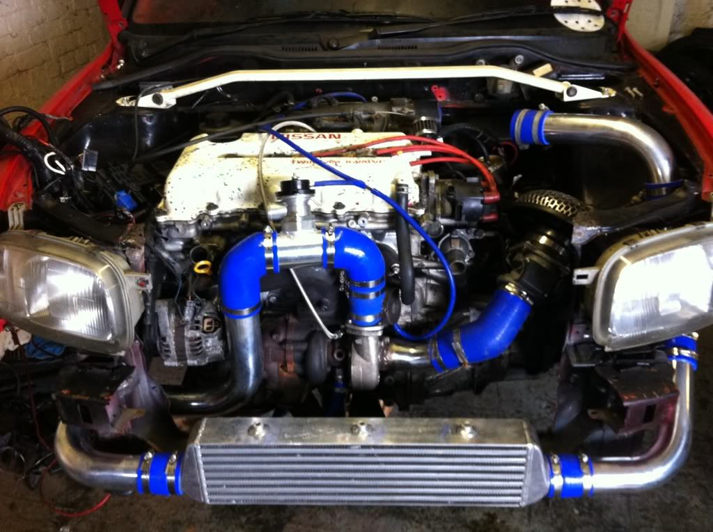

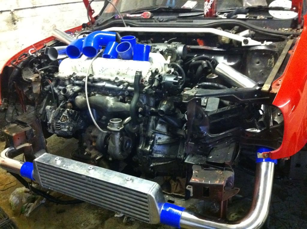

Fit turbo / intercooler

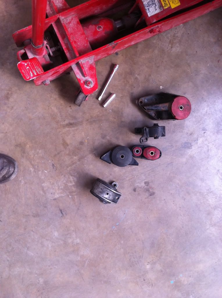

Front and rear mounts

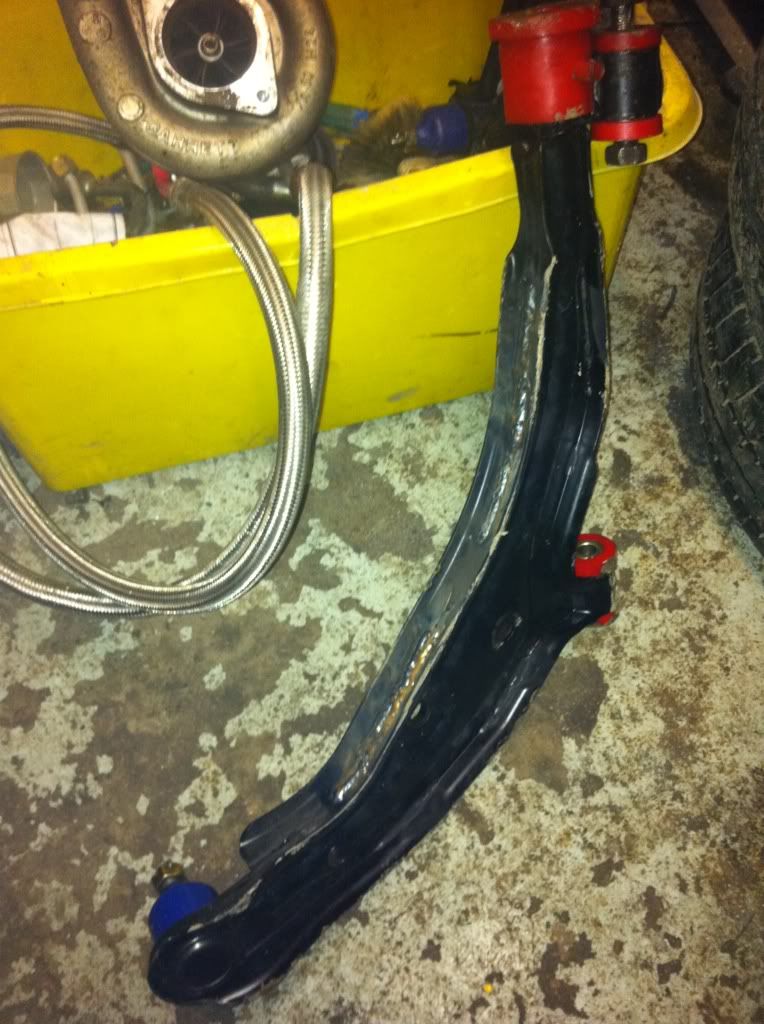

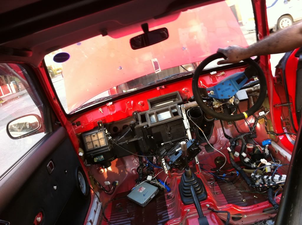

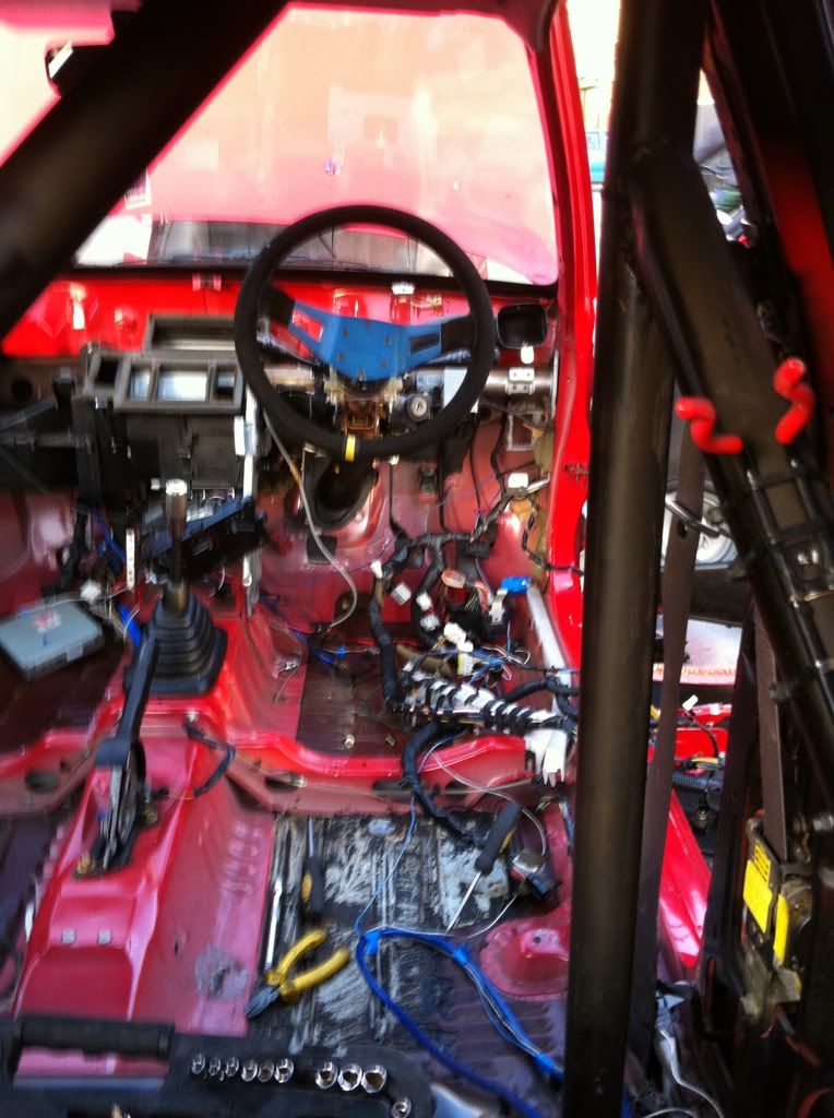

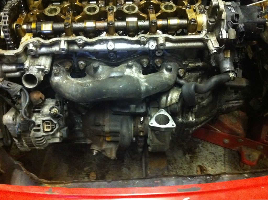

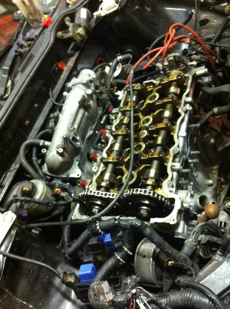

Holidays gave me chance to start on the car... done quite a bit hoping to get rest done by the end of the week.

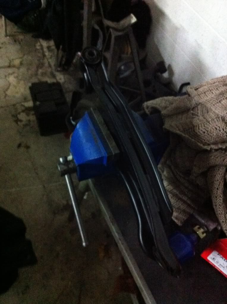

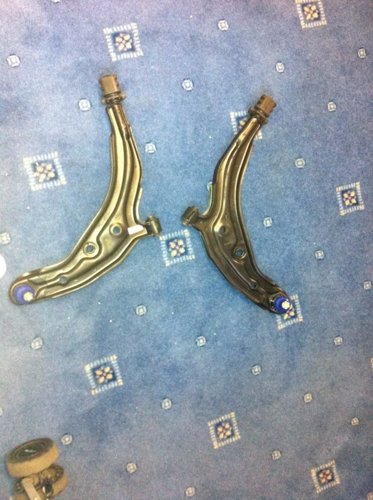

New wishbones poly bushed and welded.

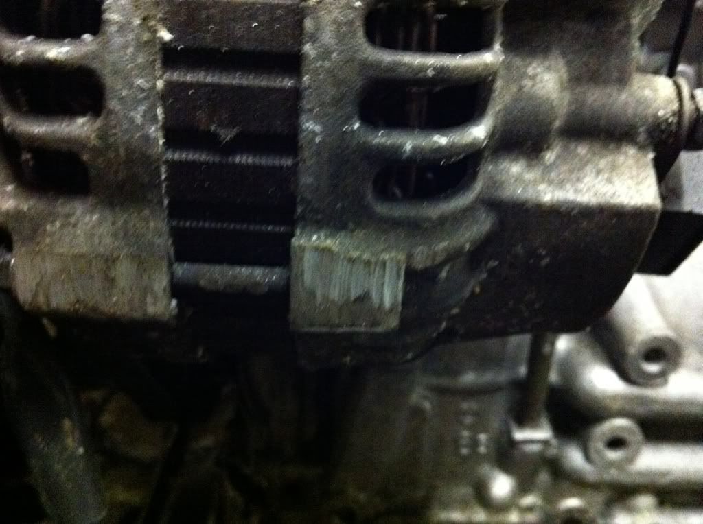

Filed the alternator so hopefully no rad problems
Yellow stuff pads and brembo brakes
Took most of the sound deadening off.
Wired the almera loom in (not connected yet)

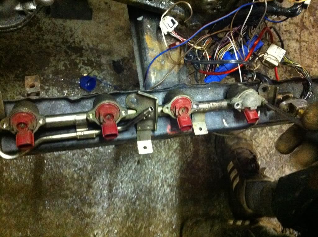

Put the purple injectors in
Fidanza fly and clutch

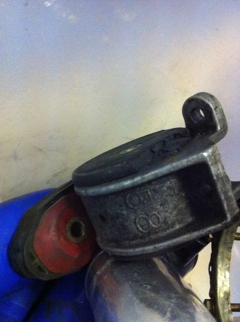

Mounts
Got more bits (oil pressure switch, gauges, oil return feed and quick release steering lock)

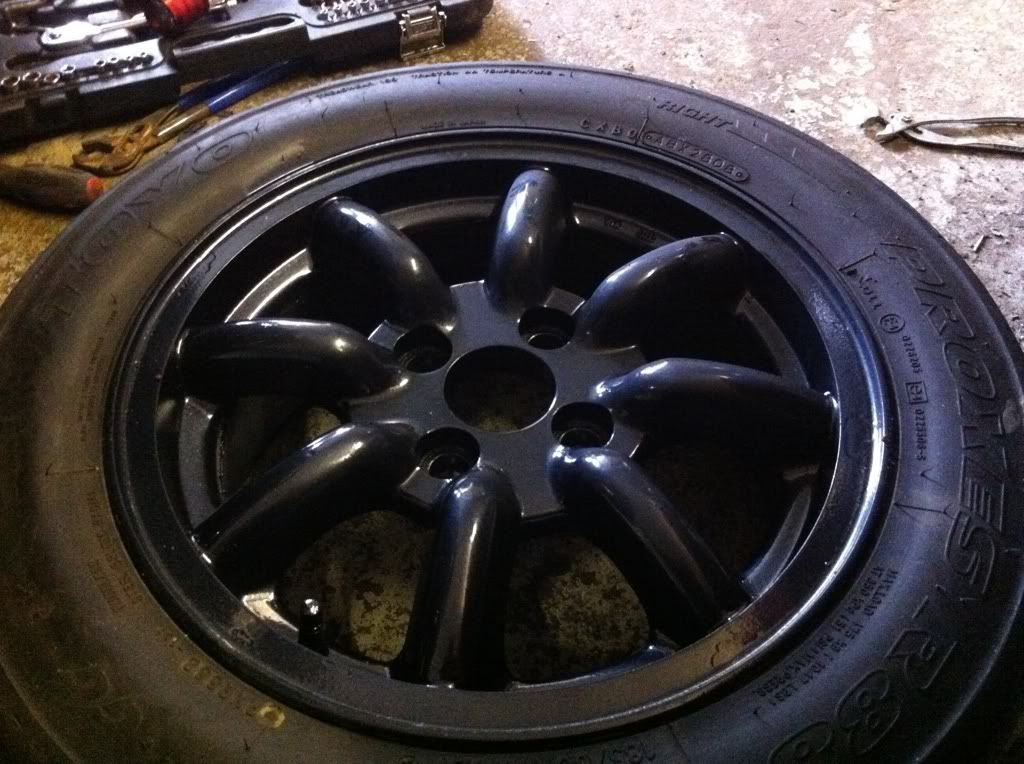

Sprayed new grill and alloys
