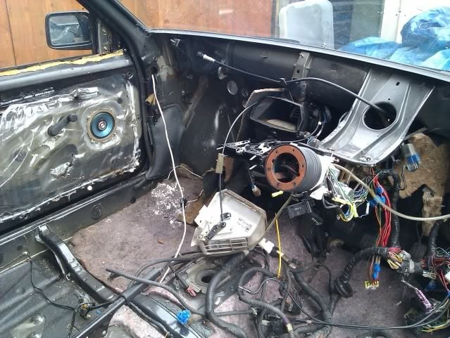

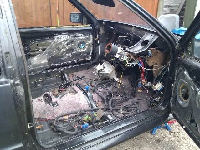

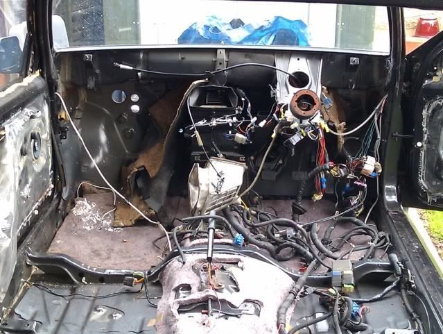

Not expecting an easy build with this car, Ed stripped the engine bay and some of the interior around 2 years ago then another project and commitments took priority.

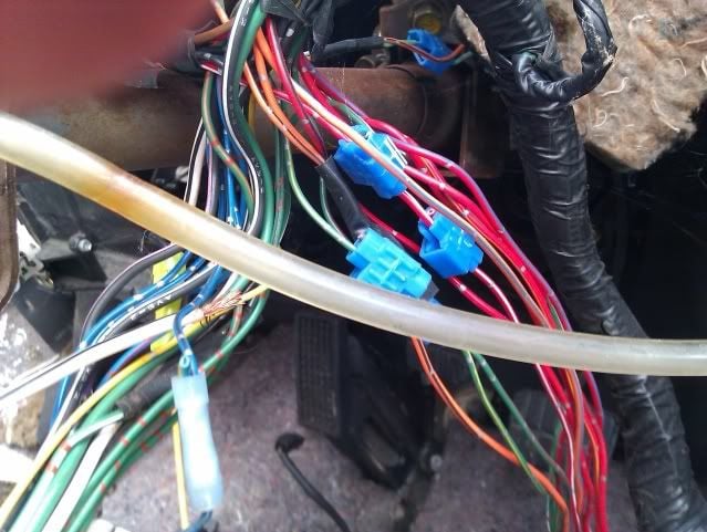

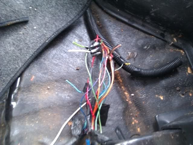

Wiring was a little mess with lots of wires for amps, speakers etc these have now all been removed along with seats and carpet, dash was removed by Ed previously.
Clifford alarm was removed so may need some repairs and alterations to the loom, will find out upon closer inspection.

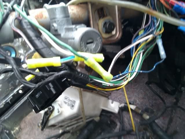

The evil that are scotch locks, will be disposed of appropriately and wires repaired.
Rear loom needs some minor attention.

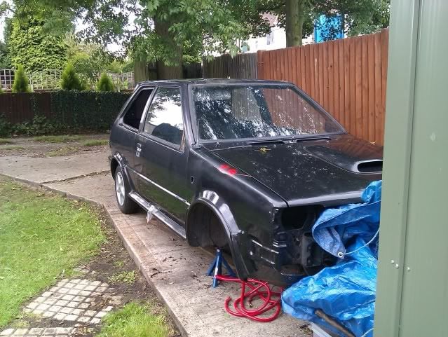

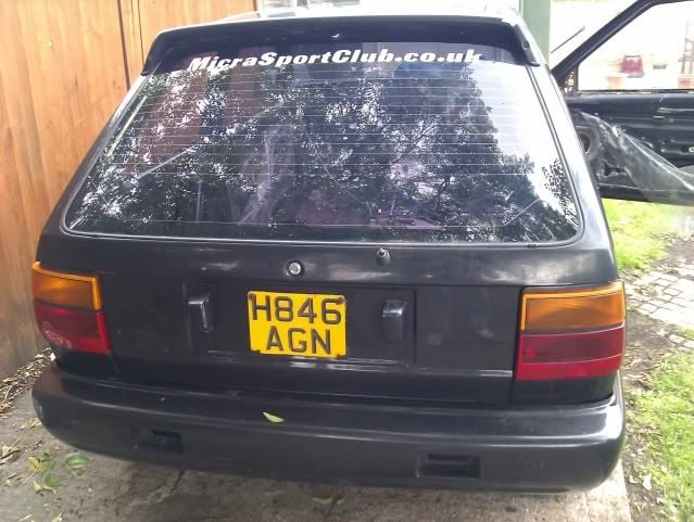

actually pretty good, Chassis is solid through out. Lot to refit, i only removed all the seats, carpet and several thousand miles of speaker wires. lol
Less frightening than when she was picked up. lol
What I meant was I didnt think it was missing all that:laugh:
I remember Ed saying to me the shell was a good one.I have a full st loom there if you need anything

What's wrong with scotch locks?

Agree id solder too. This car was going be stripped and dipped when I had it hence why its in so many pieces. The shell is totally spot on. Even though its sat for years its still really really nice. I was going to just make it totally perfect and origional in every way but I know I will now simply never have the time to do so. :)
I have the tendency to burn my hands on soldering irons so scotch locks will do the job for me! Will look forward to seeing more updates
scotch locks are the worst thing ever invented, anyone caught using them should be shot on the spot, the amount off wiring problems ive fault found on cars (other peoples) that are caused by scotch locks is unbelievable. choc blocks are marginally better but still bad. soldering only on car wiring im afraid, only proper and most reliable way to do it.

That blue is awesome. Agree that Scotchlocks are the work of thedevil. Soldering and heatshrink is the only way to go (Y).

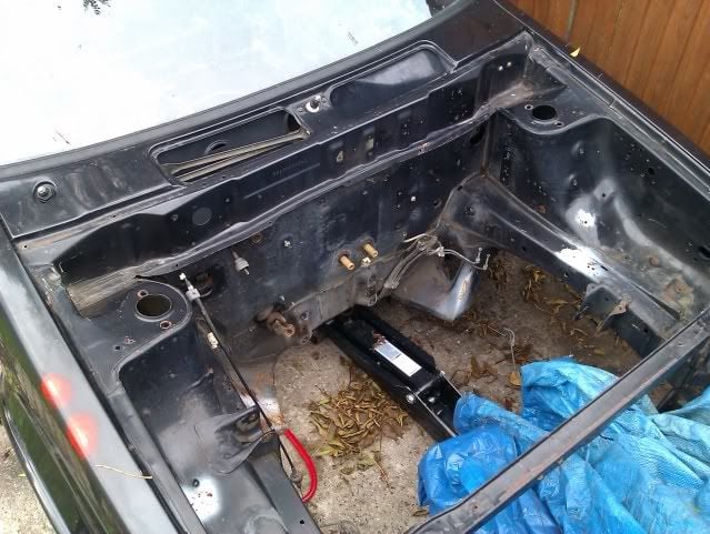

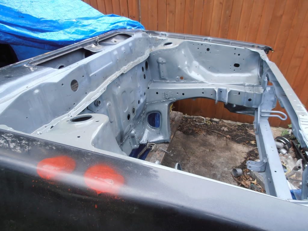

Engine bay de-rust stage 1, will be semi primed by Sunday then i will slowly move to the back of the car. Need to pick up more parts from Ed.

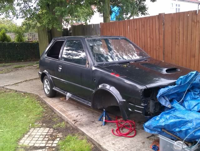

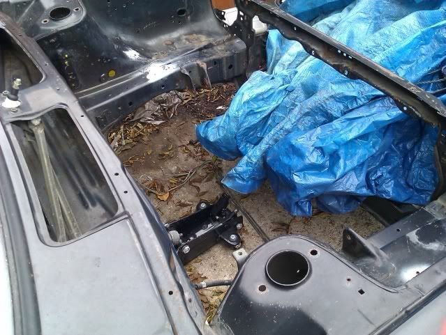

Front end stitch welded, pictures only show a very small amount of the work. Strut towers have been filled smooth.

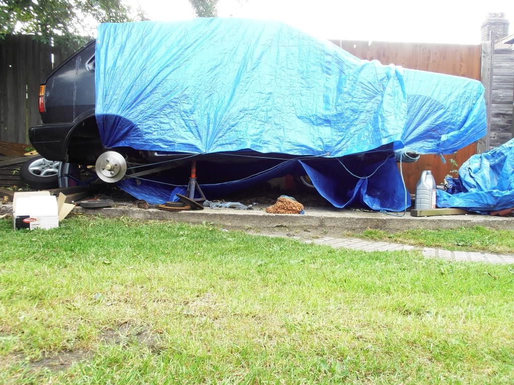

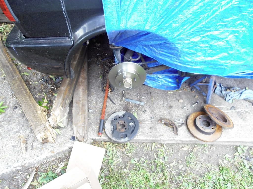

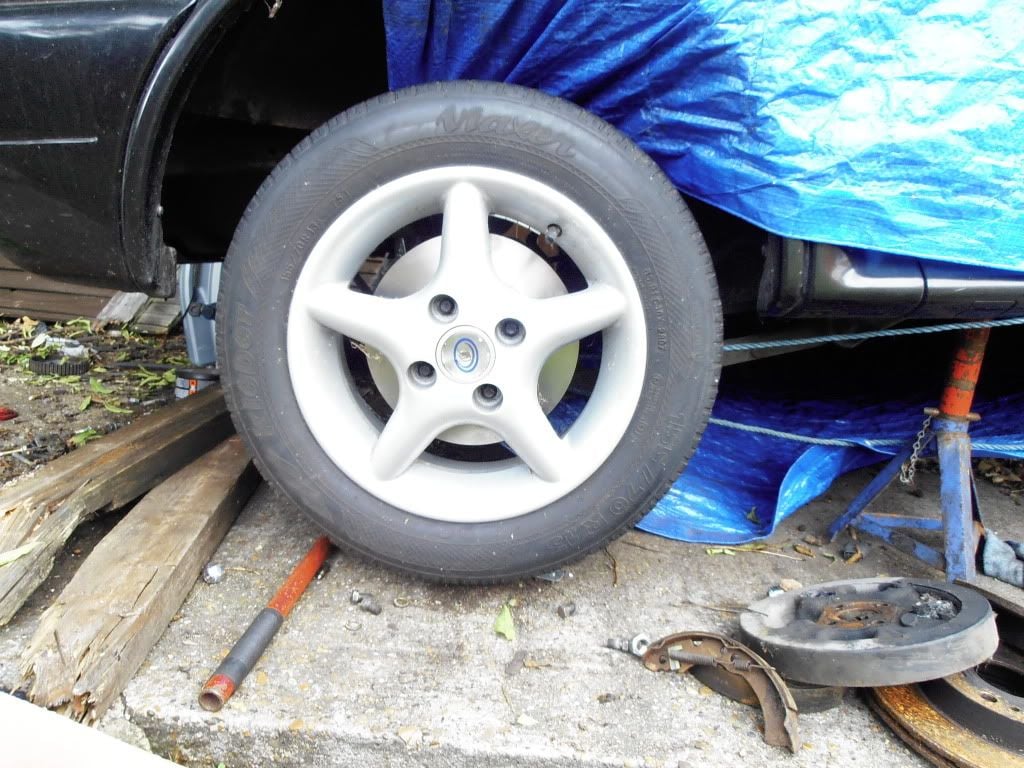

Rear brake setup:
Rear K11 discs with Golf MK2 rear calipers and some custom bracketing. The suspension strut will affect how well it works but I think I will have success and I am getting the calipers for free... recons from work ;)
Will also have Caterham 4 pots on the front once I have got a bit further with the rears.

Rear brake setup:
