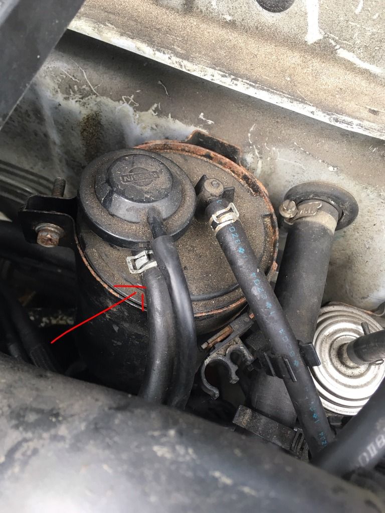

Anyone have any idea's on what this little takeoff pipe on the TB is? Can't remember where it went
Same for this one on the intake manifold. Big one is for the brake servo but no idea what the little one is :S
Well that's it for now, gonna clean the intake manifold and throttle body up a bit before i stick it back onto the engine. Then the fun can begin on working out where everything needs to go on the K11 loom.
Oh yeah, I remember how annoying it was to reach some of those bolts back behind all the hoses and everything. Shame I can't really help you with K10 attendance on JAE. Even though I will hopefully have mine running by then, it's a tad too far and fuel costs alone would be enough to buy another K10 or two. However, I can help you with the mystery takeoffs:
I'm not 100% sure on the orange one as it doesn't seem to line up with the diagram, but hopefully this should be at least of some help. Also, keep in mind the photos are of a LHD car, so the brake servo is on the other side, etc. Your mileage may vary :)
Best of luck getting her to run on time!
Hi Ben, glad your still cracking on with this project.
Just had a quick look at the car and the one at the back of the take manufold goes to the carbon canister
the one on the t/b is very close to the throttleplate ben, so no actual mani vacuum but a high venturi flow at low throttle (to vent the white plastic canister purge valve on the end of the head)

Sorted this pipe with a screw, it's a vacuum takeoff for the carbon canister (thanks for the help btw guys!) so i won't need it anymore
