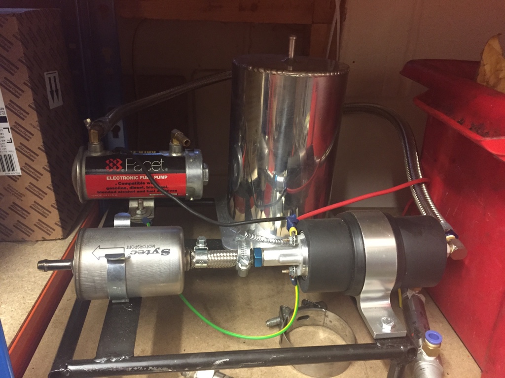

I've got a gold top facet pump for sale and a sytec fuel reg too
The red pump at the back , great condition
Ooo cant remember, not much, it's meant to replace a mechanical pump
Plus the fuel reg keeps the pressure down
£40 for pump
£15 for reg
Posted :)
