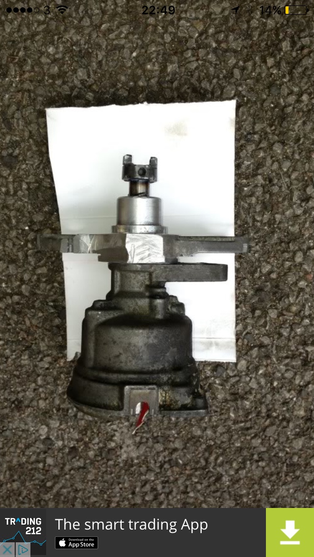

Had a little play with my K11 distributor after work today to see if i could get it apart. It proved much easier than i had thought actually. Now i'm just trying to figure out how to best cut it up so i can use it to mount my MA10 distributor to the CG :/
I ended up using more tools than i thought though haha. Yes the mallet and impact driver were necessary for some stuck screws!
Stripped down to the parts i need, main body. bearing and the main shaft with slotted drive thingy attached.

Just found this pic of my old dizzy ,
The brighter silver part is what's left of the chopped up k11 dizzy housing, all that remains are the bolt hole parts, i then drilled it out so it would fit over the k10 dizzy
So it's like a collar
Then welded on the k11 drive to the k10 dizzy,
Sent from my iPhone using Tapatalk
