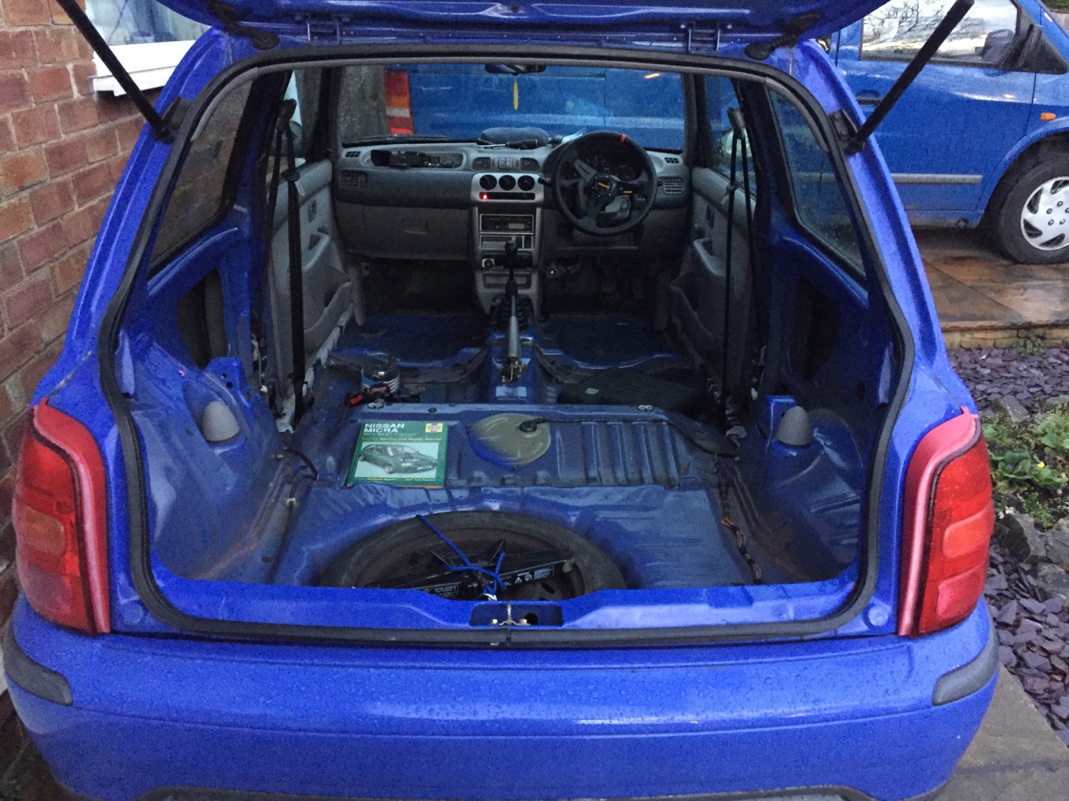

Stripped interior

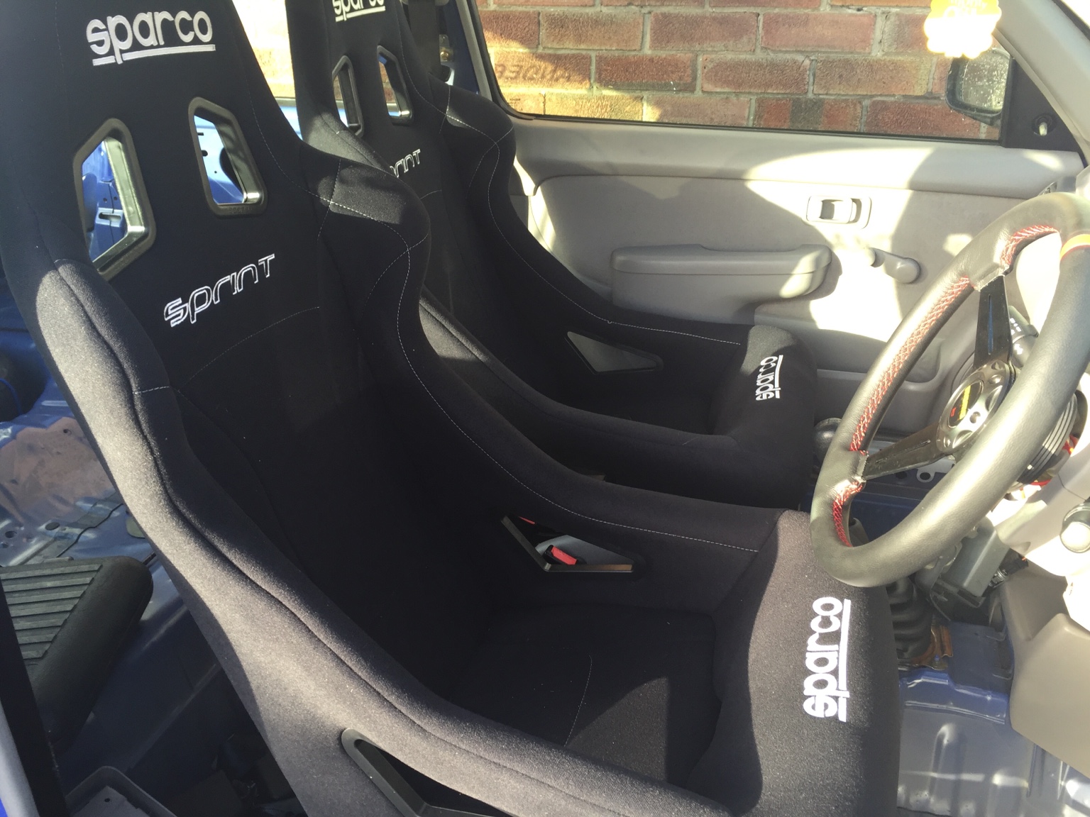

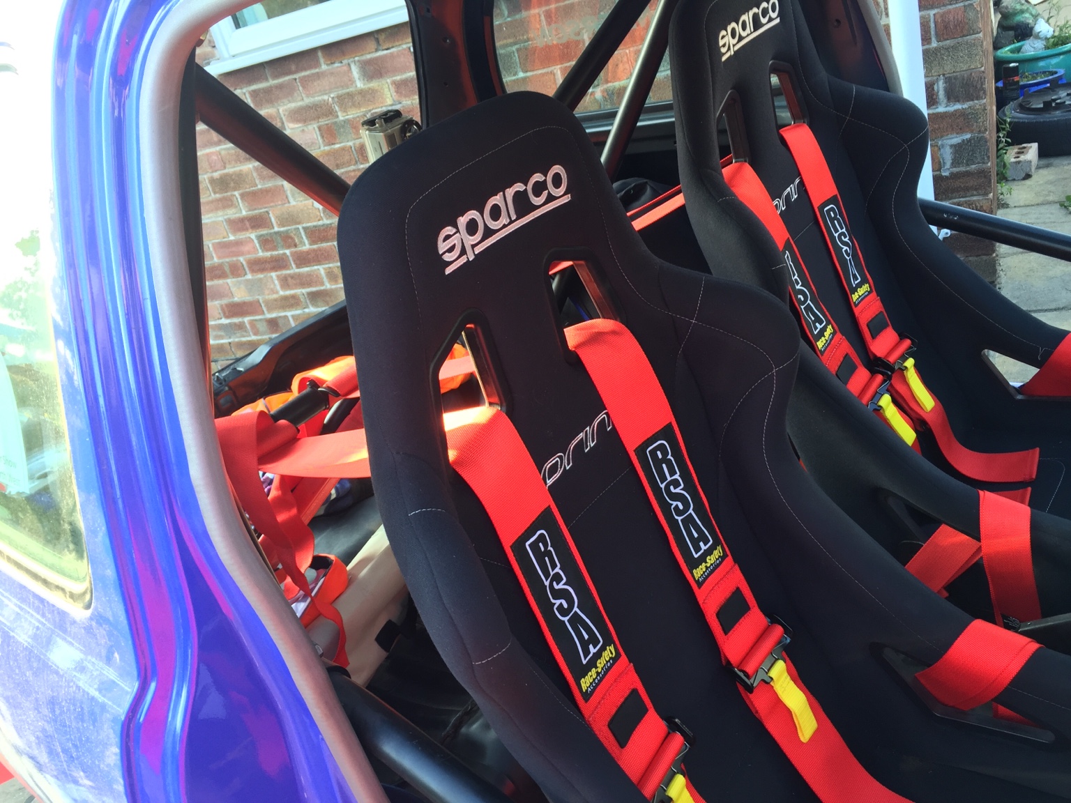

Placed 2 in date Sparco sprint seats

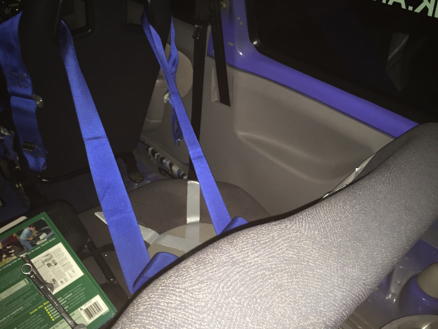

And 2 out of date sabelt harnesses (only for autosolo)

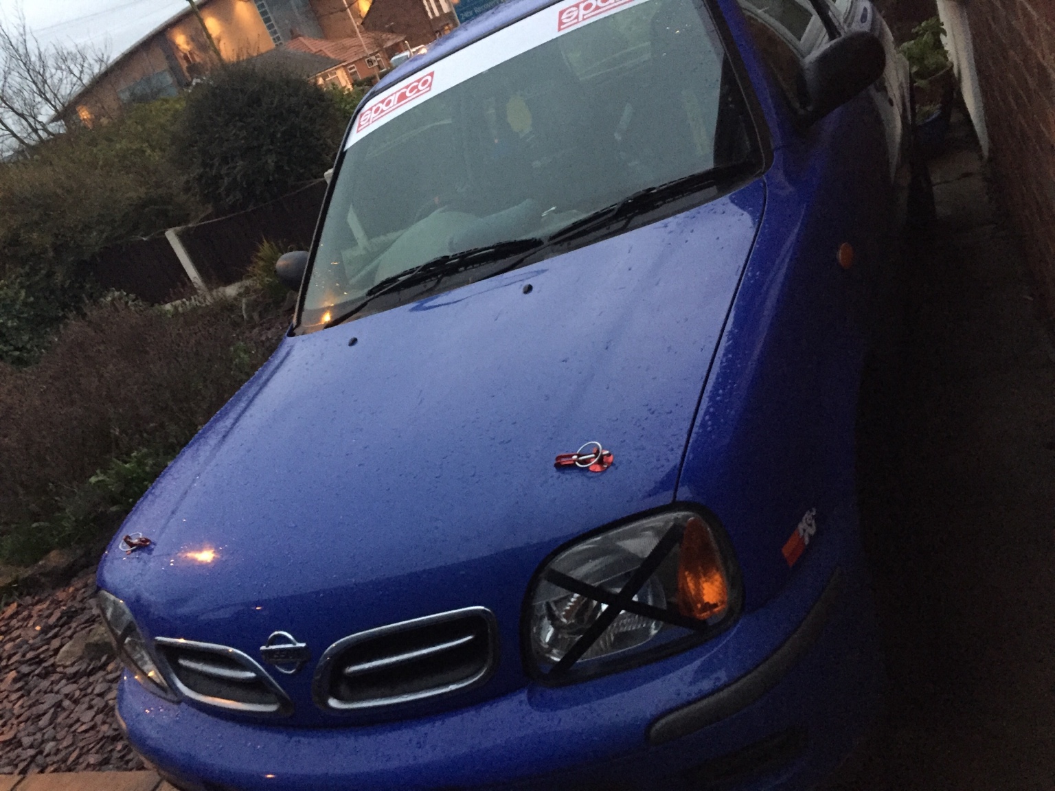

Sparco red bonnet pins

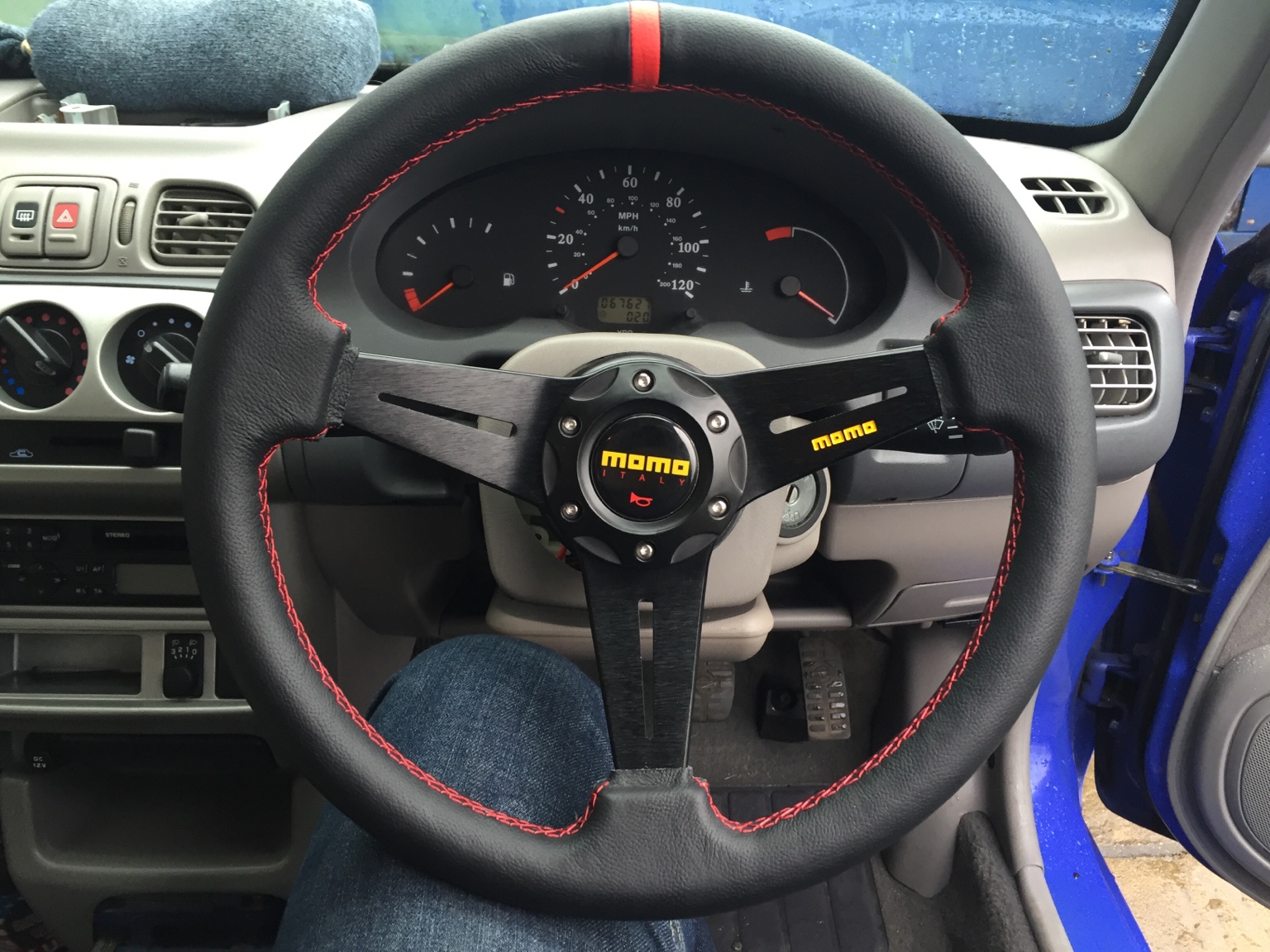

Replaced the standard steering wheel for a mono Italy in red

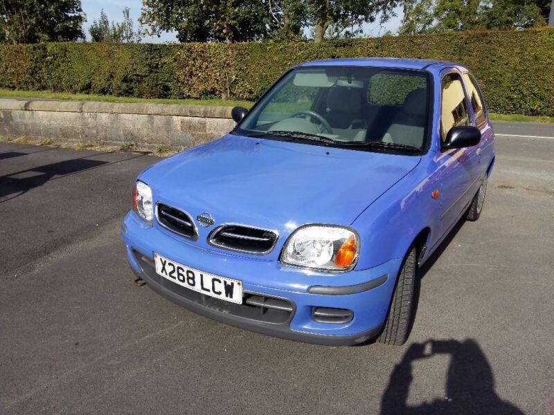

When she was bought!

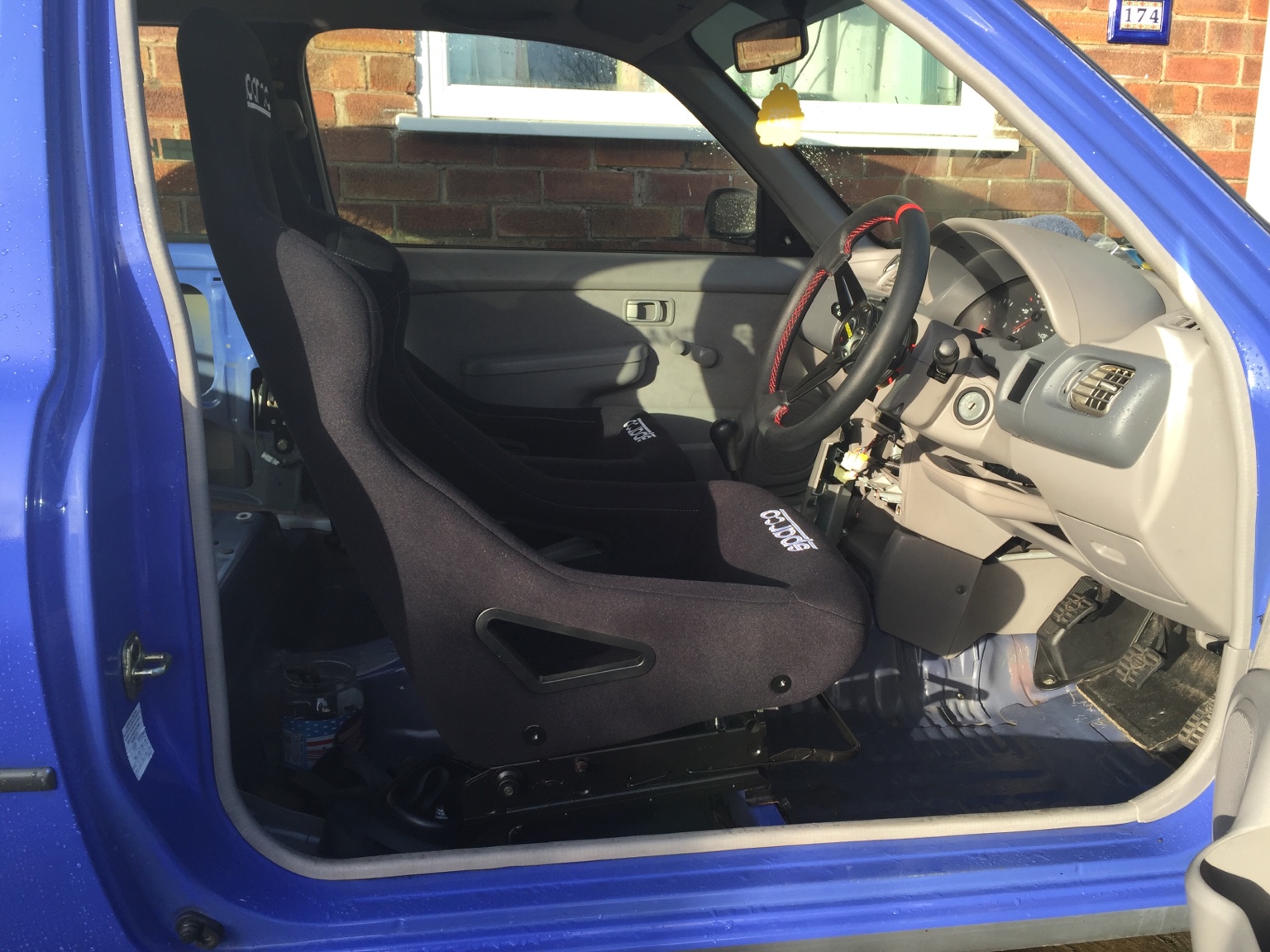

Stripped interior
Steering wheel

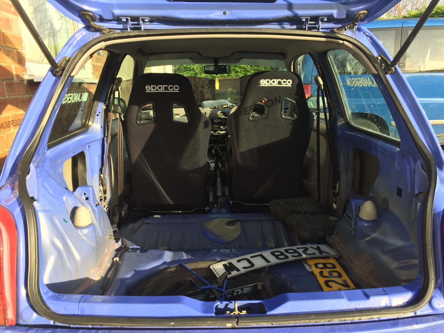

Sparco seats After making a bracket out of the standard ones

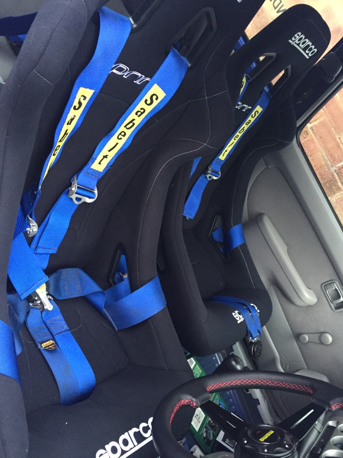

Harnesses nearly all fitted

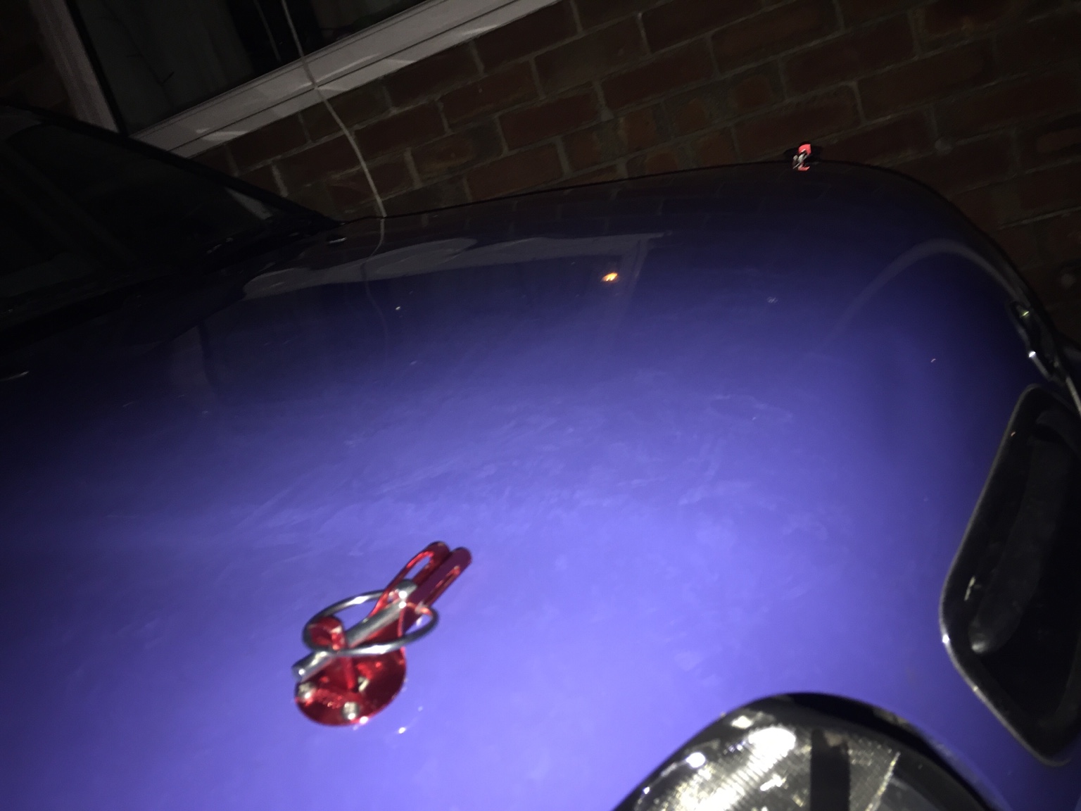

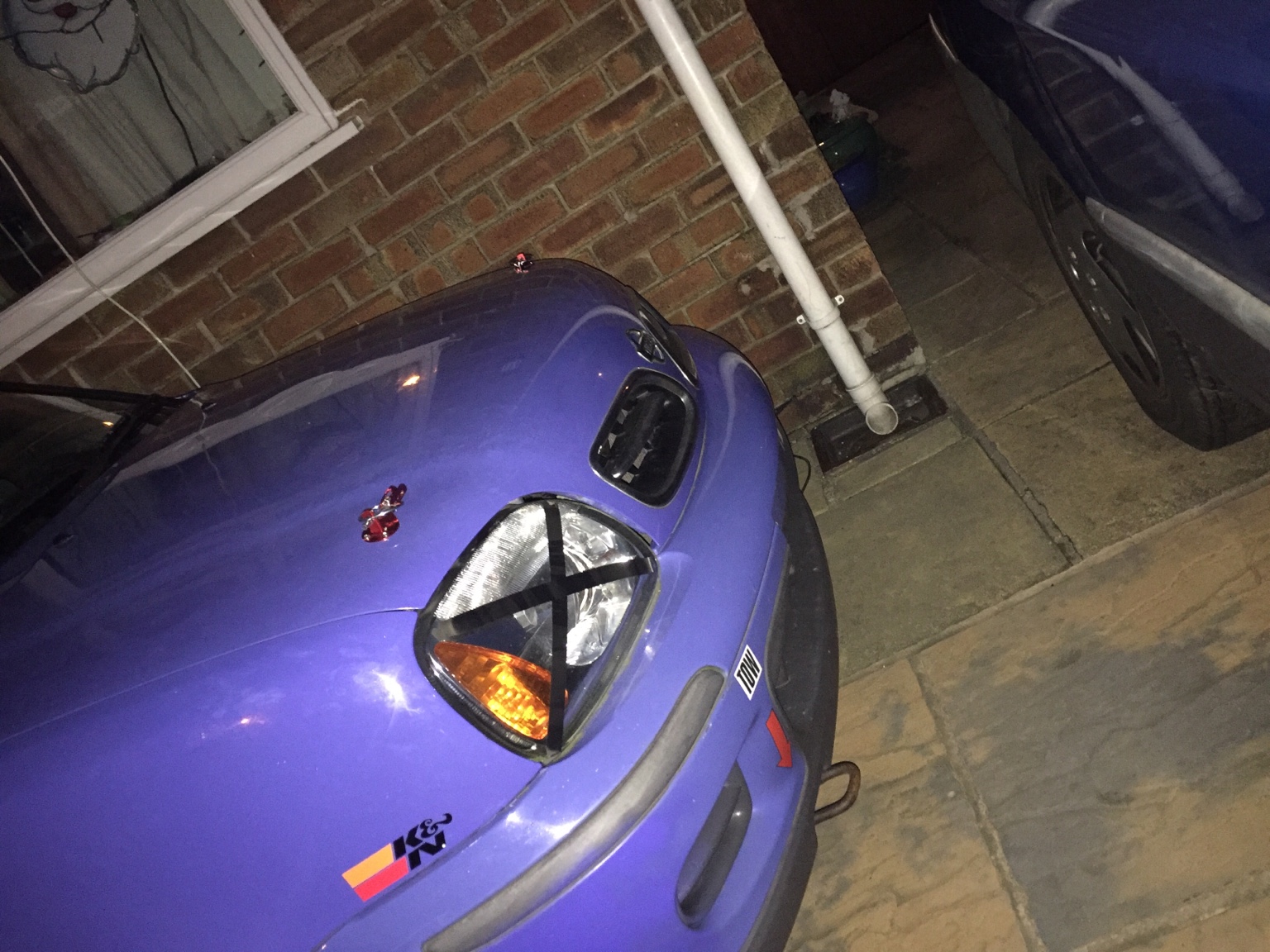

Bonnet pins (took awhile as I was scared of drilling through the bonnet!)

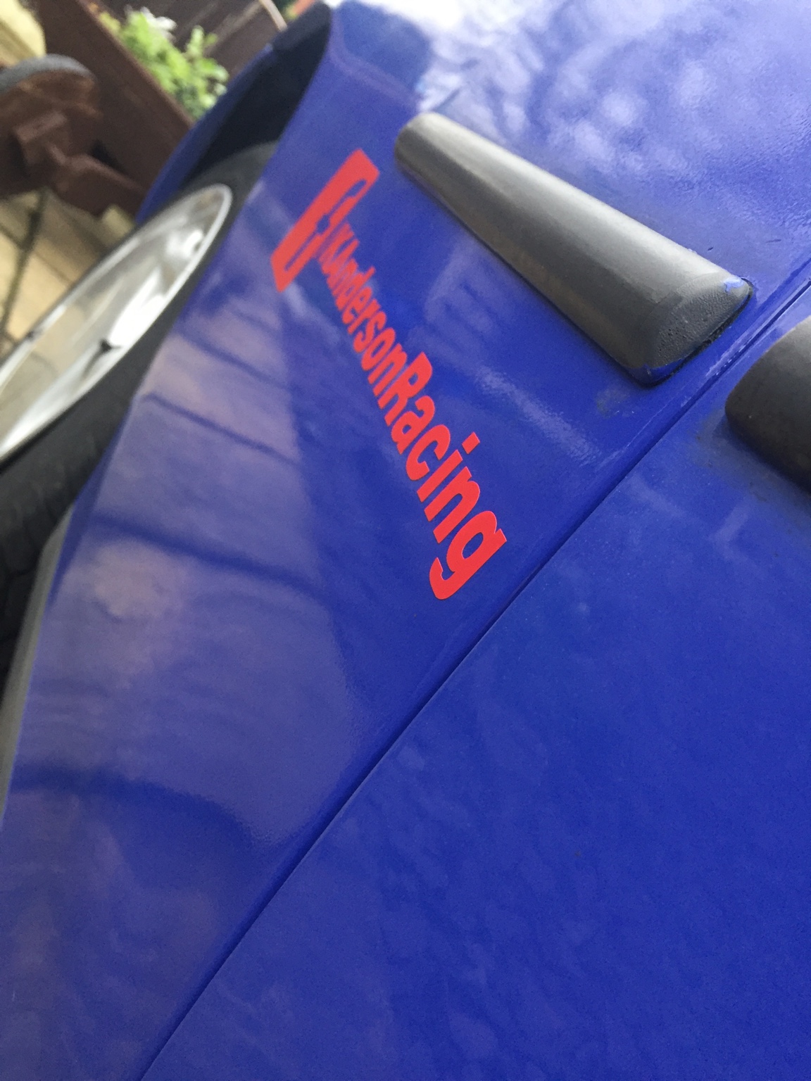

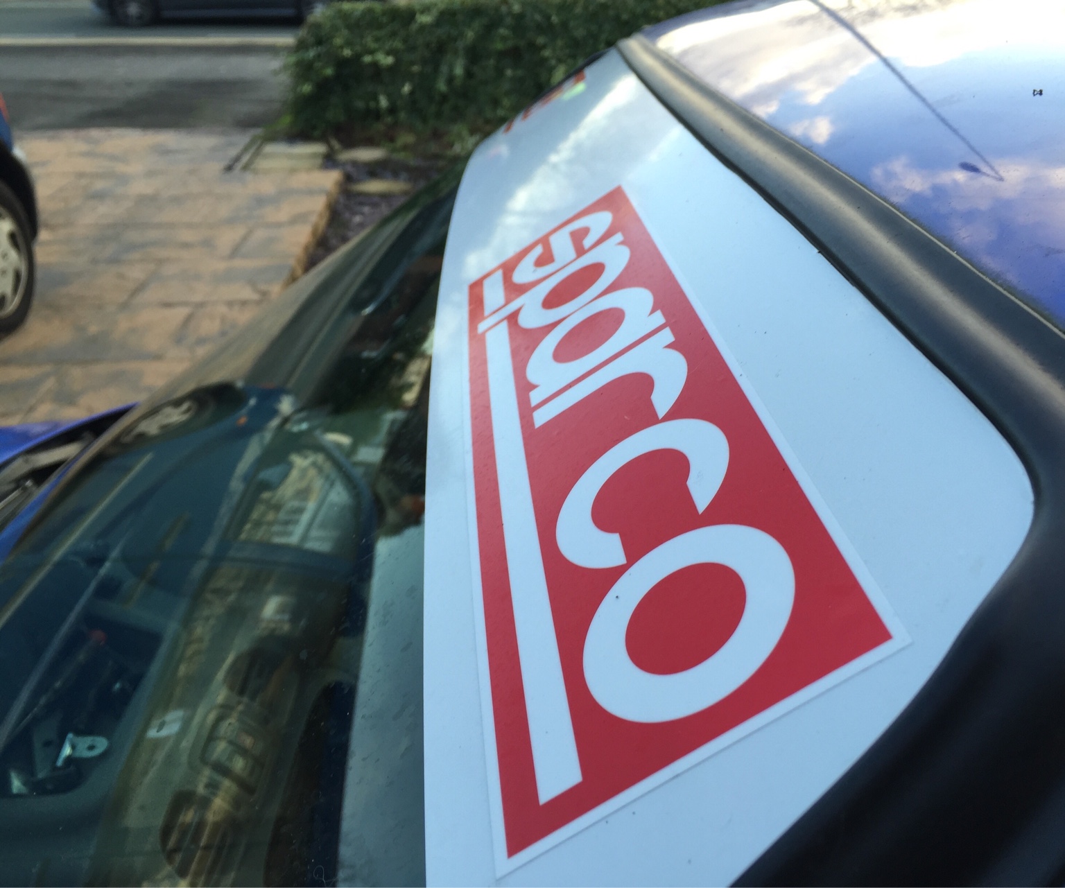

The odd decal here and there

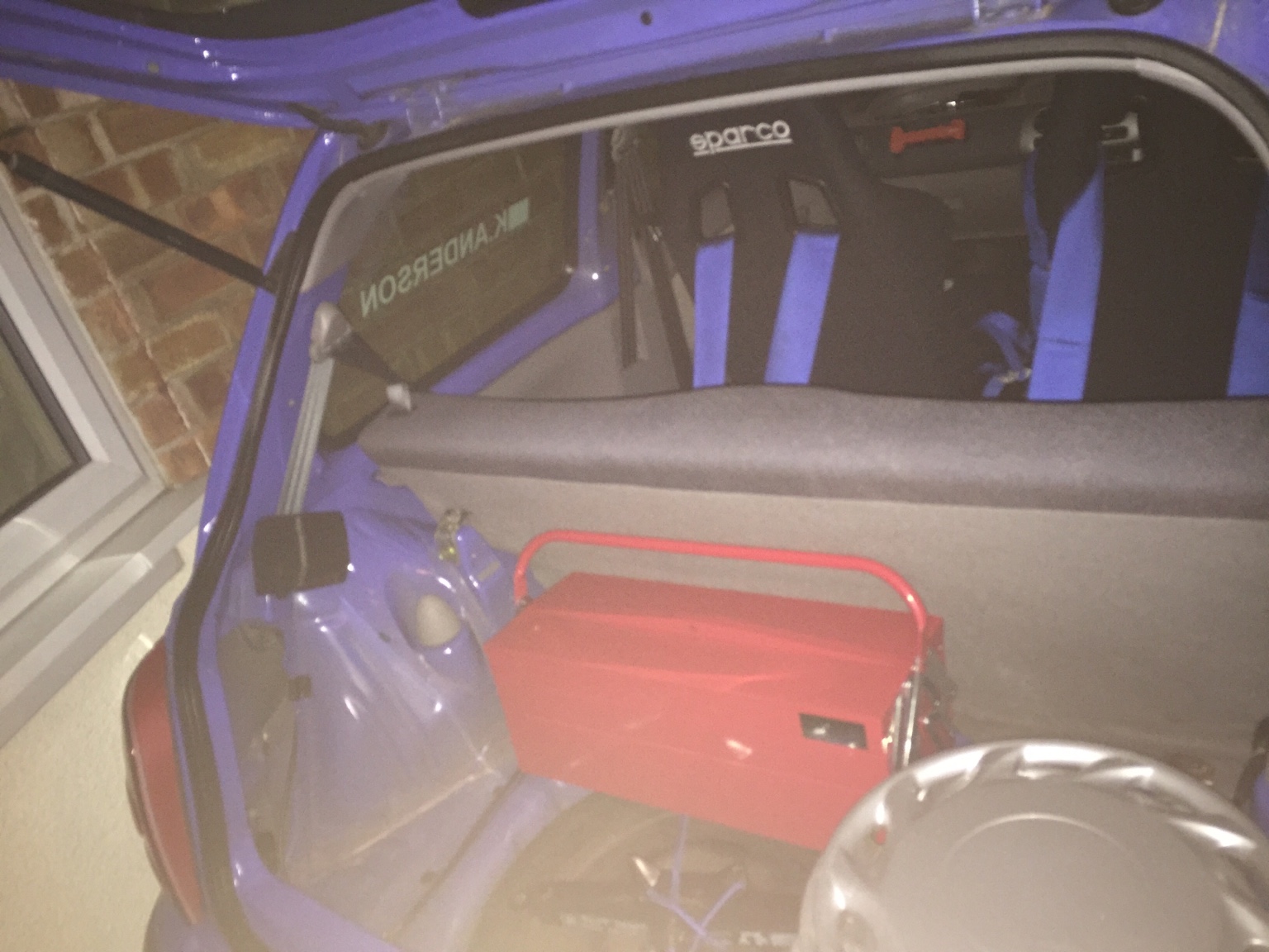

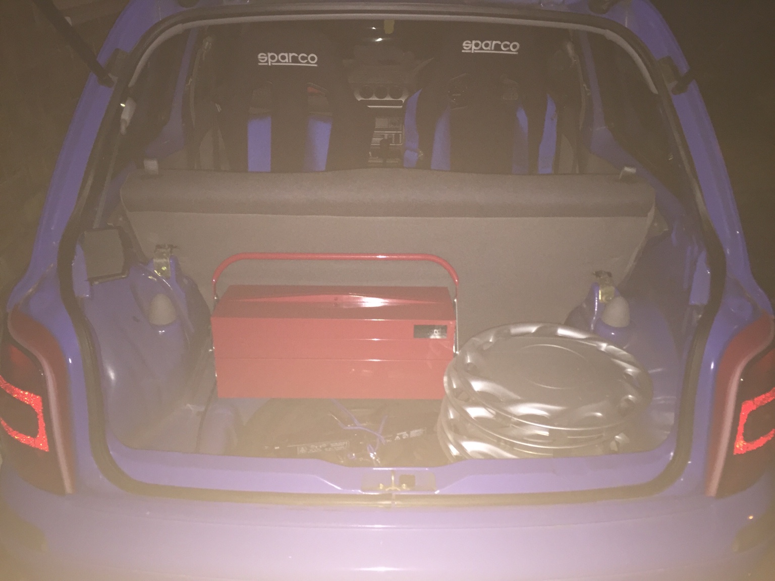

FYI you won't be able to road rally it like that!! You need all the rear trim back in, will be fine for autosolos tho.
That's good news then, should be OK. Apologies for being the bearer of bad news.

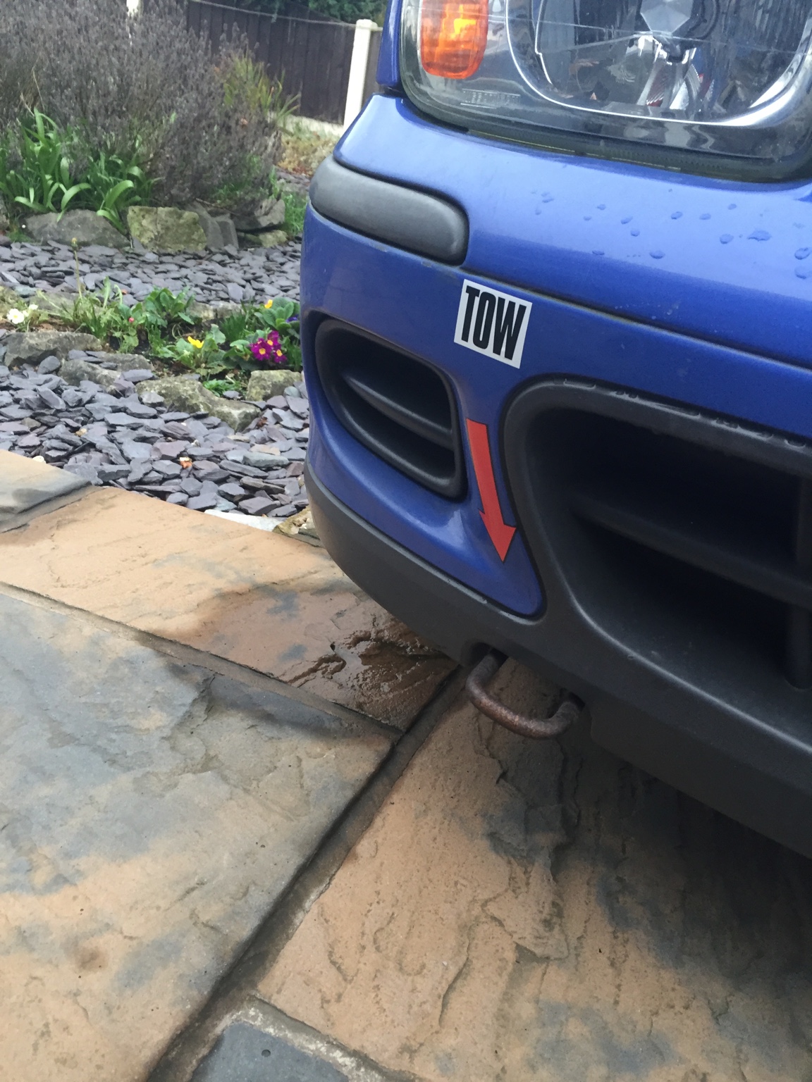

My recommendation would be to paint your tow hook red or something, now you have a big arrow pointing at it, that'll make it look nicer imo.
Also you state in your op that your harnesses are out of date, pretty sure that's fine for road rallying. They only need to be in date for stage rallying I thought, @SuperUno will confirm/deny that.

I presume the tool box and wheel trims won't be there on events..
Yea tool box and trims are just in there for storage at the min, stickers are for the autosolos as people seem to get confused by the driver. Some how... I believe I can't do road rallies at the minute as I am only 15 going on 16 in the next few weeks so just for for autosolos at the minute

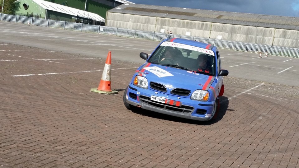

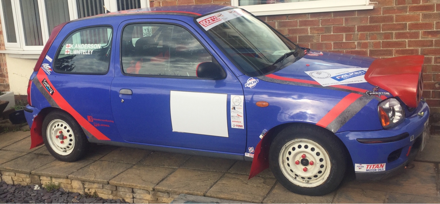

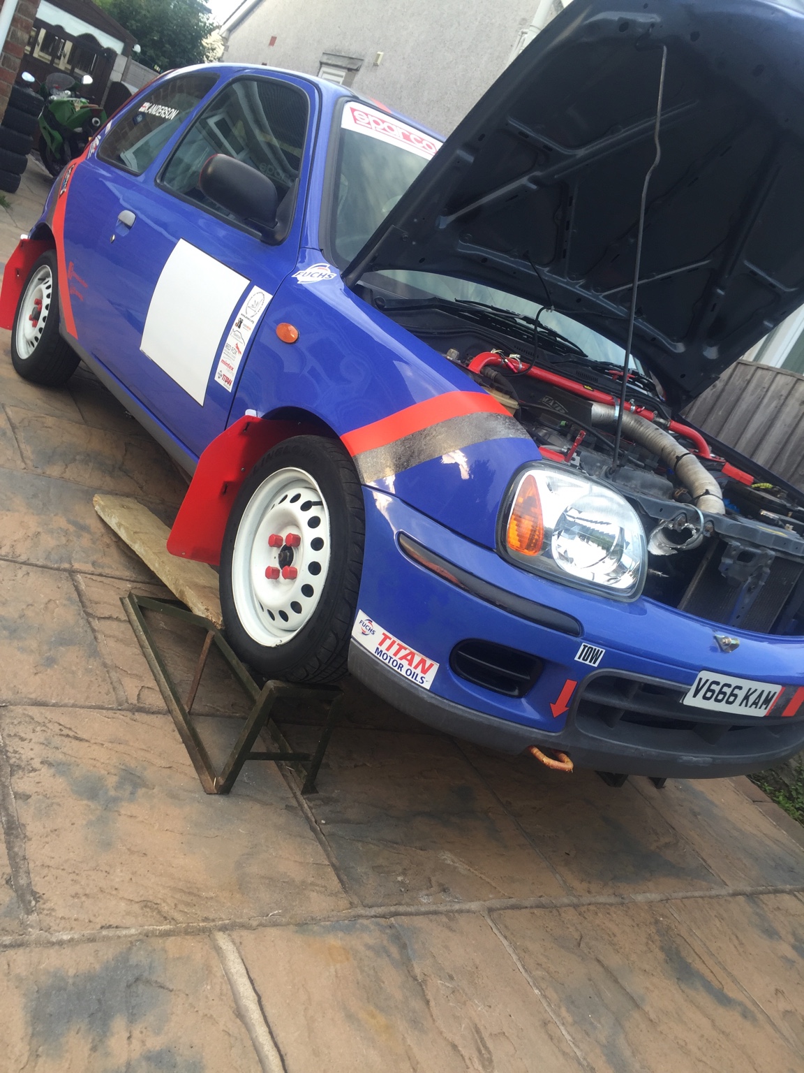

Has been a while since I last posted so here's how the car is now!
So since I last posted my spec has become larger.
Safety devices bolt in cage
Deep dish OMP
RSA in date harnesses
Sparco sprint in date seats
Mud flaps
13" steelies from original 14" (looking for alloys)
Fan override (very useful)
Spots removed
Vibe spoiler
Gaz dampers and coil springs

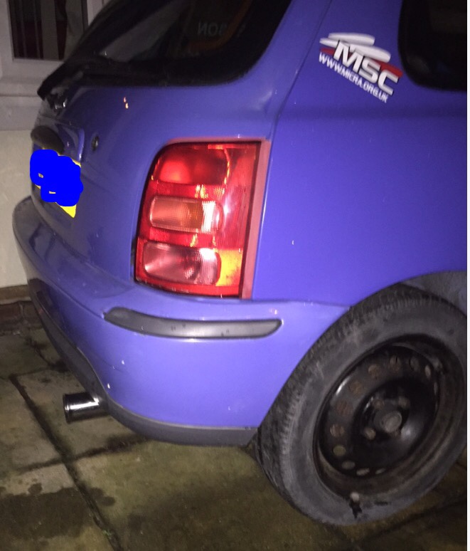

Mintex brakes and pads

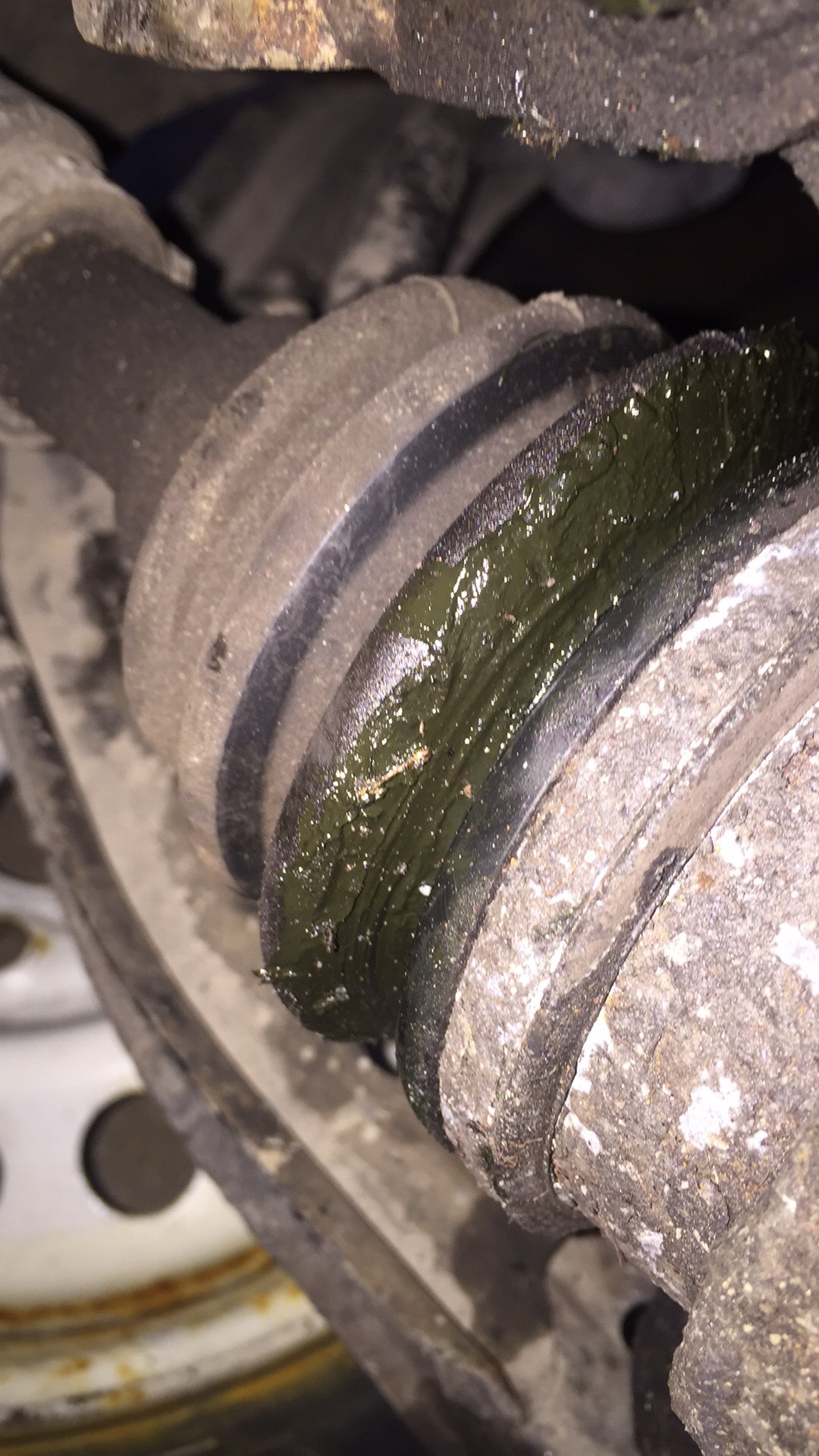

New cv boots(1.10.16)
New drivers side wishbone (1.10.16)
Nav foot plate + horn (annoying with some people)
More things that I can't remember ect ect
Car has been used on only autosolos so far and looking to be logbooked by the end of October.

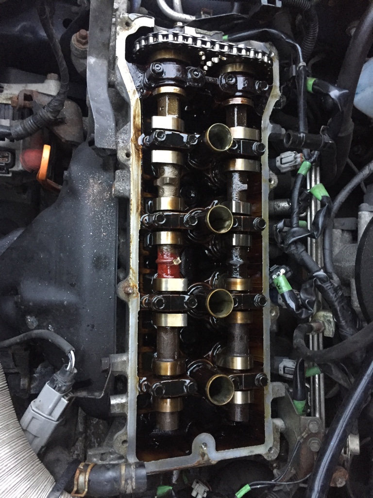

Tested the other day at the Neil Howard stages, brilliant although I have idle issues, constant adjustment on the throttle wire... can't get it right!
