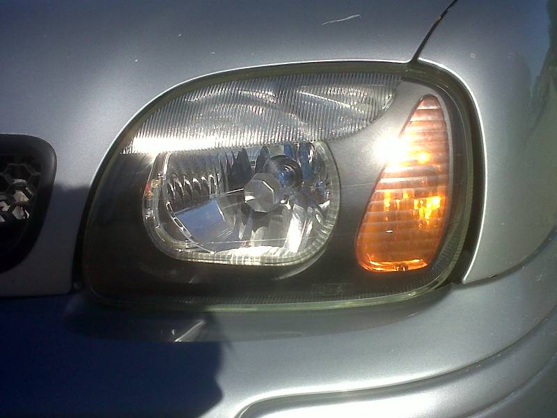

Pity they didn't work out, the shape looked quite good from your pics. You seem to have lost a lot of the light from the middle section. I've actually turned the voltage down on my prototype pic as they were too bright for the camera. I'm sure the headlights will still drown them out though when they're on. Theyre more for show than anything really.
