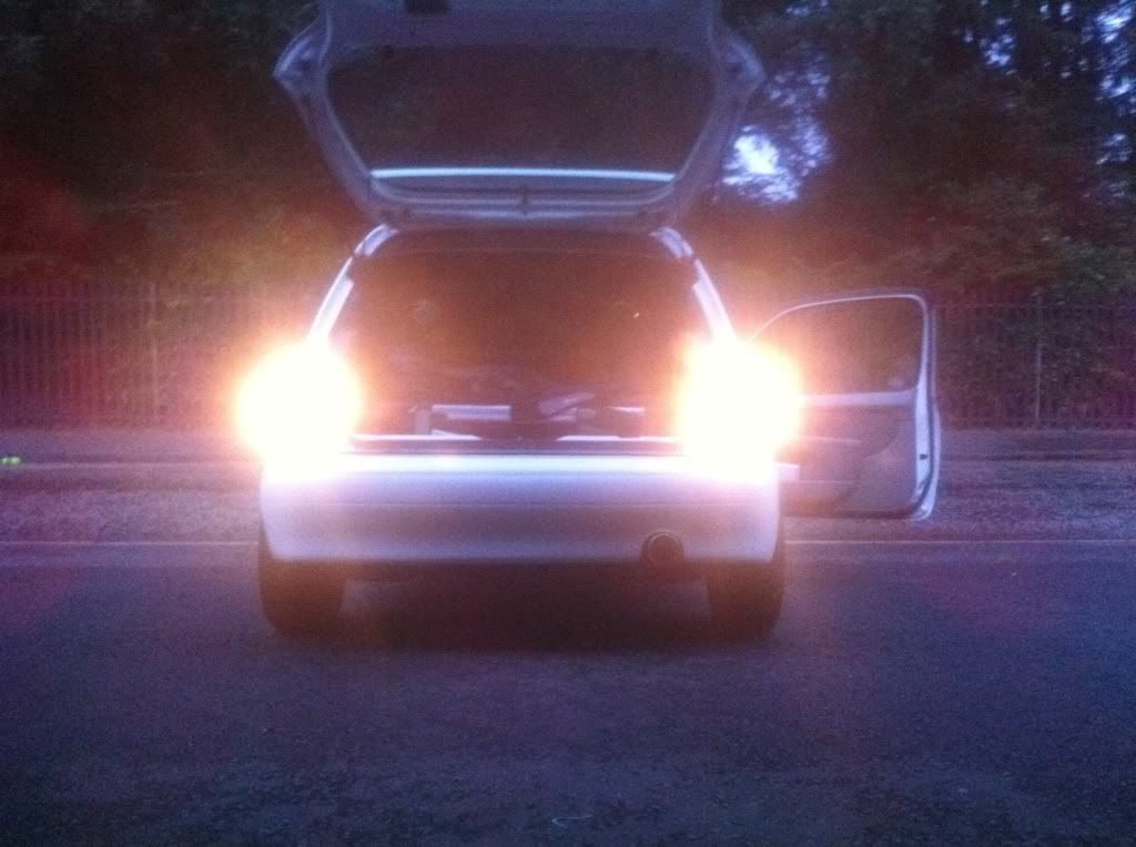

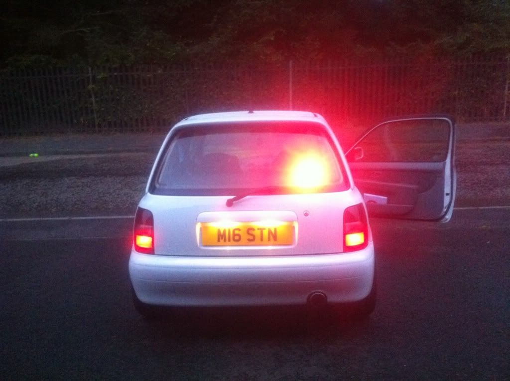

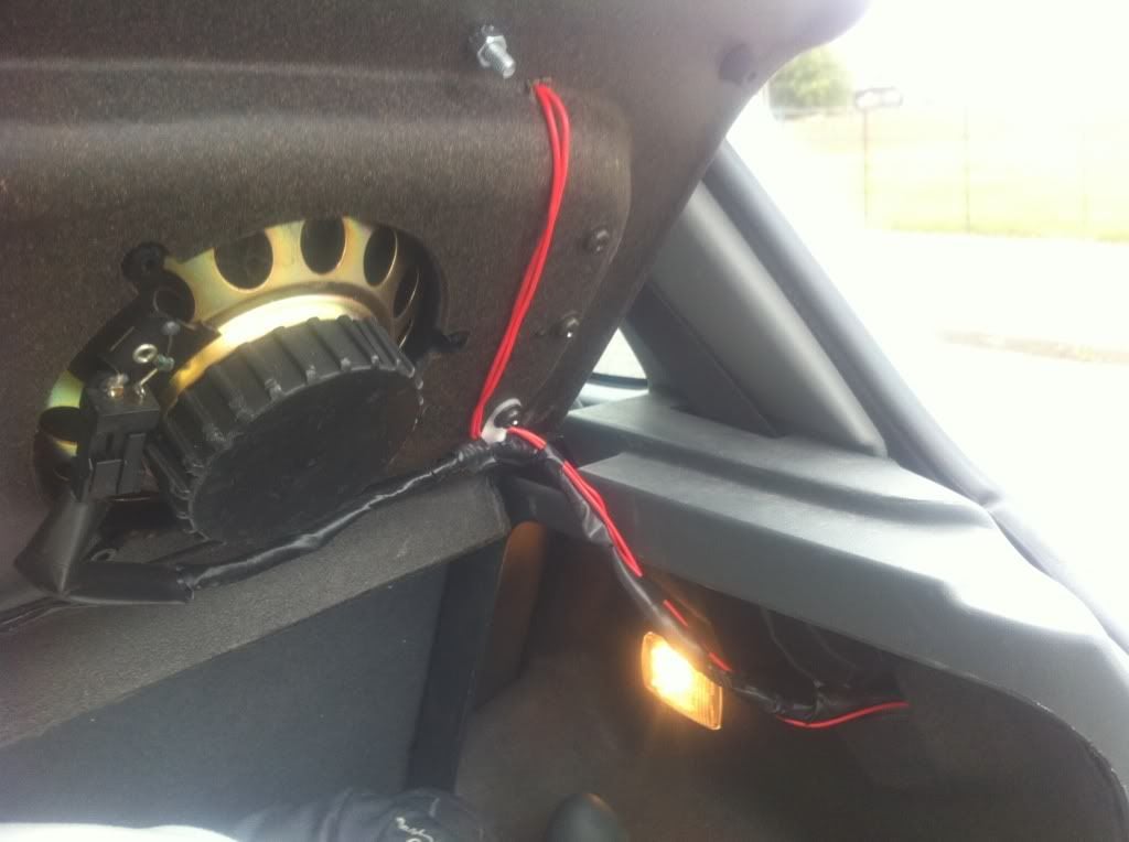

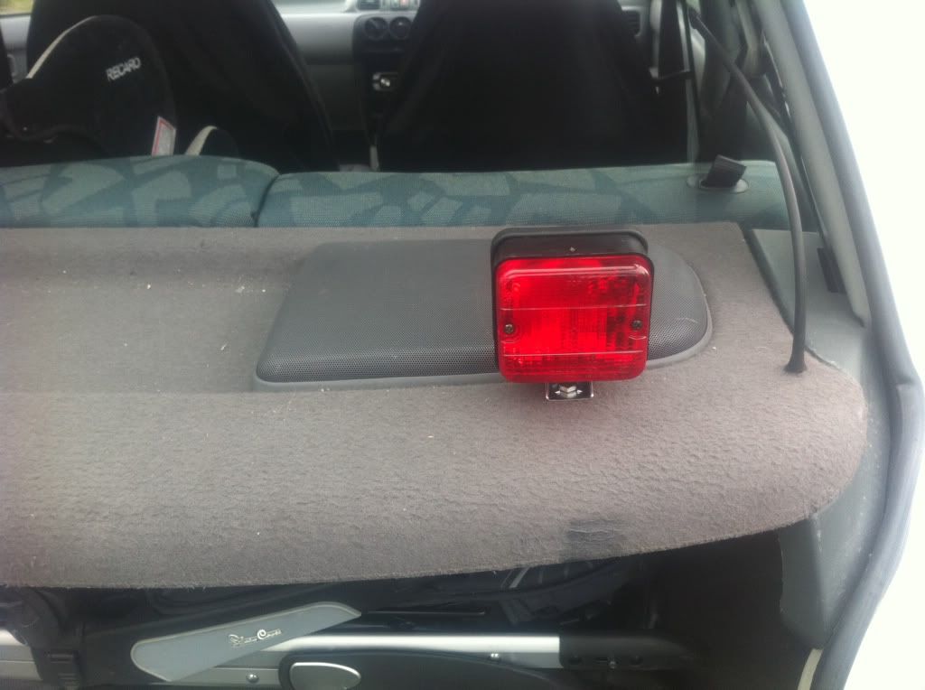

Had a few hours tonight on the car made the jap lights into twin reverse and fitted a fog on the parcel shelf :)
There brighter in the pictures, just normal in person :) was gonna hang it off the bumper at the bottom but it just didnt look right and is too low for regulations i think
I was going to do that but im risking a super-s bumper for the same effect. Then i couldnt make my mind up where to insert it so im glad its out of sight and its neatly fitted :D

Stani, what about a third brake light/the one that sits in the middle bottom part of the rear window. You could convert it to a fog light too...
I removed it pepo, have never liked that brake light but that would have been easier
Ah, OK... when you get a chance would you post some day time pictures of the fog lamp. With my rear flyeyed lamps you can see very little in the night if you drive behind me. When foggy... gets worse :) I'm thinking of adding a fog under the bumper. Today I fitted my rear splitter and may well go just behind it (Y)

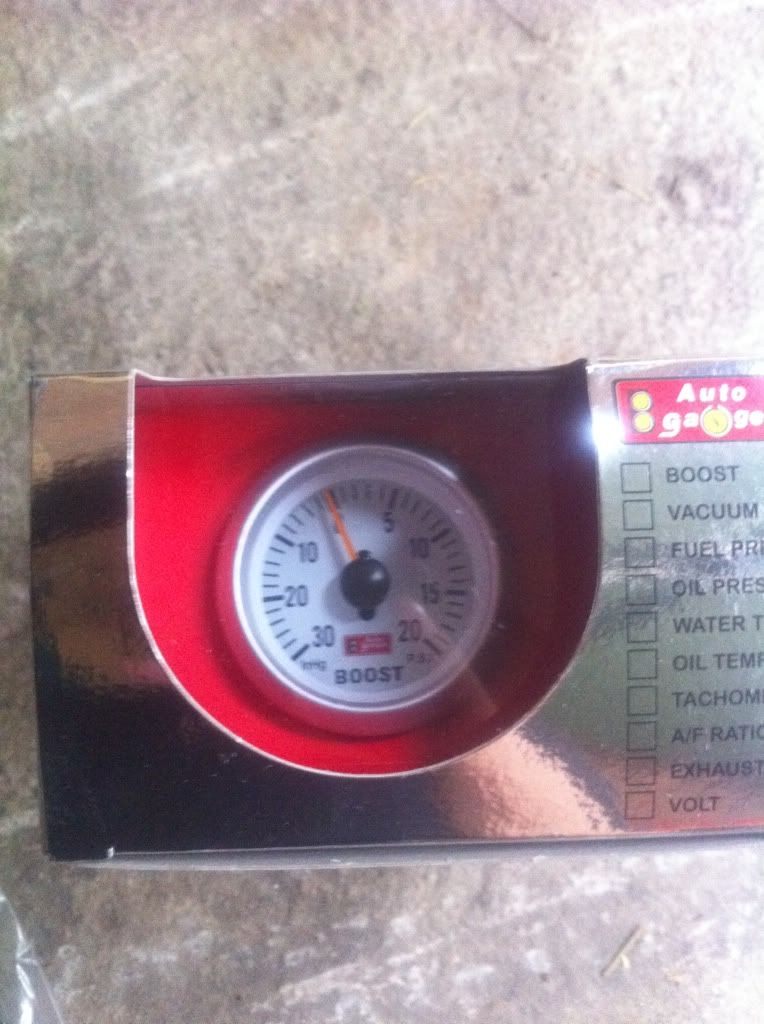

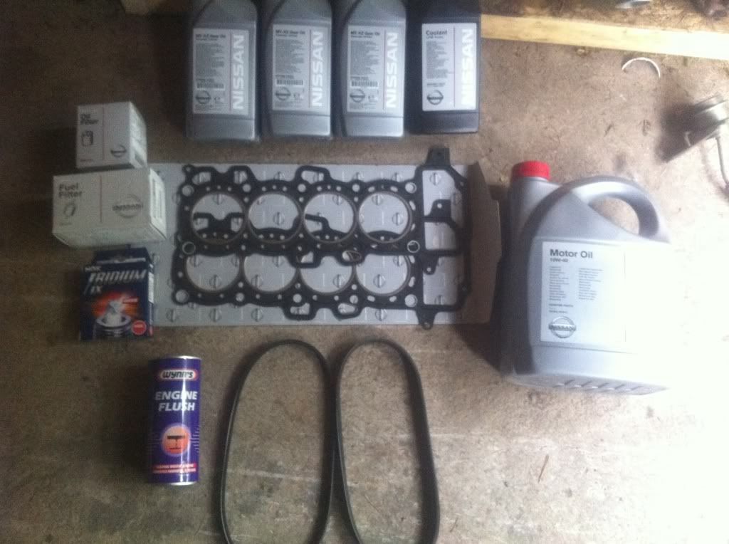

Pepo the pictures have been added above :) heres some of the bits ive been collecting
Oil, filters etc

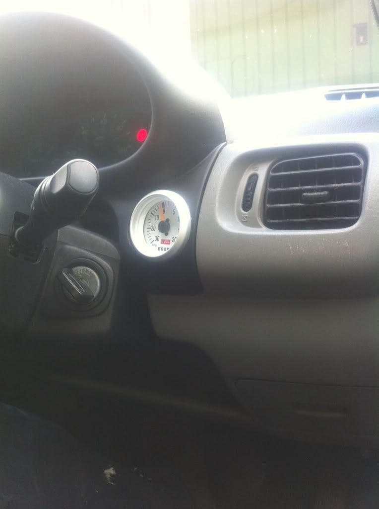

Boost gauge

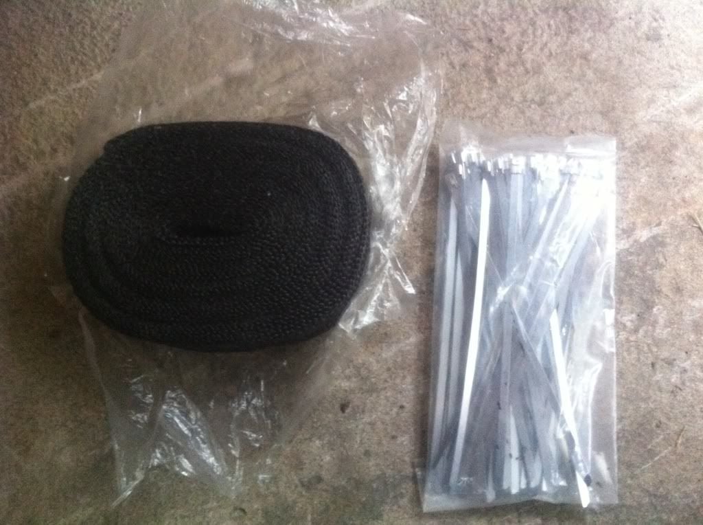

Heatwrap for intercooler pipes

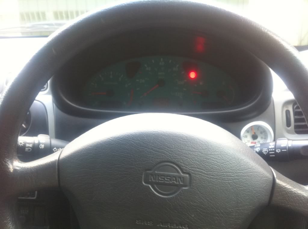

runnin some negative boost atm eh stani lol :) i had one in bluey and it read about minus 3/4 bar on lift and about minus 1/4 bar @ cruise iirc
Aye not piped in yet though just trying to save the odd half hour here and there for the big day! Im sure ive got everything apart from the remap money or a reply from Ed. Both of which i hope to have soon

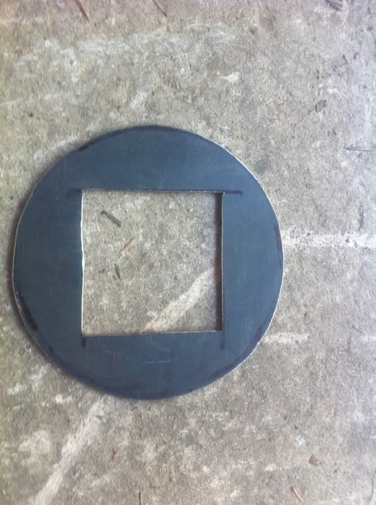

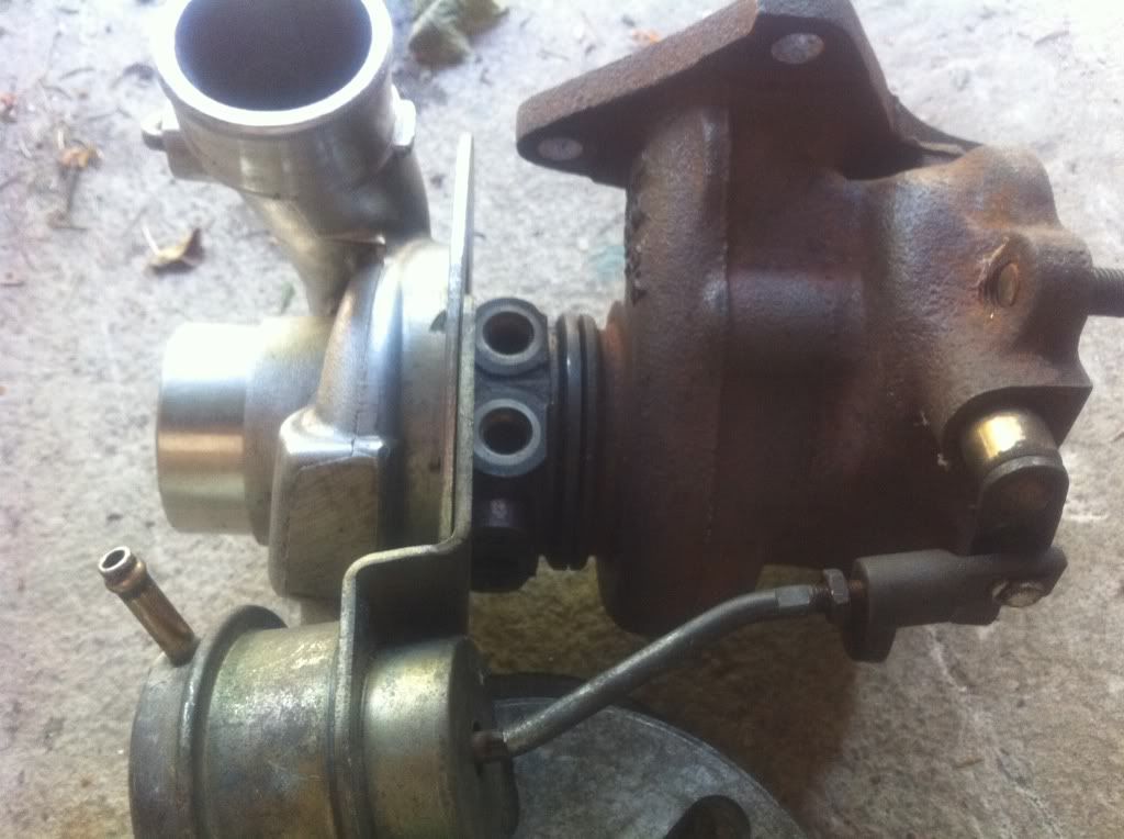

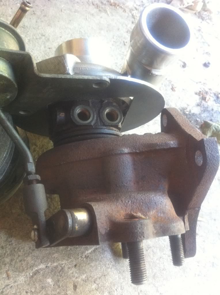

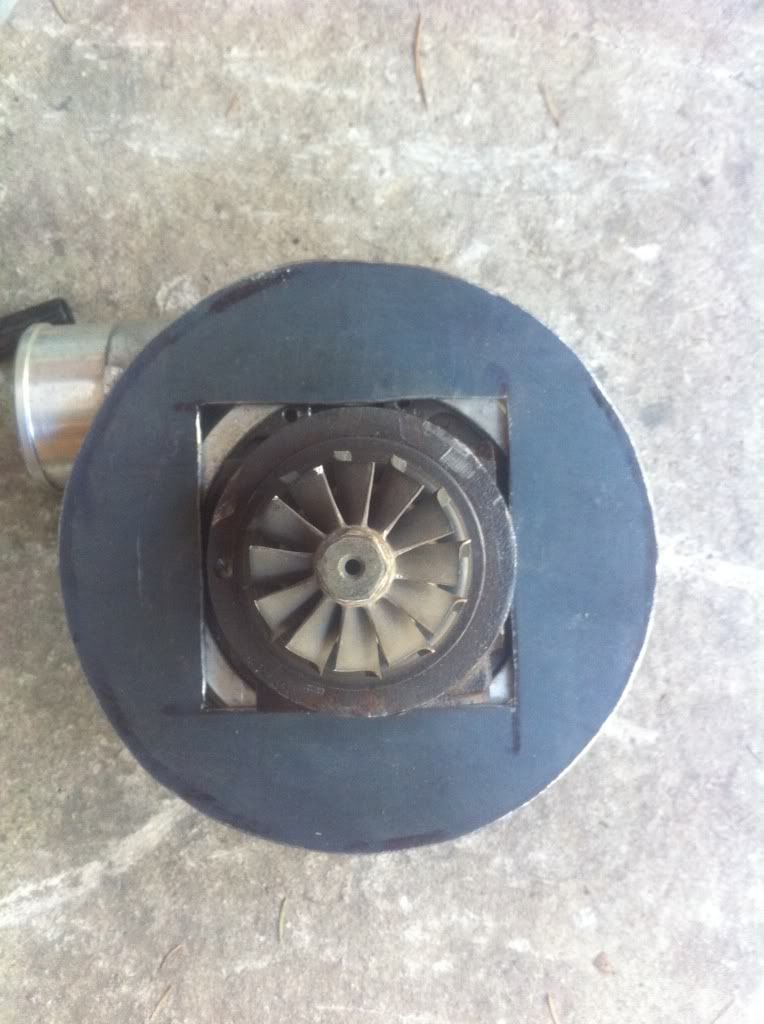

With having to rotate the inlet and exhaust housings on my turbo the mountings for the actuator were 180 degrees away so had to make a new bracket which will bolt into the existing holes and allow the actuator to be bolted in the correct place :) also picked up some braided fuel pipe and end finishers

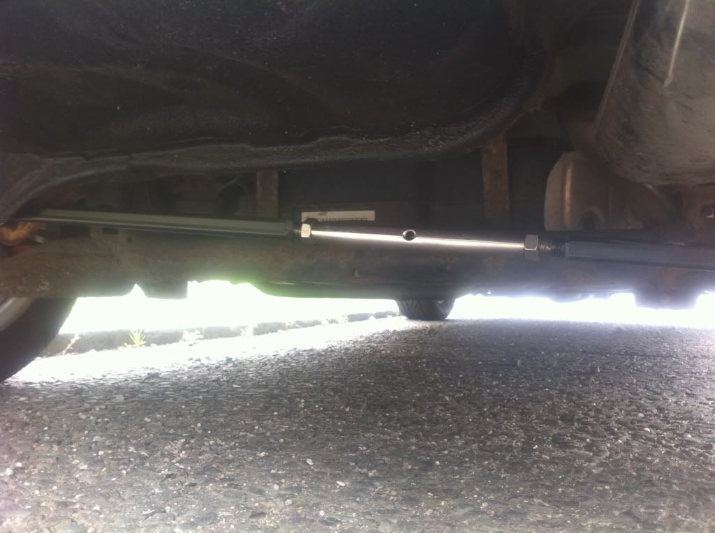

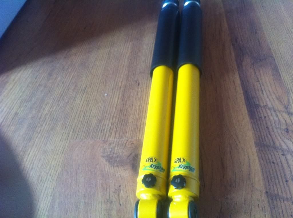

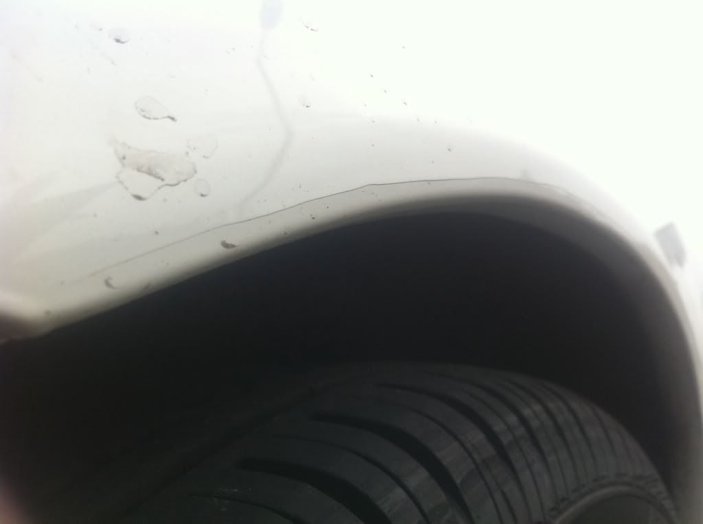

Turbo build delayed AGAIN!! Since ive fitted my frankspeed wheels and chunky tyres the offside rear wheel has rubbed the arch over bumps and cornering which has caused the paint to crack!!! Ive fitted an adjustable panhard rod now which has helped and bought spax adjustable rear shocks to help further. The car is booked in to be repaired on the 23rd of this month, also getting a dint on the boot popped out as it appeared after a respray. Gutted that ive had to spend another £400!! Anywho its time will come eventually :eek:
Aye im gutted like, that arch is a newly made one aswell. I reckon if it wasnt then the inner arch lip would have bent round easier and not caused a crack so in a way i know its solid. Ive also got my manifold back after it was skimmed flat and a new crossmember :D
