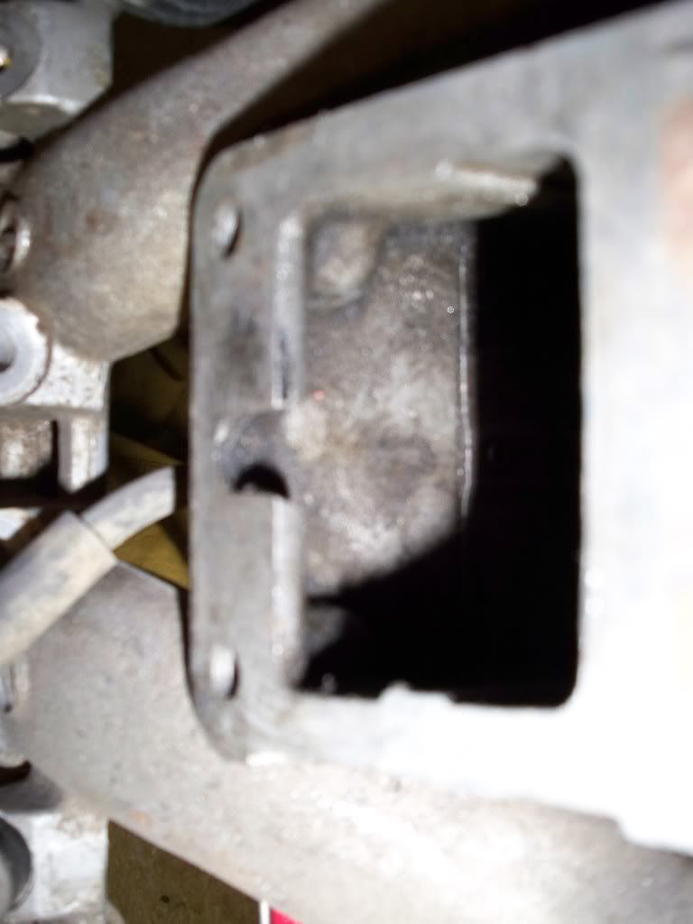

The picture below shows the area that would need removing for it to open fully as it fouls it at the minute but apart from that, would it work? It would give a greater air intake than standard and I can make a mount for it to sit on correctly.

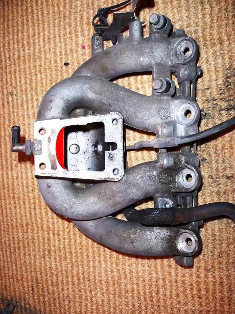

i would be interested in putting on the 2.0 plenum chamber, that would give alot of advantages with turbo installs

Not sure if the 2.o plenum would fit?

to me it seems like a lot of work for minimal gain. you might be better off trying to bore out a 1.6 tb to fit the 2.0 butterfly valve. but it would be interesting to see if the plenum with fit. that would solve your first problem anyway.

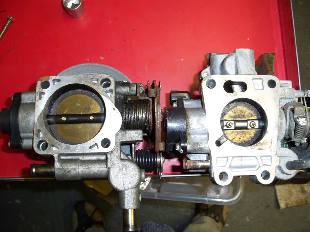

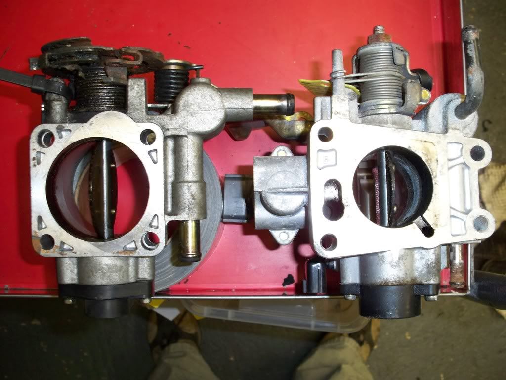

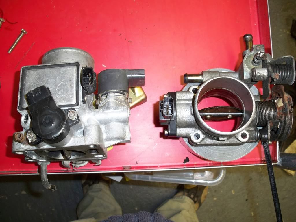

Below are the photos that I took last night as you can see it has a huge difference in size,
Is it possible to use a different MAF sensor and have it located in an air duct feed to the throttle body?

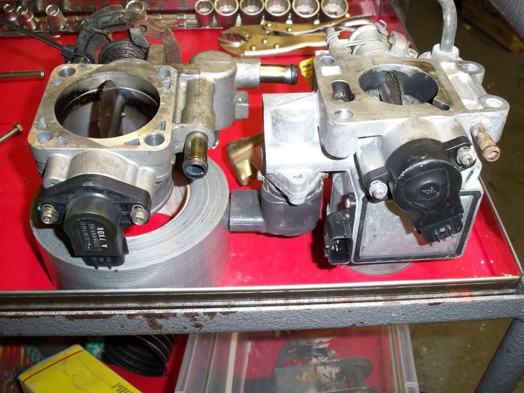

I have photos below of the sides and as you can see the 2.0 throttle only has one sensor, but the 1275 throttle has three, so would I be able to do a bypass?
This is a photo of the lip that I would have to mill down to give the clearance, as you can see from the photo its just a lip and doesnt do anything.

Consider that throttle response will now be extremely sensitive. I.e. much more on/off than it was before. You may need a cam shaped accel pulley to make this more tractable.

it looks like it could be a good mod, you have alot more airflow. but as Ed says it will let alot more air in with minimal movement of the valve, so all it may do is not give you any performance gains but just make the throttle responce tighter.
the single sensor you have on the SR20 TB is the throttle possition sensor, i think the other sensors you get on the CG13 TB is obviously the AFM sensor, and the other i think is the cold idle valve, but i may be wrong on that.
