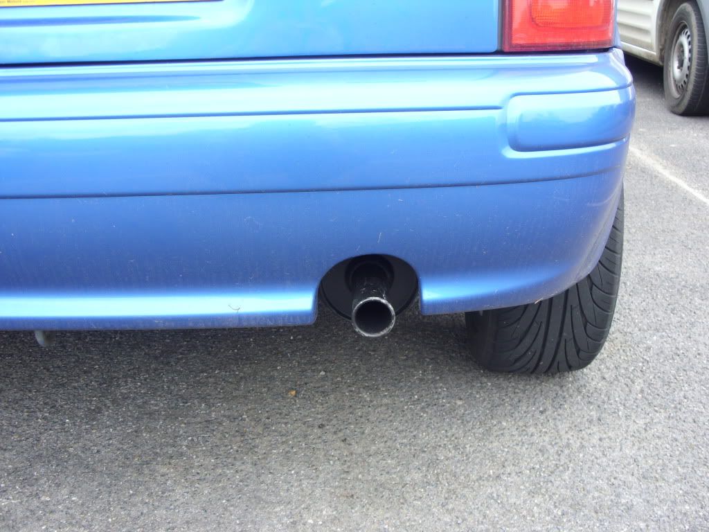

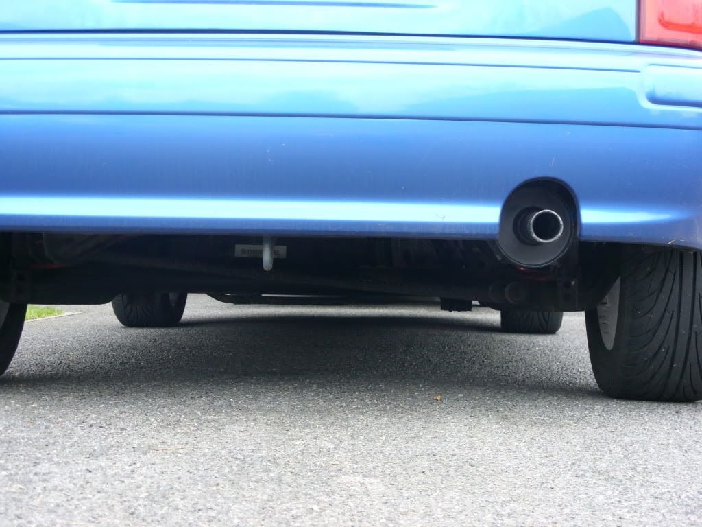

fitted the exhaust at work today all went well fits like a glove :) !! n sounds amazing !! lovly Rasp ! would deff recomend getting one of these !!!
i like it too because it looks standard so wont draw too much attention .. i hope ;)

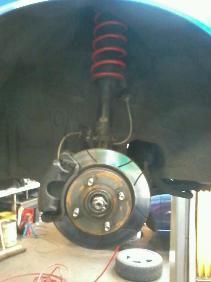

Anyways as for my little si i thought it was about time to go low n slow :p i ordered a set of
35mm PI LOWERING SPRINGS And a set of Franks panhard rod bushes :)
Anyways got round to fitting the lowering springs pretty straight forward and easy :) and the panhard rod nuts came off easyily thank god !! .. they where pretty rusty but abit of wirebrushing and de-lock spay never lets ya down ;)
was looking good just hoping it loweres it nicely 35mm drop should sit me just about my 15" wheels with a little room as not to roll the arches
Lowered :p not as low as i was hoping .. but hey ho it will do for now as ive just brough them they can stay in for a year befor ill covert to coilovers .. ;) !! n deck it
