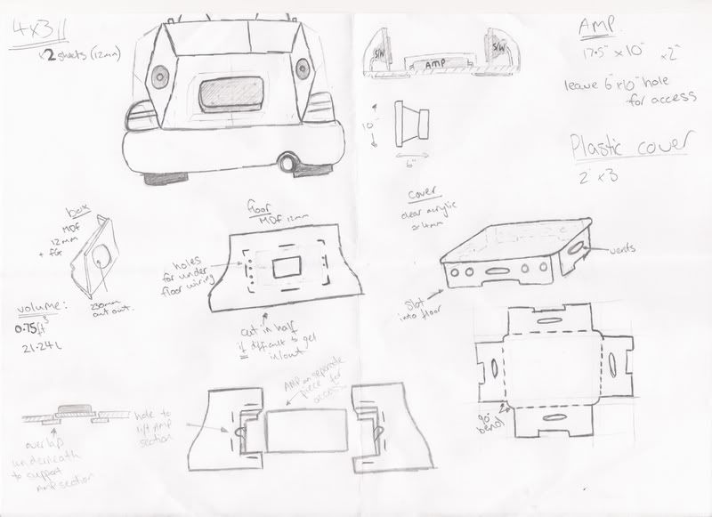

So to start with, my install is of two 10" subs (JBL GT4's) and an amp (JBL something.. 4channel amp gto-1004 maybe, i can't remember) to power them ibnto the boot, hopefully leaving some sort of boot space! I'll be making up a false floor, then fibreglassing around the sides of the boot to fit a sub either side in custom 'stealth' boxes.
Here's a rough design:
Ignore the plastic cover bit for now.

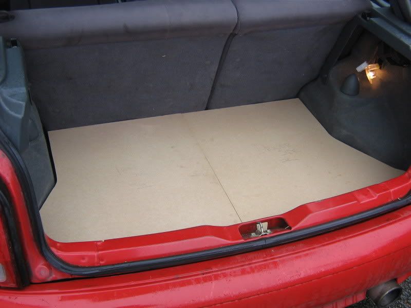

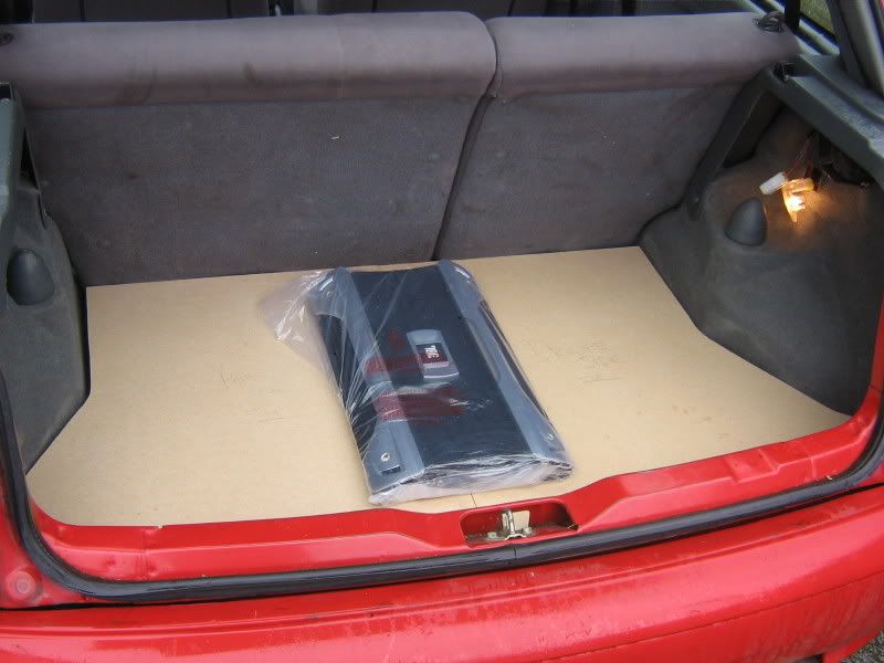

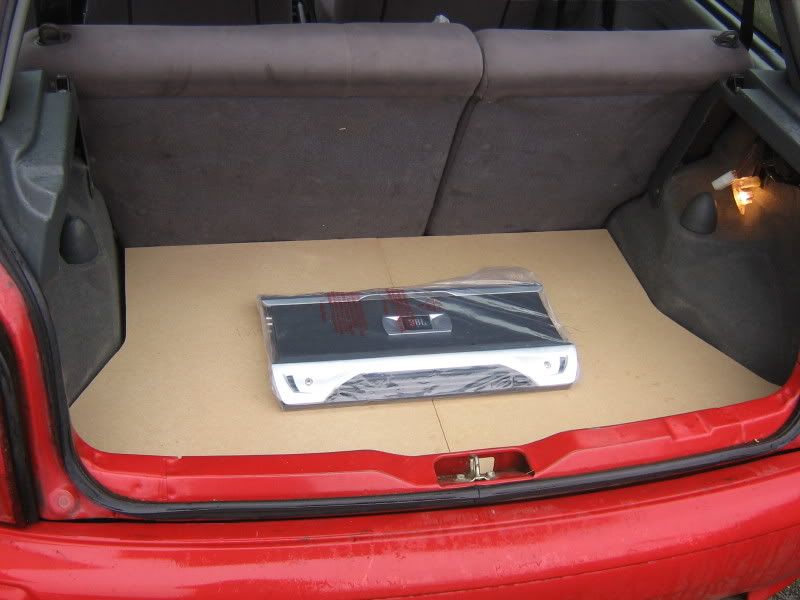

The floor in place (not finished or fixed, just the basic shape):
Now, i think I overestimated the size of the boot/underestimated the size of the amp in my design:
I don't think there's going to be enough room to fit the amp on a seperate piece of MDF to the floor, so instead I'll mount it to the floor like this:
And just cut out a hole under the amp to allow access to the wheel well. I'll be ditching the spare wheel, but need somewhere to keep my cans of tyreweld, and it'd be no good if i couldn't get to them!
Downside to this way rather than mounting it on a seperate piece of MDF is that I'll have to unscrew the amp to get to the wheel well..
Floor'as in properly now, just needs to be carpeted.

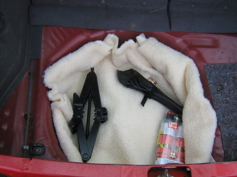

Put some padding in the wheel well to stop stuff from rattling:

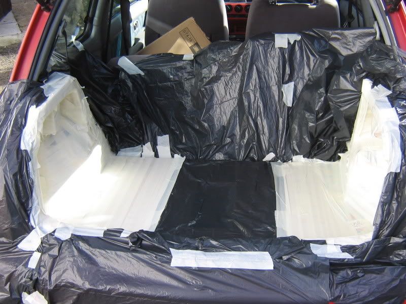

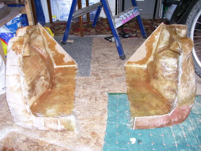

Started work on the fibreglassing today :)

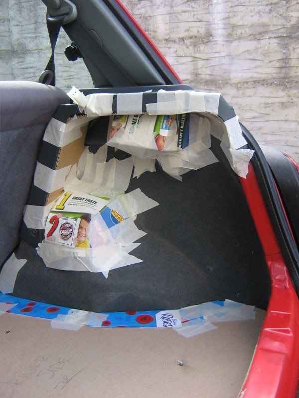

Blanked out over the strut tops/seat belts etc:
Masked it all up:
First layer of FG down:

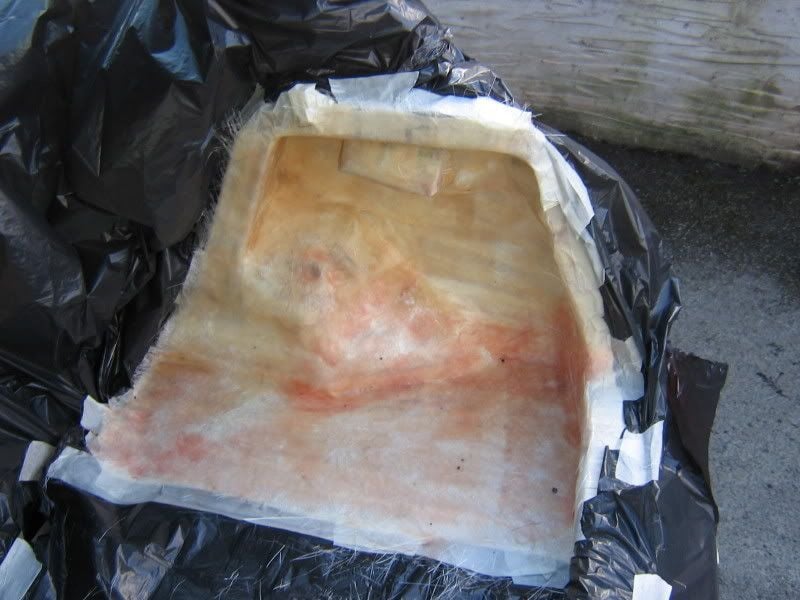

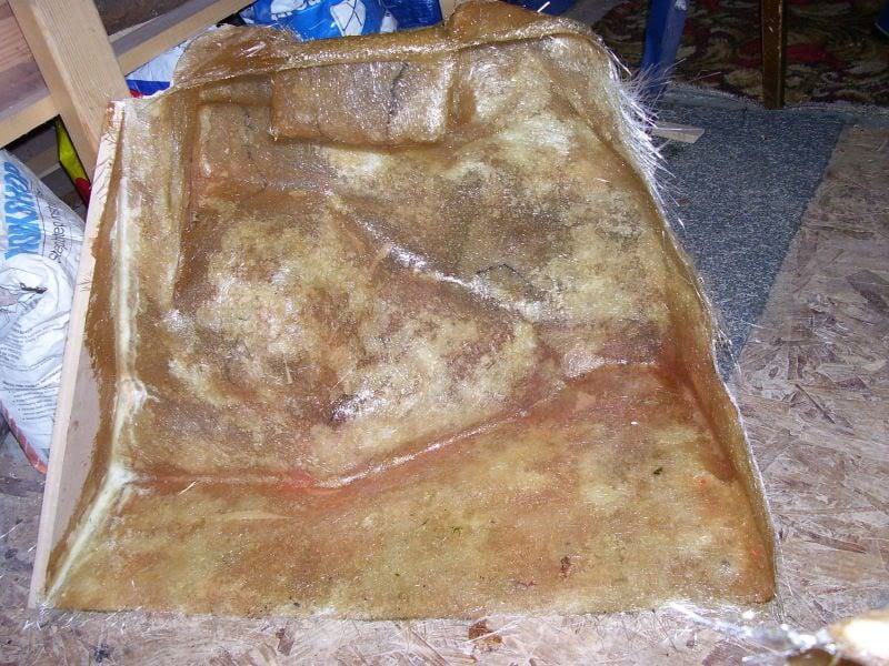

Hopefully gonna put a second layer down tomorrow then take it out of the car to build up a few more layers next week i expect

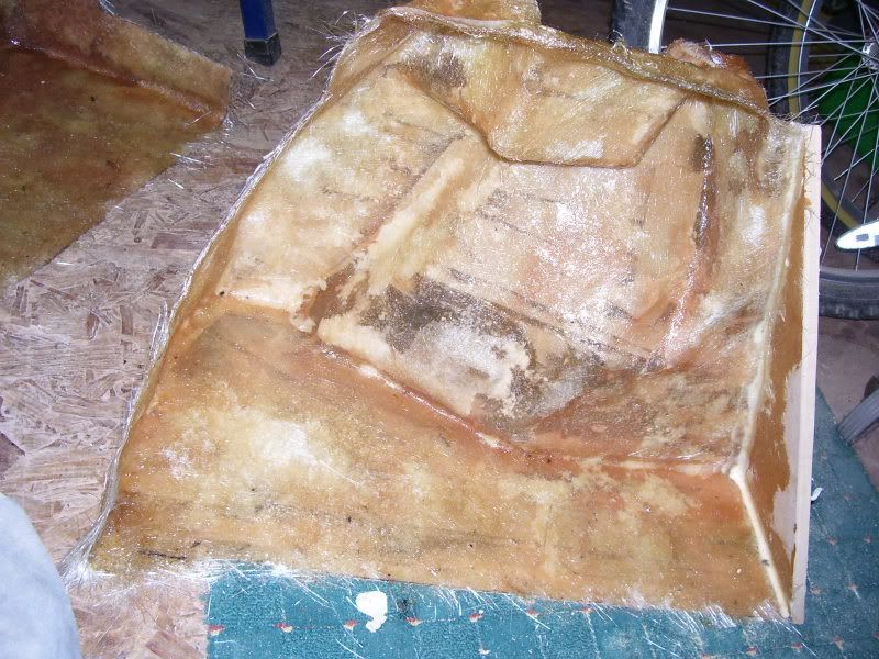

Took them out of the car and put a third layer of fibreglass on, two more tomorrow and that should be it hopefully, and can start the fronts/sides of the boxes :)
You can get a kit from hellfrauds or most motor stores. The most common one I've seen is the Davids fibreglass kit. You'll get a stiff brush, the matting, resin, hardner, a little mixing pot, and some lollypop sticks, and some gloves. There's a small kit, and a big kit, the small one going from £7 to £10, and the big one going from £10 to £15. But you'll need to buy some Acetone (nail polish remover) or Cellulose thinners, to clean the brush and your hands with.
I'm betting rob's used the david's kit because when you mix the resin with the hardner, you get an orangy/pinky mixture.
Looks good though. Using the bin bags and the masking tape is something I wouldn't of thought of.
I'm kinda half using a guide on talk audio, half making it up as I go along.. Lol, the bin bag protection came from there though!
I didn't get a kit, and bought everything seperatly instead cuz it worked out cheaper at Trago (some big department store that sells pretty much everything cheap). I think it was like a quid for tube of hardner, £4ish for 500ml of resin, and £2.50ish for 4ft square of matting. Already gone through 2l of resin and 5 packs of matting!
Trago mills in falmouth?
Ahh. I've always found it works out a bit cheaper to buy the kits for small bits of work, because you get the brushes and little tubs with them, which come quite useful. But I guess it's cheaper to get everything singularly in bulk for a large project.

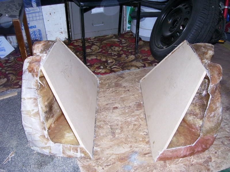

Trimmed roughly, last layer of fibreglass and side pieces in place:
I've had to make the boxes angle like that to leave me some boot space!
I measured the part that sits around the sides, coming out as far as the parcel shelf support to hold about 7.5 litres. Each sub needs 21.24litres, I used a volume worker-outer online and the total volume of the box should be about 21litres, which is close enough for me.

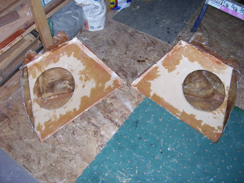

Got the front panels cut out today:
Need to cut the speaker holes, then stick them on! Maybe tomorrow, but if the weathers nice enough I have a manifold that needs swapping!

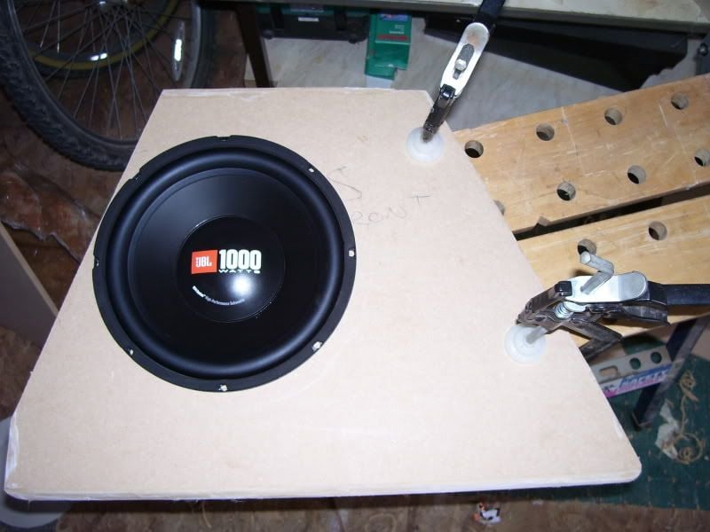

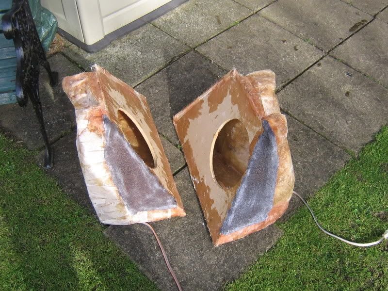

Cut out the speaker holes, would've been rude not to test fit one!:
And fixed them to the boxes:
Need that to dry, then seal up the edges from the inside, then bridge the gaps at the frontmost sides of the boxes with some fabric/FG.

All sealed up, and speaker cable has been put in and sealed too.

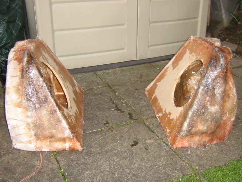

Getting close now!
Fabric stretched into place to cover the hole, and fibreglass resin left to soak in to stiffen it up:
Couple of layers of fibreglass:
Also realised the sub doesn't sit right in the passenger side box, it hits the back! So I'll cut out some rings tomorrow to space it out a bit, not really what i wanted, but oh well!

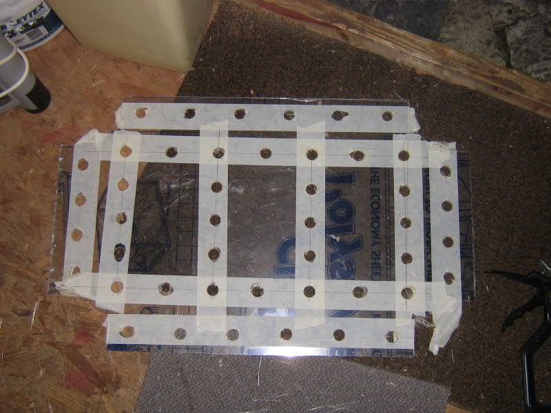

And started on the amp cover:
Still needs bending into shape..
