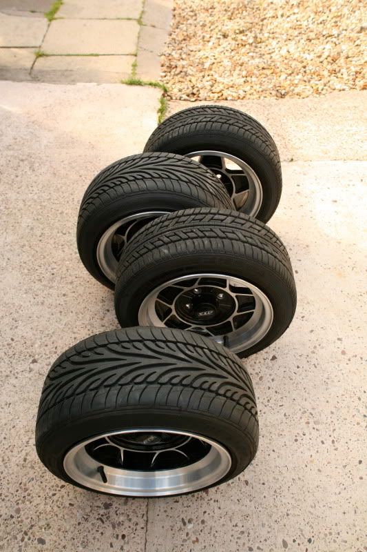

thanks guys im actually thinking about these instead i think they will look alot nicer what do you think guys especially when i get the 35mm lowering springs of retepetsir
kristians yellow euro look looks high but is slammed to the floor as much as poss mind you i havnt got a drop kerb at my house so it will work out fine i think or i might just budget my steelies and shot blast them and paint them chrome with a top coat of laquer
Cheak out the classics, I believe they come machined to fit a VW spigot, which is smaller than K11. You might find you have to get them machined to fit.
Having said that, It must be done!!!! I would love a set on mine! 7"s on the front, 8's on the rear!
